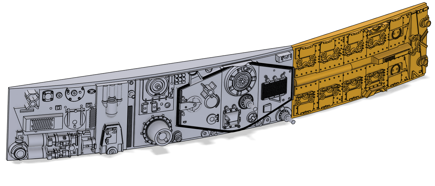

I have been watching this for a while, its incredible what your doing with a 3d printer. I noticed parts that I think match that I have been looking for. for a cylon mine for BSG can you id these parts please.
Those are from the "Elf" Tyrell Ford F-1 (003) 1971 Tamiya | No. 12009 :1:12 Model

Just finished off the next Panel last night, so have the port side rear sidewalls done
