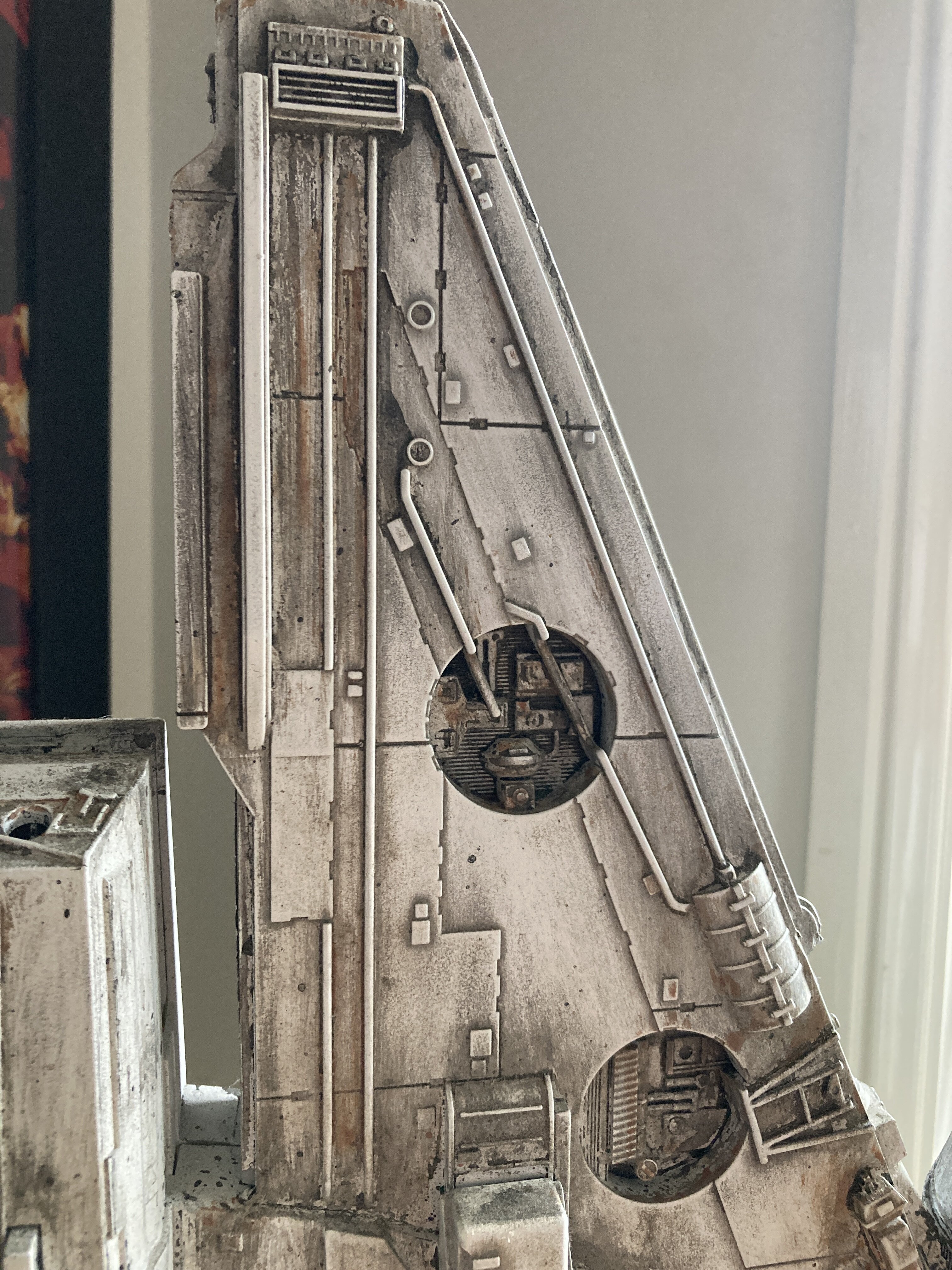

I don’t think they are short enough on the new repop. When I did mine I used the side walls from 1993 or whenever and literally cut them in half.

Thanks for sharing! You really did a fantastic job with that, it must have been a fair amount of work for you but well worth it.

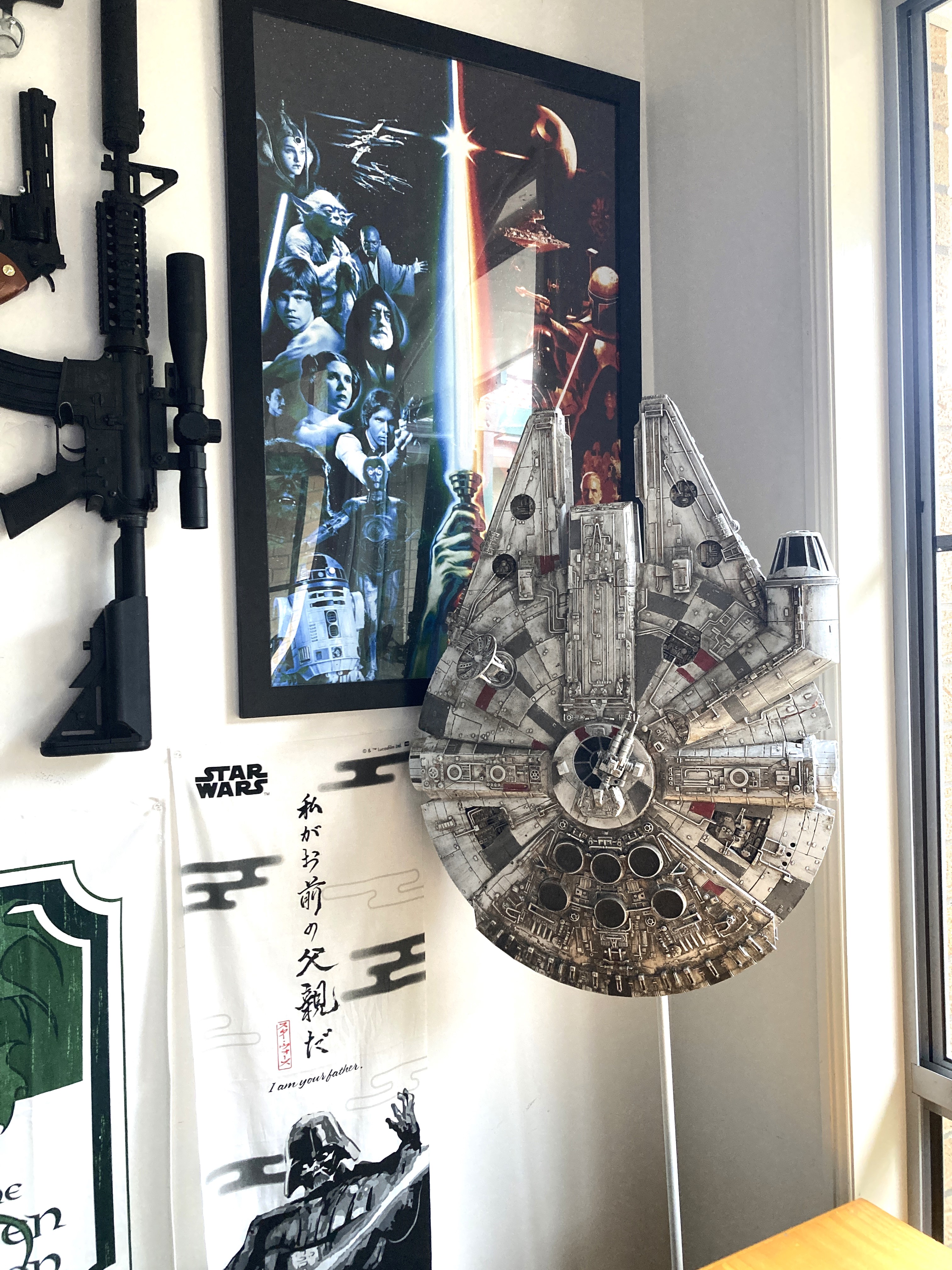

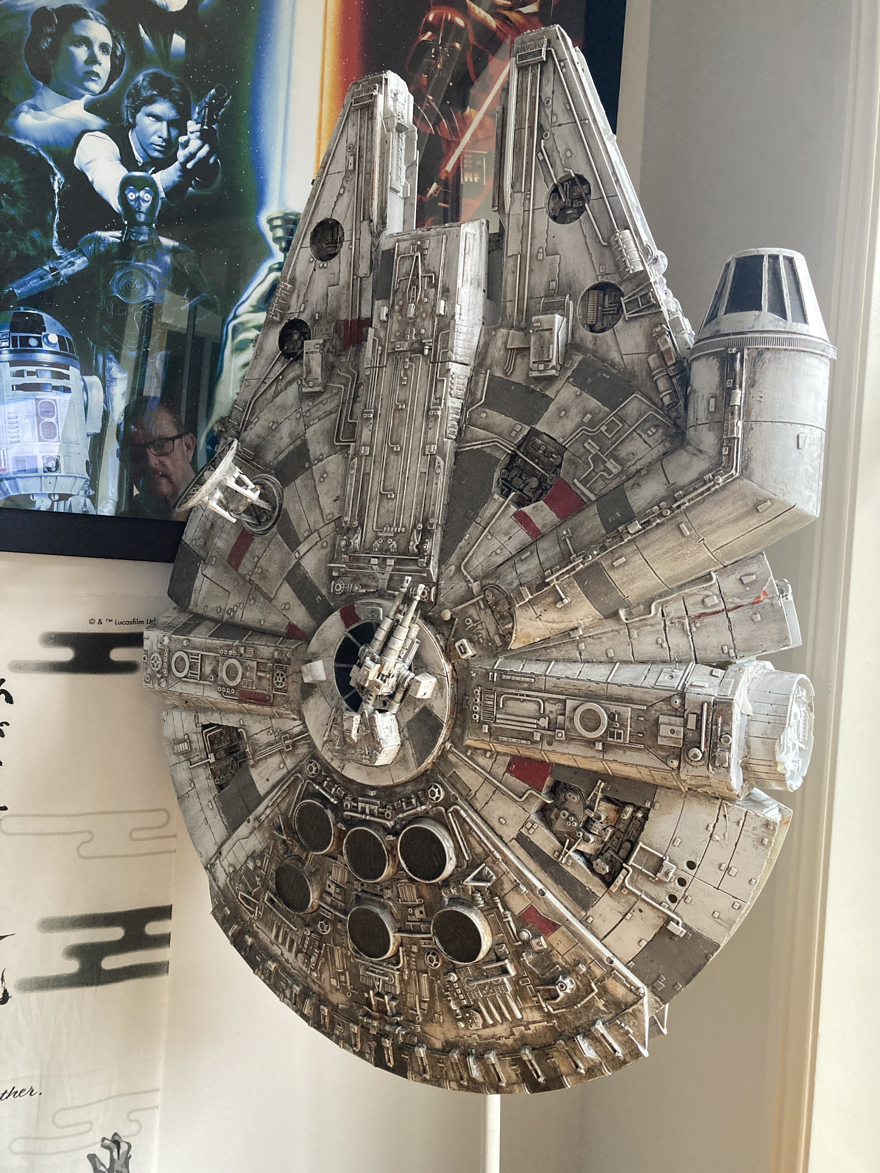

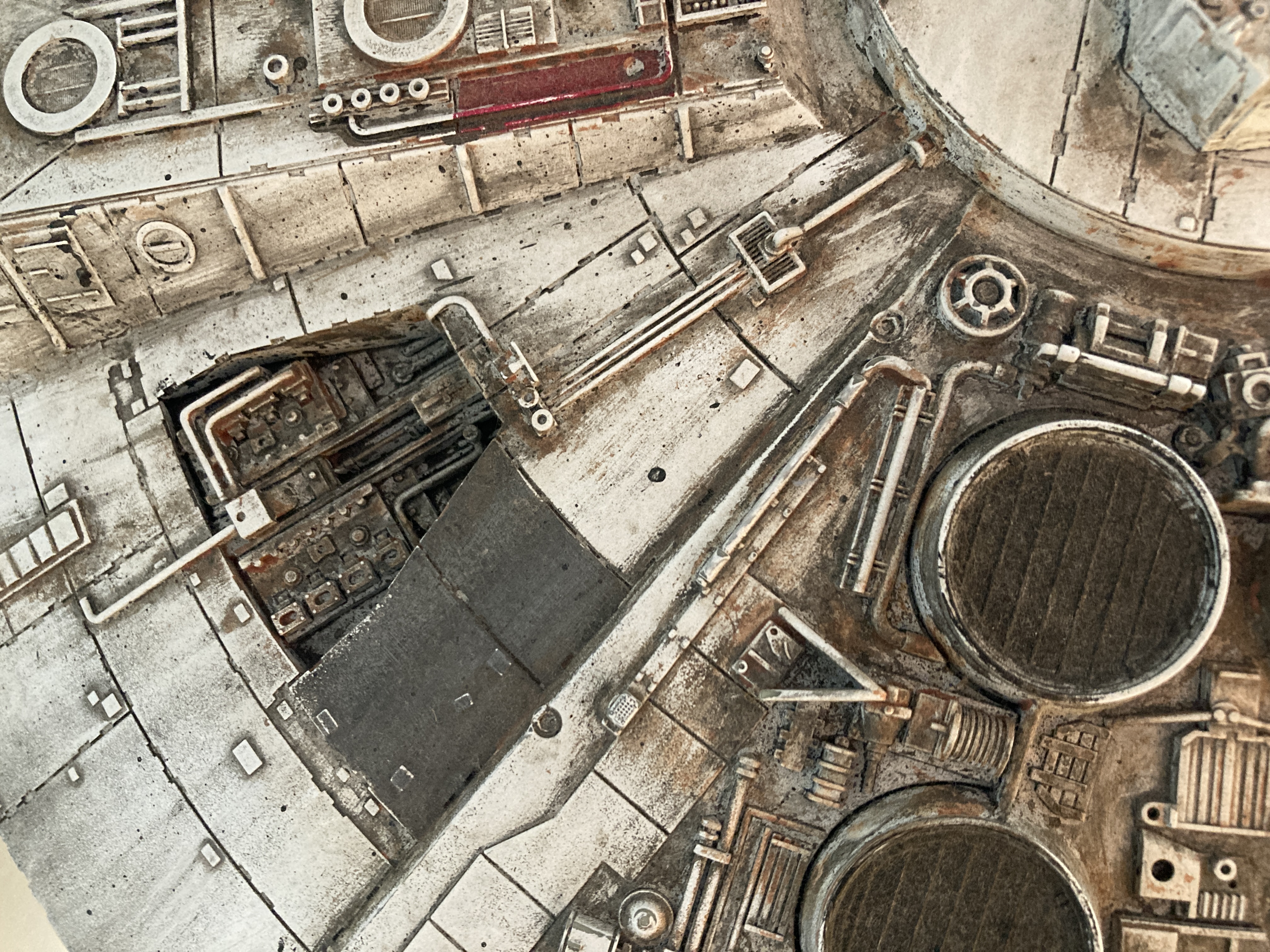

This is my 32" build. My goal was to match the original filming model streak for streak. I'm not perfect, but I got it pretty close. I think the thing people do often with the Falcon is over doing the weathering. The smaller the scale, the less weathering you should have. I see a lot of builds of the 1/72 or 1/144 Falcon painted like they're the 4 footer. You should see practically nothing at the smaller scales.

Truely lovely work there mate. You clearly have really studied the studio model well, even things like the soot off the engines you have those airbrush stop splotches, very talented and very well done.
Yeah you're right on the smaller scales having less detail, also colours should get lighter. good tips for people beginning their builds.
