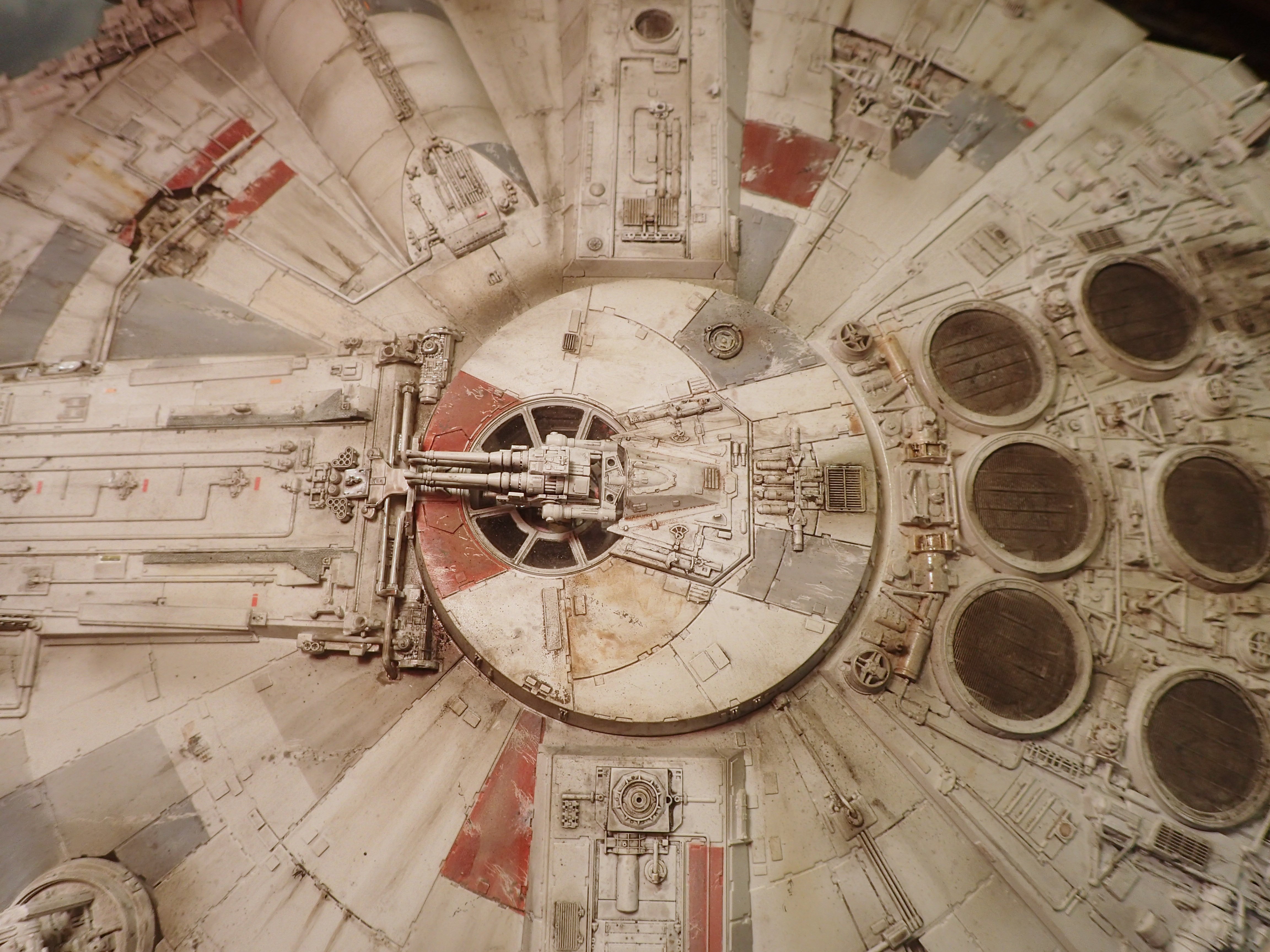

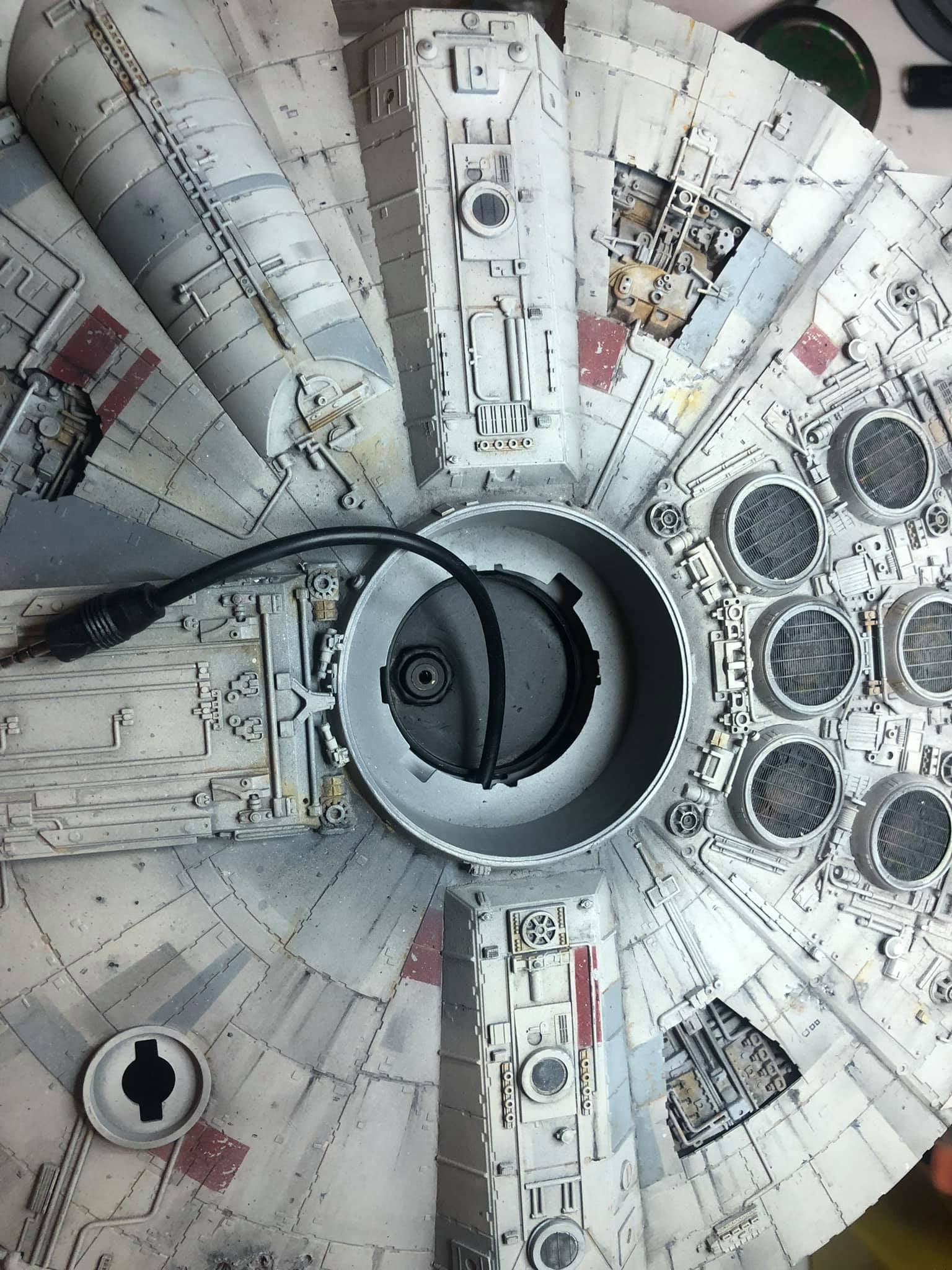

Josh as others have pointed out the lighting plays a huge part of how we see these and because the lighting in the archives is all strip lighting (and there is a lot of it), my overall impression is that the finishes on the falcons are lighter than almost all of the photo's posted in this thread are.

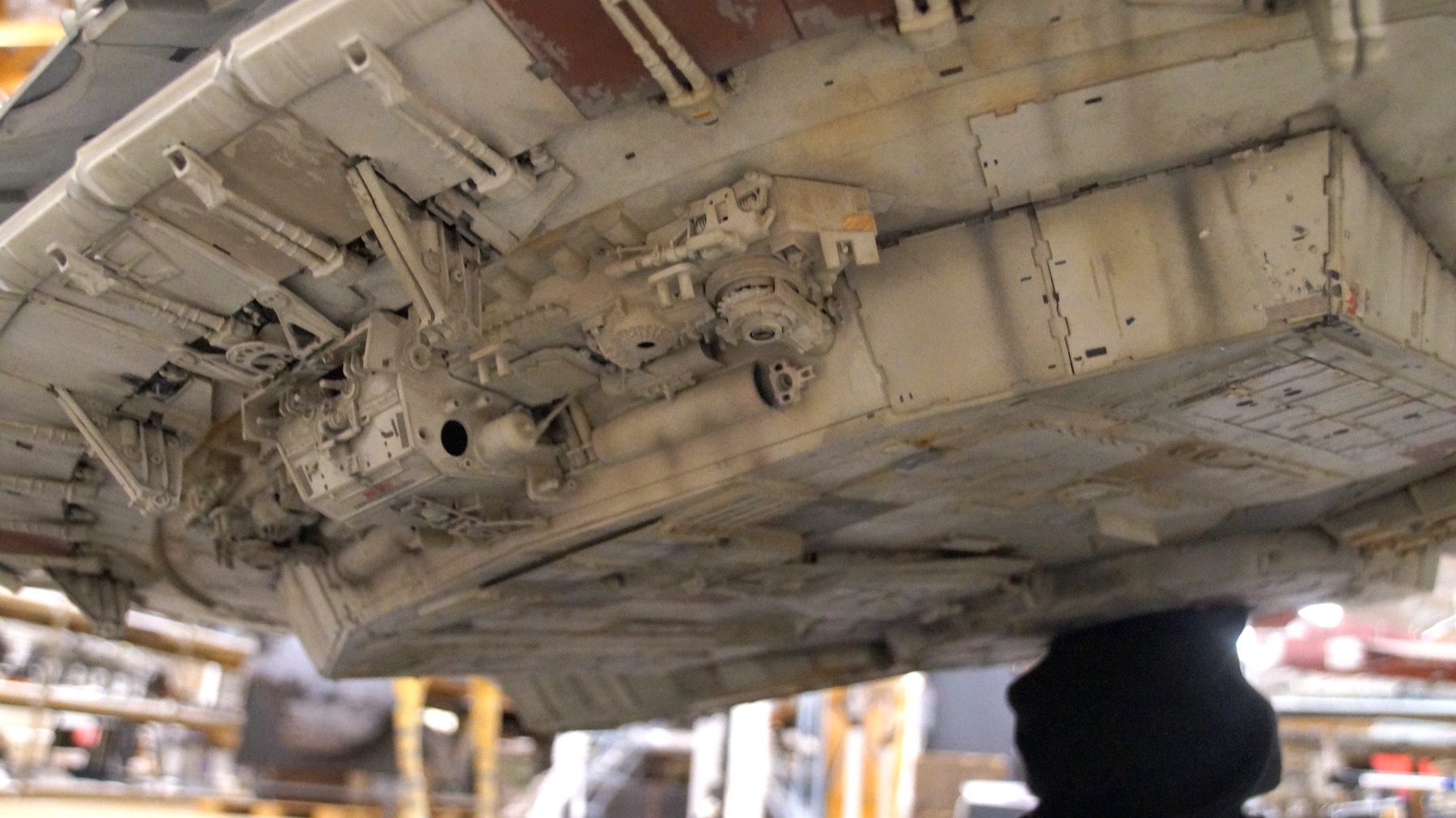

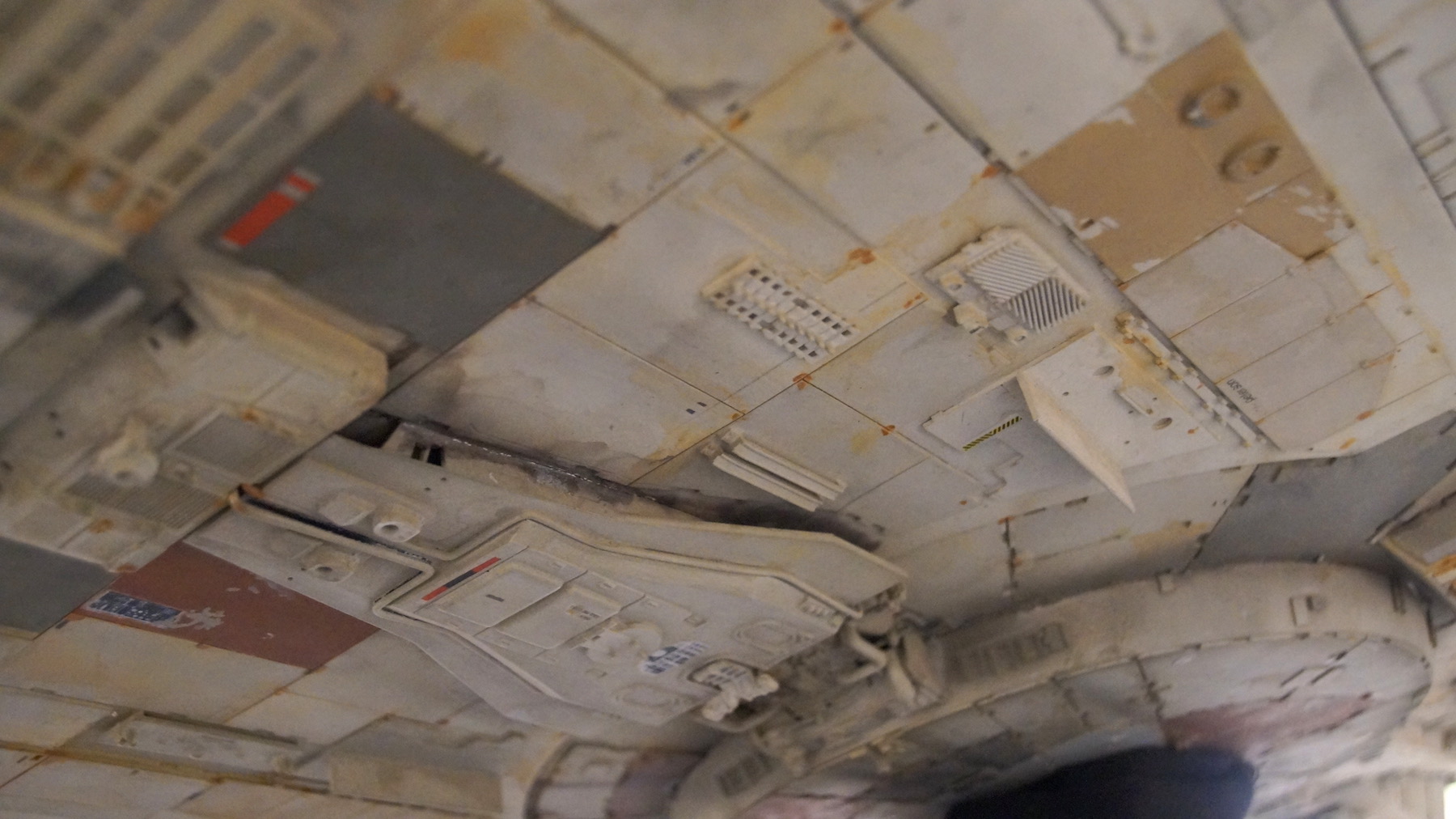

Here are a couple more taken of the underside so that the lighting is more muted and the risk of bounced light it reduced.
It is like red oxide with a dusty faded filter over it. Now that I think about it a straight white misting or filter layer would probably shift it to the wrong color. Needs more like a grime or sand colored type of misting/fading?
I am pretty sure all those odd grey, tan, light grey and red colored panels started out full tone and saturated. It was the subsequent weathering layers that tied it all together and made it more uniform looking. That is the ILM magic that is hard to capture and what I struggle with and feel like I never quite achieve. I have come close on things, but never quite got it

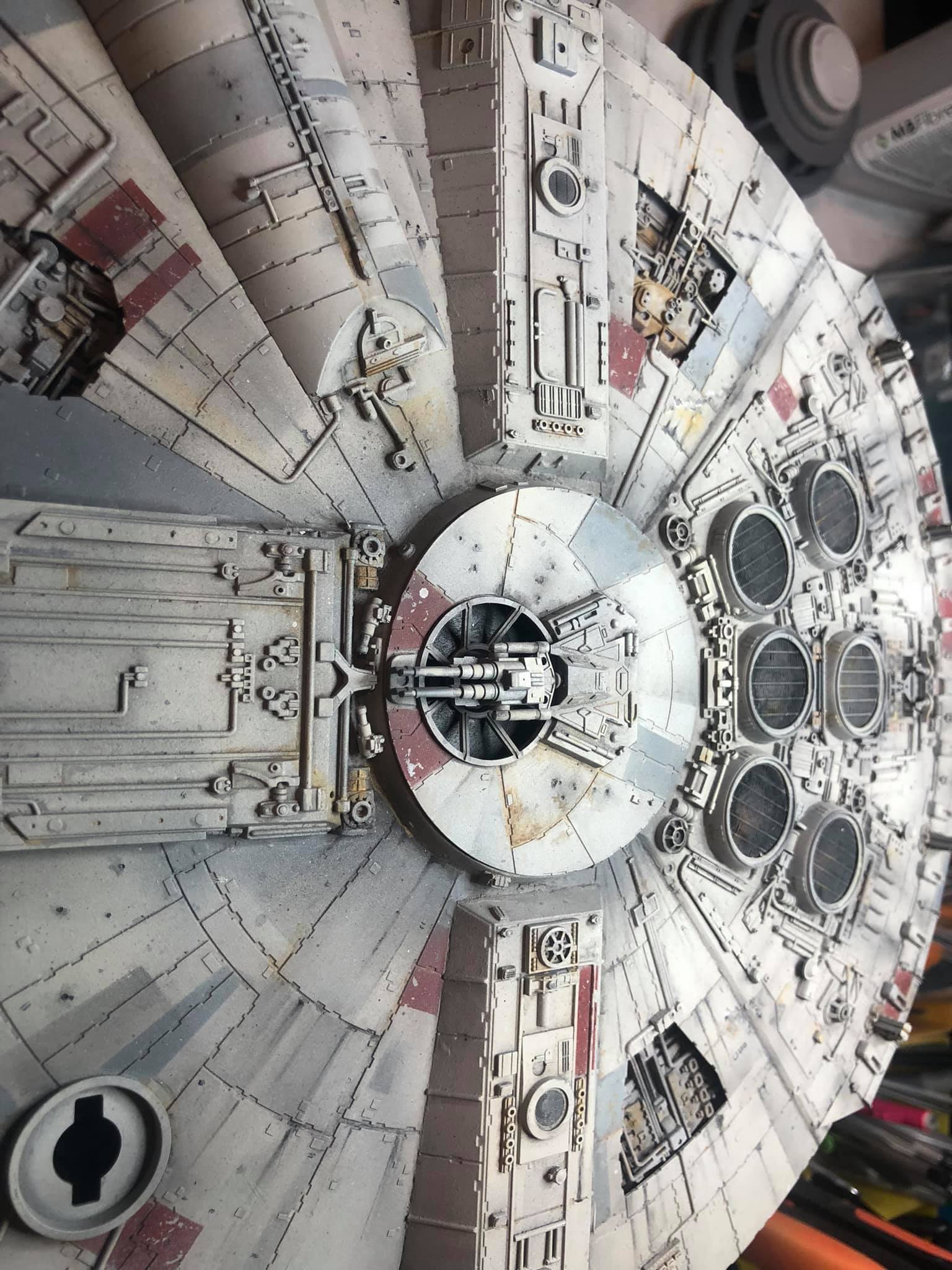

I had set aside my Bandai 1/72 for a while since I am was disappointed as well, but I think this thread may have renewed my resolve to give it another crack and finally finish it up. I'd much rather be where yours ( starks ) is at.
Where my head is at...I feel like the weathering is just too light and my panels as well just don't feel blended in
Plus I do not think I got the base color. That is another thing I struggle with. It just feels to "white"

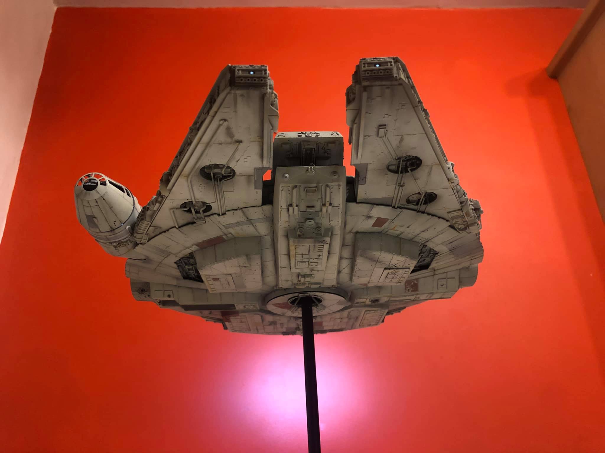

The other thing that comes into play with ILM stuff is light.
For example the pic above has no string light source and kind of highlights the flaws or weak weathering, in addition many of those greeblie details just get lost
Add a strong directional light source that cast shadows and all of a sudden it seems to come alive.
Unfortunately this is the look I am painting for, but without requiring shining a "spotlight" on the display case to achieve :lol:
and replacing the background even further enhances the effect
That's looking great! I think your Falcon is the polar opposite of mine. Mine definitely seems to need the colours toning down. Where as yours the colour seems good. I don't think it's too white (as some of the falcon panels are) but I see it needing to have more of the panels picked out and weathered. for example:

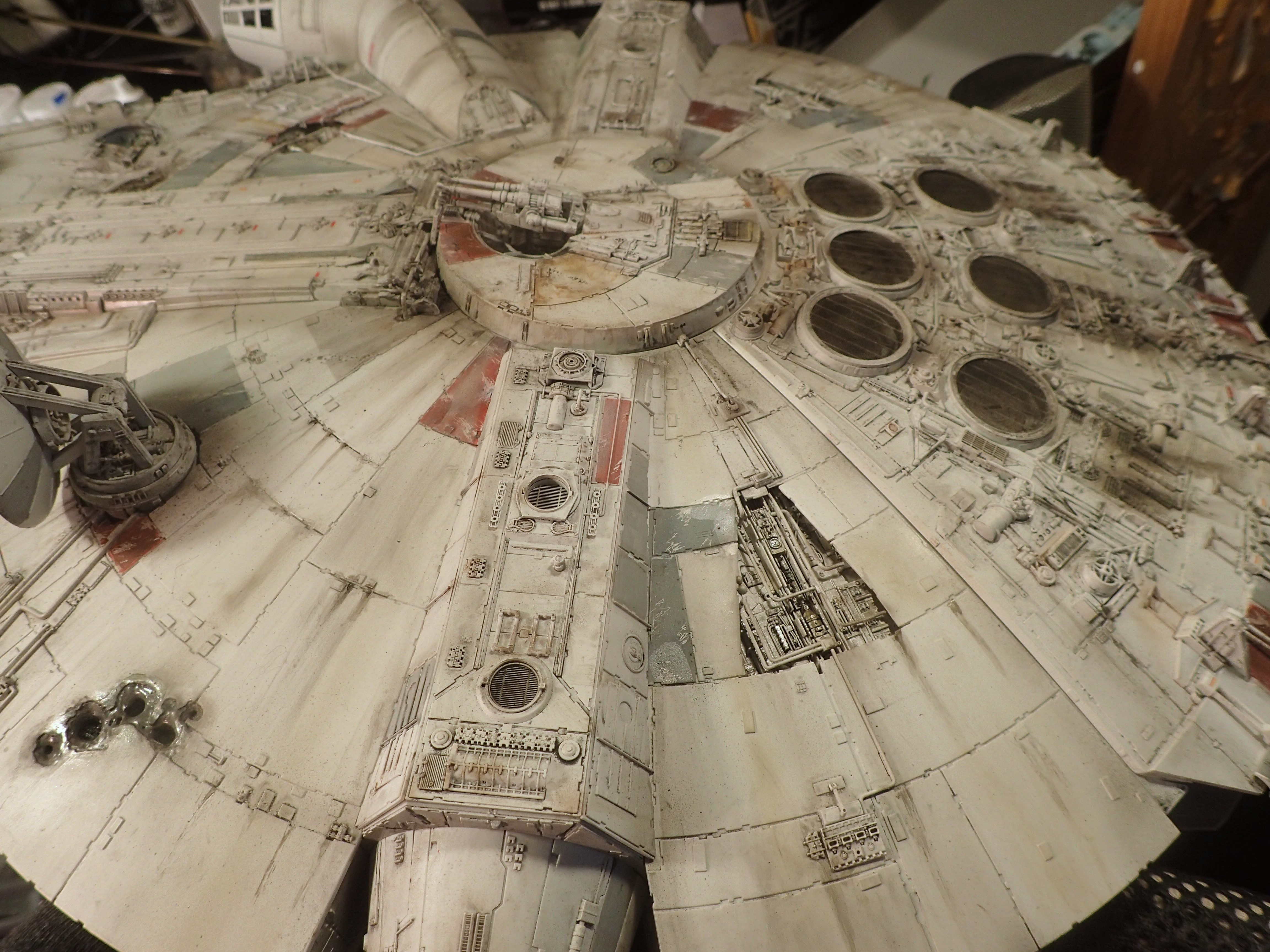

Take this closeup of your Falcon, it is quite white all over. Now:
You can see all the panels picked out. That bottom row, half is a darker grey, the other half is yellow. The panels above those are white again.
Then the next row again you can see a yellowed panel next to the grey.
I think masking out some panels and just doing a thin wash would just bump the colour in those directions and give it that less white overall look.

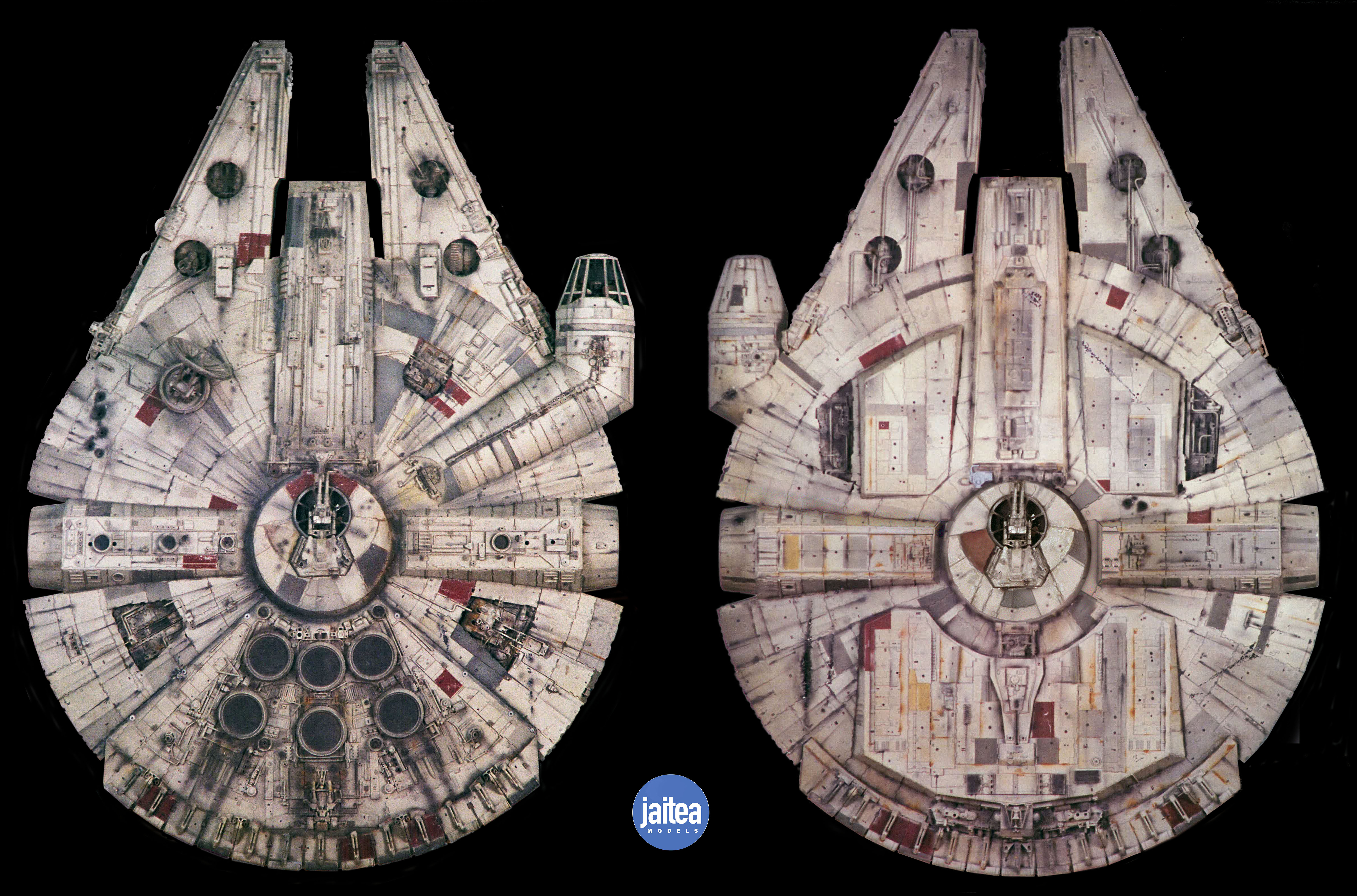

Don't know if this helps, as you know the FineMolds model is their representation of the smaller model built for 'Empire' to do more dynamic shots, The image Kramstar posted is of course the Bible Falcon, the original bigger model made for 'SW' which is a lot paler, here's a photoshopped image of the 32" top & bottom from the Chronicles book....(photoshopping out the support arm on the underside image)
I honestly don't think you need to do anything more to your model, it is a beautiful piece
J
Thank you for posting that up! That is a fantastic reference. I'm thinking those colours may have been enhanced somewhat in the printing process. It is hard to make fresh ink look faded. But it does seem that the 32" model does seem to be a bit more colourful than perhaps the 5 footer is?
Edit: I've been sitting down studying this photo and gee mines close. With the exception of the yellow which I need to redo in a more pastel, the colours are very close and all the weathering and picked out panels are in the right places.
The book image still feels a bit more toned down, I suppose my paintwork looks a bit new. I think if I can fade out the colours on there a bit Im well on the way....
Once again Very kind of you to share these photos. The weathering is so much heavier than I had actually realised. And looking at the coloured panels they do appear (at least by the photo) like they have a light grey? overspray over them.
But I am feeling I really need to tone mine down a bit. I don't think I need to start over but a definite washing out will help I think.

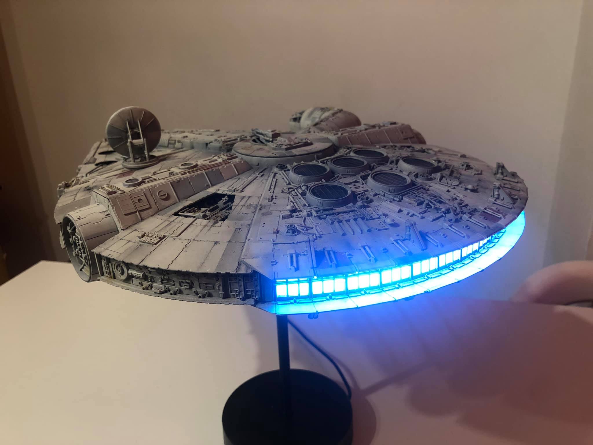

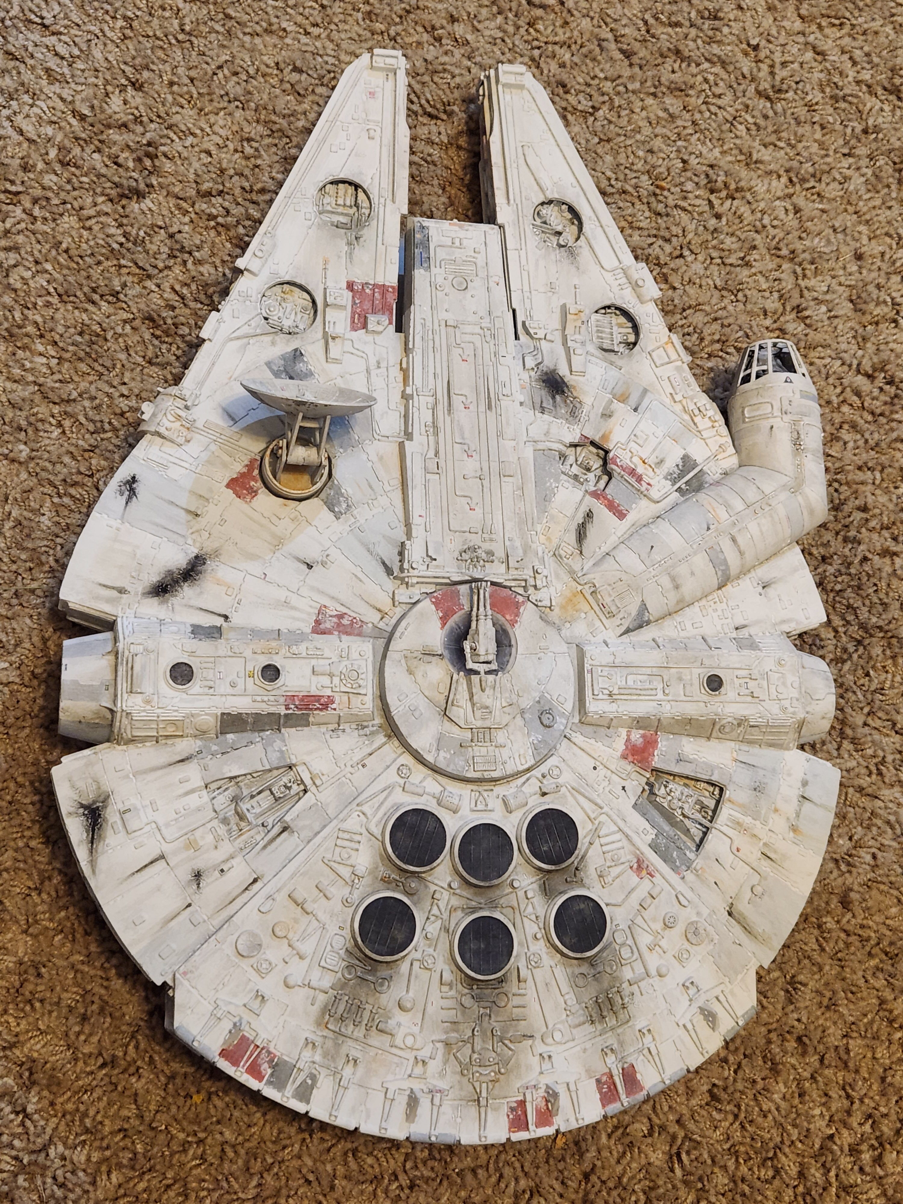

I think it looks pretty good.
I have this older MPC model that's got a ton of issues, but a year and a half ago, fixed up some parts, but mainly, did my best to paint it like the 5 footer and keep it lighter in color. After spraying the base color, everything else was hand painted.
I went in quite intimidated, but was glad it turned out pretty good.

Yep. I originally got this from a girlfriend back in 2009.....when I still had all my hair and none was gray yet....lol.
Definitely a decent kit for the time.

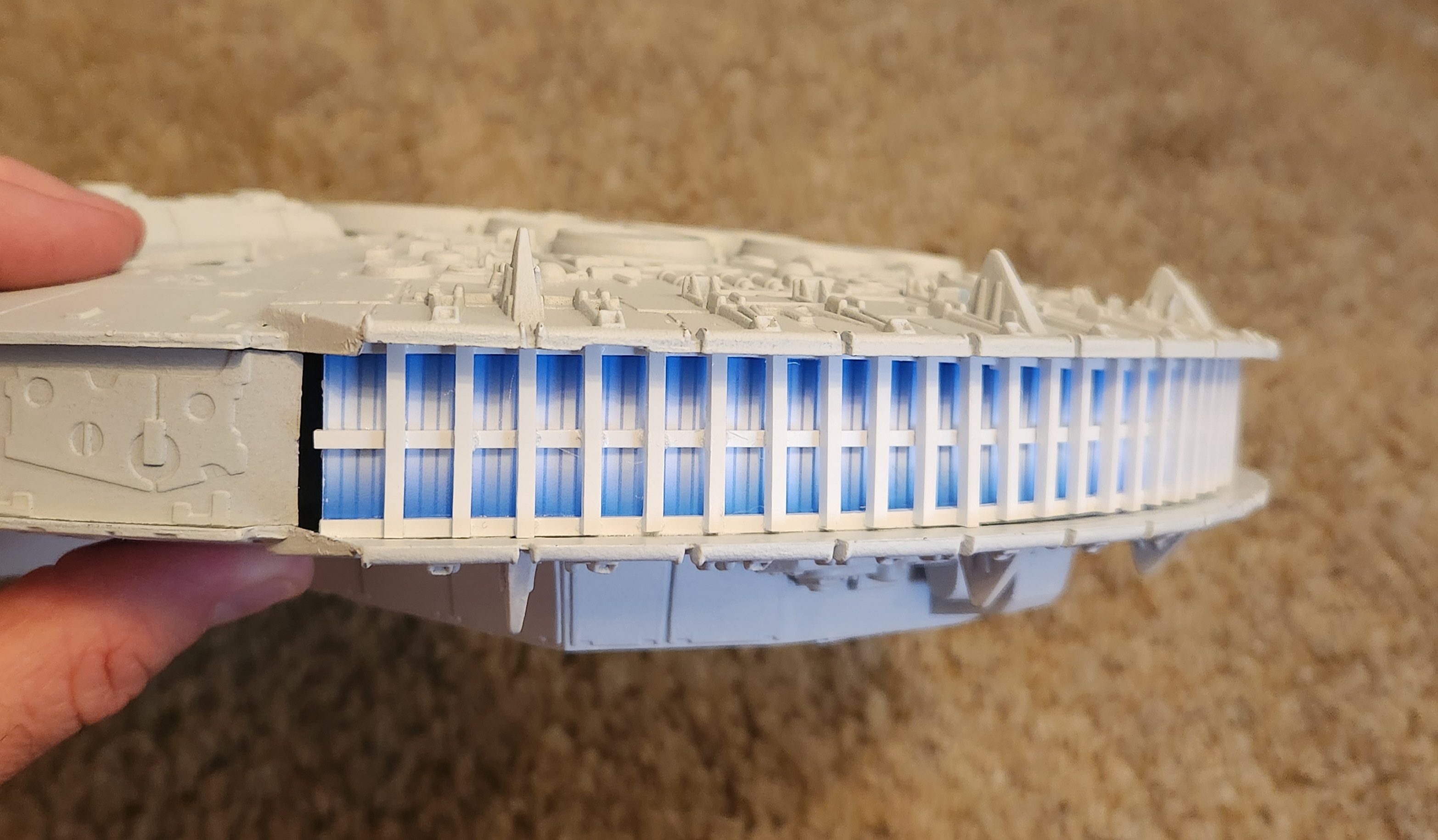

So the back end had this clear part, that I had originally painted like this. The paint job I did back then wasn't great, and why I totally redid it.
I too the whole thing apart, and actually ended up breaking this back piece....
So I just scratch built a new back for it, and had to make it all fit best I could, and then cover the gaps on the sides.
The glowing part was made up in photoshop and printed on photopaper. Wasn't sure if it was going to work out or not, but it totally did in the end.
Great catch! Definitely need more subtle panel variation as well as streaking as well

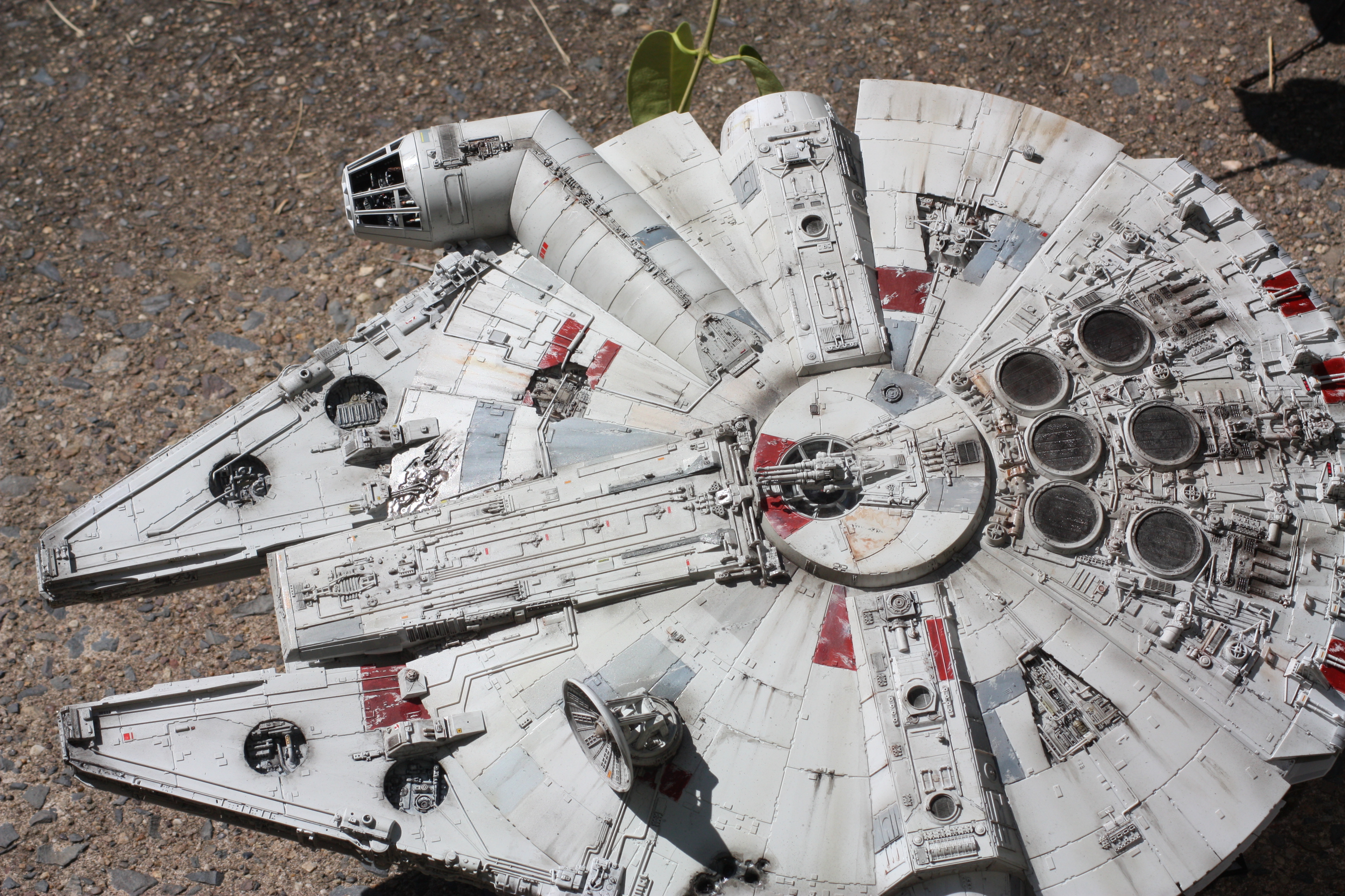

Here's my old FM 72 that I modified a few years ago,.....painting looks a bit off to me now, knowing I could do better
J
Always fun to see how everyone else tackles their Falcon and any issues they run into it.
That's the one!
You did well scratch building the rear panel. I think the print worked out great.
View attachment 1902905View attachment 1902906View attachment 1902907View attachment 1902908View attachment 1902909
J
Good grief, if mine looked like that we wouldn't be having this conversation. That's pretty much perfect!

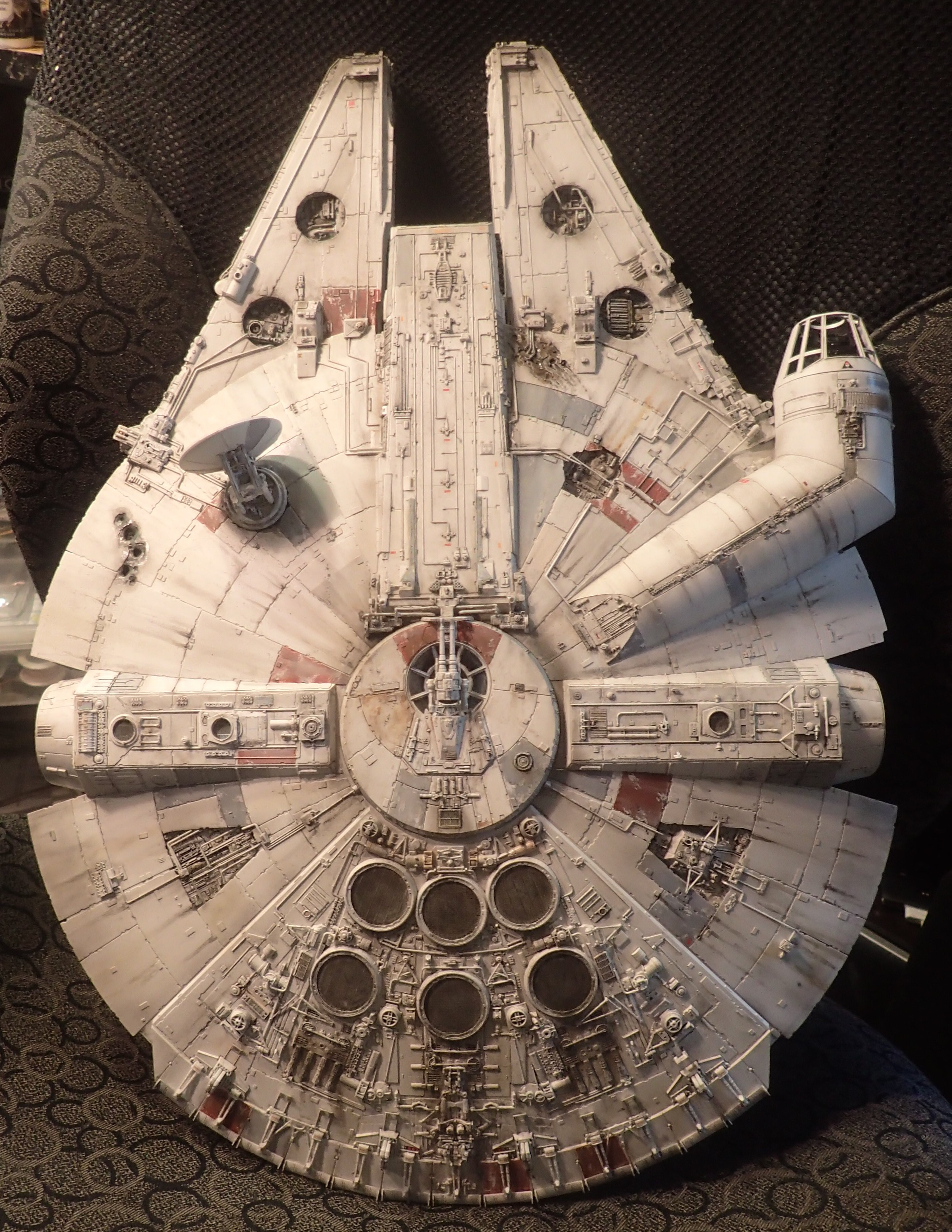

armed with renewed vigor and suggestions on what to fix, I did some additional weathering passes. Still some more to refine, but I feel better now
View attachment 1903012View attachment 1903013View attachment 1903011
Yeah fantastic! That's a huge improvement. It's subtle but your brain percieves what you're seeing totally differently. Make sure to continue posting your progress :)
With the weathering powders you may be onto something.
I have some Abteilung 502 railroad powders here. Ones a burnt rusty colour. Yesterday I mixed like a light grey water and did a thin spray over the falcon. The thing that sucks to me is now it looks like it has a think light filter over the coloured panels and doesn't look right haha. It's the same percieved issue I had on my first paintjob. But am thinking I'll remask the red panels and give them a treatment with the powder.
Thanks for those images! Really great to see!
At risk of hijacking this discussion, you wouldn’t happen to have any shots showing the interiors of the lower two pits, would you? I haven’t seen any shots that show all the insides clearly.
And tying this loosely back to the original topic of painting, for some reason some folks seem to paint all their Falcon pits black or dark grey, which looks very weird since the original models didn’t look like that at all. :)
