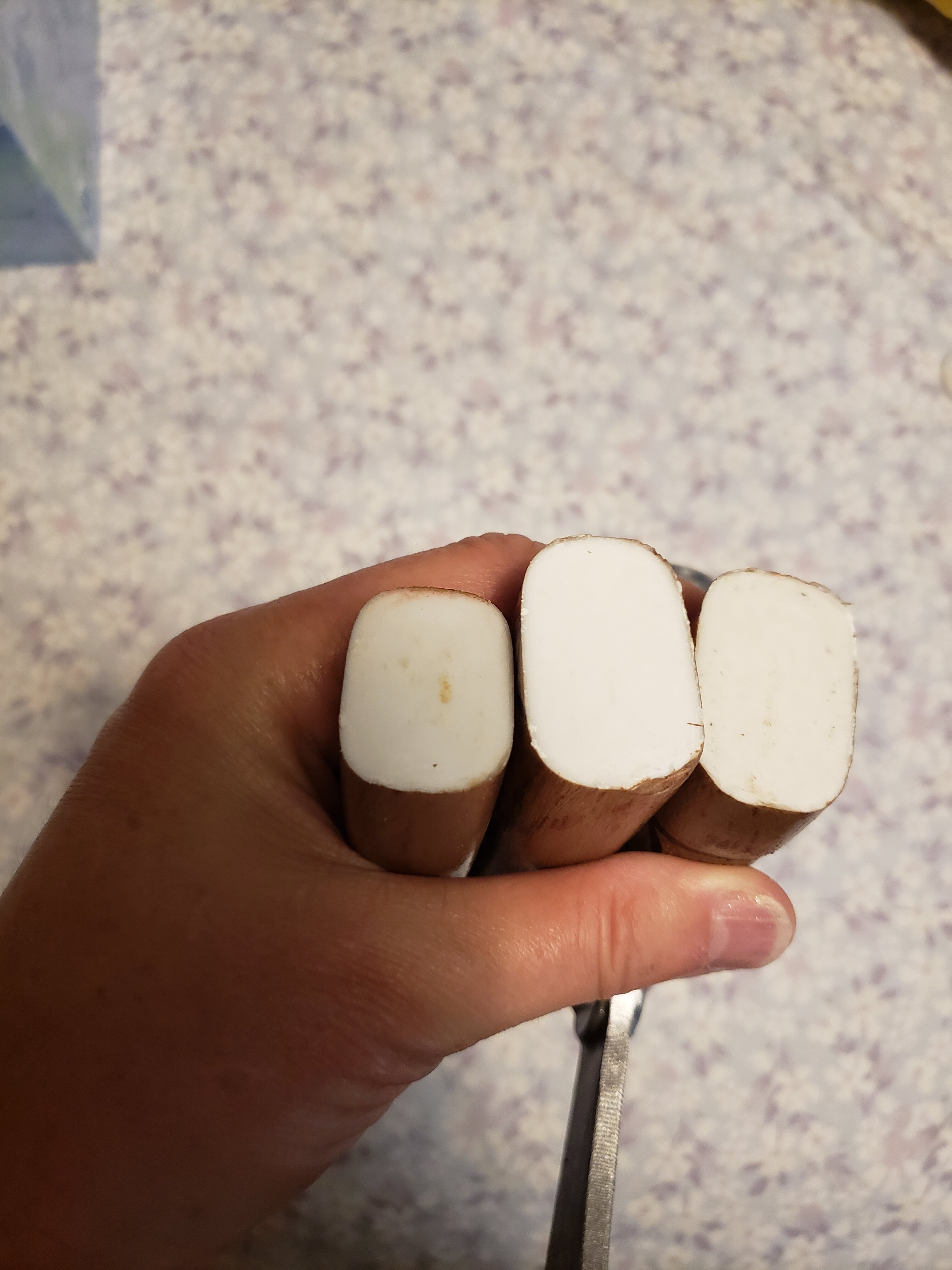

Although not professional guidance, this is simply a product review. I have had solid success with superglue when connecting 3d printed PLA filament parts. I often use baking soda as my filler if there is not a perfect match between two parts.
However, I have had NO SUCCESS using gel superglue as though it simply will not make adhesion with PLA. Given, I have little love for gel superglue in any project but for PLA, it simply does not bond. Like popping candy out of a candy mold after it cools, that level of non adhesion.
Here we have my Tomahawk of recent work. I had gelled the contact so I had some time to move it while lining up the parts and then taping. It held for several days while I painted several layers and today it came apart like an oreo cookie. Perfectly smooth release as though only the paint had held it together
