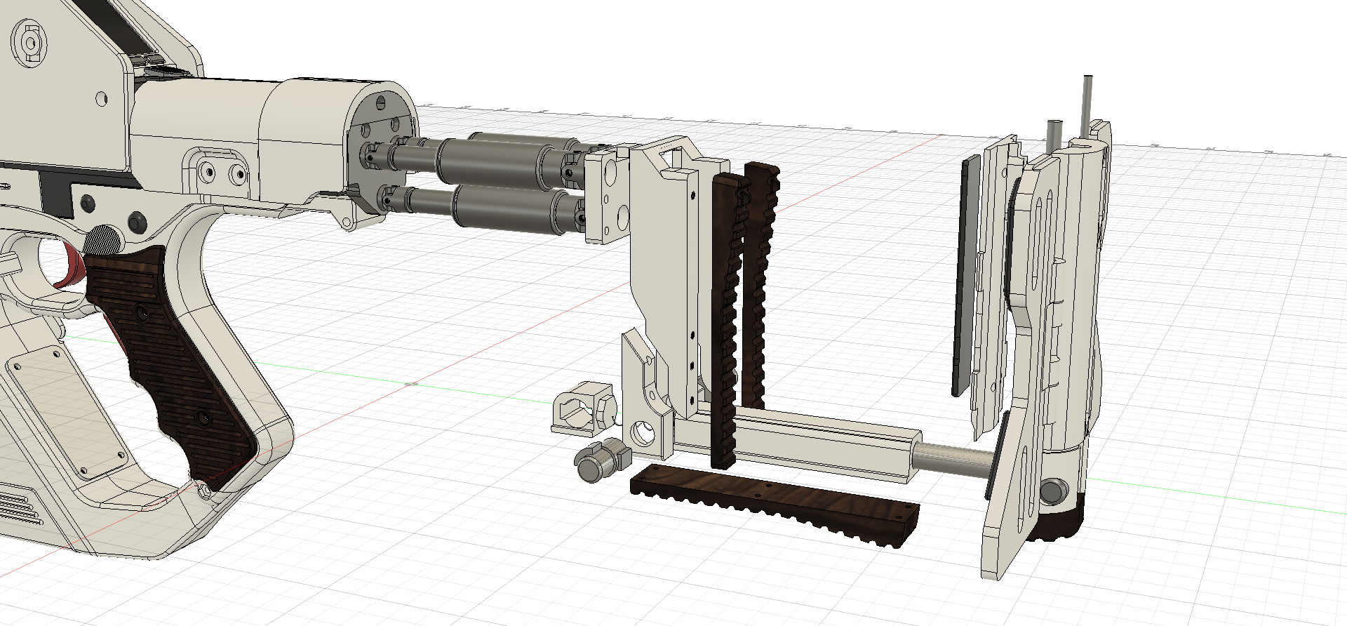

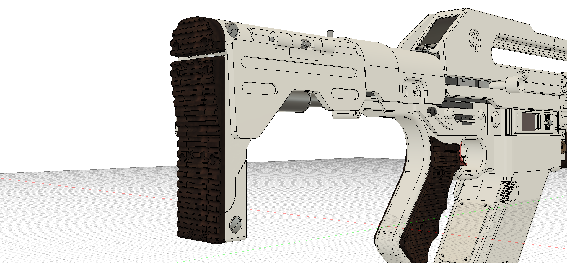

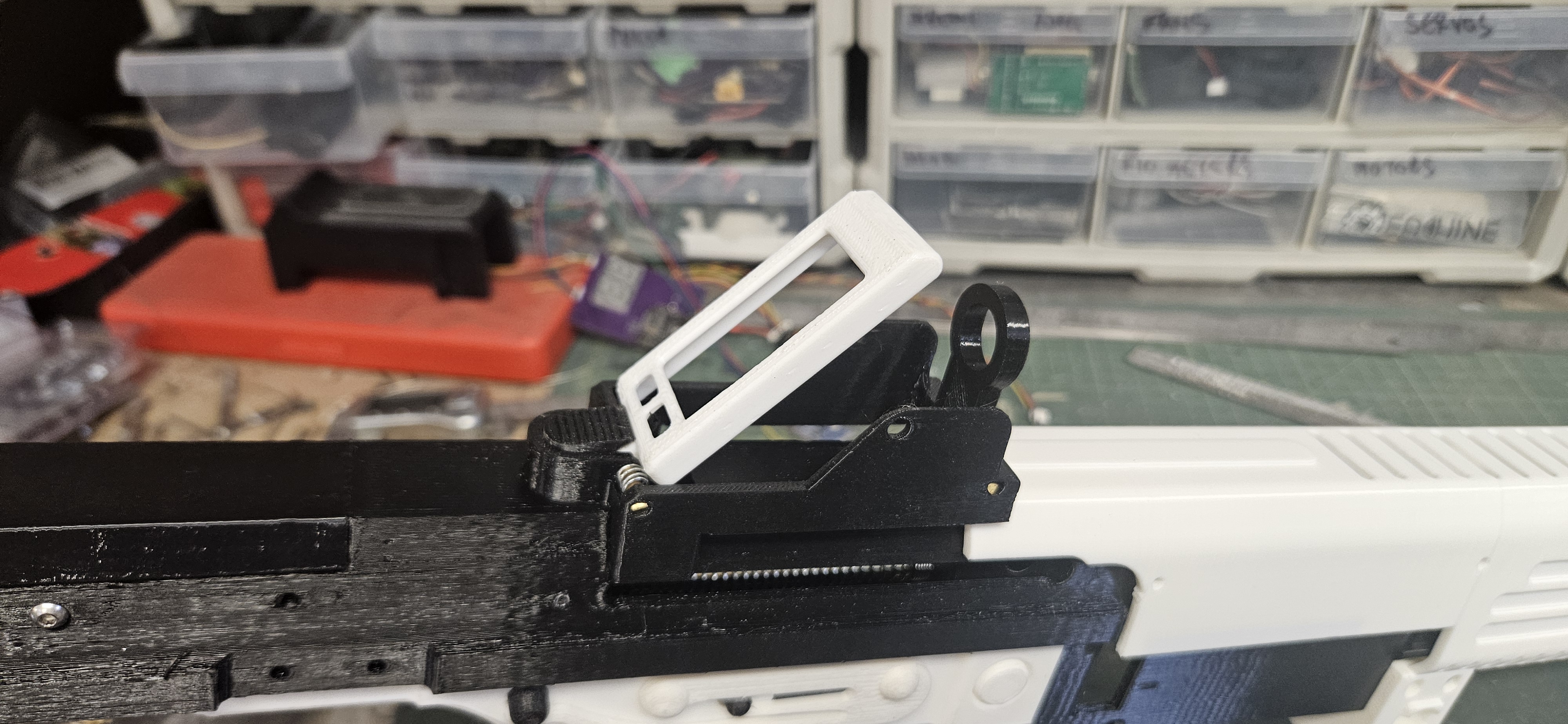

Rear stock:
i must admit this did my head in a bit. Trying to replicate the look was pretty easy, but getting the functionality of the stock was quite hard.
Unlike the Weta hero prop, i wanted the stock to be solid and not flop around, which can even be seen on screen.
The pistons bolt together with 3/16 rod and make for a strong mount. This then bolts to the rear wing assembly and matches the Weta prop.
The top assembly is spring loaded and will pop up and then the wings will open, then you can rotate the assembly 90 degrees.

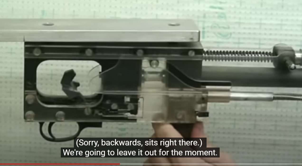

I looked around at electronic firing and movable breech designs and settled on one from a very old " forgotten weapons" clip on youtube.
I cant remember what the actual design it was from - i will find it one day ...
Anyhow caseless ammo was loaded in from mag, gas blow back moved the breech into place with the round, and set the firing pin ready to strike.
So with this design in my head ... off i go :unsure:

Rear stock:
I just watched the movie again, but did not see the flopping around of the stock. Do you mean that the stock is not locked in place when it's in closed position?
The mechanism you modeled is just insanely cool! I would never have thought of using a spring to lock it in place at the front.
Really looking forward to the finished rifle!
Cheers!
Roman
Cheers!
Roman
When they open it up, the actors are quite gentle with it and it moves around. Its subtle but noticeable. I get that it is supposed to move for the auto aim, but for my build I want a fairly solid stock that still opens, but also be strong enough to take the abuse from people that may not have the same investment in care...

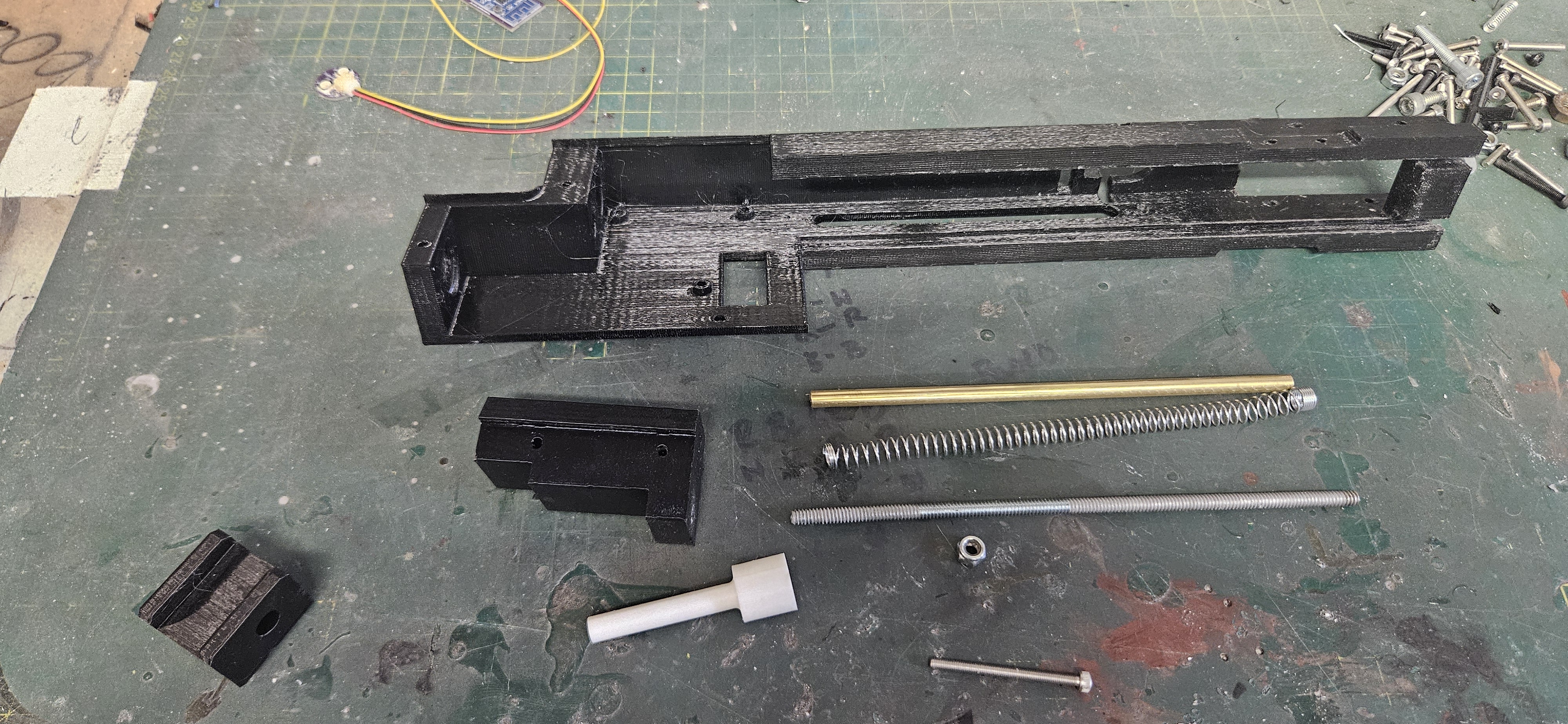

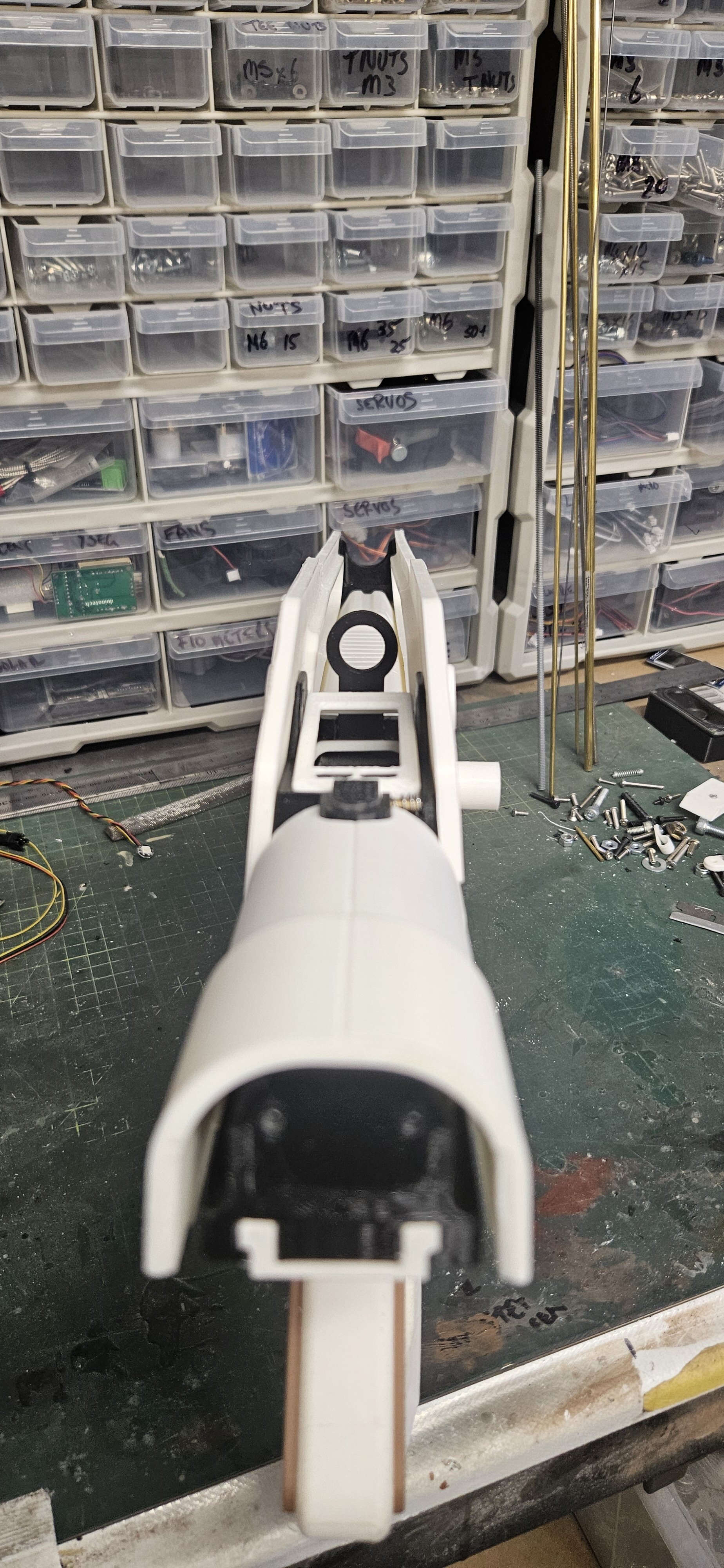

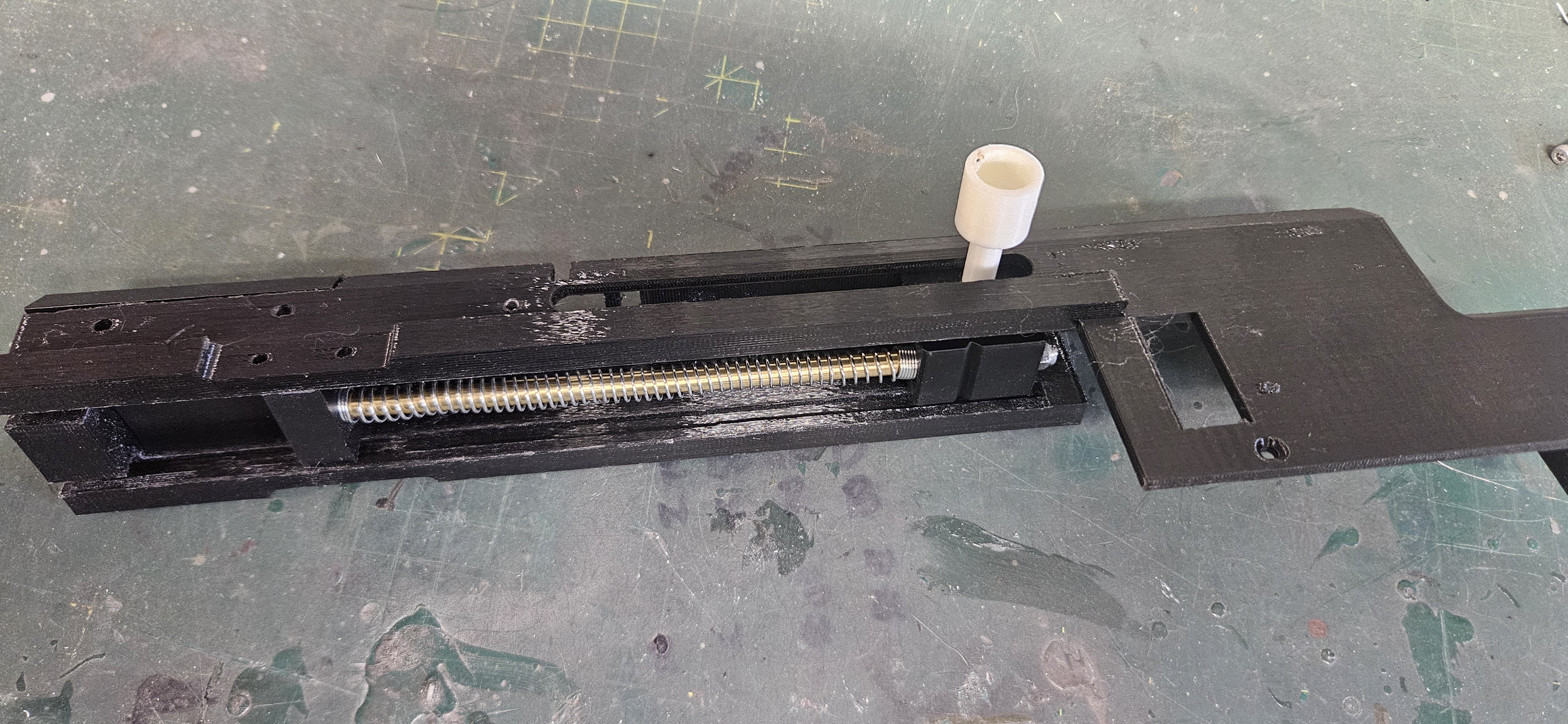

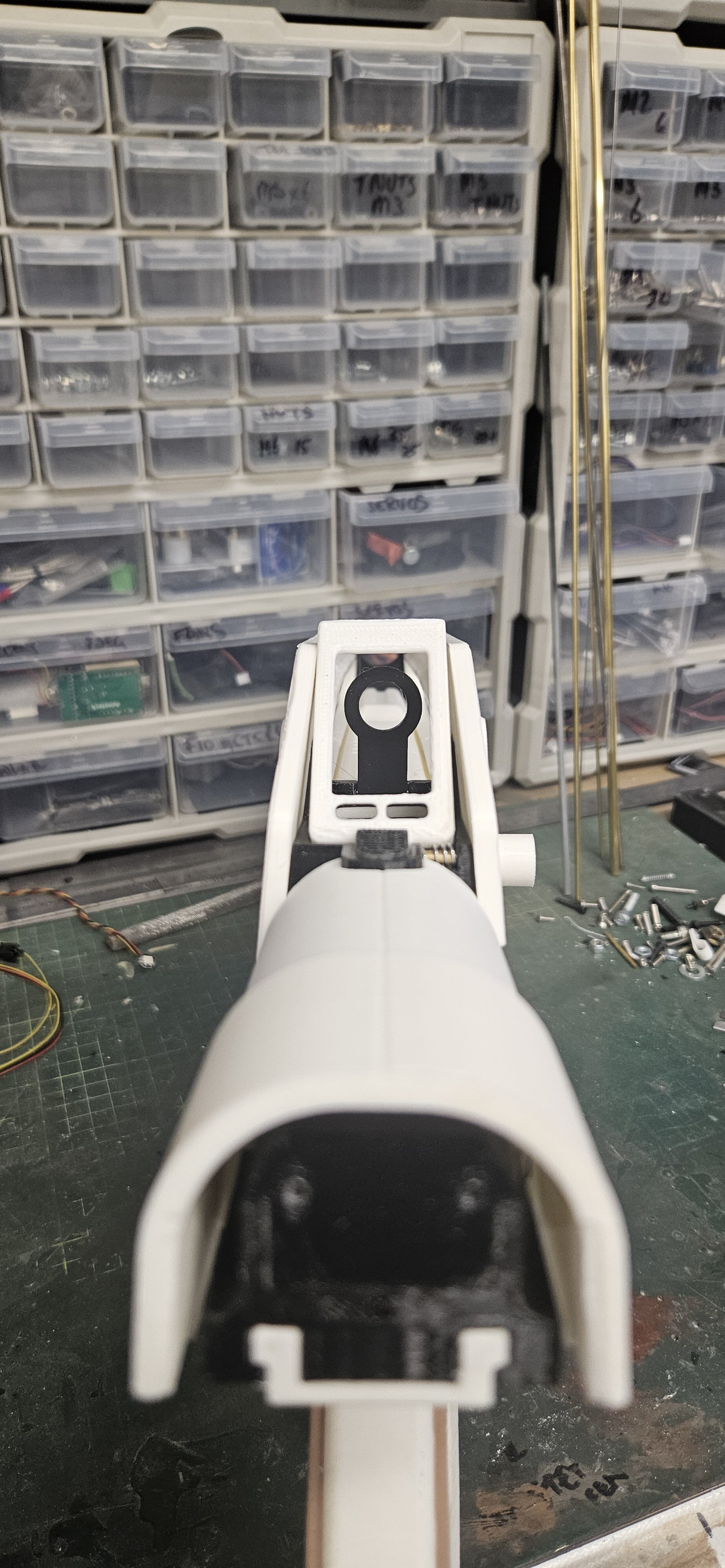

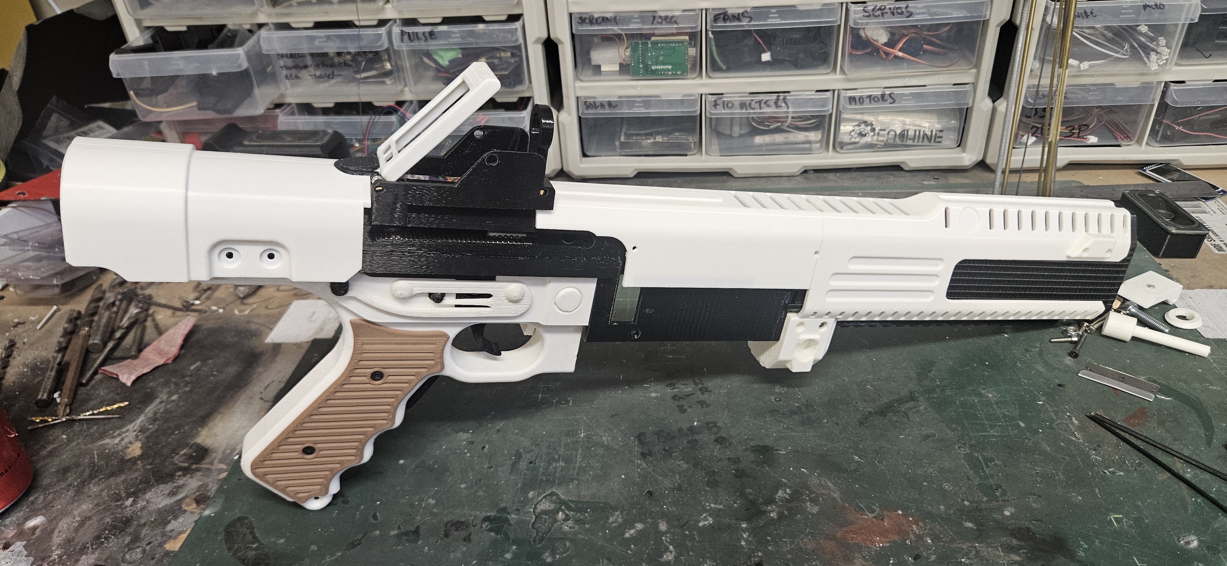

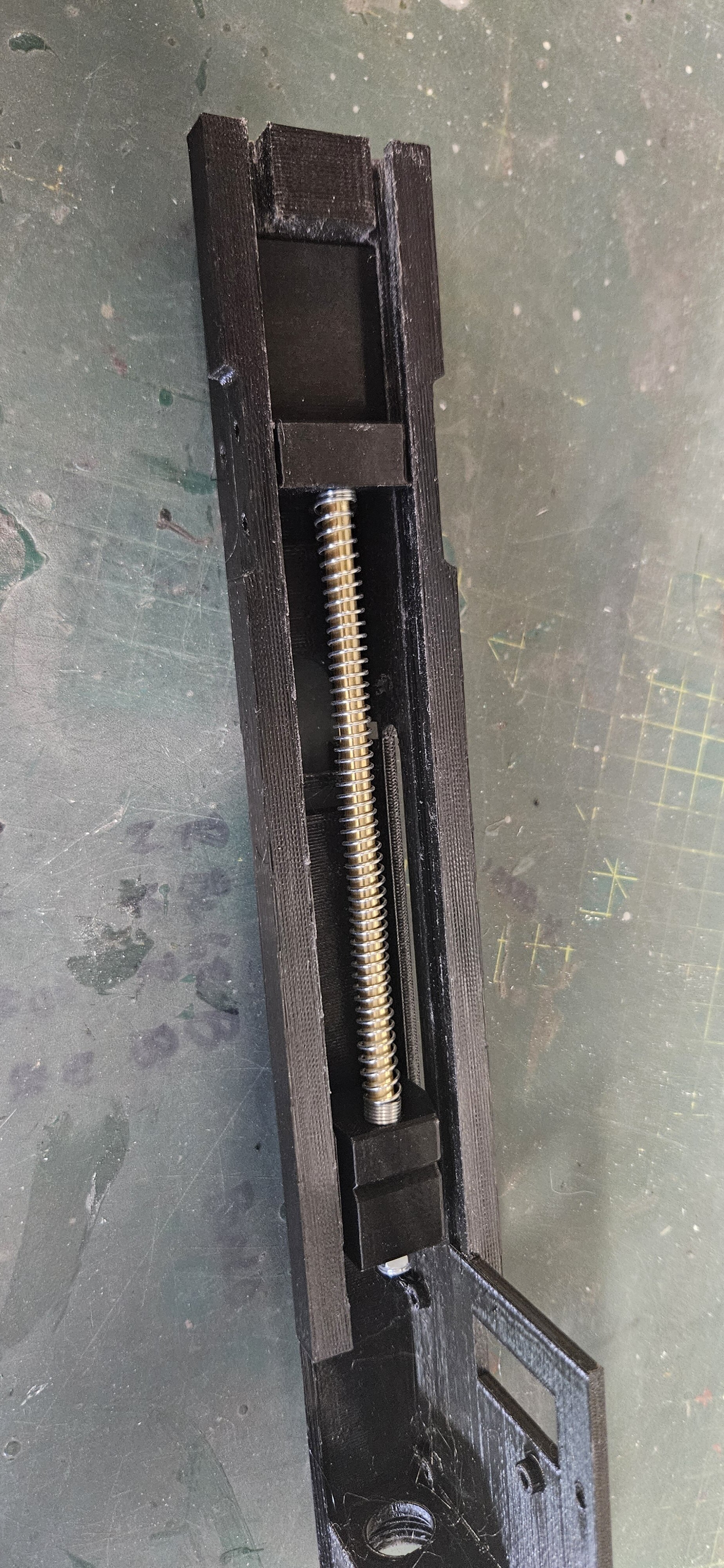

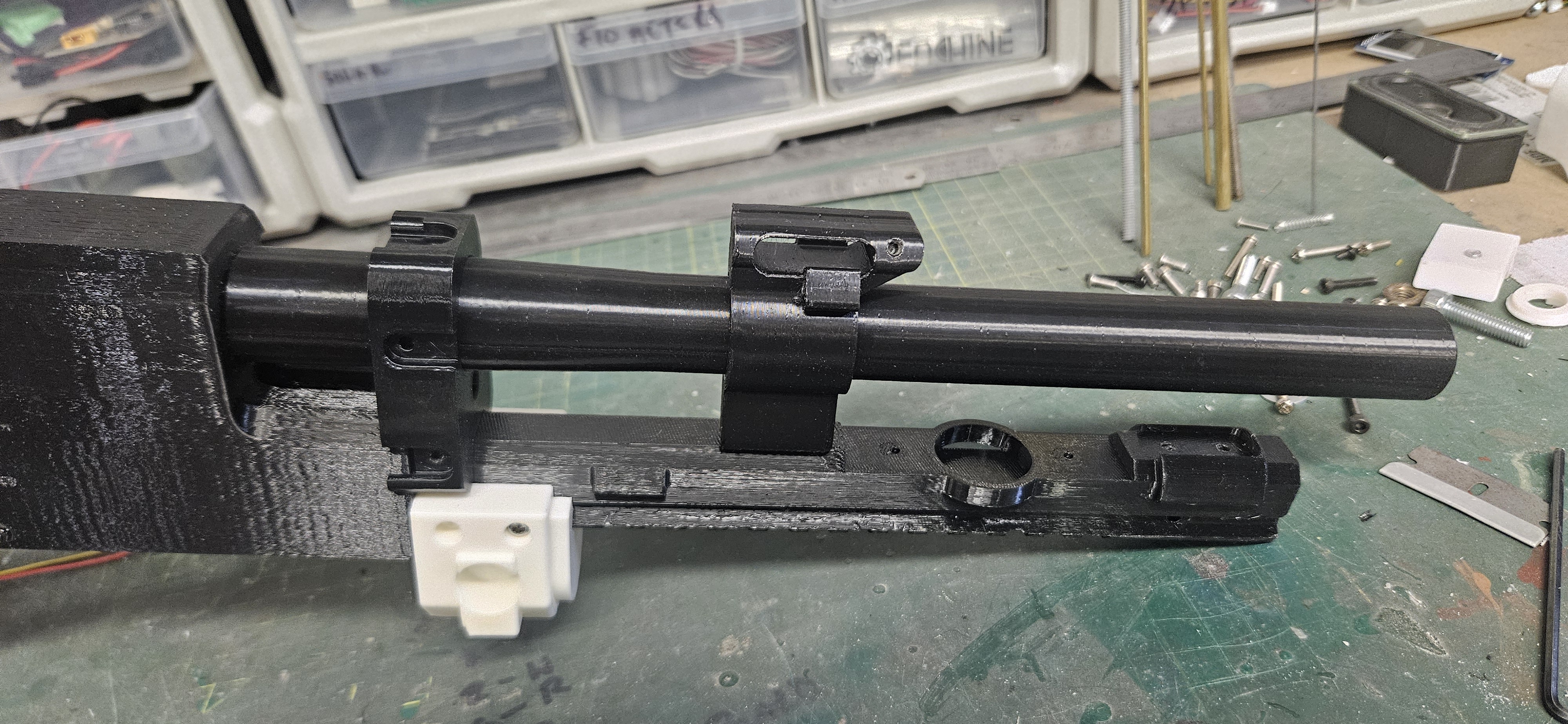

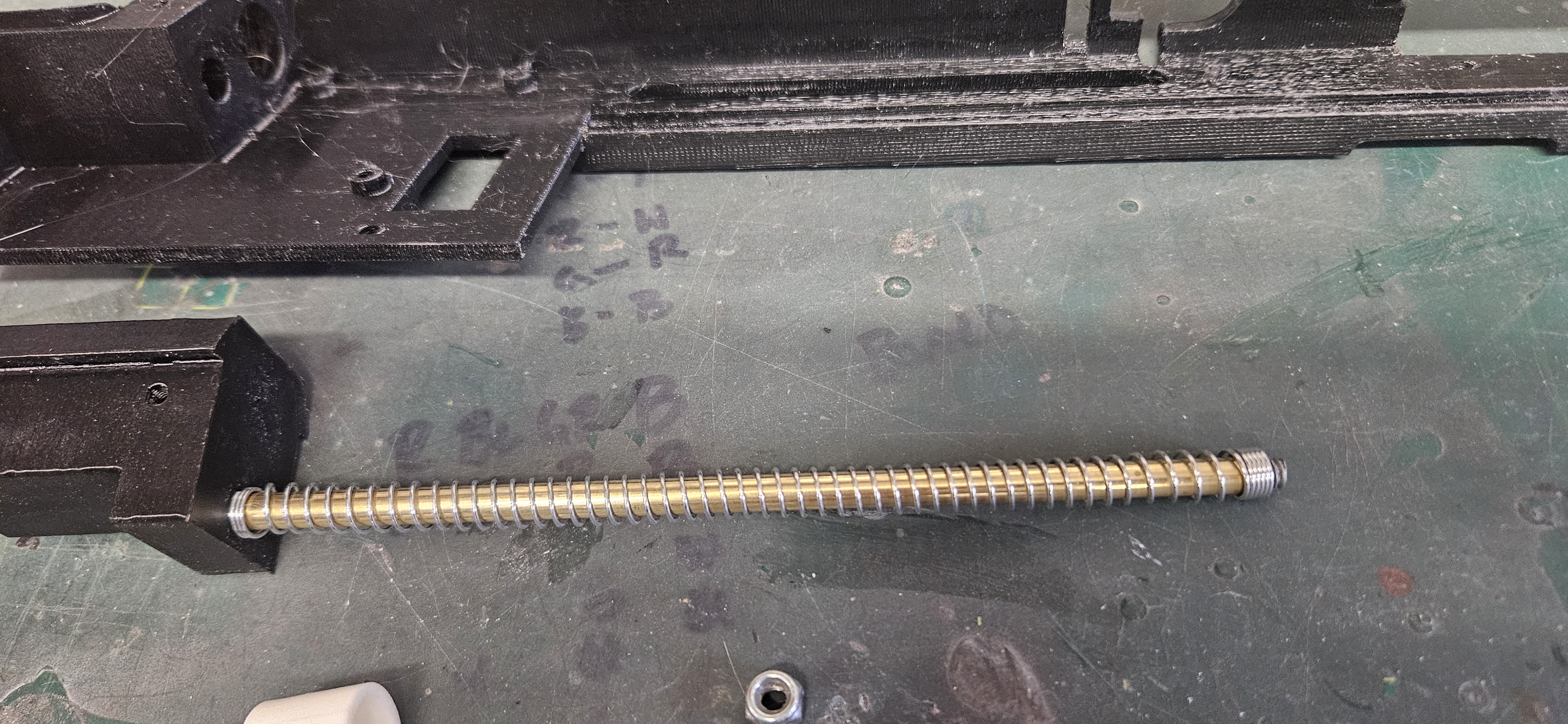

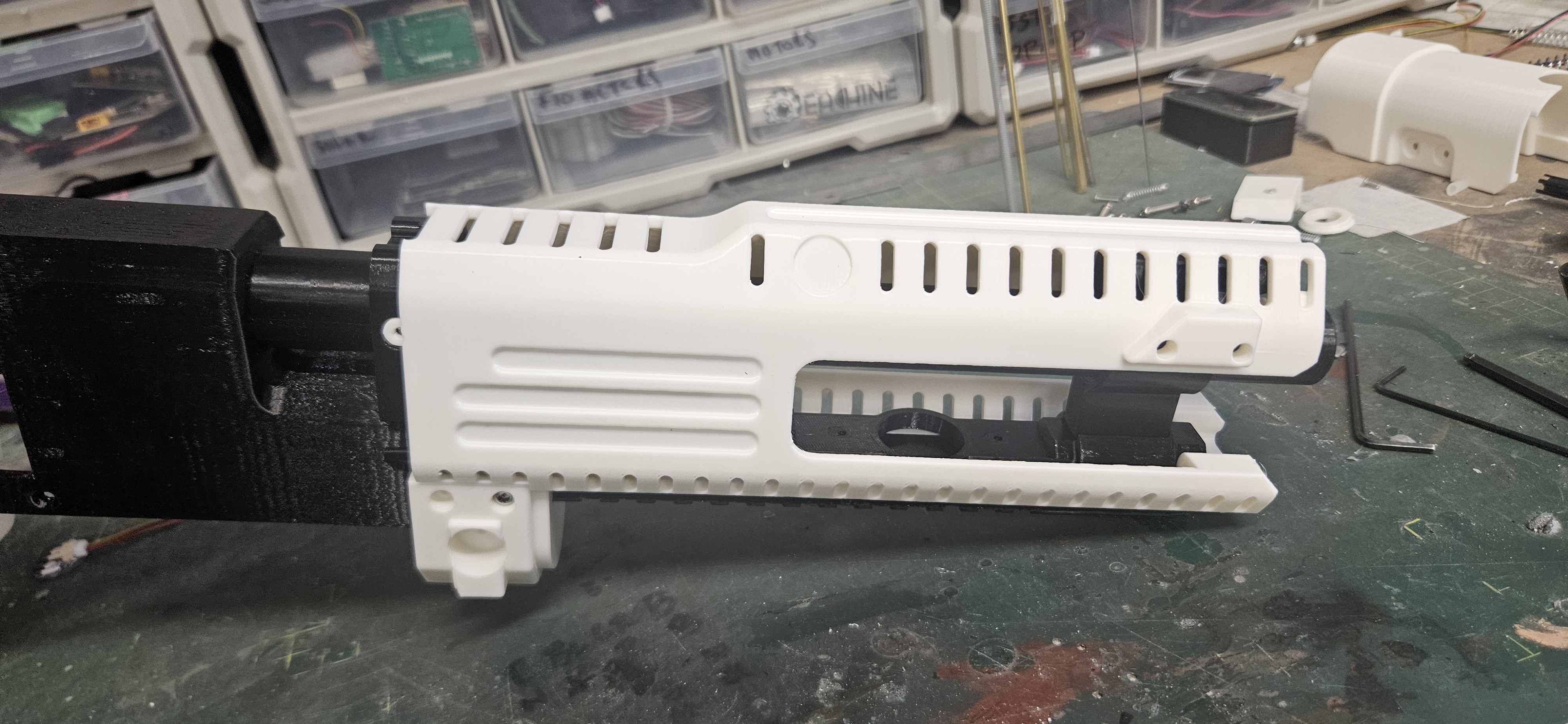

Printers have been busy:
I'm printing in ABS, PetG and PLA. Apologies for some of the prints, I was dialing my machines and had way to high retraction, the black petg is also overextruded. Anyhow first up is the upper reciever assembly. These are test assemblies to make sure everything fits. There are no electronics as yet.

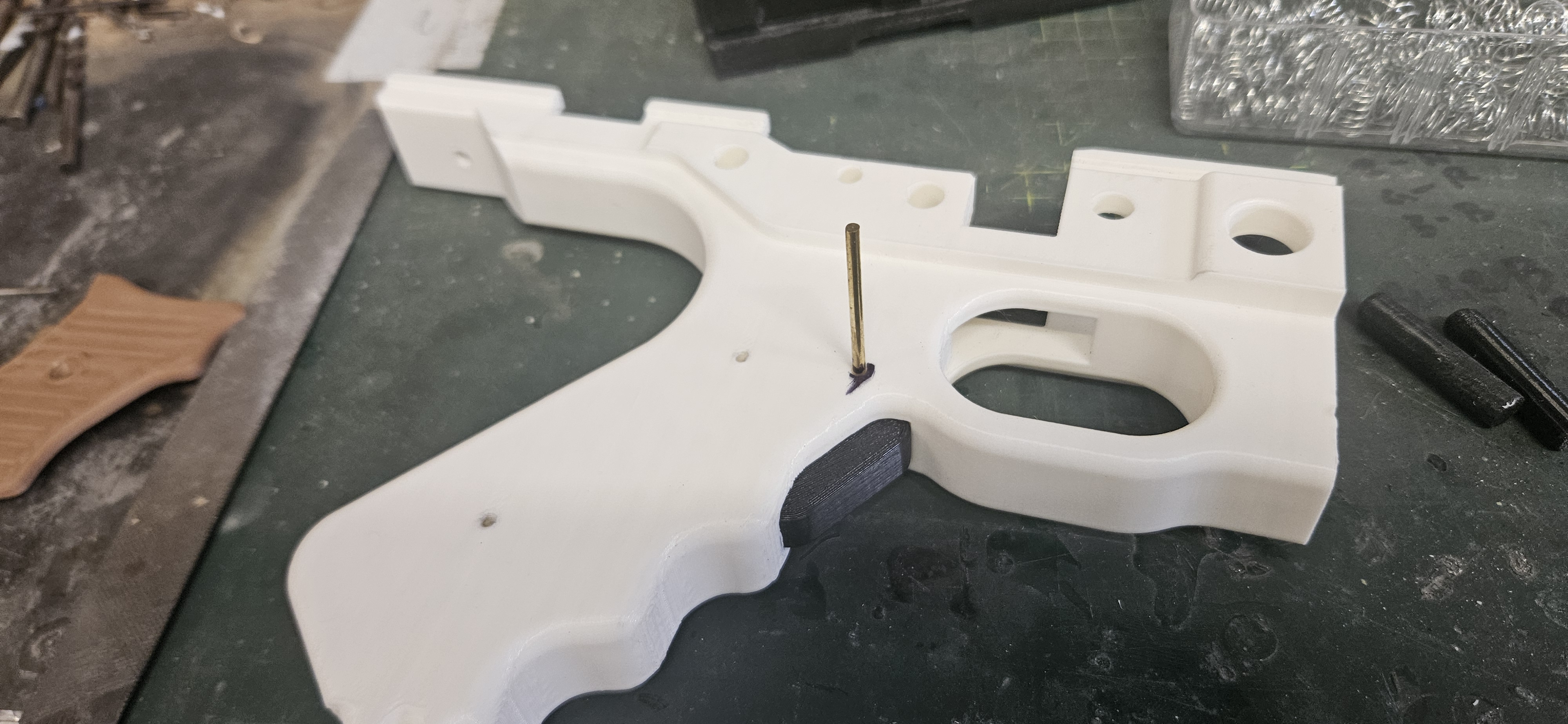

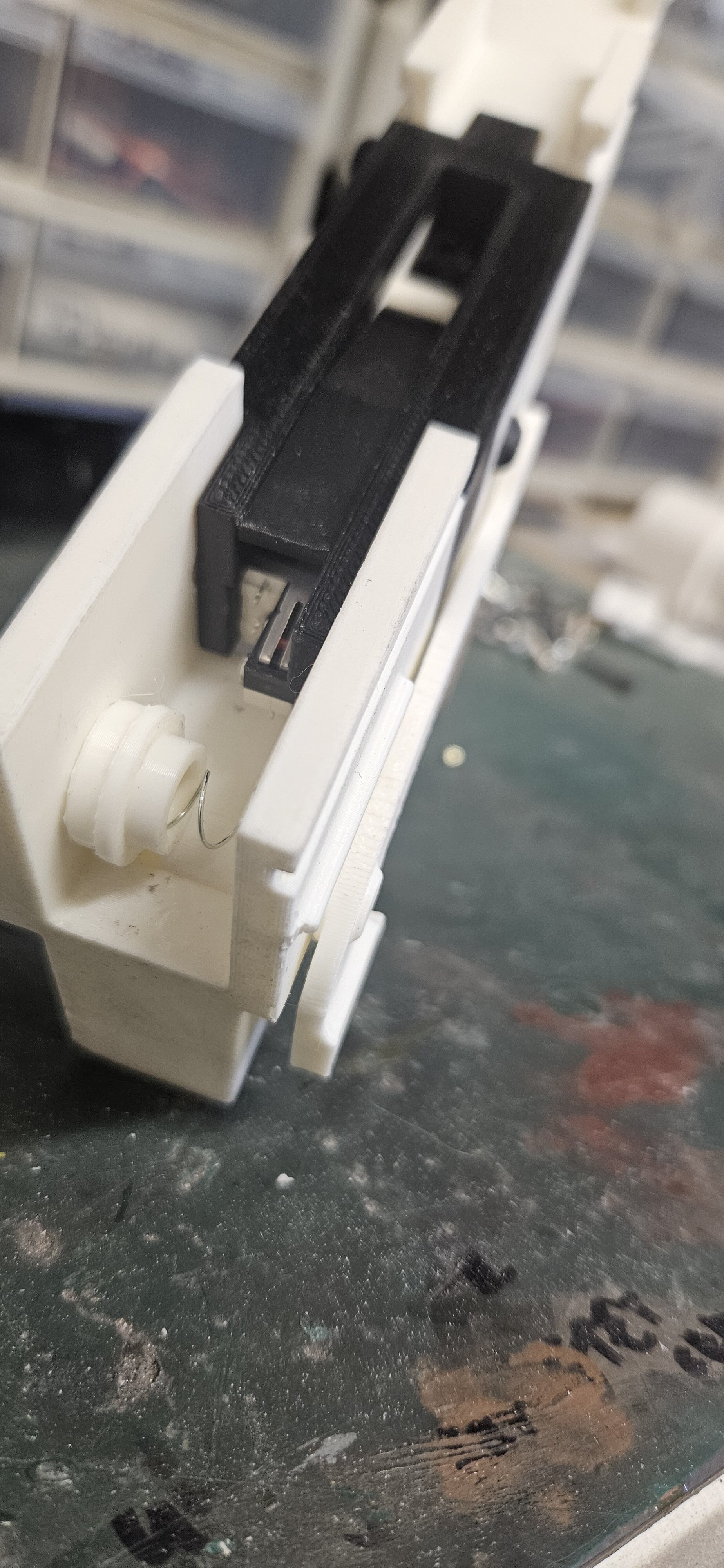

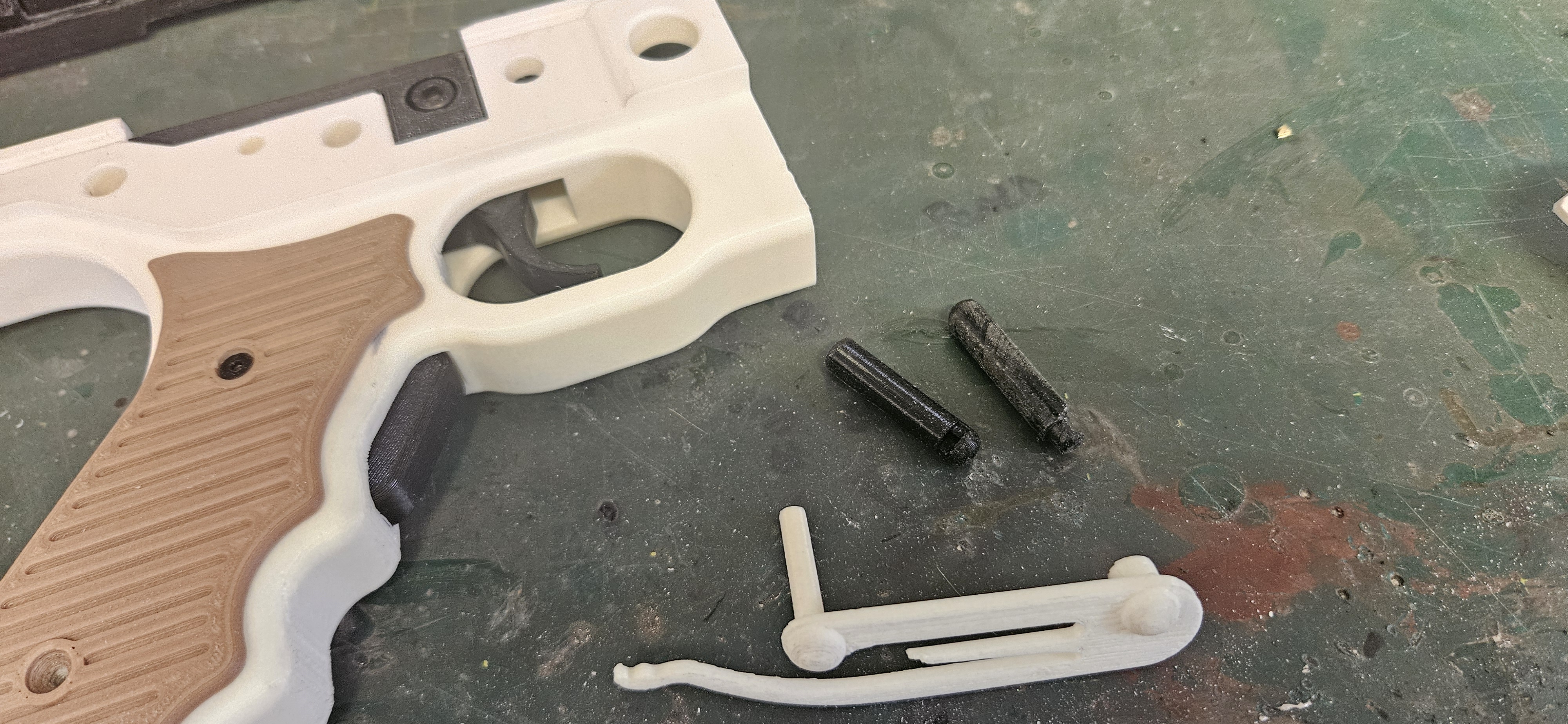

Lower receiver and trigger assembly:
I have changed a few things with the trigger. Originally I had modelled in a catch for the charge lever, but since it's not referenced in the movie and it adds quite an extra complexity to the assembly, I have left it out.
Ah, I just rewatched that scene, now I know what you mean. I thought you meant it was moving in its closed position, but you mean that once the stock is opened the rear moves around quite freely. So does that mean your stock in its opened position will not be able to move from left to right to "simulate" auto aim?
