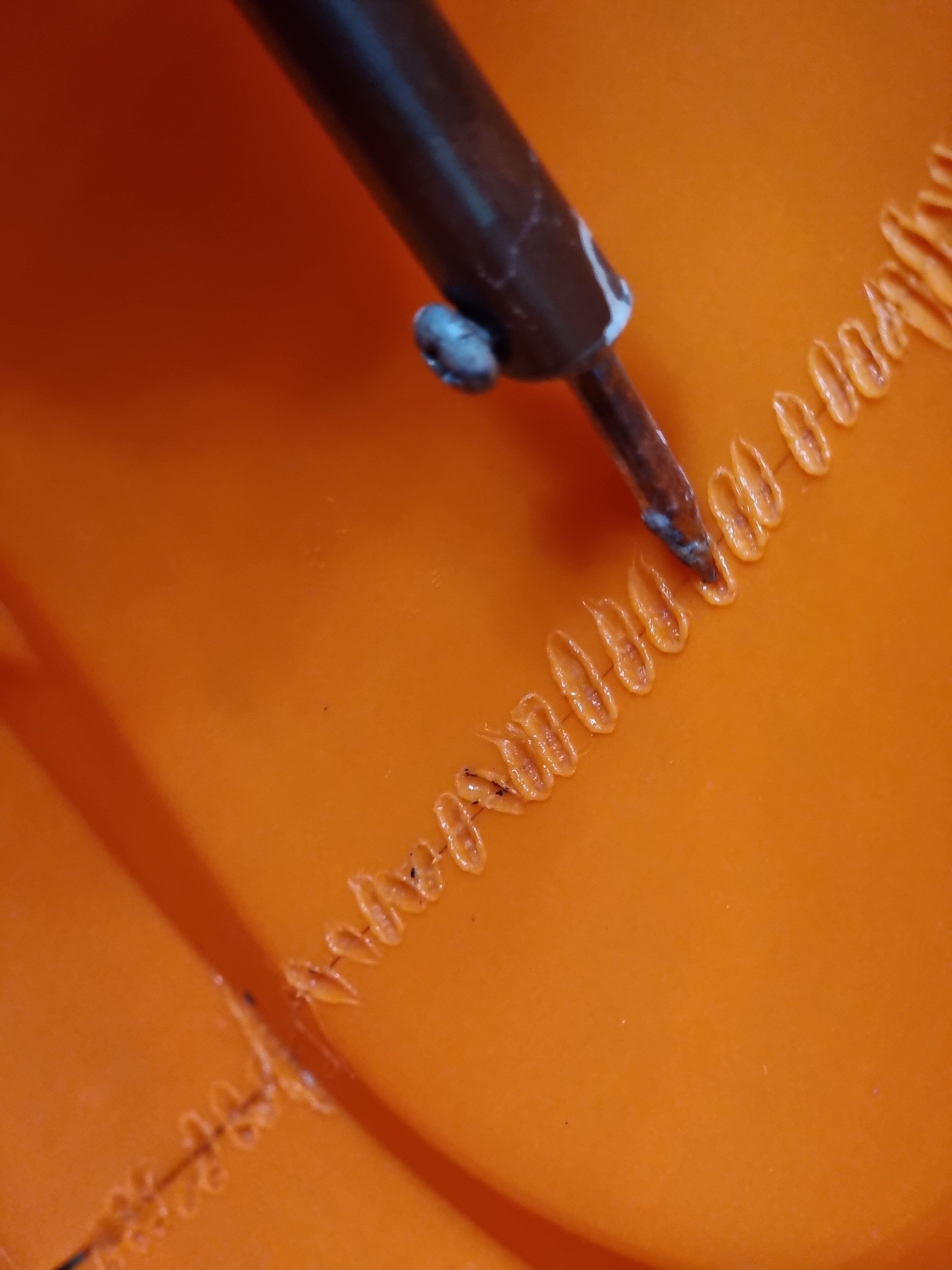

Welding PLA
I started construction on my Helmet no pun intended this afternoon.
Cynoacrylate my usually bestest bonding friend seemed to take ages to bond with PLA unlike my hands which I kid you not resembled The creature from the black lagoons webbed digits.
I started using a soldering /Sodder Iron to plas-weld the pieces together, something Ive always done repairing everything from kids toys to lawnmower boxes and all seems pretty sturdy so far. I am also going to hot melt meccano pieces as cross members into the lid for my own sanity and I will cover with a suitable interior at a later date.
Melty..
I find that for helmets and thin walled items I print, that a mechanical bond is best in addition to a glue bond. So when I design something I incorporate pin holes to accommodate thin brass pins. In addition to the mechanical joint, it also provides a way to ensure the parts being joined mate exactly the way intended. This will also lessen the amount of post processing and filler needed.

If I download items that do not have the pin holes, I tape the pieces together and scribe marks on the outside. Then use a drill to make holes. Sometimes the holes don’t mate exactly, but you can bend brass or enlarge holes to ensure that it fits. I test fit all pieces until I’m confident that when I’m ready to glue it will fit perfectly on the first try when gluing.

Now thats a great idea I shall be using this method from now on (y)
TazMan2000
That's why I tend to cut big parts apart in the slicer, it has a function to add pinholes quite easily
