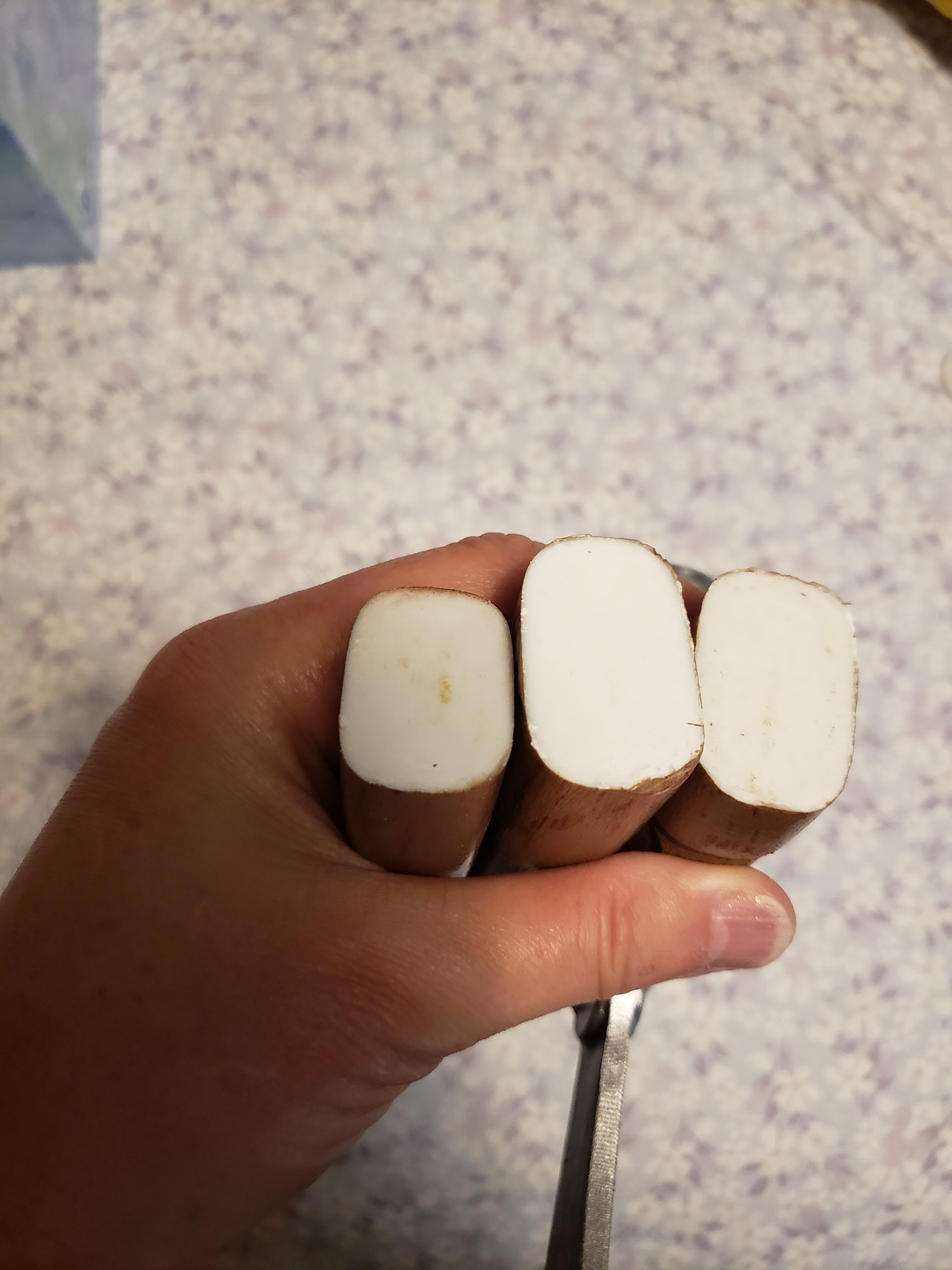

For gluing parts that aren't subject to shock/stress, I've been successful with crazy glue. I buy the one from the Dollar Store (Canada) and it never failed me. As for load/stress bearing, I use a construction adhesive: PL Fast Grab Premium (Canada). It's a gray color adhesive and once it dries, it become like hard plastic. As a matter of fact, I've poured it in silicone moulds to make small greeblies ;) I've used it to affix the legs of my Tintin rocket.
