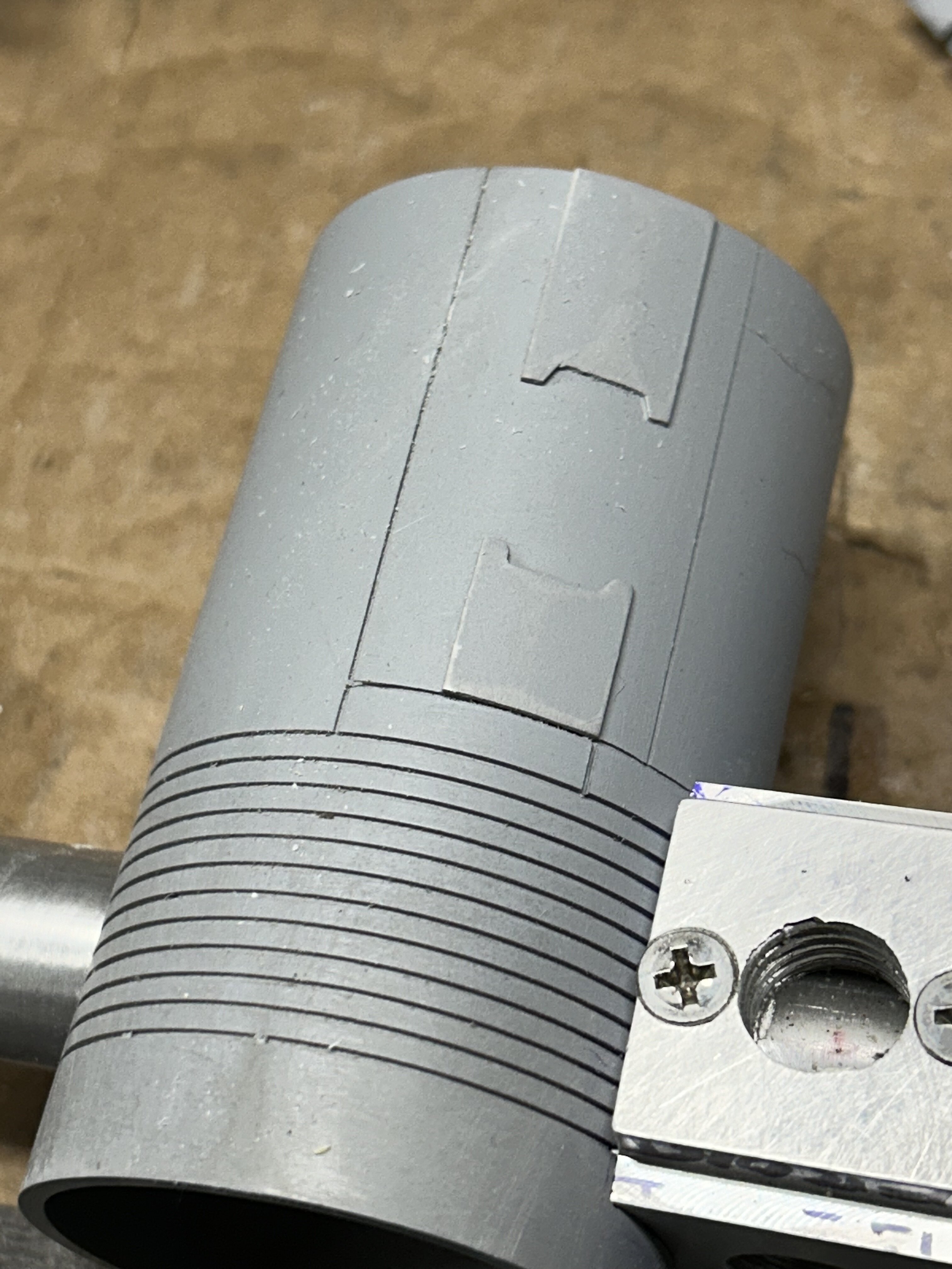

Started over with my cylinders.
Some dikum to mark the lines
After some carful cutting.
Test fitting cylinder parts and scribing next.

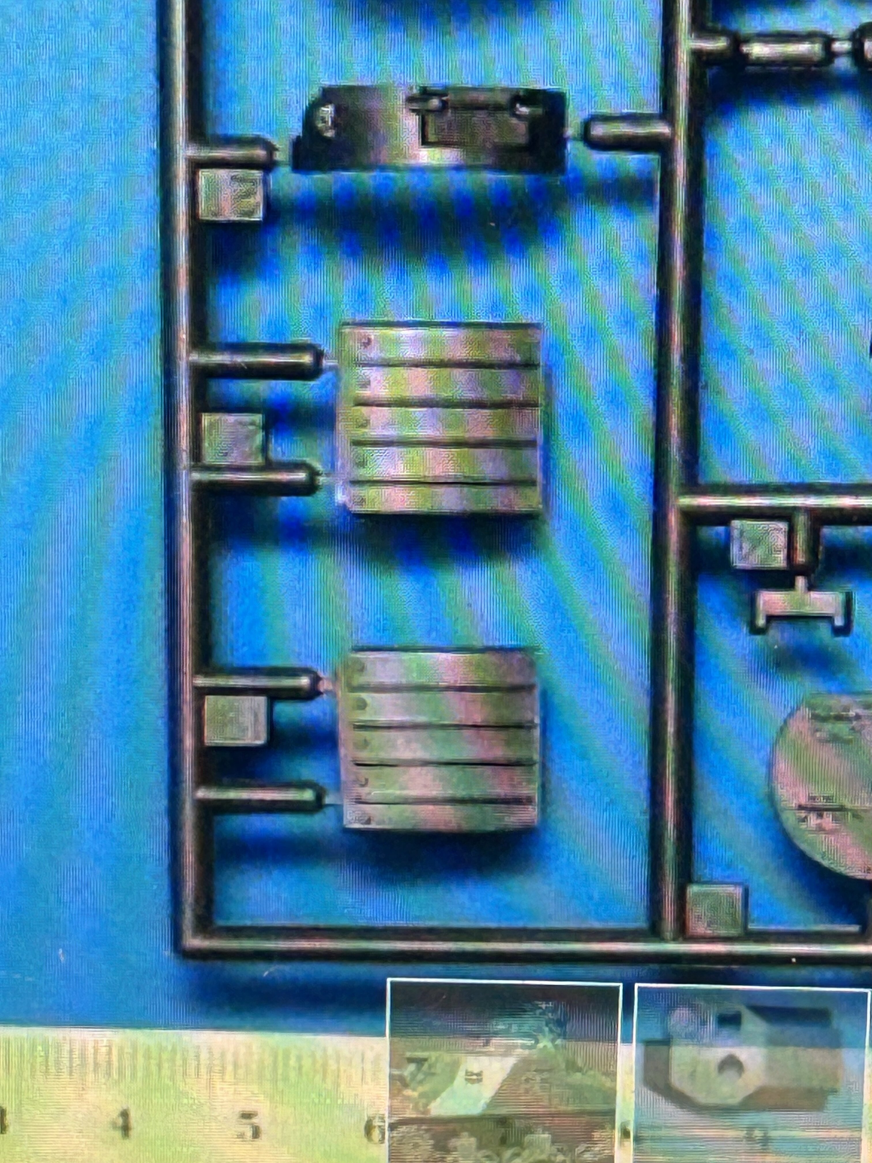

I wish I could help, I need another for a Ma.K project, they are well over the 60 dollar mark now I saw 1 for 125.00 this morning, yikes
Ya. That is why resin will be just fine for me. :)
If you don't mind using resin castings, I could send you copies of both.
PM sent. Thank you!

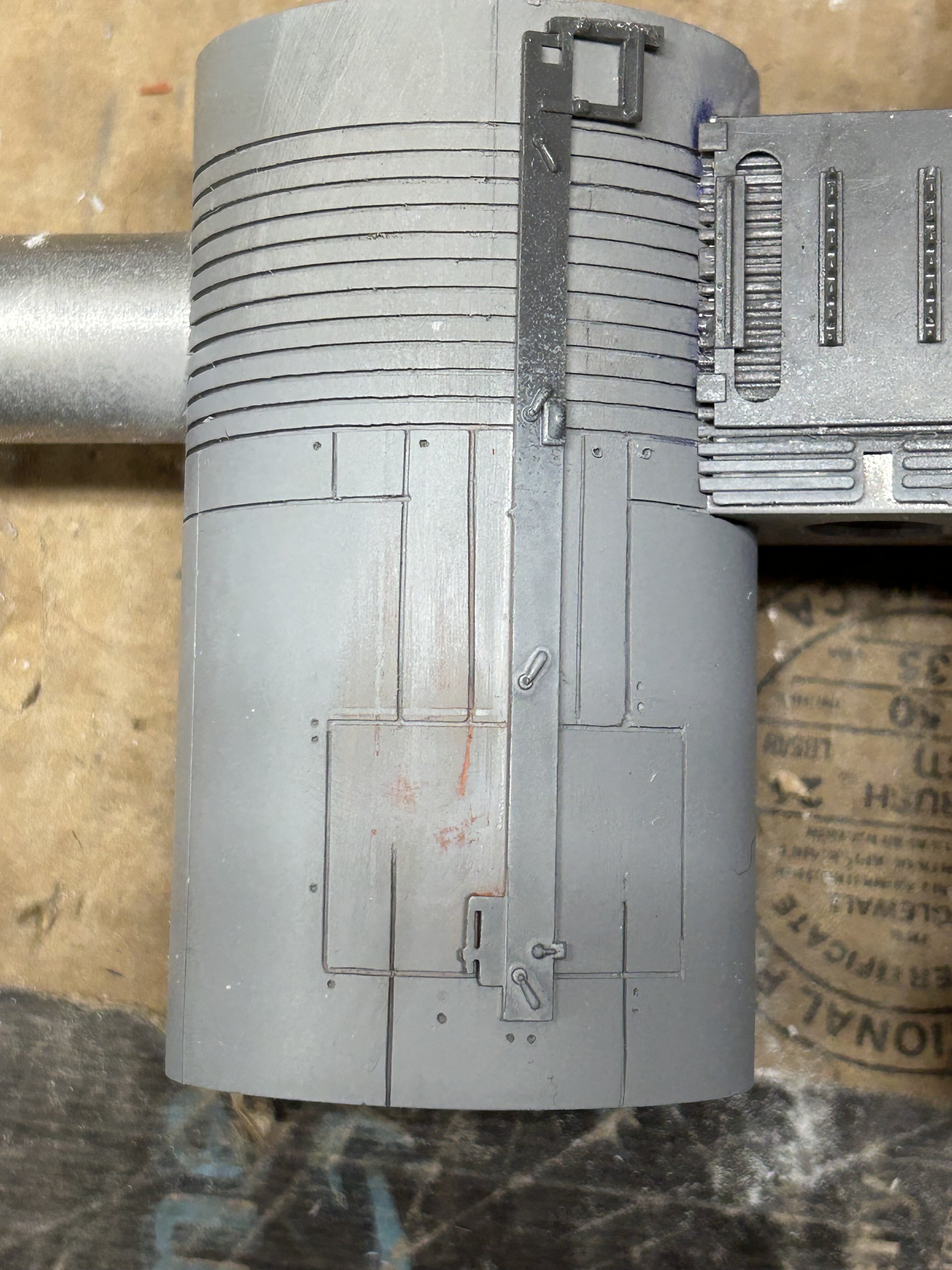

Started scribing and recalling the trouble i saw on the other builds. I will get thru this...

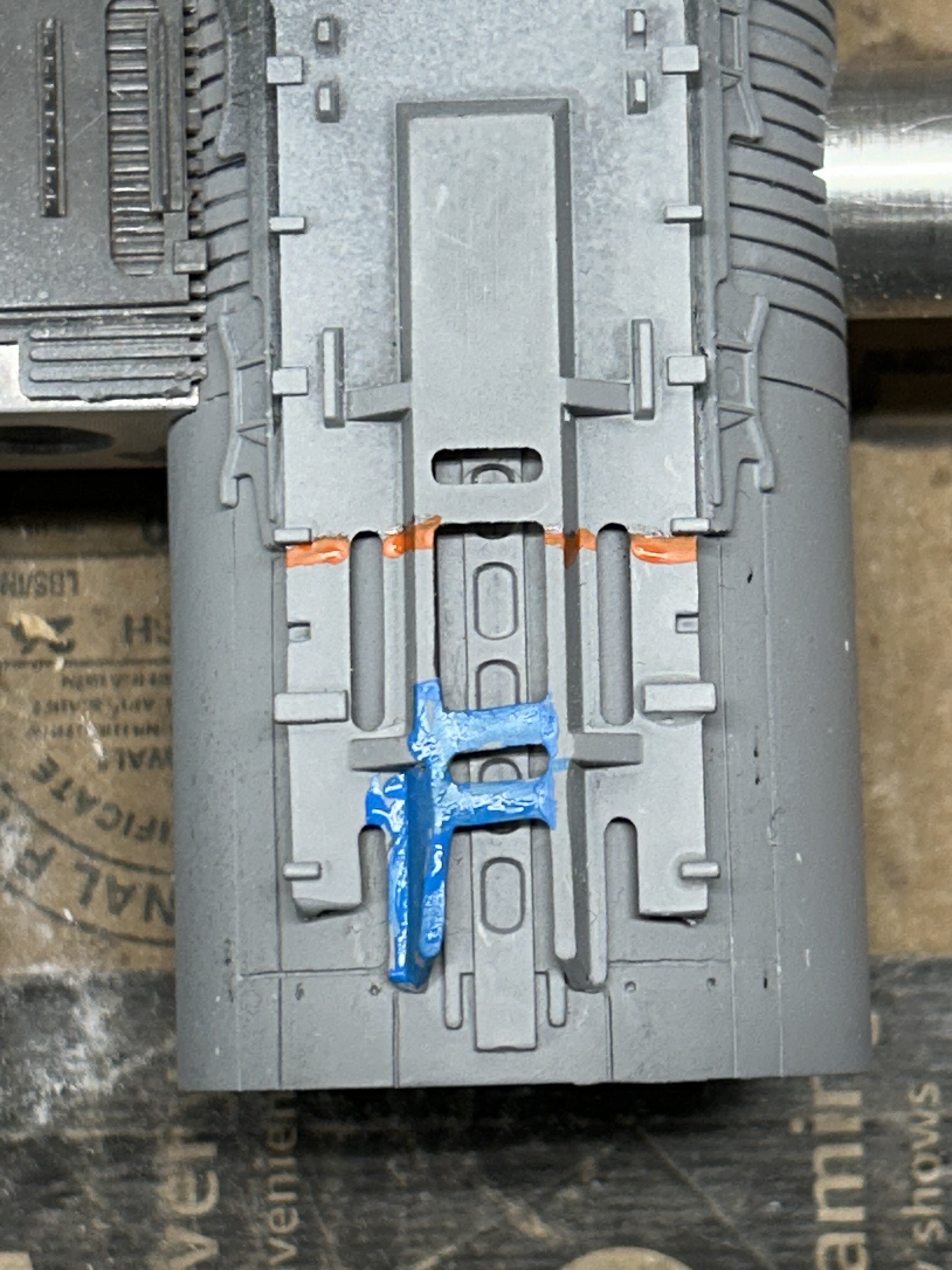

Need some friendly advice.
I was drying my primer and in a hurry and got a little too hot. My upper Leopold plate warped. Not bad but obvious. (Blue area)
It is glued on real good. I have a spare plate but do not have spare Leopold side details as they would not survive an extraction.
Options are
1. Leave it be. Battle Damage.
2. Scrape it all off and source new detail parts
3. Cut it back at the orange line and graft in a new plate rear
Thoughts??

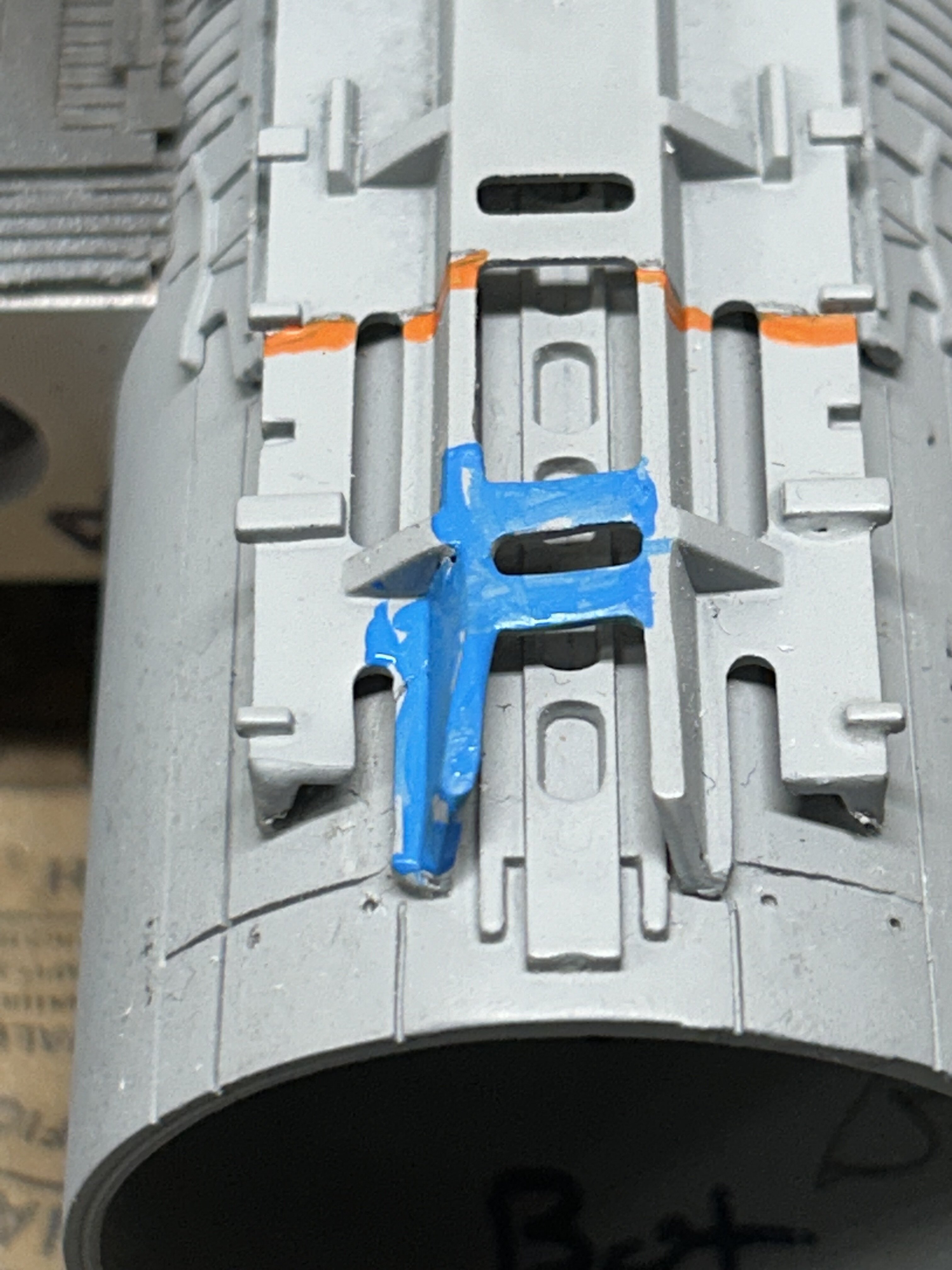

Options are
Thoughts??
Otherwise working on scribe lines and awaiting a few parts.
Progress…
I have some spare side details, so if you wanted to remove it and replace, I can send you those parts. Let me know!
Try with an clothes iron on low, put a piece of parchment paper between iron and plastic and move back and forth until flat;)
Successful extraction and repair. Stoked.
Was able to salvage the Leopold ladder in the extraction. That was surprising. Cut my new Leopold plate. The filled in grooves on the body will be covered so I will not dig that out.
I knew the Leopold side detail was not going to extract well and one did not.
Here is the successful repair. Left to right and comparing with the other side. Again stoked.
No need for spare parts. Thank you to those who offered.
Until my next mistake…
