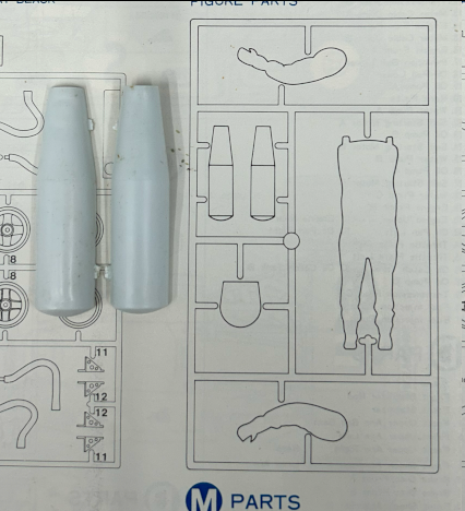

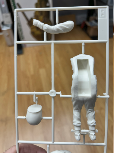

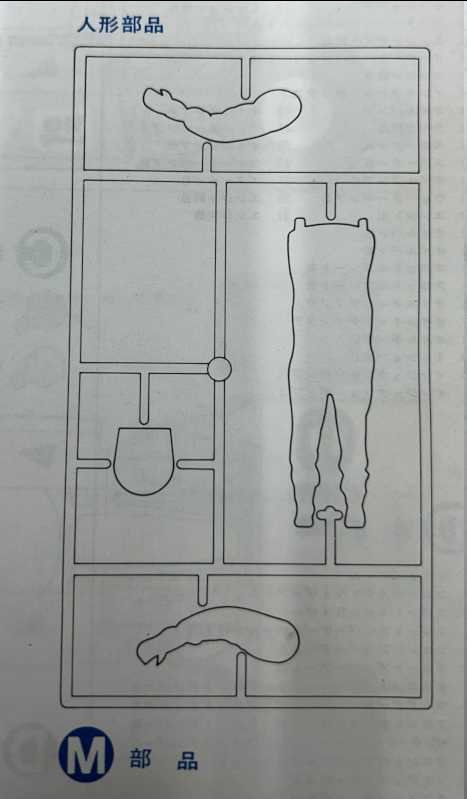

Those parts are not in Tyrrell Ford F1 'ELF' 12009-700. Those parts are blanked out for some reason.
They ARE in the Tyrrell Ford F1 'ELF' 1209-1750. Which I believe is an earlier boxing of the kit.
I’m in the process of updating the kits numbers. When I started, I was just grabbing from Scalemates.
If you look at the kit list in my drive, you’ll see which ones have been updated. I haven’t made it to Tamiya yet. Once the doc is finished, I’ll start updating the maps.
I'd never bothered to look at the instructions beyond the part layout pages. I didn't realize that's the handle to a screwdriver that you don't get in later editions. I really don't know why they'd blank that out. Seems far less expensive to just put a 'part not used' note in the instructions than to adjust the tooling.

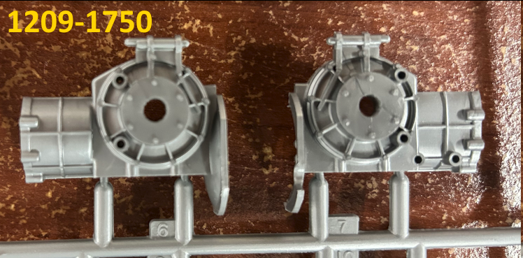

Your kit is an older lot than my kit "1209-2500", so please tell me one more thing. Which shape does this part of C-sprue have?
Thank you, Dave! I've always wanted to know the number of the first edition kit without a mold in this part.
In the case of the first version, the C6 and C7 cannot be used for the 5-foot Falcon.
As you may know, the number in the second half of the kit number shows the price in "yen", which is the unit price of Japanese currency.
"1750" means "1750 yen". "12009-700" is an unnatural number. Is the right edge covered with a label or something? This kit should be "7000 yen".
