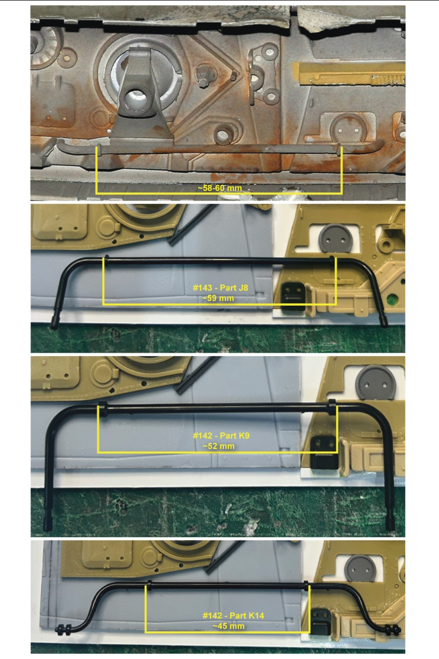

There's are two call outs on 'Port Sidewall Complete' (and its smaller version which we can probably do away with) of #142 Lotus JPS.
Based on measurements, I believe the cross bar is actually part J8 from #143 Yardly McLaren M23. The similar parts from the Lotus are both to short.

Dang! Now that's some careful sleuthing. Appreciated!

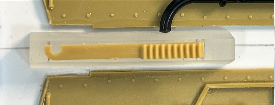

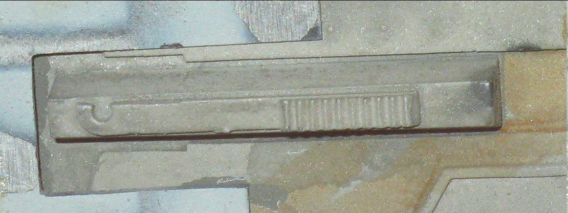

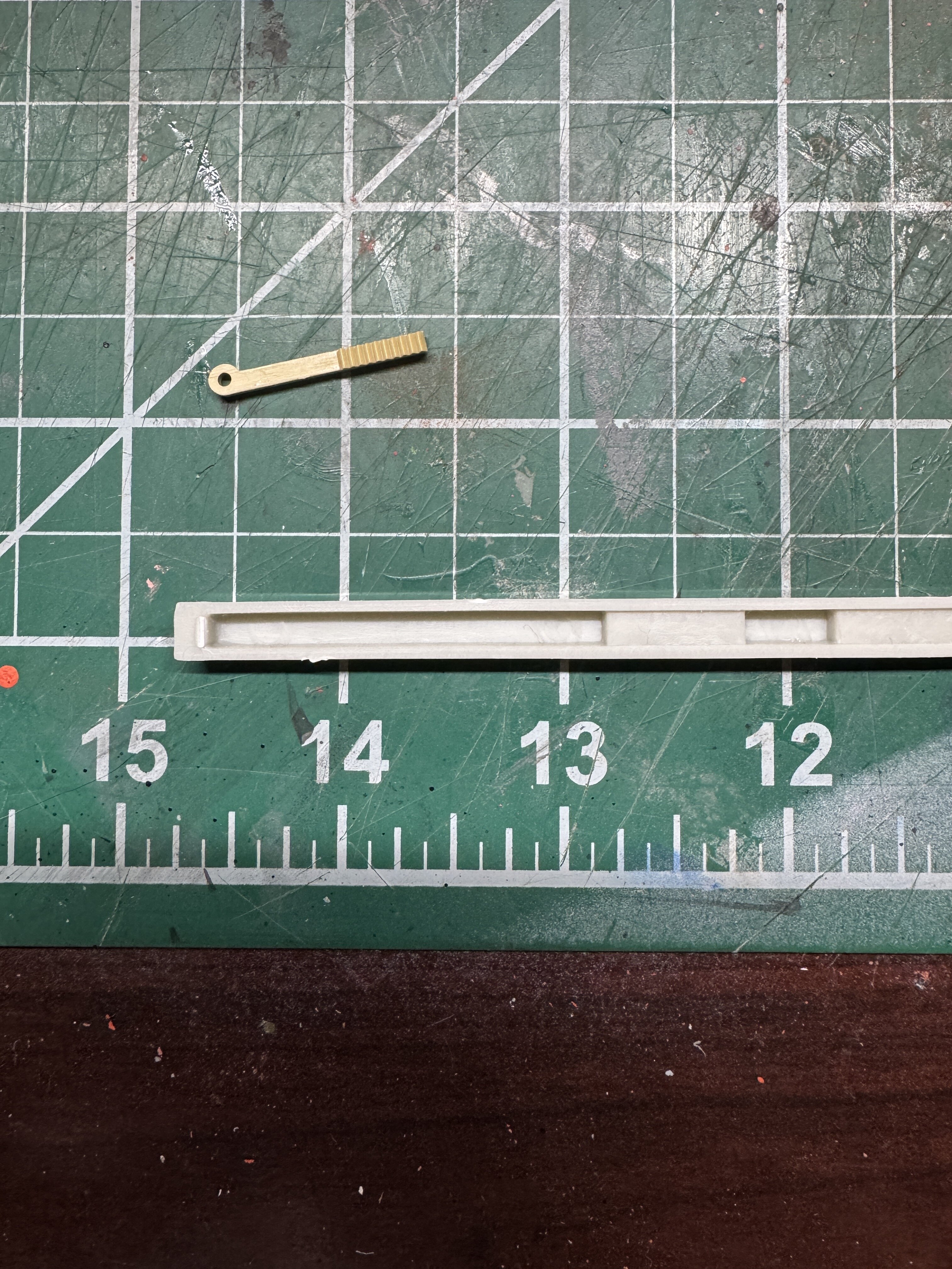

Okay I think I have this figured out. Part 203 from the Payhauler seems to be the only one that matches the Nitto rocket part. If you filled in the back of the part with something you'd then be able to cut it to the correct angle on the other side. Thoughts?
I measured it and found that the top was too wide. Sure, you could sand the sides down so the top was narrower. Maybe that's what they did.

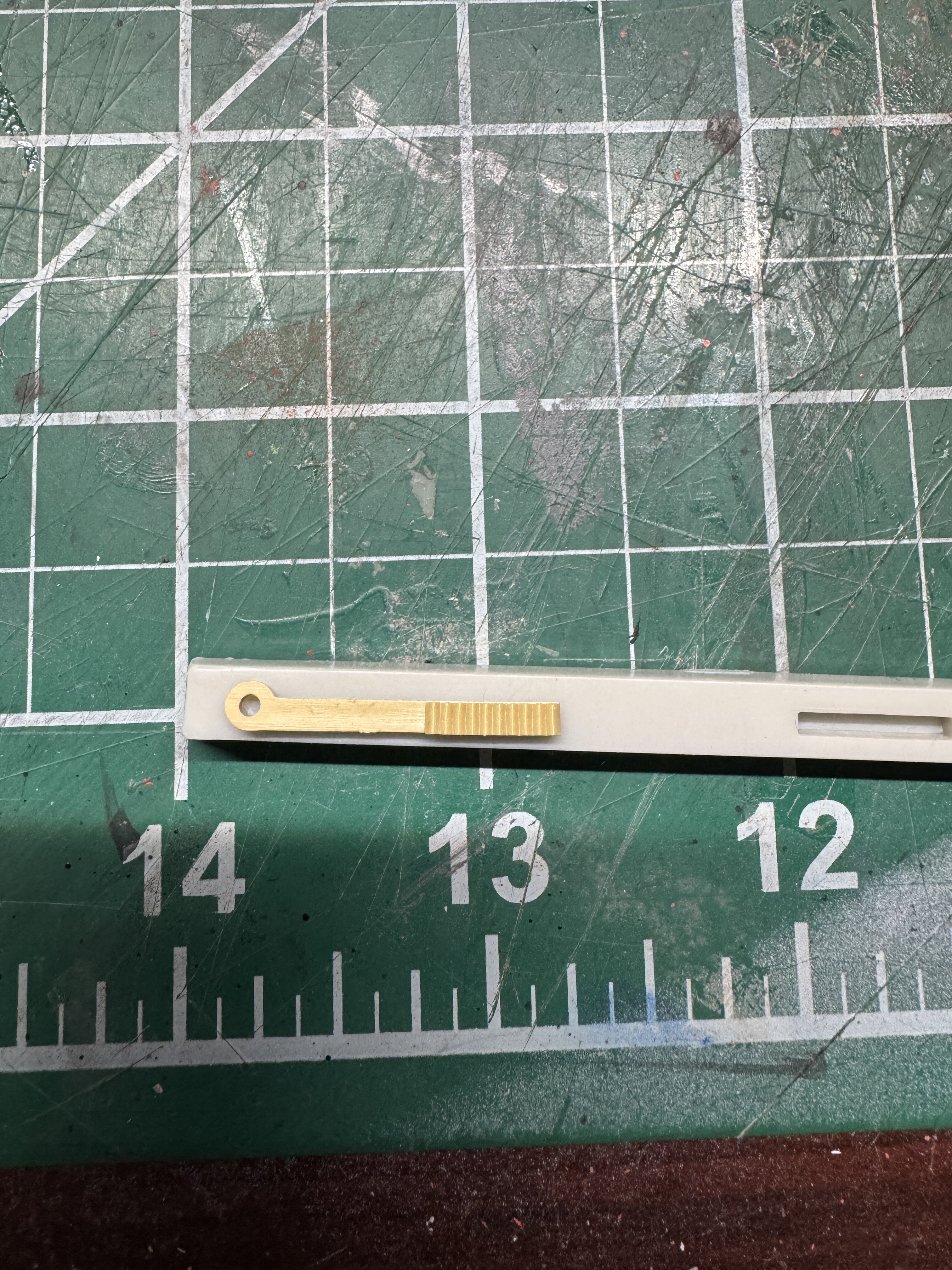

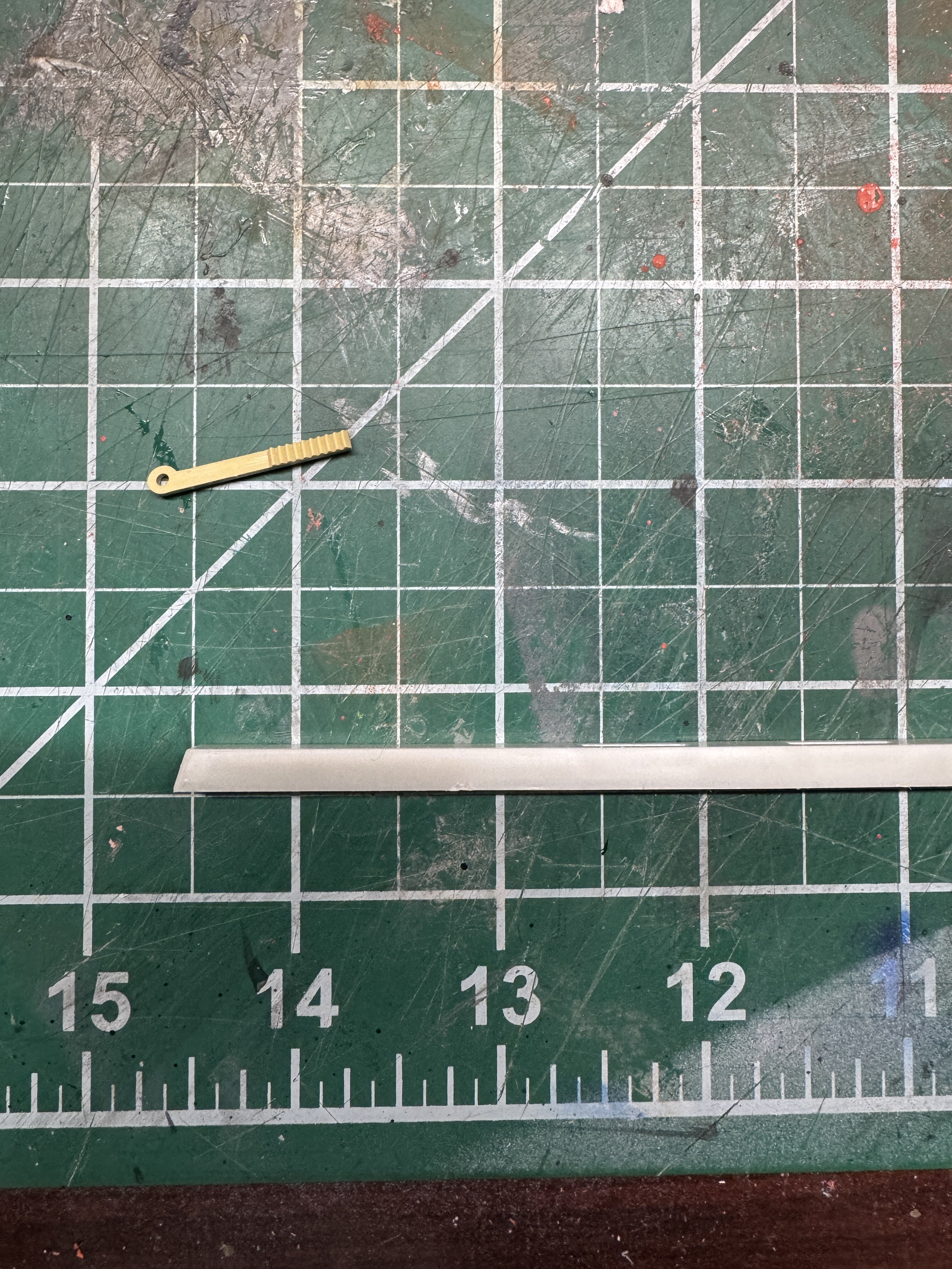

Maybe not how ILM did it, but I scratch built that part from acrylic. I feel I am closer dimensionally (although still not 100% perfect). I'm happy to be proven wrong though.
Ignore the black pipe, that's the McLaren part that just happened to be sitting there.

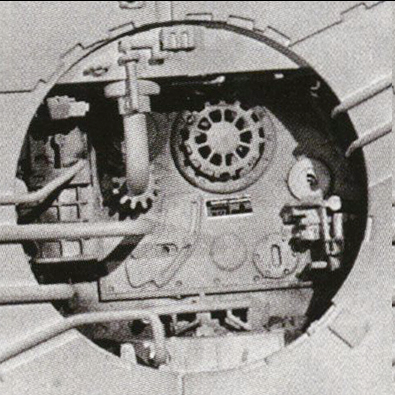

I know it's not the same heat sink that's used around areas of the X-Wing. That one is much too large and has the wrong vane shapes. I haven't spent any time really looking at the quad cannons yet, but I was under the impression those heat sinks were the same as the ones on the X-Wing?
Was that pit modified for ESB? Because it resembles an MPC X-Wing heat sink.

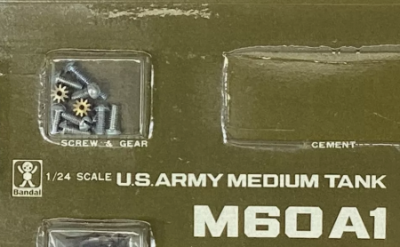

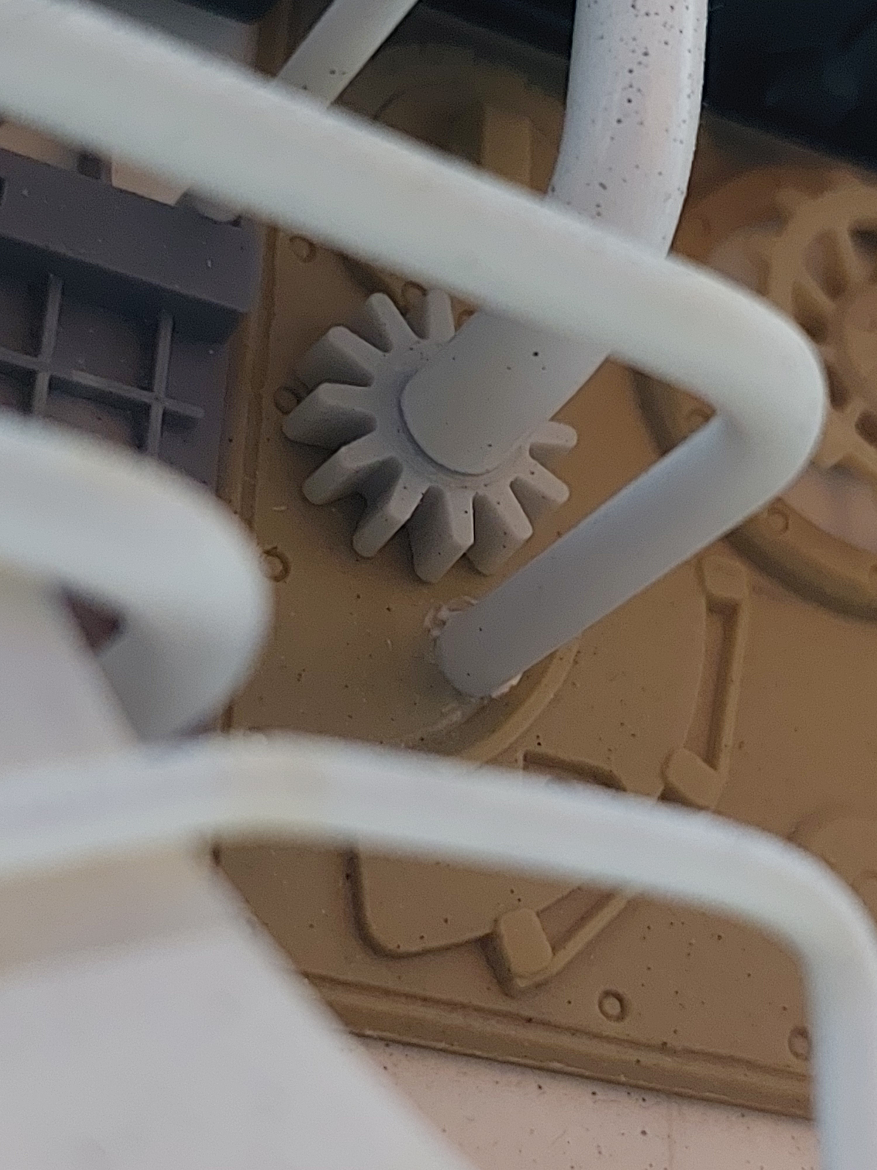

Nope, I've looked at all the gears in the motorized/RC kits (at least the ones I have in my stable). They're too small. The one we are looking for has an outside diameter of ~11mm and 12 teeth.
If you disassemble the transmissions from the Assault Gun or the Hummel, there's a gear in there that's close, but it's still not correct overall. There's a gear in the 1/25 Centurion that is close to the right diameter, but it only has 10 teeth.
The other thing with the part used on the filming model is that it has a bit of a rounded crown to it. I'm not sure why a gear would have that. I'm not sure why a heat sink would have that. That rounded top is really the only thing that makes me think it's a kit part, but I'm not sure.

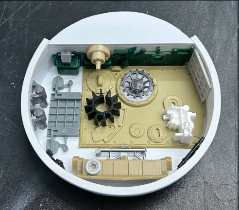

I have a question about the wall of Chieftain Pit. There are several differences when comparing the Bandai Falcon kit with the photo.
How is the correct way to place these parts?
