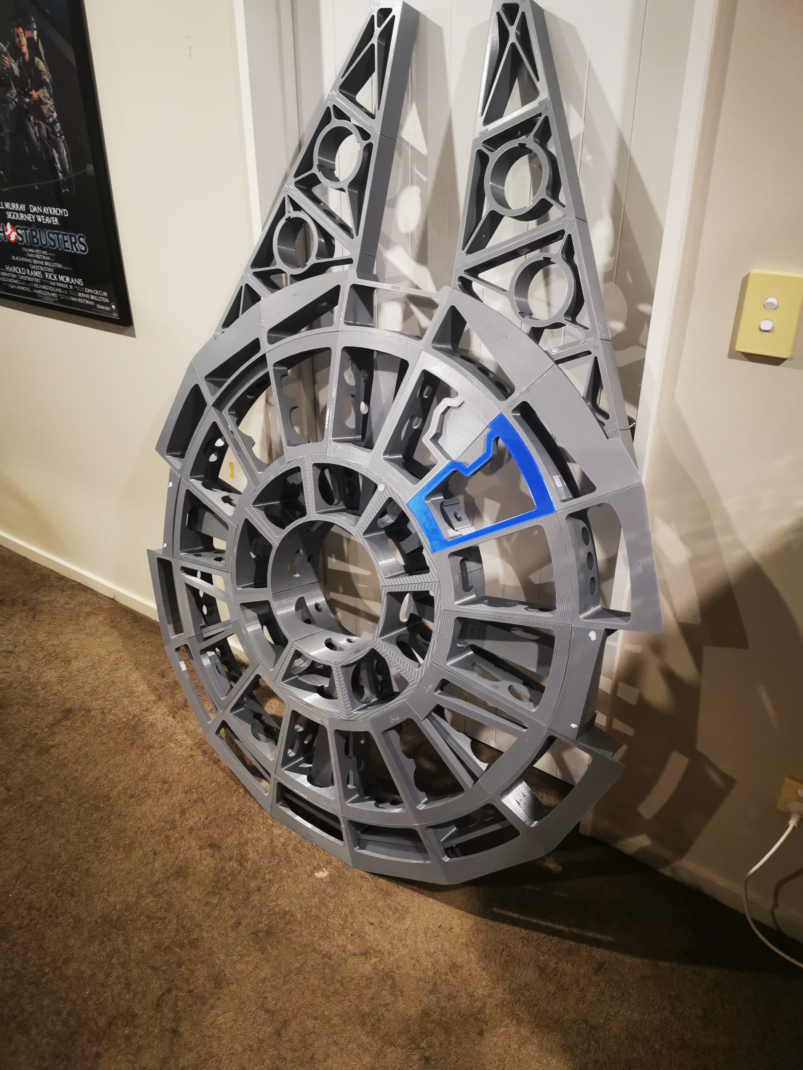

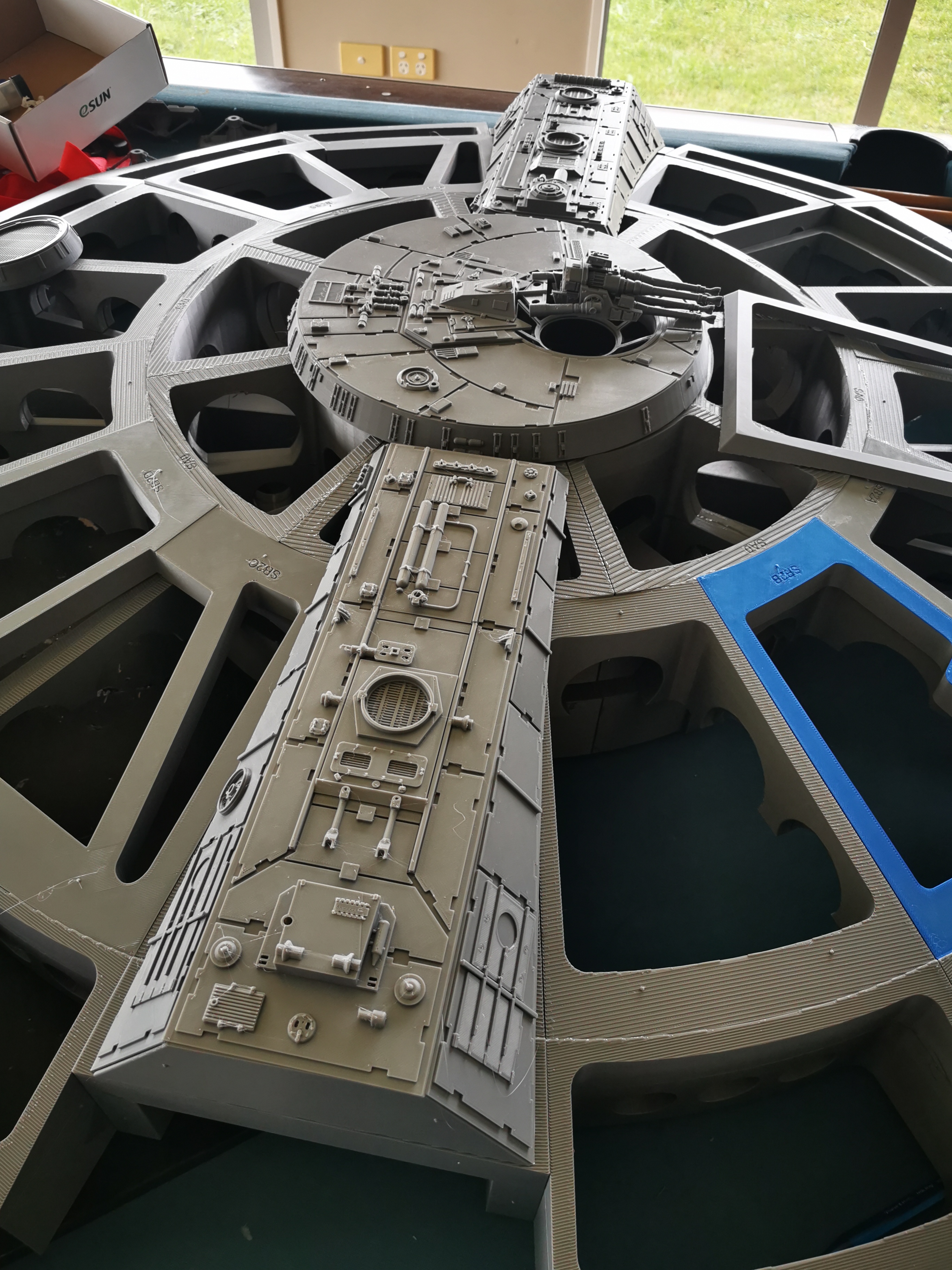

Very “crisp“ detail. Not sure how you and other experts produce this modeling with photography, CAD & printing, but those learned disciplines certainly seem to have been mastered. Great work and construction pictures. Shows what high quality can be achieved with this building method that links this technology to modeling of cherished subjects.Upper shell glued and ready for a bit more detail
and a bit more detail
will focus on printing off some of the detailed parts I have already designed prior to printing the bottom half of the shell - still working on my landing gear, ramp design etc, so that might take a while.
Have started on the cockpit parts, that might also eventuate before the bottom half

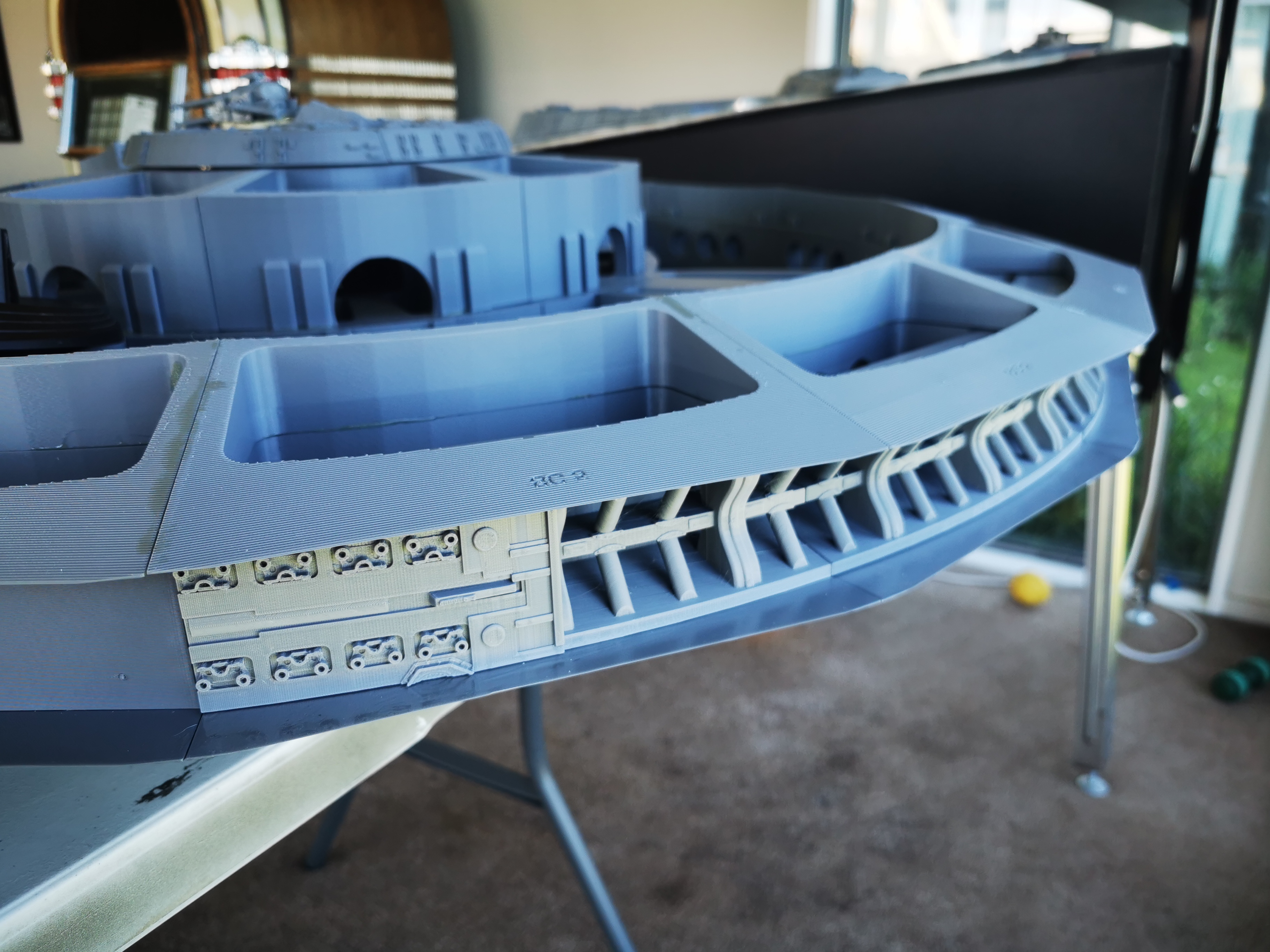

I have printed the Bottom Frame, and added in the rear engine vents - its designed so I can run 2 LED Strips from inside the Model around the inside of the vents
While doing this I did redesign some of the frame, the main one is I add mag mounting for the two gunner Turrets, so they can be easily removed, depending on how you want to display it. I am also adding Mag Mounting for the Docking Rings.

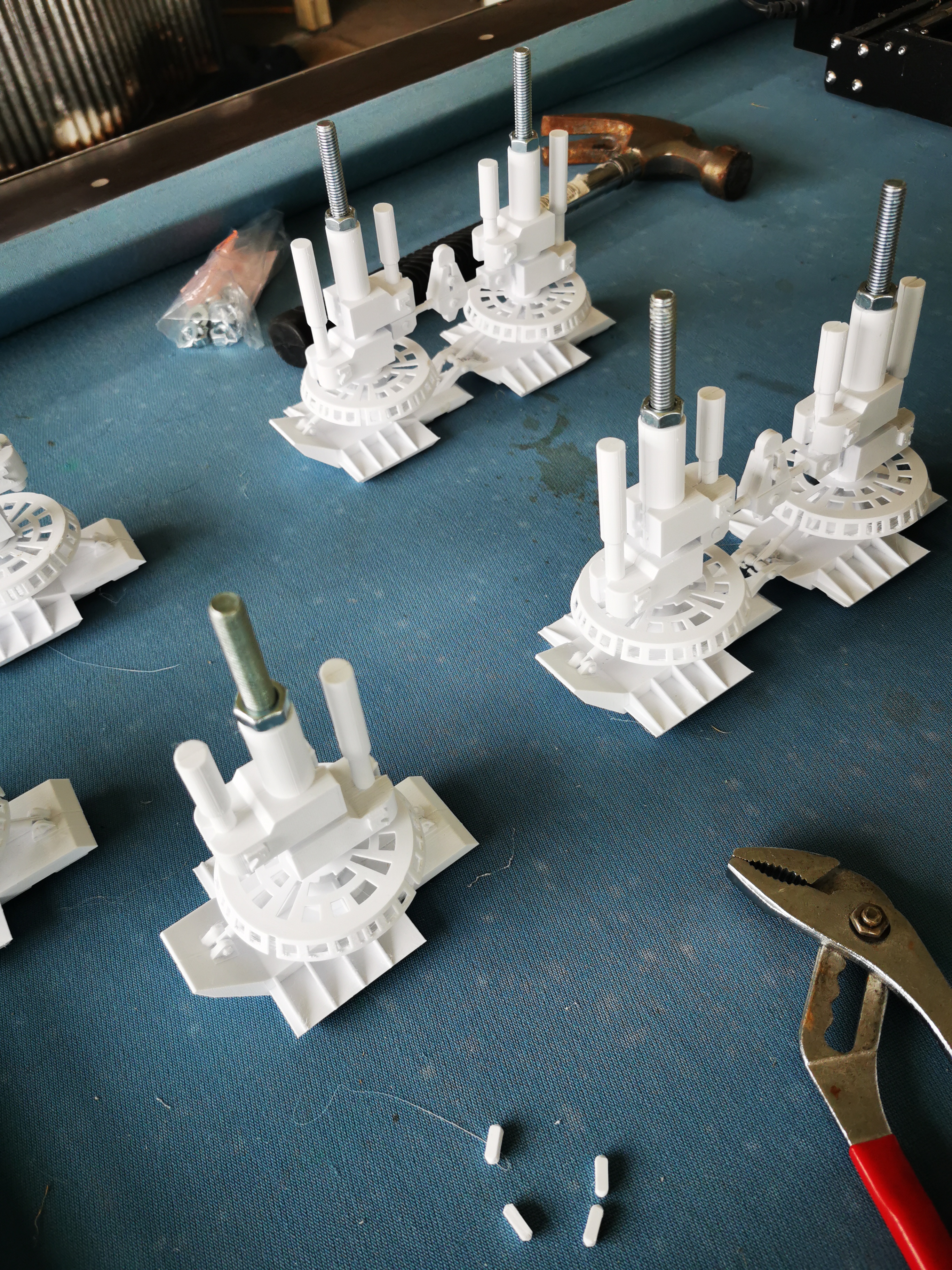

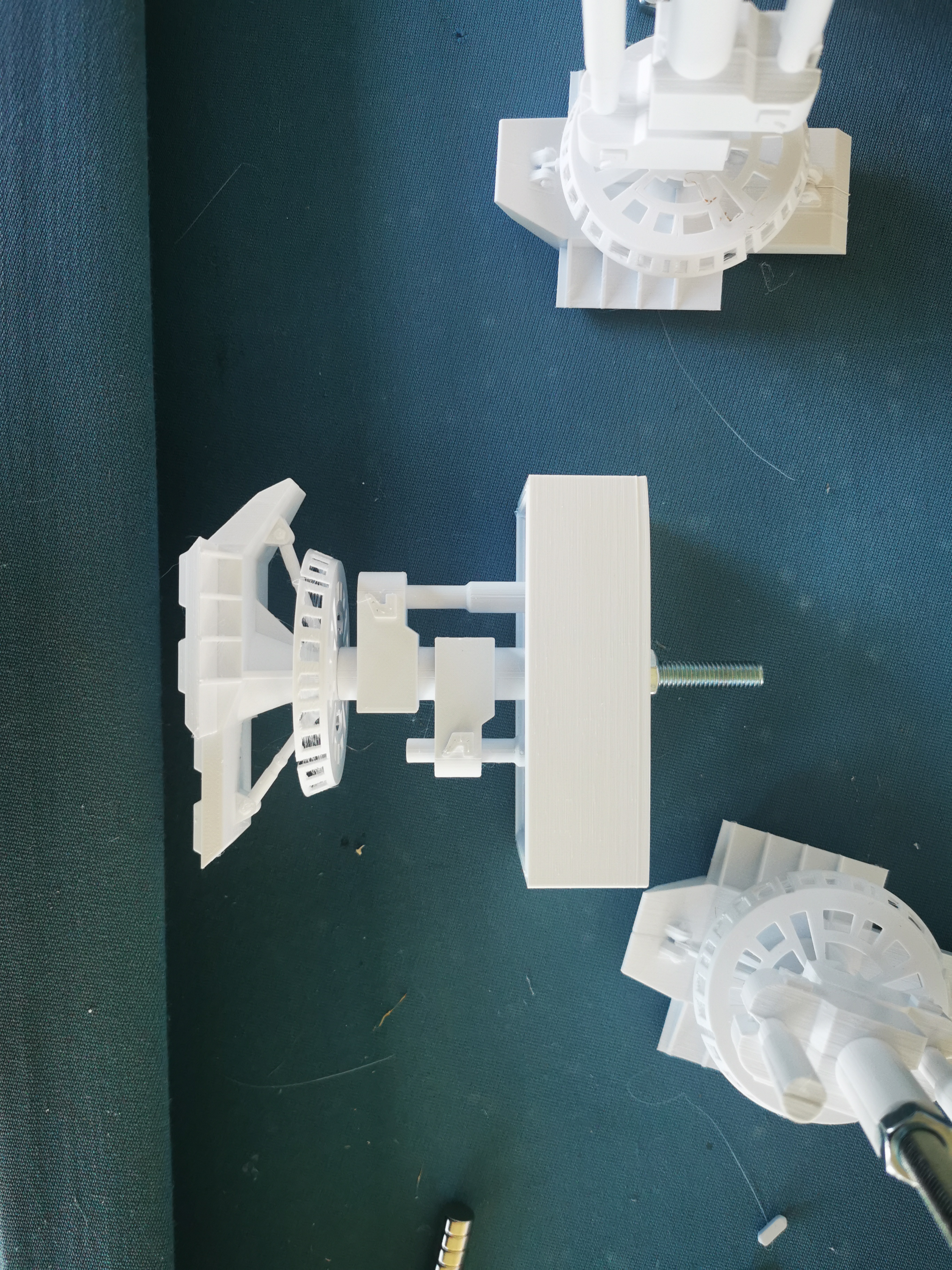

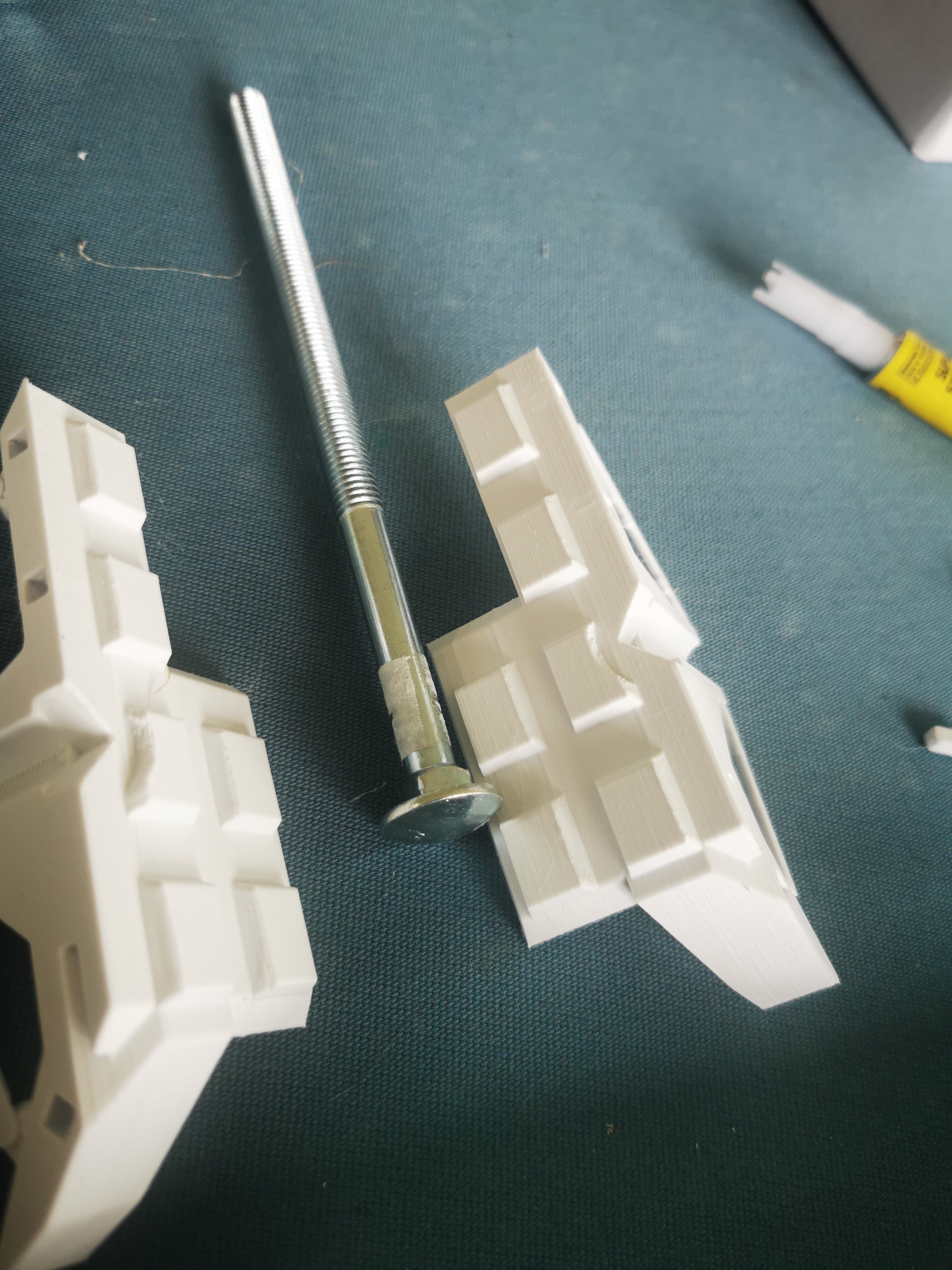

Part of the design for the Lower half of the saucer, was making allowances for the boarding ramp, and landing gear - which after quite a few attempts, I did end up with something I'm happy with.
So ended redoing the landing gear to allow for a coach bolt to support the weight.

This are printed split as in the photos and joined with the standard pins I use for everything in this model
