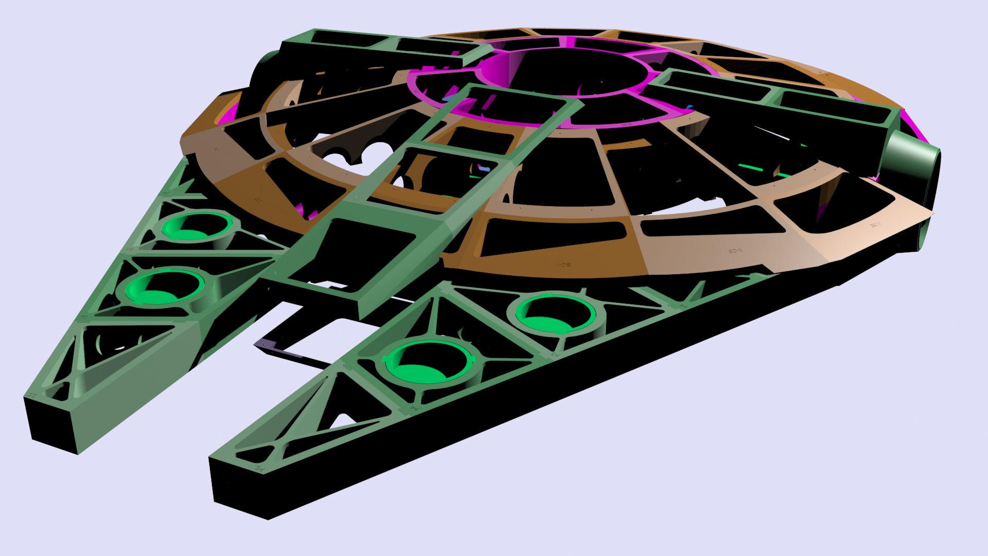

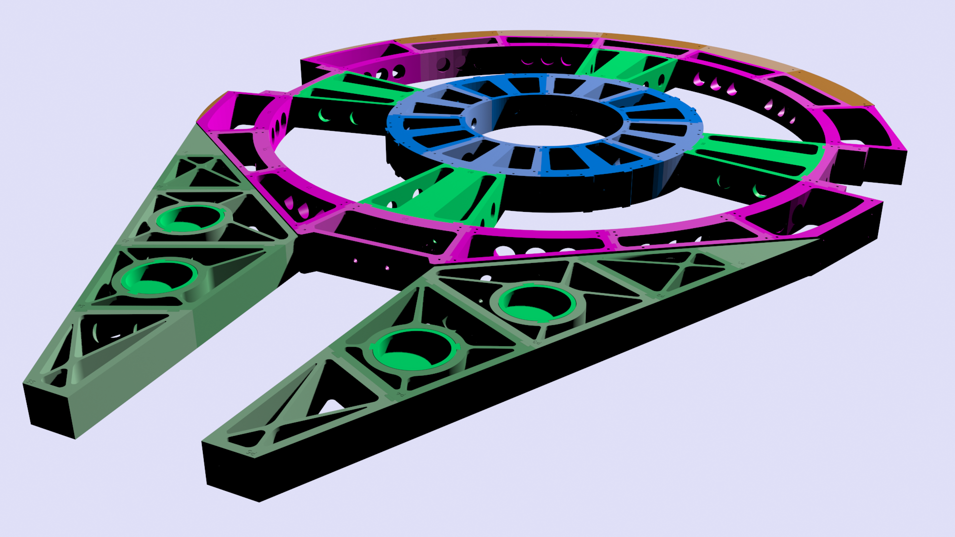

Bit of time since my last update, finalized my frame after about 6 variations, so thats been hot on the printer - aiming for minimal weight - allowing for channels for correct lighting etc.
Have also been working on the Docking Arms and Jaws - so a few pictures of the progress.

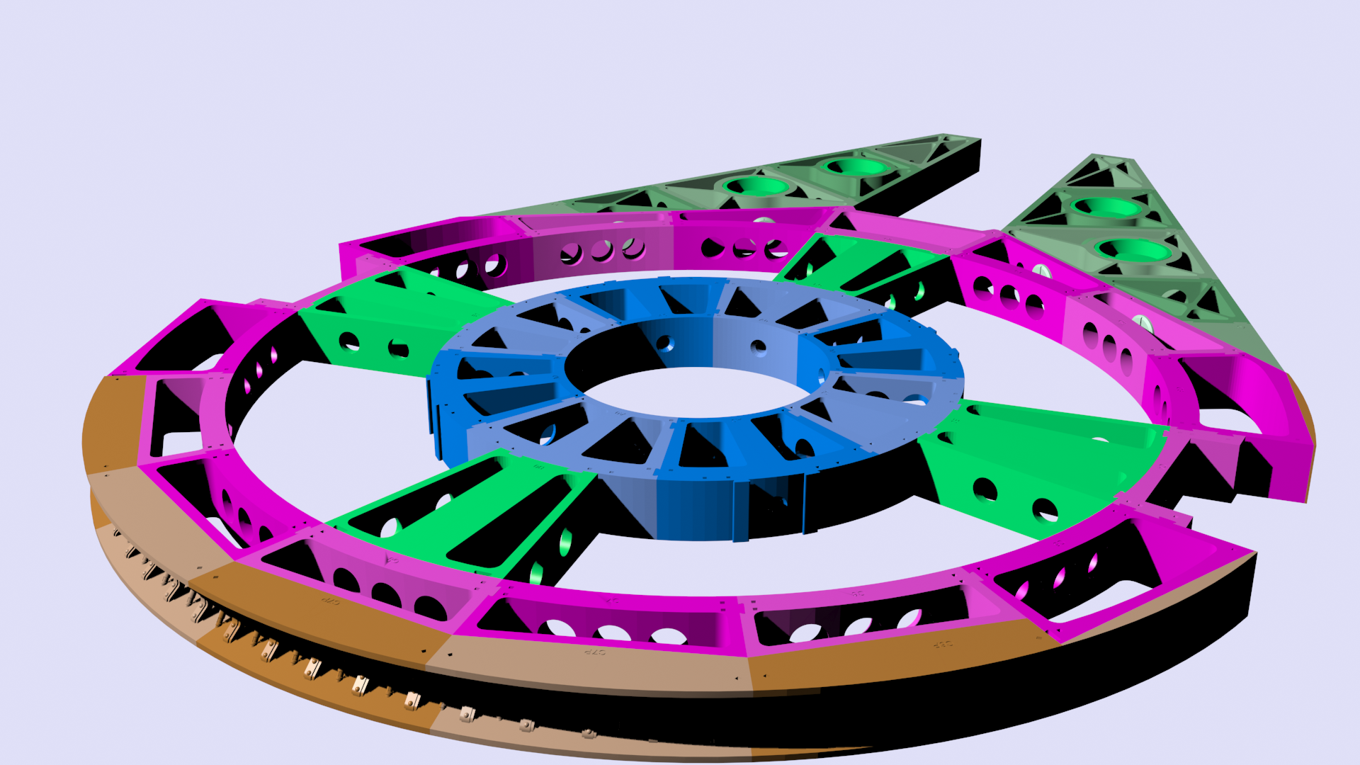

The central frame design is Finished - here is where I start deviating from the Studio Model - in that I have redone the engine area, based on others learnings about this - I will also be putting in the option for landing gear (Reinforced) and the landing ramp.
There is channels within the rear engine frames for 2x WS2812 RGB Strips - which will end up controlled via an Arduino and possibly a bluetooth phone app.
Next shots will be the secondary disk frame.
Currently Sitting at around 7kg or 15.5 pounds for my American friends
57.5mm seems like a pretty good height, and fairly dead in the middle of the existing numbers out there that I know about:
  • One builder used 63.5mm (i.e., 2.5 inches)
  • Another builder went with 59mm
  • And the sidewall height per the "Bandai 1/72 PG Falcon Conversion method" is 54.89mm (i.e., 55mm), by my own measurement and calculation.
What I would test, to make sure I'm happy with it, before committing, is how the 2" high forward mandibles look coming out of that 57.5mm high circle, and if that height gives you enough "lip" to overhang and hide the long Tamiya 1/35 M42 Duster greeblie (Part #A8) on the upper starboard mandible and still have the lip hover "above" that greeblie with some wiggle room to spare (see greeblie #5 on Parts Map MF018 1.2, pasted below). That's the precise point of reverse-engineering from the greeblies that I would try to test the theory of your sidewall height -- because it would only give you a scoche over 1/8 of an inch for that space, which may be enough as I have not measured the height of that greeblie. But there are lots of other considerations to keep in mind, like the height of your FalGal plates, Matilda plates, etc.
This is both the "trickiest" part of the build as far as I'm concerned, and also the most fun where you get to use "parts-to-the-whole" proper proportionality in your own artistic interpretation -- what I like is how, thanks to the durasteel plate overhang on the domes, the mandible sidewalls AND the dome sidewalls seem to be "visually" consistent in their height, even though they are not. So you want enough room to wiggle "downwards" with overhanging plating, but not so much that it looks cavernous once you get up close to inspect the sidewalls.
If you're willing to tell, I'd be keen to know how you derived the 57.5mm number, as I'm fairly obsessed with "build approaches" that different modelers take, and this is one of the most consequential decisions in the whole build, in my opinion.

Many thanks for the heads up, my Measurements have mostly been derived from an existing base model on RPF - I will post the link later, but seems to be the main go to for 5 footers.
I will focus on this area, as I only have about 3mm above and below the mandible - however as I am 3d printing things, I can cheat a little. Tho I'd much rather not.
