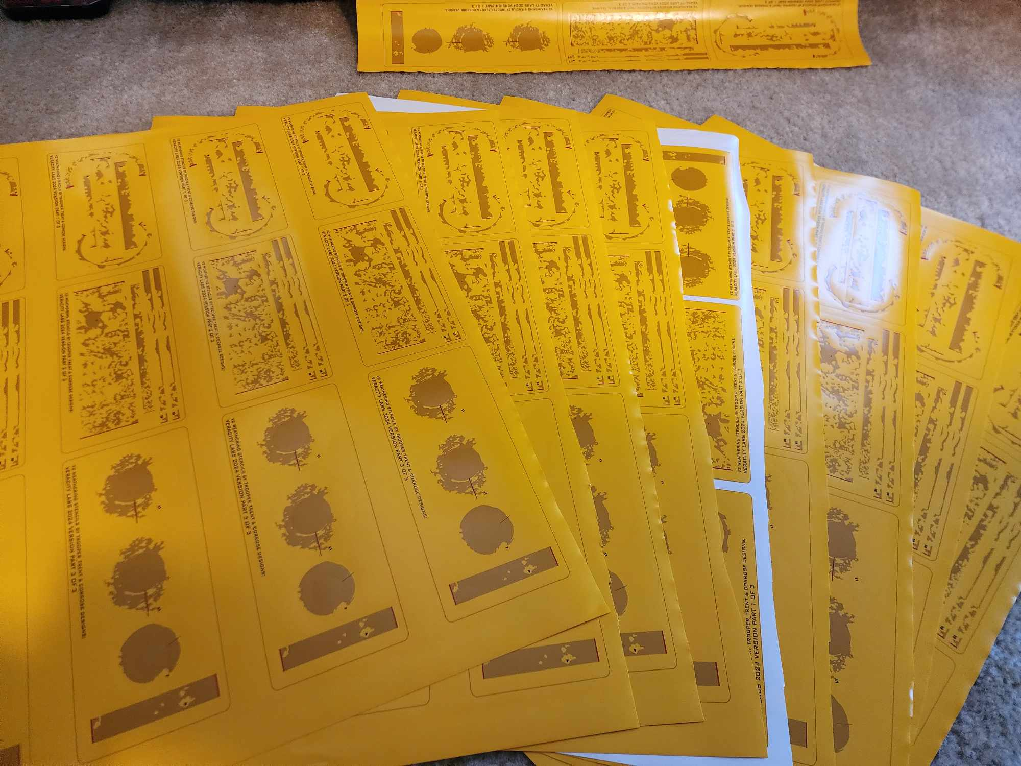

Trooper Trent is nearly finished producing all the stencils and gaffer adapters.

Stencils and gaffer tape adapters are done. I'm just cutting them out individually from the large sheet so they can be folded and shipped out.

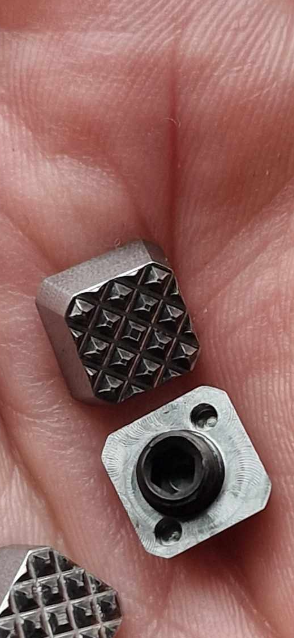

The new chunks are the mild steel, (according to Malaki Skywalker are rusting appropriately) and are literally in hand. The model was updated to automatically remove the flange, which we know to be absent on the V2 along with rusting sides.
(The two holes on the side are mounting points for machining, and will not be visible once assembled)

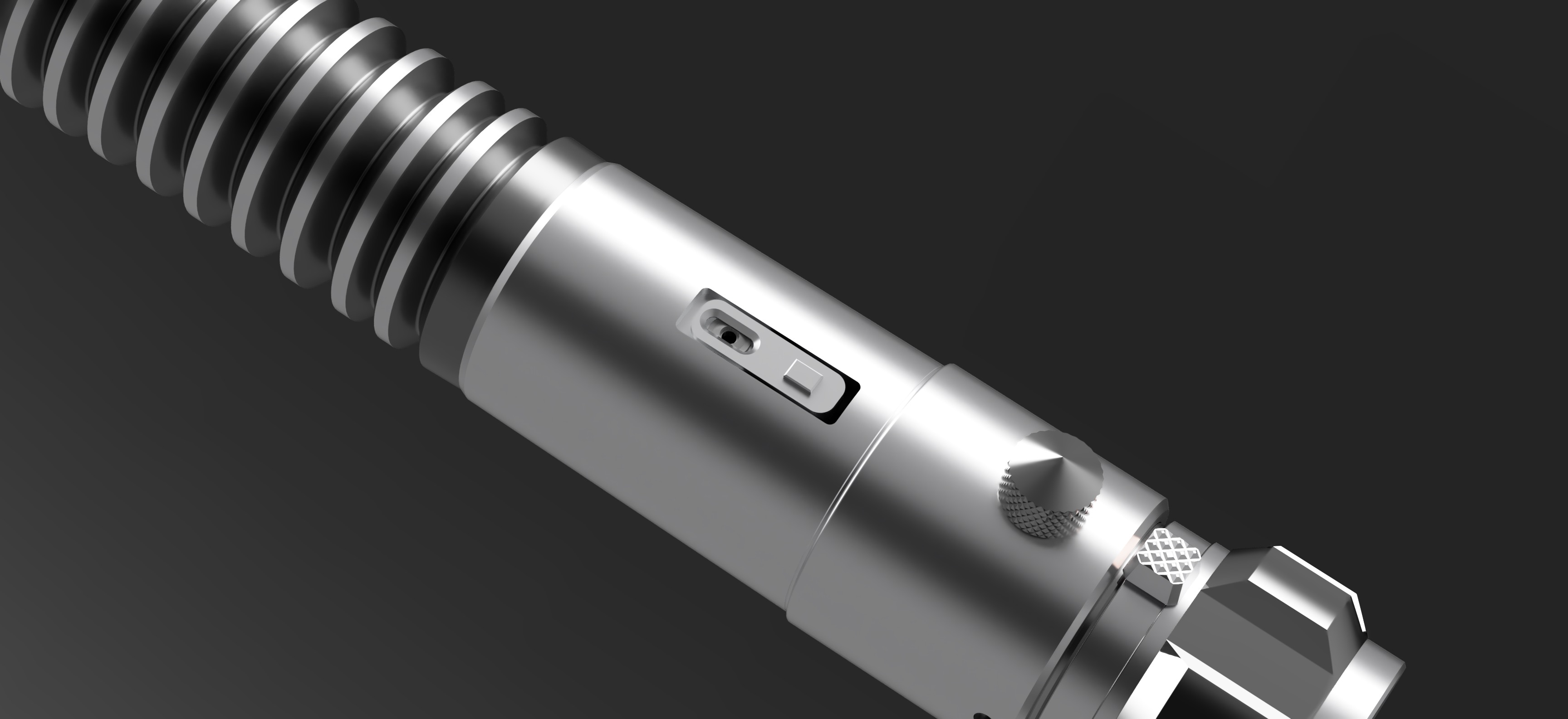

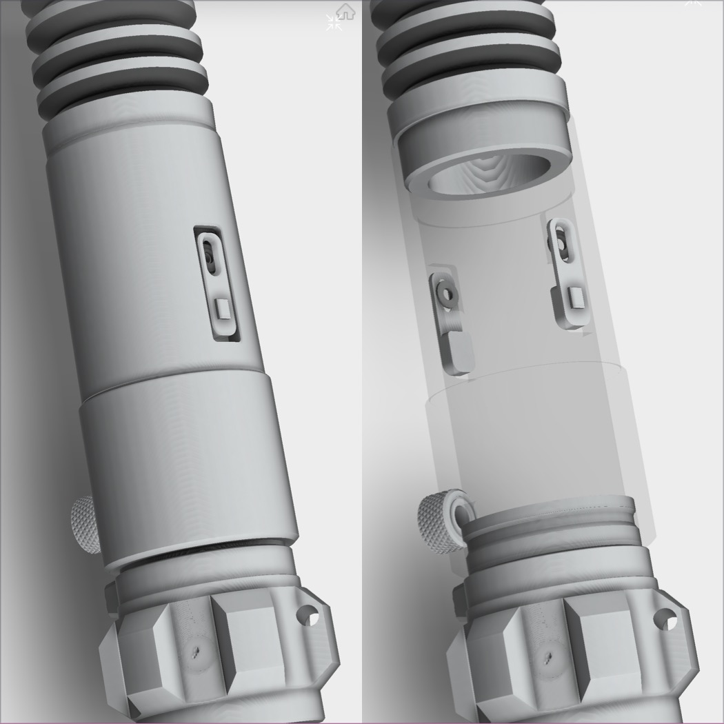

While assessing the model features needing to be re machined for accuracy- I did stumble across an accuracy feature that has, I believe, largely been missed with replicas. It is a subtle, but very sensible detail we have opted to include.
By doing so- it also removes the possibility of using the clamp card as a switch. I’ll get into why at a later date…
As the clamp card is no longer viable the next solution to keep it underneath the clamp, is making them accessible via the Graflex tab location.
There will be two on each side in the lower position.
(The threading for the crystal chamber is too low to do a rocker bar for one side)
A spring washer will allow a tactile actuation on the chassis underneath while also allowing a *removable* lower chassis, which was not possible before.
For those who do not want this feature for static display, the tab will simply be able to be removed. I recommend aluminum tape in its place.
The pommel has also been updated.
We’ve opted to make a removable cap so that swapping between venting is easy for the user. It is still a hidden vented cap along with the static version.
The mill mark has also been adjusted- I spent some time at my mill and arrived at a different conclusion for accuracy by recreating the appearance. This, after being dissatisfied with the way the milling mark was looking on the prototype - followed by the production pieces.
I do need to print a body and verify the tab placement is exact- and works across multiple clamps. However, the clamp being provided (The Roman Props new Folmer, per Halliwax’ glowing recommendation) is what we are referencing primarily.
I understand that the delay is frustrating, but getting this right the first (and potentially only- time we do this) is very important to us.
Here are some more renders of the adjustments.

At least, we just finished the redesign so I need to confirm with a printed prototype. It will then go back to TXQ for machining which will then require another couple weeks. I won’t be able to provide a solid date right now.
Yes, new plungers come through the bottom two holes. It is designed so that they should sit flush with the provided clamp. If they need to be lower by preference it should be simple to file them shorter.
Also to clarify- the design of the tab allows 2-3 mm of adjustability up-down-left-right in the event that the clamp hole locations do have any variance

No these are specifically paint masking stencils. You can’t get that level of detail with powder cost and the heat would melt the vinyl.
Thanks very much for the answer, apologies if it came across as ignorant! I've never powder coated before, but my work has a powder coating set up and I was wondering if this would be a good application for it.
not at all! We've discussed it on the boards before as it does sound like a good idea at first. Powder coating, while very durable, has a noticeable thickness and doesn't work well with any kind of detailed stencils at all. The real prop is just chipped paint, and spray paint is plenty durable, even with frequent handling.
