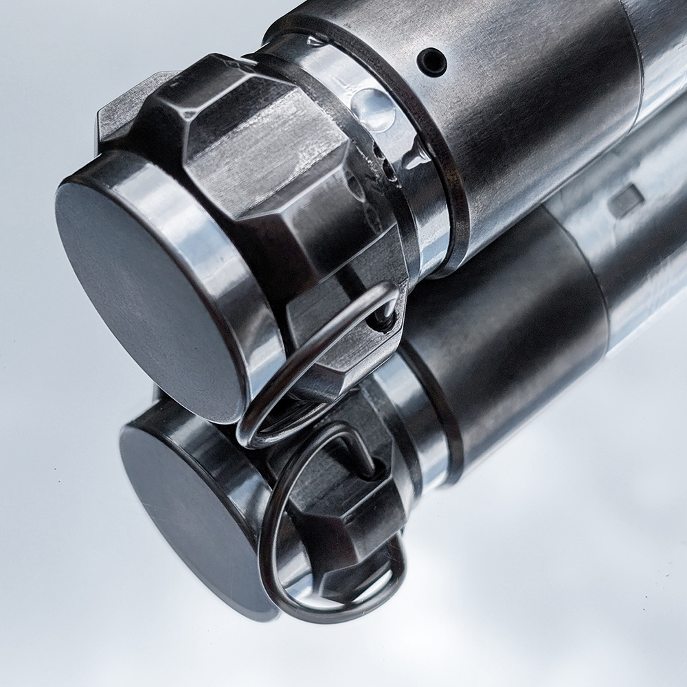

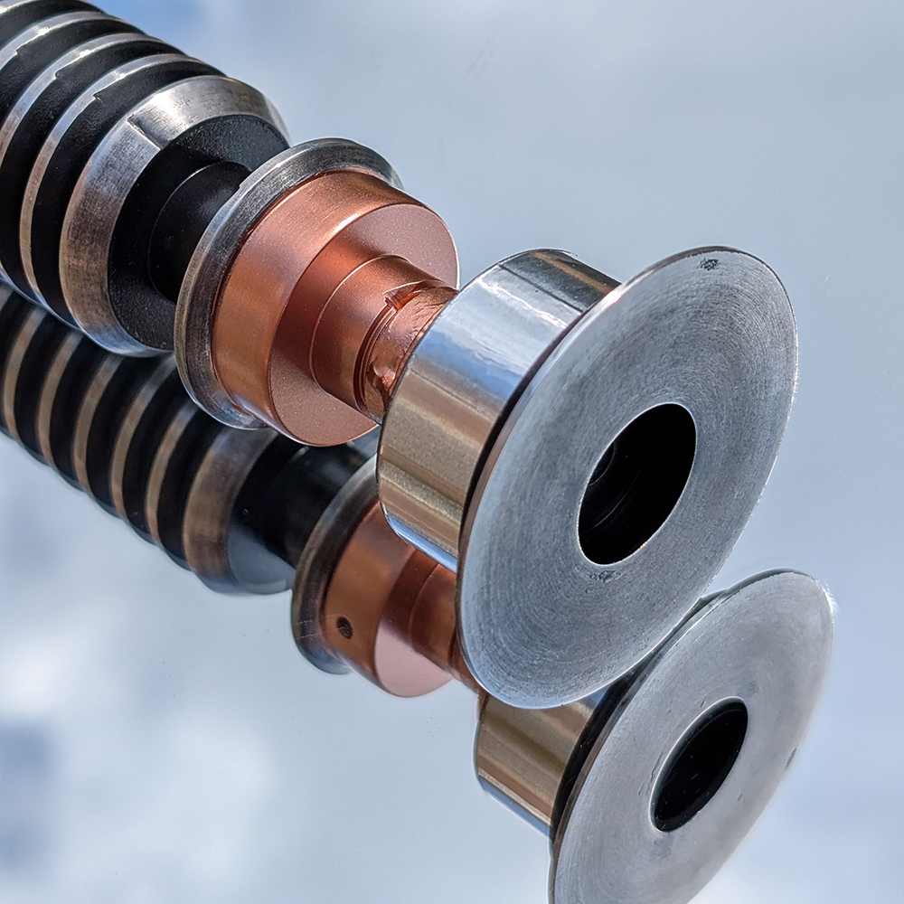

Since the Pommels have been prepped for some time, I went ahead and darkened them so that they could be finished and ready to install.
Very happy with how these have turned out and it's great to have them completed and awaiting final assembly:

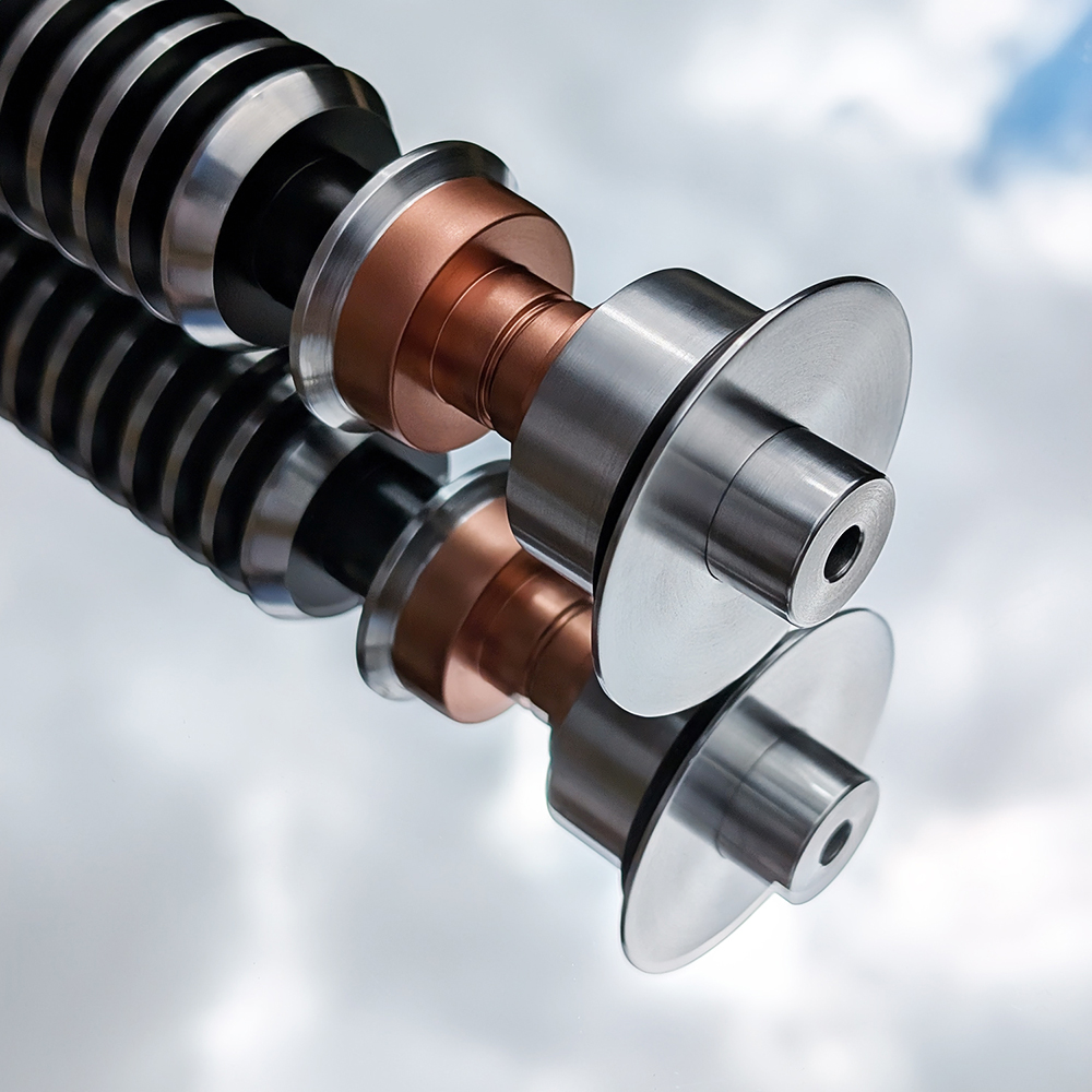

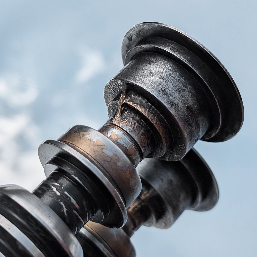

Work on the emitters is also largely completed. There is very little work required on these prior to darkening, so I went ahead and darkened these along with the pommels.
I apply the imitation casting flash after darkening. For this I use a combination of Quick Steel and JB Weld. I then paint the underside with a base coat. The base coat depends on the intended version. I base coat the production variant with an aluminum base to match flash colour to the underlying metal. I skip this step with the NASA variant and apply a black base. This is then dusted with bronze gold or copper, going heavier towards the neck join.

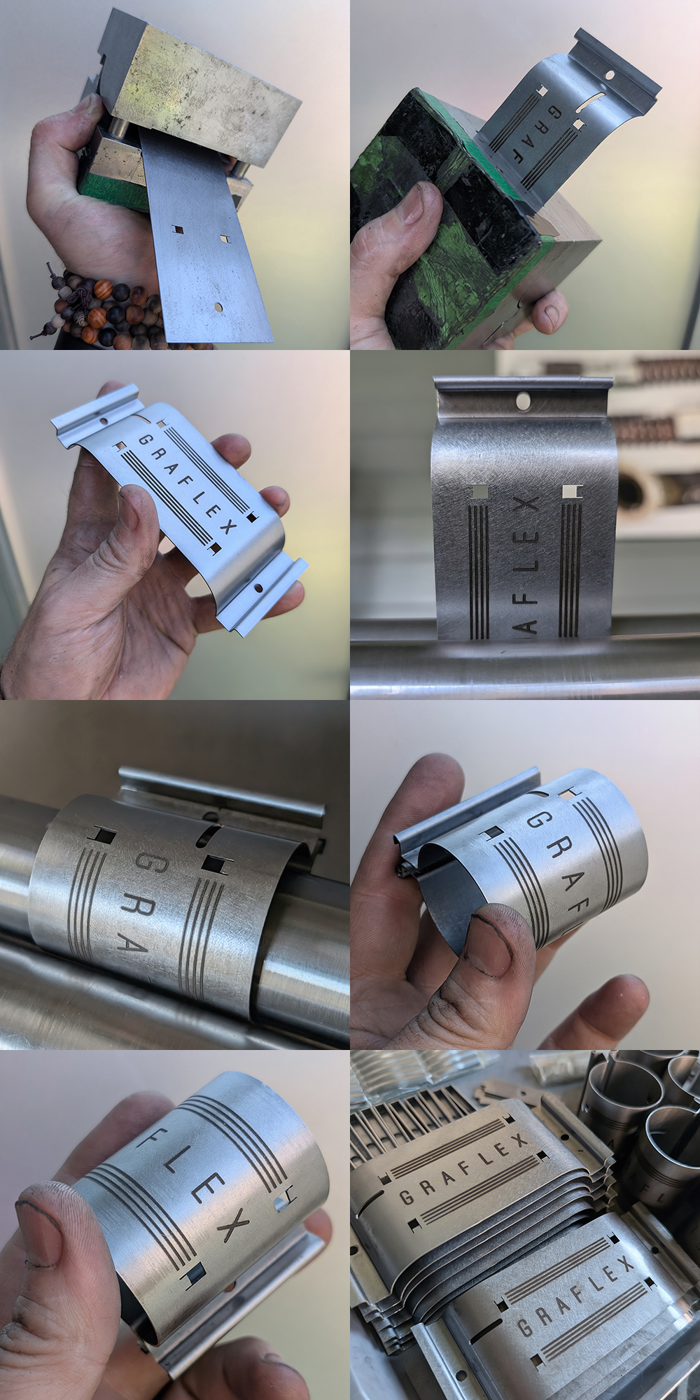

Clamps have been finished and ready to go for some time now as these were done alongside Batch 5:

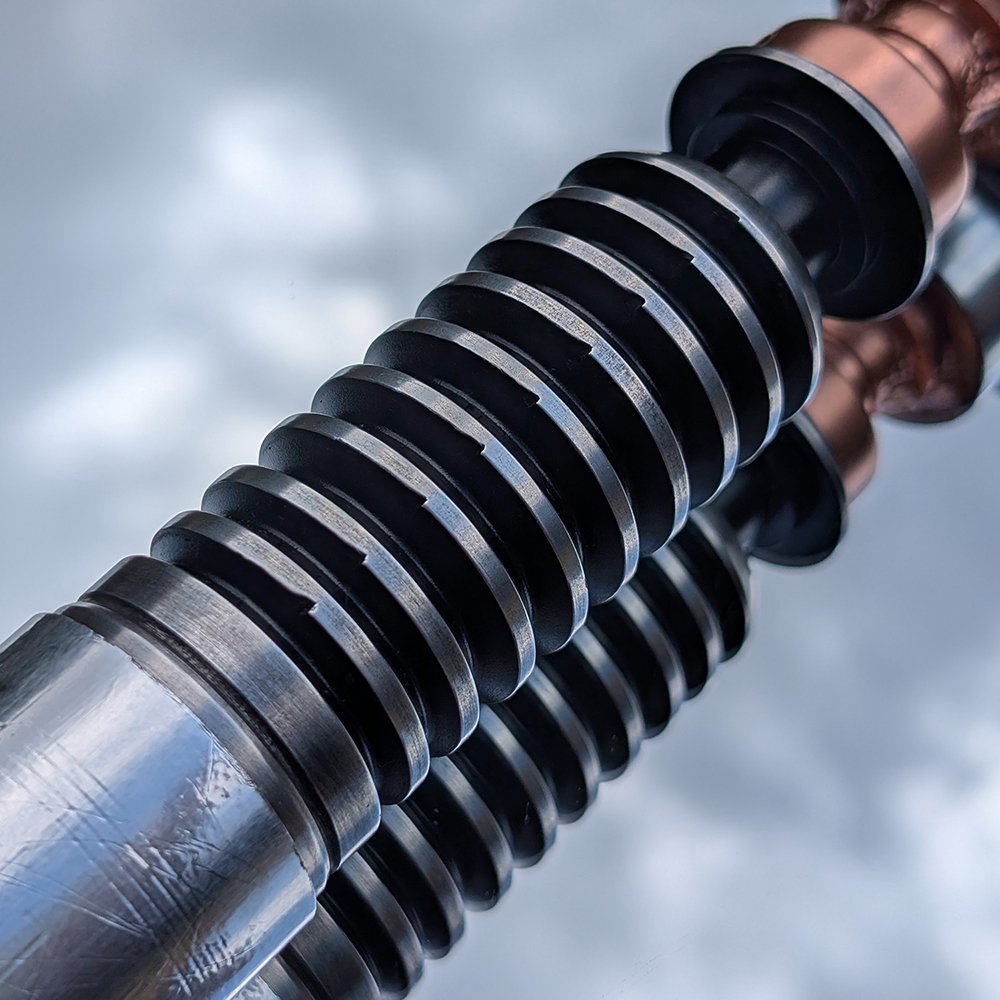

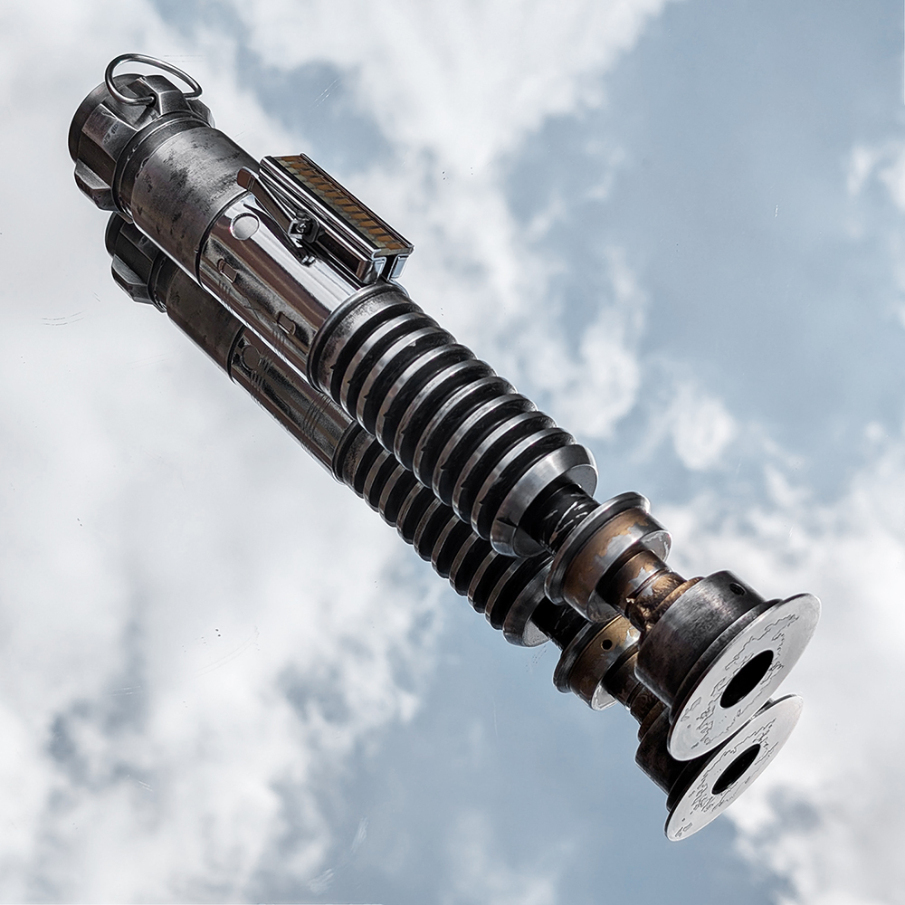

With work on the emitters and pommels pretty much completed, along with the clamps, all that remains is the body sections!
The body sections arrive with me as a V2 profile (minus the fixing point). Each one has to be adjusted to match the V3 profile. This involves alterations to the base of the booster section, the thickness of some of the grip rings and, of course, the neck profile. Fixing points then have to be added and tapped, before finally adding the seamline by hand on each side.
This is quite a lot of work as you can imagine, but it has to be completed before any chemical darkening or painting can take place.
I’m happy to say that this work is now complete, and I plan to have them all darkened on Monday. “Chemical days” involve me taking over the bathroom in the house, as my workshop doesn’t benefit from running water unfortunately. This involves emptying the bathroom entirely. A deep clean is then required once I’m finished. For this reason, I have to limit these days to days when the children are at school. So, no darkening of parts can happen over the weekend unfortunately. They are now ready however, and first thing Monday morning I’ll be donning my PPE and getting these darkened! I am looking forward to masking and painting the bodies the very next day. Masking V3s is obviously a walk in the park compared with the V2s (no stencils!) so I don’t foresee this taking very long at all.
So very close to the finish line now!!! Once the bodies have been darkened and painted, final assembly should take no time at all and I’ll begin the process of booking these in with UPS.

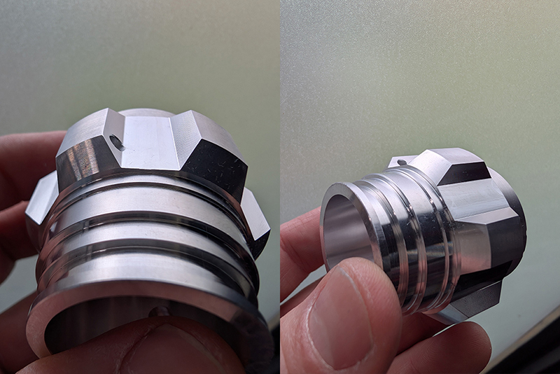

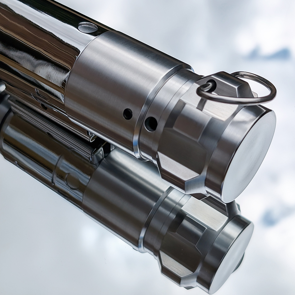

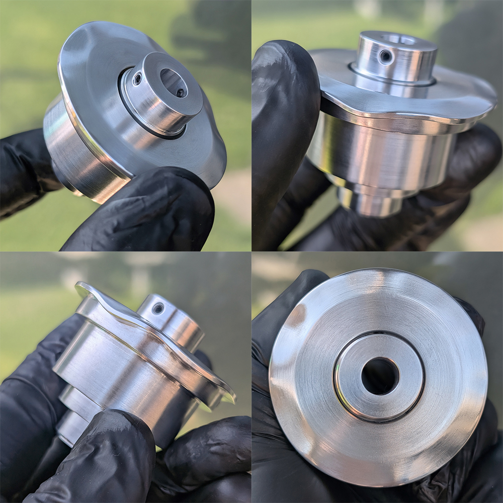

With the previous set of V2 parts, there was a lot of additional “clean up” required by me. This time around, there is very little work to do between unwrapping the parts and darkening/painting them. This is fantastic news obviously, as I expect to be able to complete them is a fraction of the time that it took to complete Batch 5.
ONE part did arrived with quite a glaring mistake however… Just to reassure you, this has already been dealt with and the replacements are already in production!
Spot the difference!
This is obviously not even close to acceptable, so please DONT PANIC! They have been rejected and are being replaced. (y)
I do bear some responsibility for this though. I was informed by my supplier that these would be produced by the same machinist, and that it was essentially a repeat order. So I **ASSUMED** they would be identical to the previous order.
Assume nothing!
Unfortunately, a “sharp internal corners” checkbox was NOT ticked this time around!
So, I do bear some responsibility for having missed this.
My supplier has VERY graciously offered to cover the cost of having these replaced however, which is incredibly generous of them, and obviously a huge relief!
So, panic over! These are now back in production and will be delivered well before I am done working on the bodies and emitters. (y)

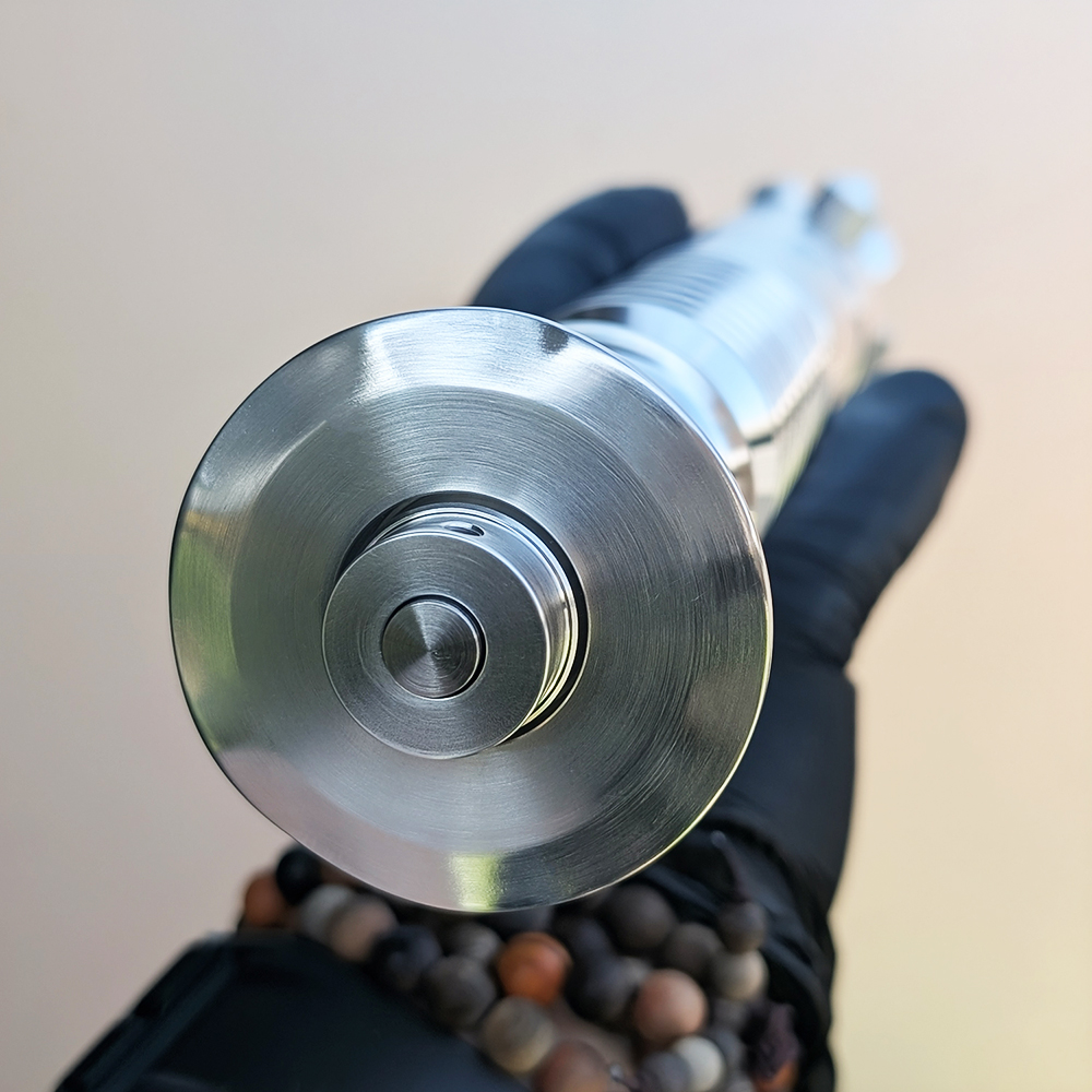

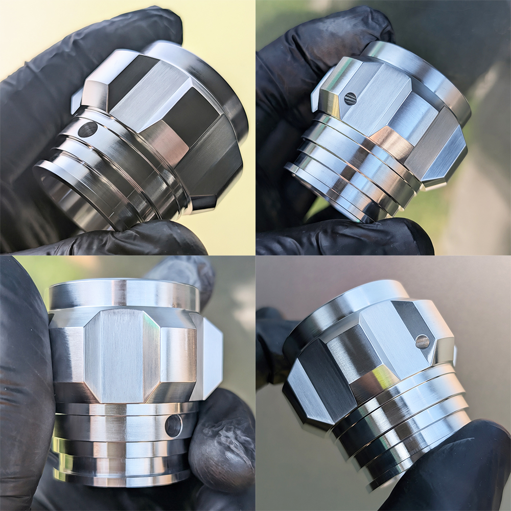

As for the other parts, I could not be happier!
Emitters are looking great once again, with accurate dents pre-machined. Just some minor tool marks to polish out, which is to be expected due to the nature of how they’ve been milled:
Bodies are pretty much ready to go, with almost zero work required. The only detail which was left off the drawings/models, is the “booster ding”. I’ll continue to add this by hand. Although the shared body sections from the previous order were based on the V2 profile, there was still a considerable amount of prep work involved. Expanding the internal bore to take the 8mm rod (from 6mm) is more work than you might think! Also, the fixing points for the pommel and the cone knob required drilling and tapping in the correct location. I can’t tell you how happy I am that they now arrive with all of this work already done!

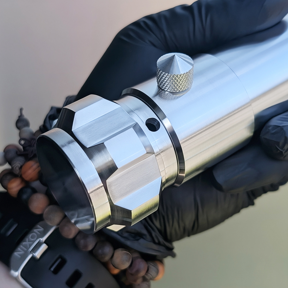

I’m always a little nervous about the knurling on the Cone Knobs. Whilst my drawings haven't changed, the one that was made for my first ever V2 run was less than perfect! I think the machinist simply saw it as being a knurled thumb screw, and that any knurl would do!
I have since explained that “close enough” is not “close enough”. I added very specific requirements for the pattern to the CAD drawings, and since then I couldn’t be happier with them.
As I said though, I’m always a little nervous when unwrapping these!
I’m happy to say that they have nailed it once again!
I’m looking forward to working on the clamps for these. As I mentioned previously, I was having to trim down the ends of the main clamp prior to forming them! This is one of the many things that have been slowing me down and has led to the run taking longer than anticipated. All of these things add up obviously.
I’m happy to say that this adjustment has been made in advance for this next batch (and all future ones) and they can be formed straight out of the box.

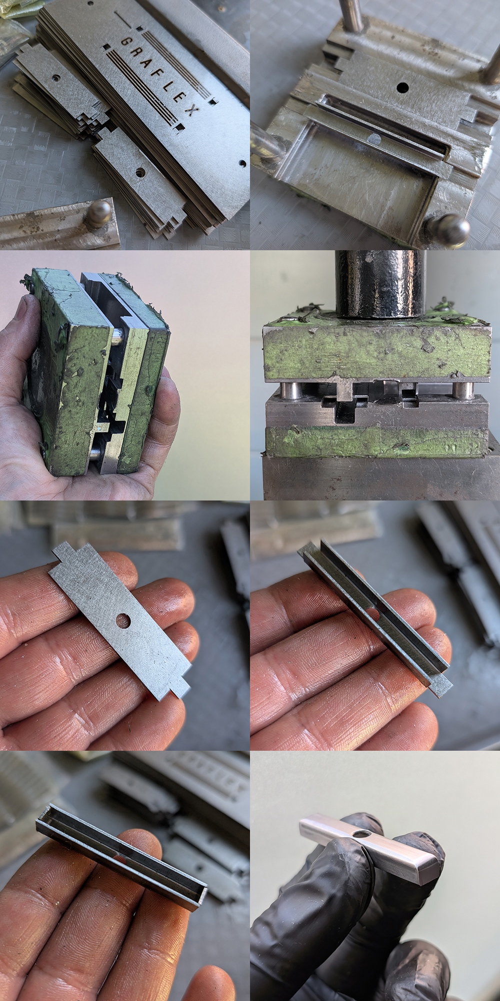

I had some serious trouble with the levers for my previous order. The manufacturer just couldn’t understand why I insisted on certain aspects of the design. I think the rounded tip and curved surface were proving tricky to machine on such a small piece, and whilst they did their best to accommodate me, the end result required some reshaping by me, as well as a lot of polishing to get them looking how I wanted.
This time around, they have really knocked them out of the park, and it looks as though I can send them straight to the chrome platers!

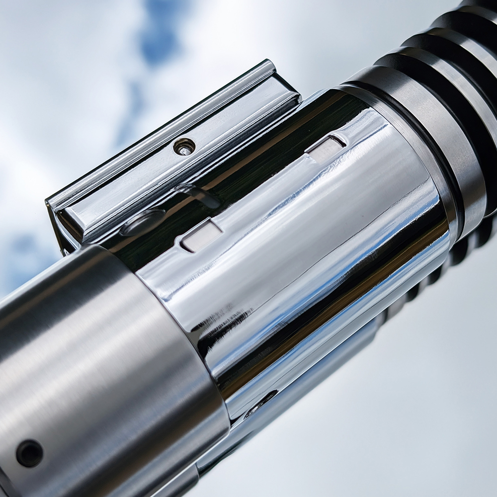

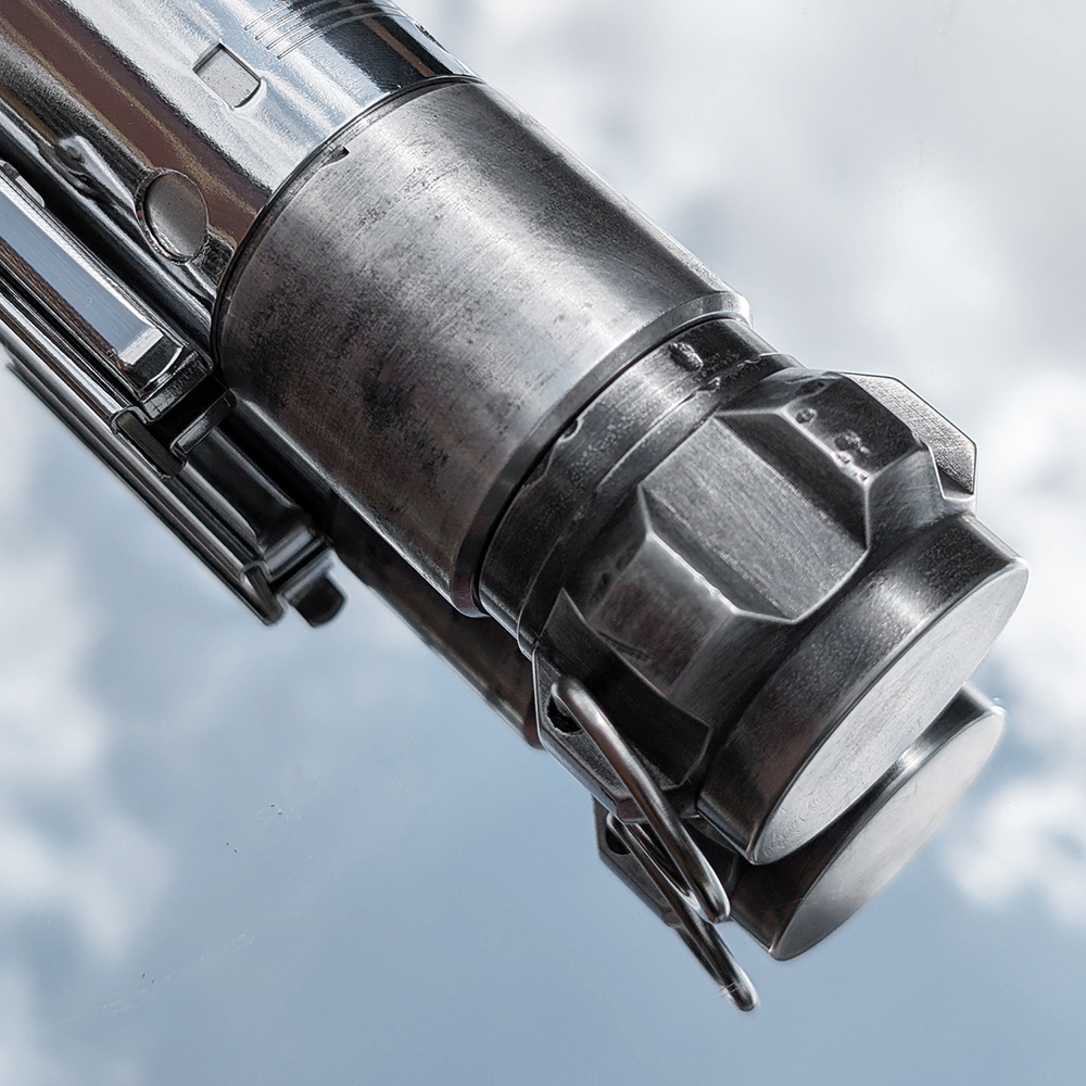

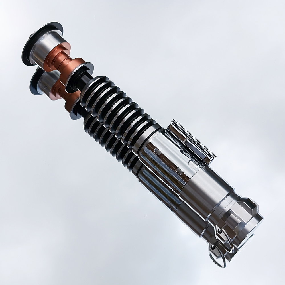

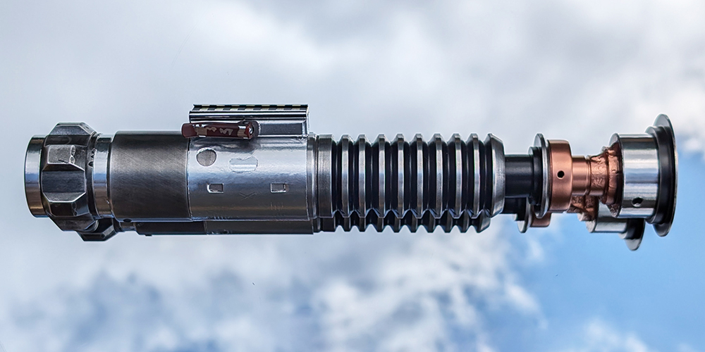

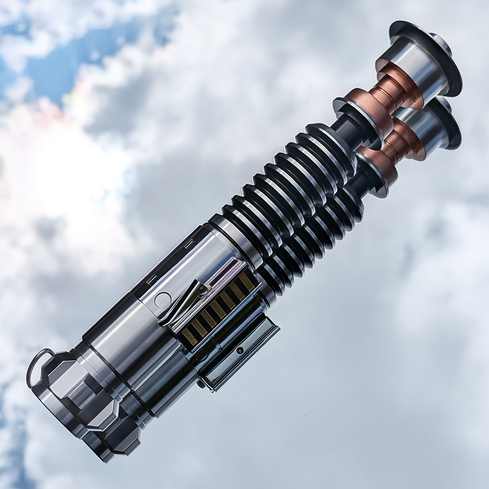

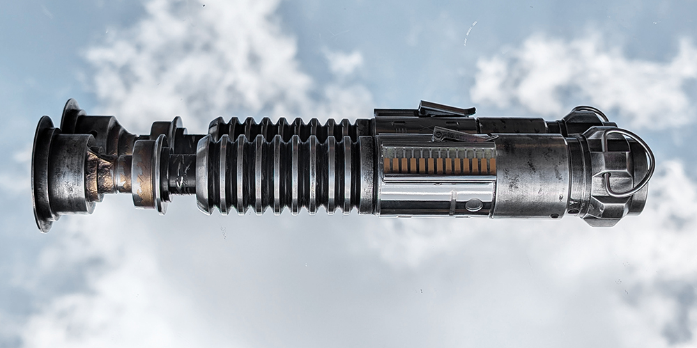

Here are a few comparison shots of some of the latest “N.A.S.A.” (post-production) and “Throne Room” (mid production) commissions:
For this batch I also completed a special request. I was asked to create an idealised V3 with no seams, clean paintwork, no chemical darkening, as well as some additional features. It has a nipple added to the emitter as well as an inverted clamp. This was primarily to create a clamp with no text (The sheet was rolled with the text facing inwards).
I really love how this turned out. Big thanks to Zachary for the opportunity to work on this and create something a little bit different. I hope you enjoy it as much as I’ve enjoyed working on it for you.

Batch Six did eventually ship by the middle of last week and I have been busy working on V2s ever since.
After a good tidy up of the workshop, I have unpacked all the parts for this final batch.
The replacement pommels arrived last week, and I have now had a chance to check them all over.
I couldn't be happier with how they've turned out. We now have sharp internal corners! The use of the end mill to achieve this does result in more tool marks which obviously require some clean up. This is obviously an acceptable trade off for the improvement in accuracy.
The emitters also require a little bit of clean up due to the way that they are machined. I'm still so happy with how these have turned out though. Adding these details by hand (using a jig) never really gave the desired definition. There is always some recoil/spring-back when cold forming metal. By having the details machined, we're able to replicate the exact details, as captured in my models from the available references.

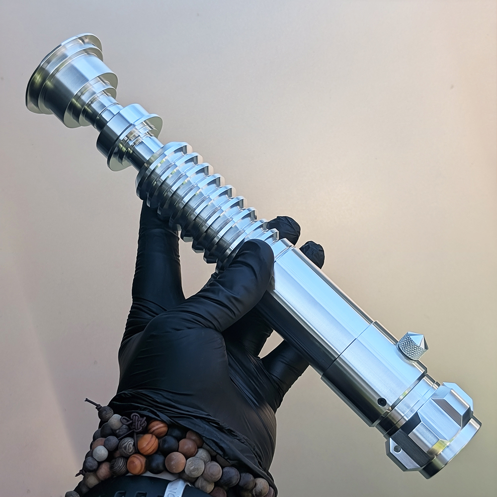

So, I spent some time this week polishing up the aluminum parts. DIY kits are just waiting on clamps now.
I assembled one of the kits just to check that everything is fitting together as it should, and that the threads are all correct. Everything is looking great! The body sections require zero work and can be used straight out of the box! This is such a welcome change to the previous batches! No drilling or tapping!
My next priority is to get the clamps for this batch formed and send out for plating. I have made a start on these this week and expect to have these out for plating early next week!
It's a lot of work, but I have to say, I'm enjoying forming them straight out of the box now that I've corrected the length. I was previously having g to shave 1mm from each end of the clamp sheets.
I've also expanded the hole in the clamp bar. For the V2, there is just the one bar obviously. Genuine clamps have a rectangular hole in this bar, which I would drill as part of installation. This means that the clamp can be tightened in-situ.
For the previous batches, I had the bars made with the smaller hole and expanded half of them myself. This time around I figured I'd order them with the larger hole to save me yet another job.
I made a good start on the sheet metal work this week and expect to have the rest done early next week (if not by the end of Monday).
These will then be shipped out to my plater ASAP.

The announcement thread for the August 1st Yuma / I.S.Y.H.C.A.N.L / Hero run remains completely written out and ready to post (pending artwork). I thank you all for your interest and patience. I’ll get this posted VERY soon!
