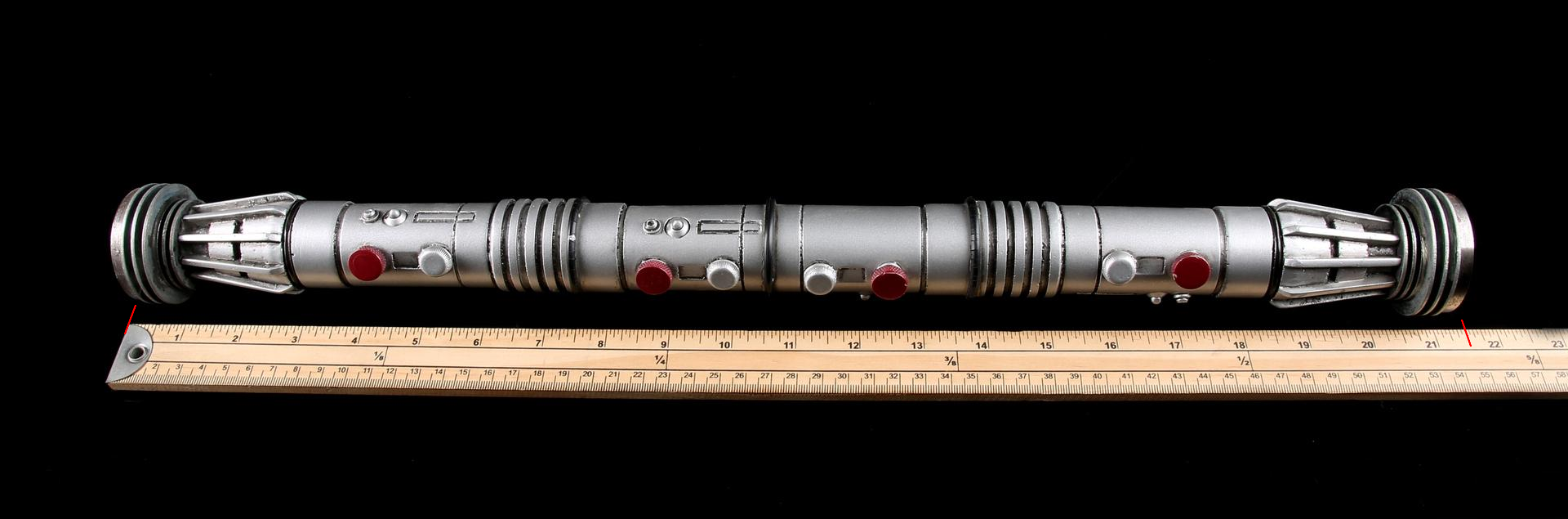

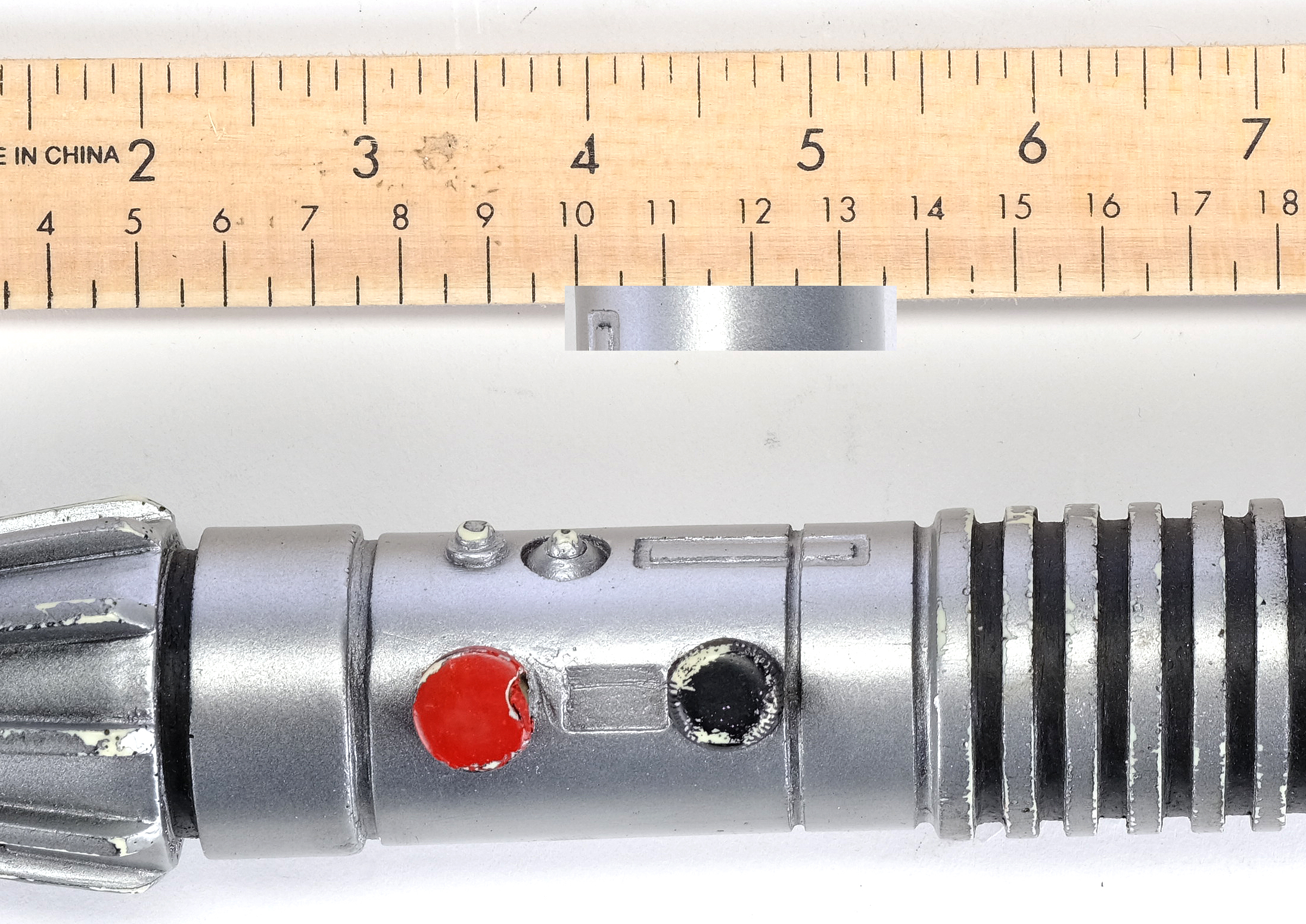

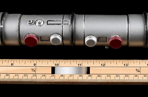

I dont really believe the prop is 53.5cm or 21 inches long. Descriptions always round up or down. In that same post you can see the image where the hilt is longer than 21.5 inches

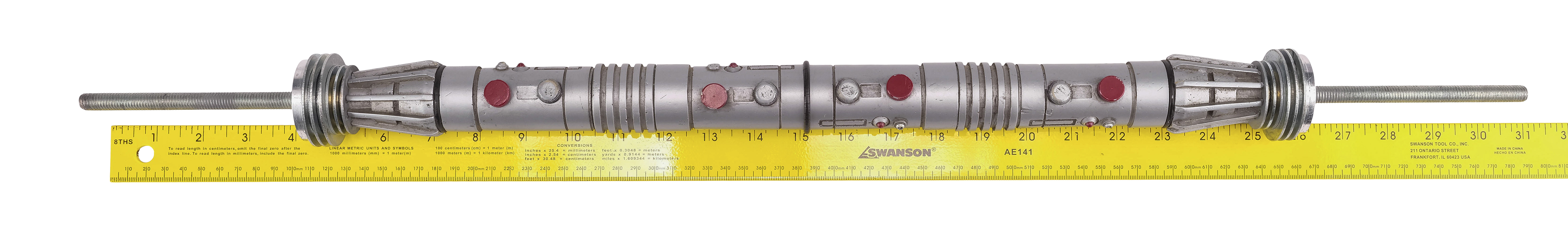

Here is another prop that is clearly more than 21 inches long (almost 22). It starts at about 4.25 and ends about 26" so its like ~21.75"
Sorry, i don't believe its smaller (shorter).

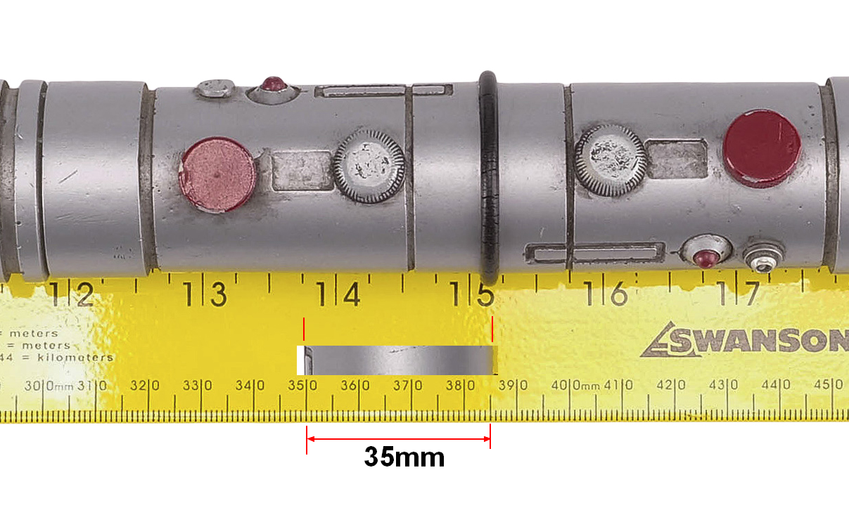

Regarding the diameter, I dont have the actual prop to measure it but using the above image I estimated it was close to 35mm. I wouln't dare use any other makers size as reference, even if they had an actual prop. So all i have is those images.
The prop image i used for reference is a cleaner cast which leads me to believe it's an earlier cast from the master, and as you know resin shrinks.
Not saying mine is the correct one, just saying how i came about the 35mm diameter. I have used this technique with all the clans I've made.

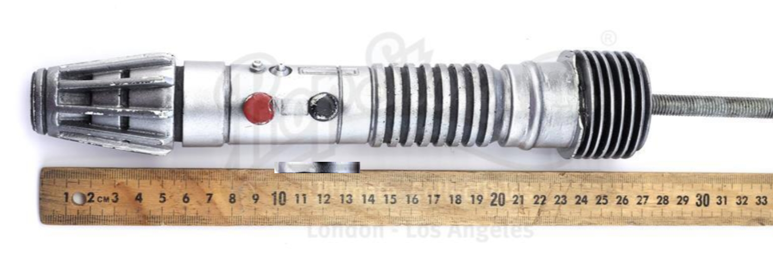

Here is a plo koon prop that was also casted and against the ruler it's also 35mm
Here are 2 more

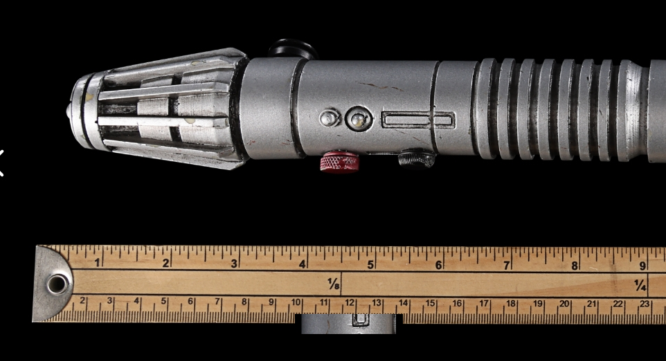

And last but not least, the image from the prop you referenced. I wouldn't trust this one that much because its at an angle and not a top view like the plos. But its about the same

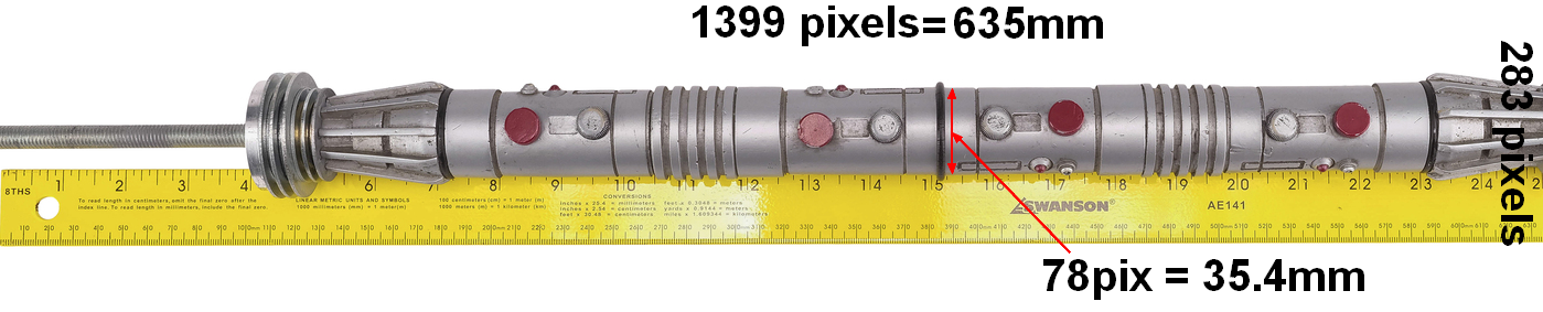

Another way to estimtate the diameters is to cut the image so that the ruler has an edge to edge disctance and we can use pixels.
Anyways thanks for sharing and I hope this clarifies where my measurements are comming from. I do understand that the diameter that i am using on the pics are closer to the camera than the rullers, but the focal distance seems far enough to neglect size changes.

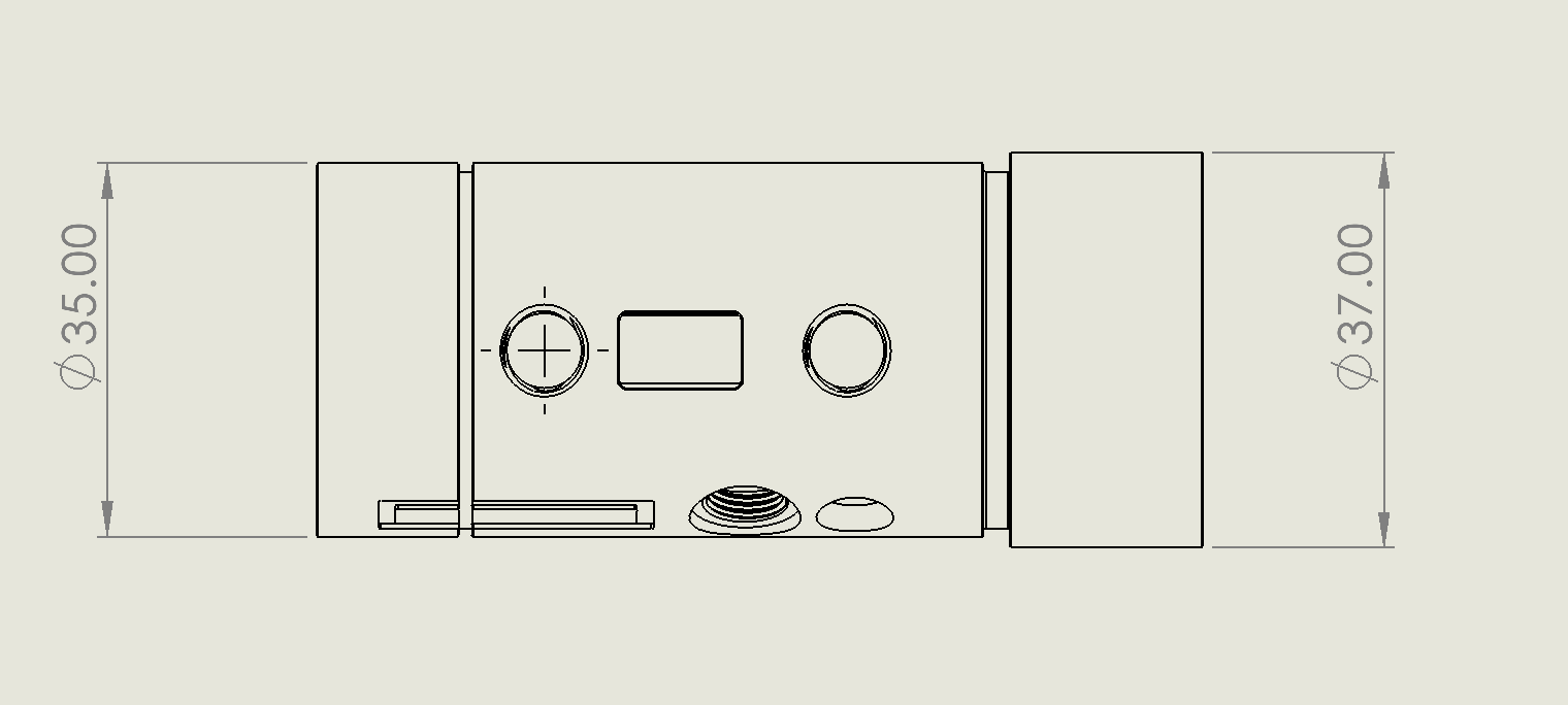

A prop maker by the name of Troy Sente sent me an original part that was used ot make the silver button. I 3d scanned it and adjusted my 3d model to match it. The red button I do not have an actual one but I was able to get the measurements from someone else.
