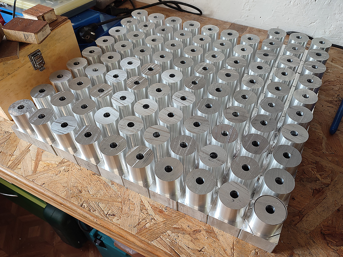

You know, facing parts is an under appreciated thing. I once got just a 2cm long disc of aluminum from a shop and they must have just hand thrown it on the bandsaw. That thing was so crooked… a friend on here fixed it for me in his lathe and I got back this part with just a perfect flat surface with the rings and I was soooo thankful
The cubes of aluminum have an interesting look to them, lined up like that.
Very durable floor tiles, say.
Ahah yeah my wife wants me to do a table with this, I told her it would be a very expensive table... :-D

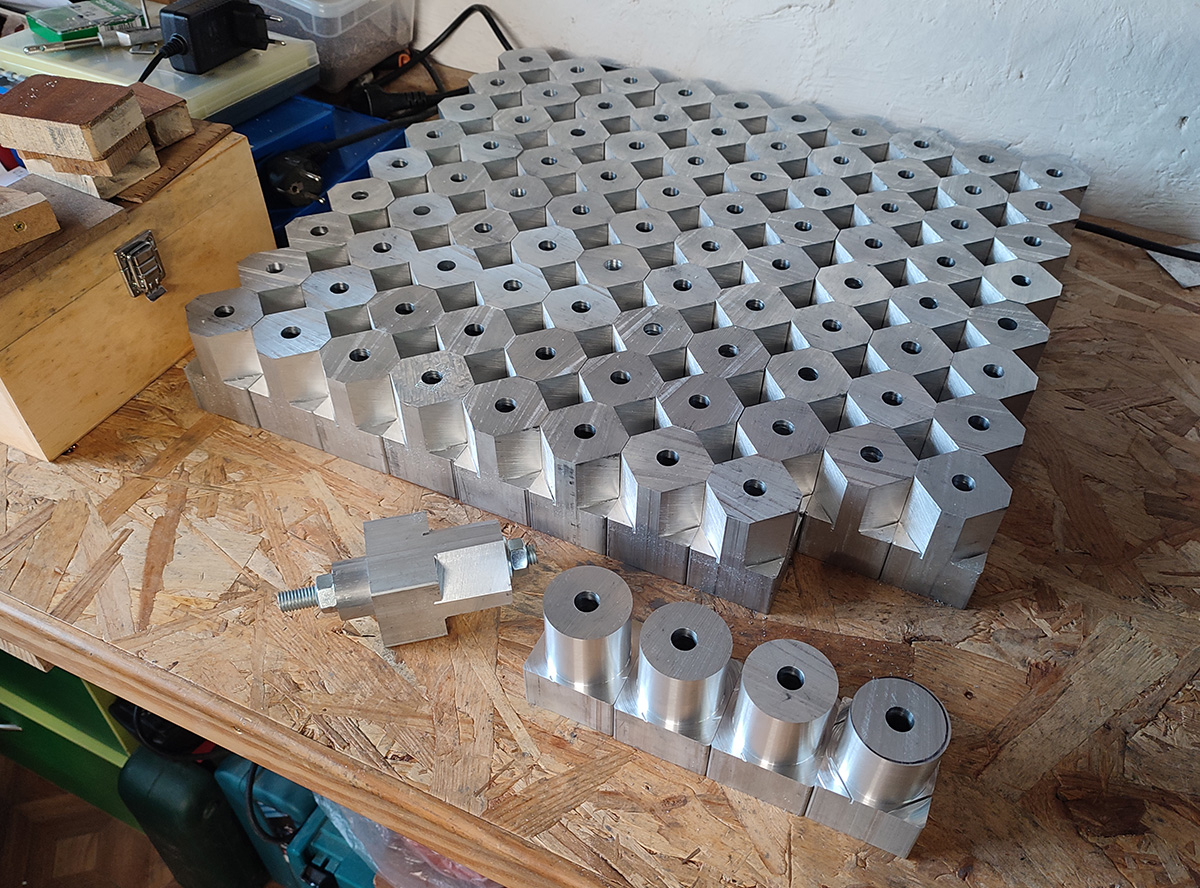

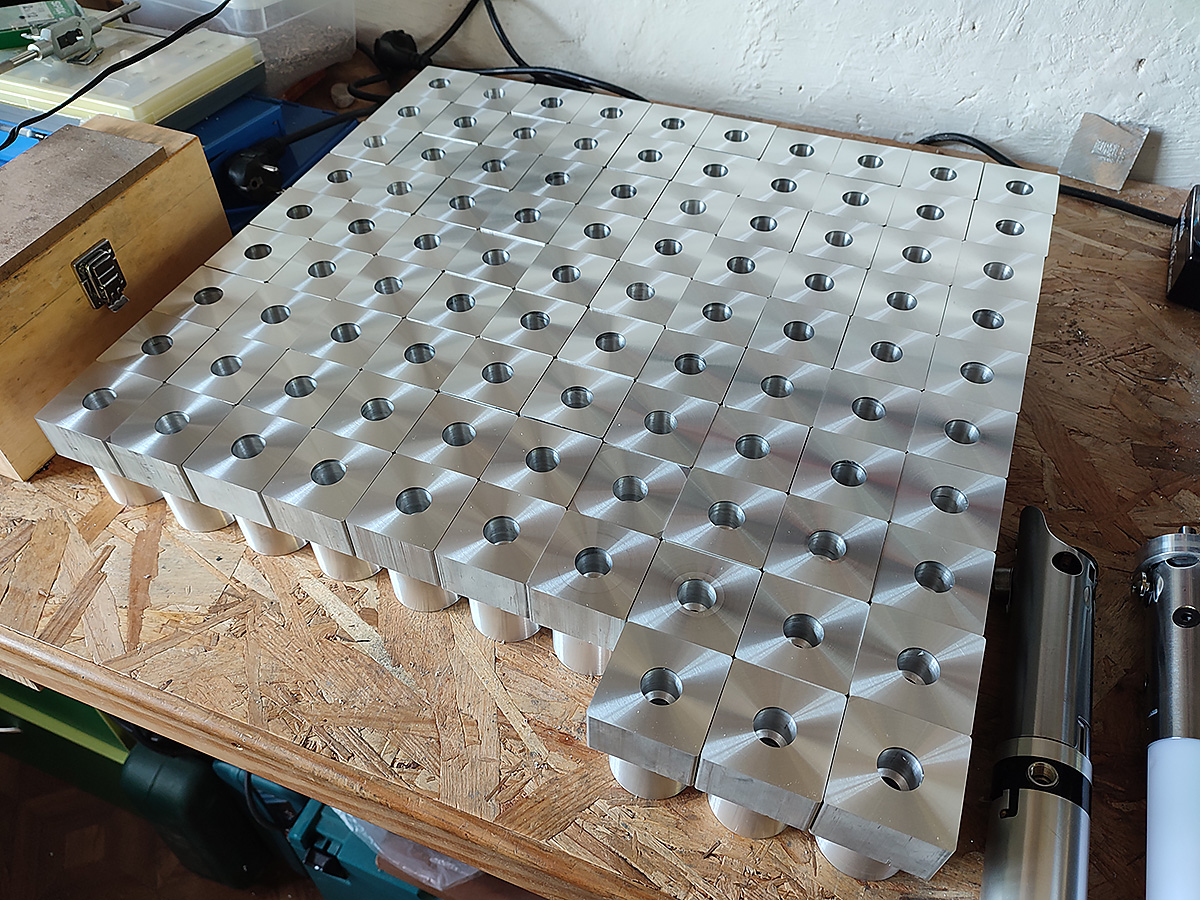

and the main course! the shrouds! Drilling a 12mm hole in the center so I can put a threaded rod and put it on my lathe chuck, and rought shaping the front with the band saw to remove material quickly and avoid going crazy on the lathe with the square shape. Damn! that doesn't look like much but this was already some work!
Now starting the long and difficult part of turning down the front until it's round so I can turn it around and chuck it without the threaded rod to work on the back:

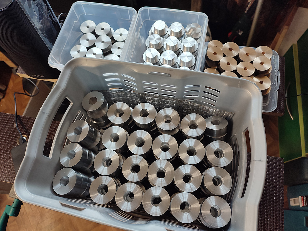

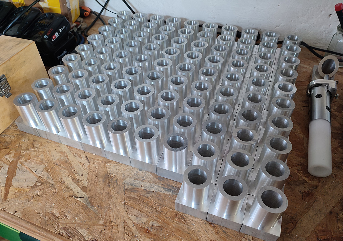

all shrouds are now cylindrical in the front, this is not the final size, it's a first approximation, to be able to turn the part around and put it in the lathe chuck, but this was the most time consuming step for the shrouds, so it's a good thing done :)

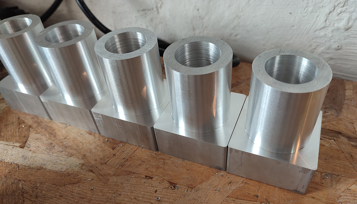

after that, the part is turned around and I cleaned the back face of the shrouds, first final surface for those :
and i started turning down the back of the shrouds for the tubes bodies to fit, that's the second time consuming step for the shrouds:

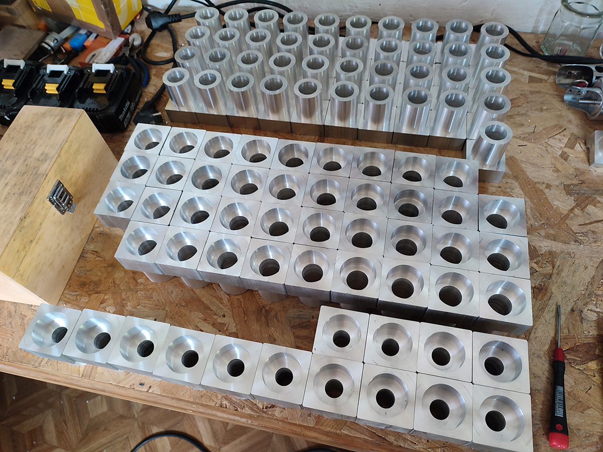

I finished emptying the back of the shrouds and started on the last 2 lathe opperations:
as explained in the wip thread and first page here, the inside is volontarily slightly rough for screen-accuracy. As you can see the final outside surfaces are pretty damn clean though :)
all of the square part is still raw and will be machined on the mill when the lathe opperations are finished on all parts. The final square is a few mm smaller than the base square stock. and this is when I can add the assymetry visible on the real prop as well.
the storms are still happening for now so progress is still slow even though, like I said in the previous post, I'm not really delayed so far as i'm working everyday every moment I get to use the lathe when there is no thunder.
Those last two ops are pretty time consuming, so it will take a small while, however, that will be a good chunk done for the shrouds when this is finished! For info, time wise, the shrouds are currently 35% done :)

Hello there,

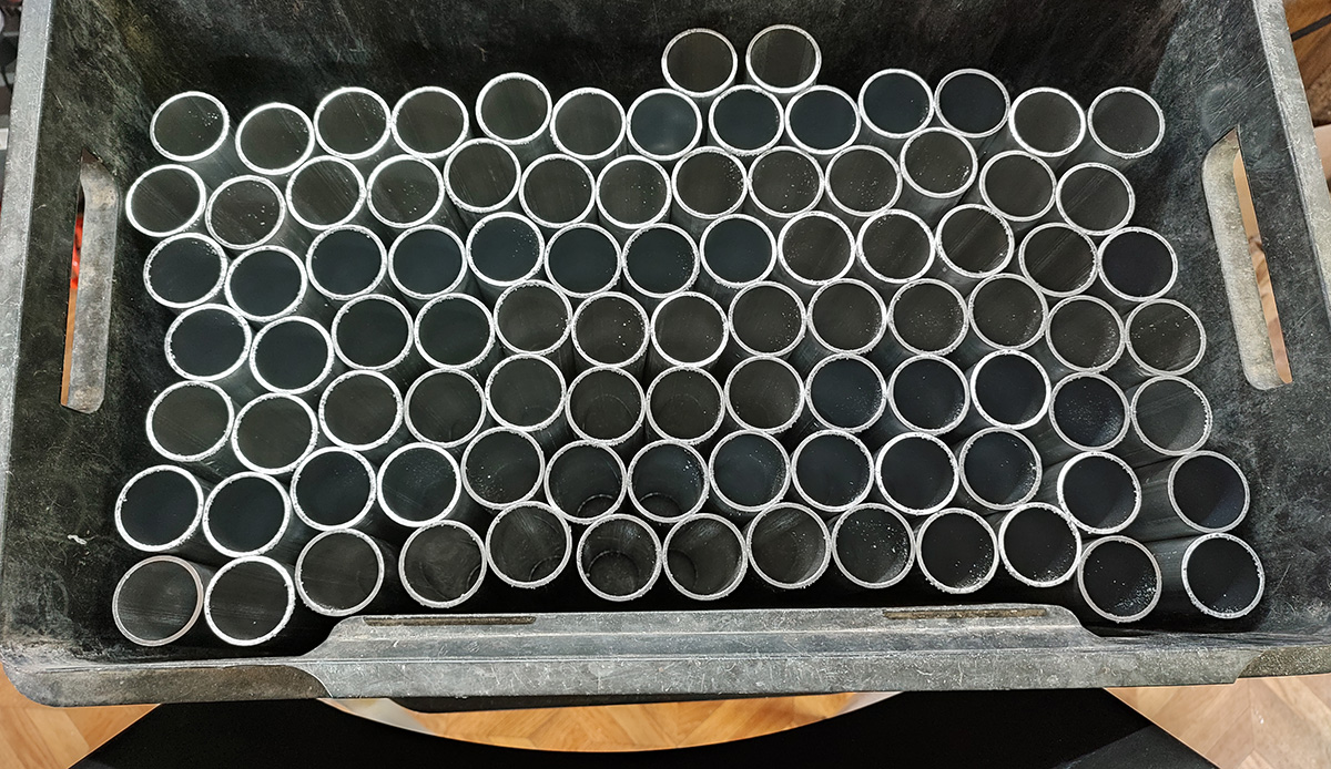

I finally finished all turning opperations on all the shrouds! those last two ops were a real hell! I didn't forsee when prototyping that doing this 93 times would be much more difficult and it definitelly took more time than planned, but it's all done now! damn! I'm happy this is finished and I can now move on to milling on those :)
I also cut all body tubes today, so that's something as well :)
cheers

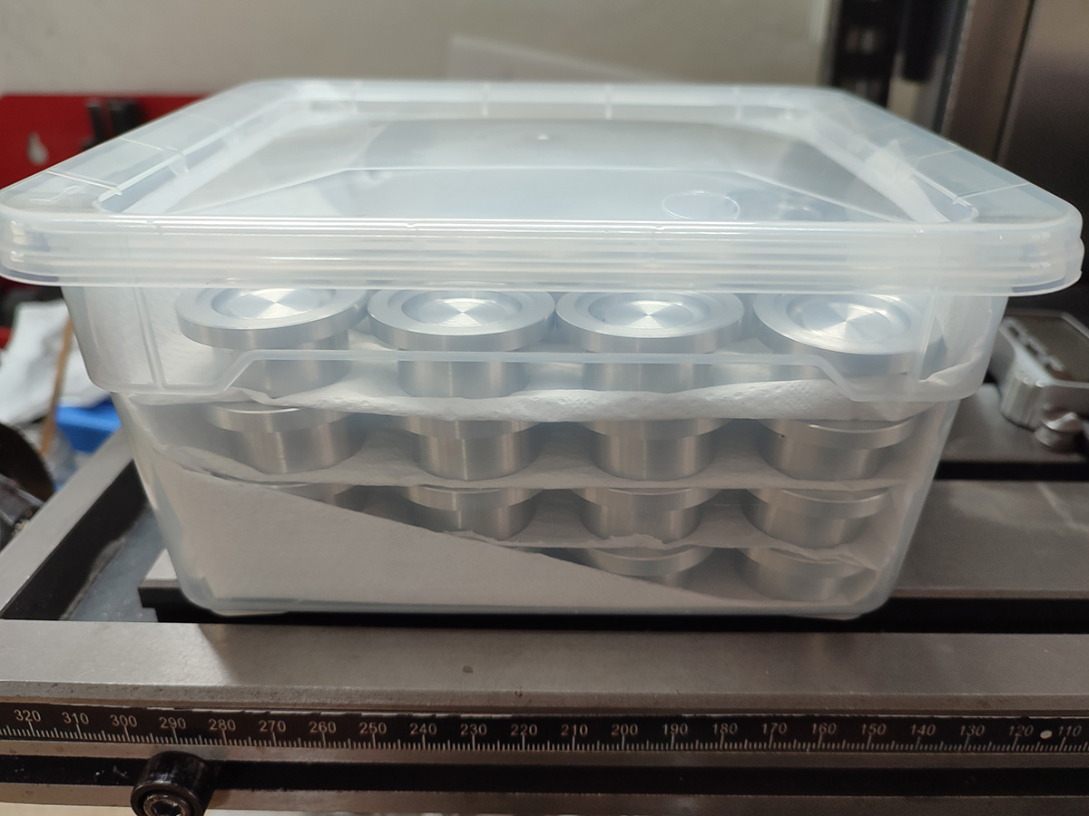

Hello there,

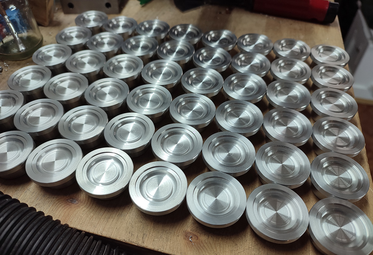

first part of the list finished! the back plugs for the Barbican version + a few extras if people want those for another version also or to buy individually.
I'm very happy with the result, my fabricated tool for the half round groove worked a charm for the whole run, all perfect!
now, all carefully stored away with paper towels in between so the parts stay pristine until the end of the run :) I see some guys from shops tossing aluminium parts into bins when they get out of the machine, makes me sick ahah! with all the time spent on my parts, I want them to stay perfect :)

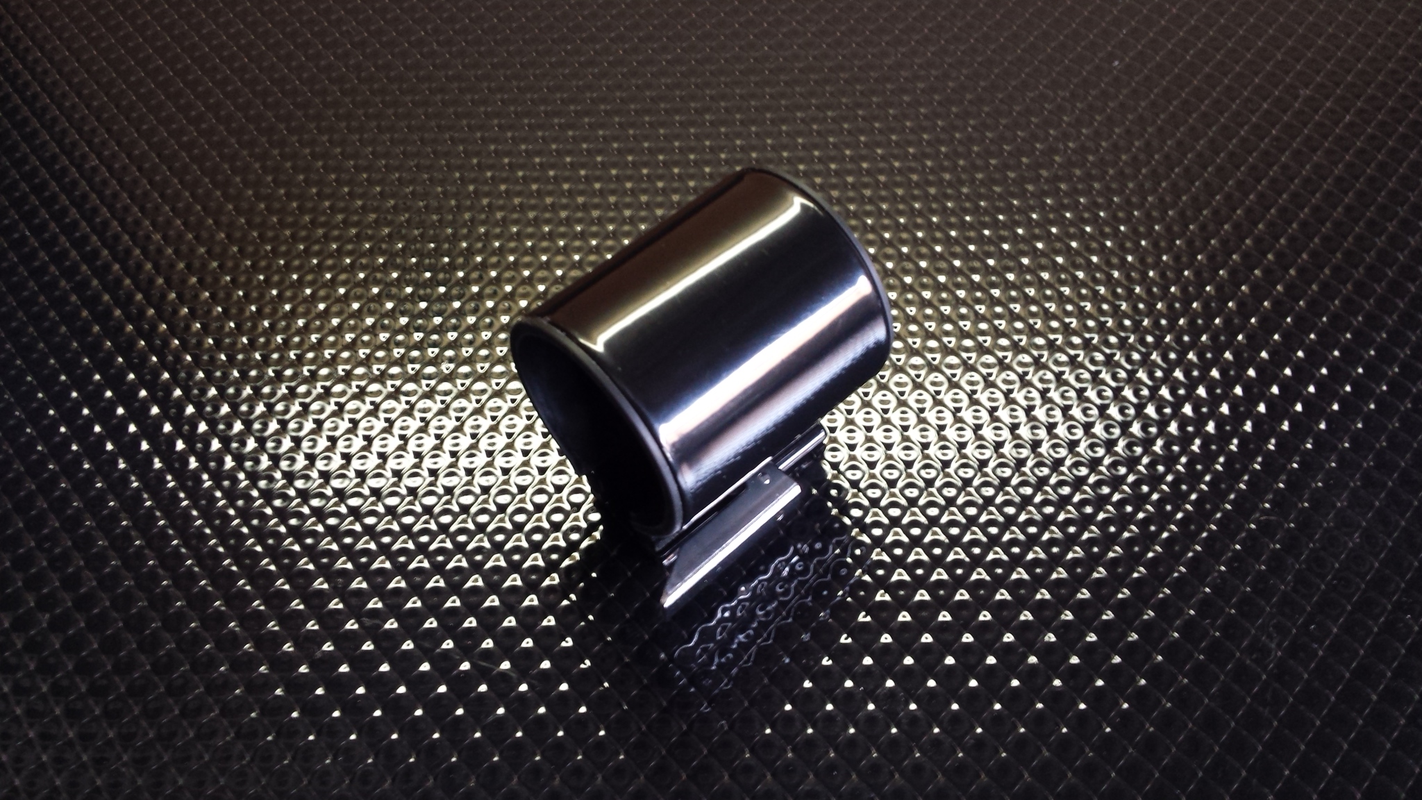

MPP clamps are now available on my site for pre-order. To make sure there are enough for this project the order page is password-protected ATM. Password is: RPF
MPP Archives - Roman Props | Roman's Empire

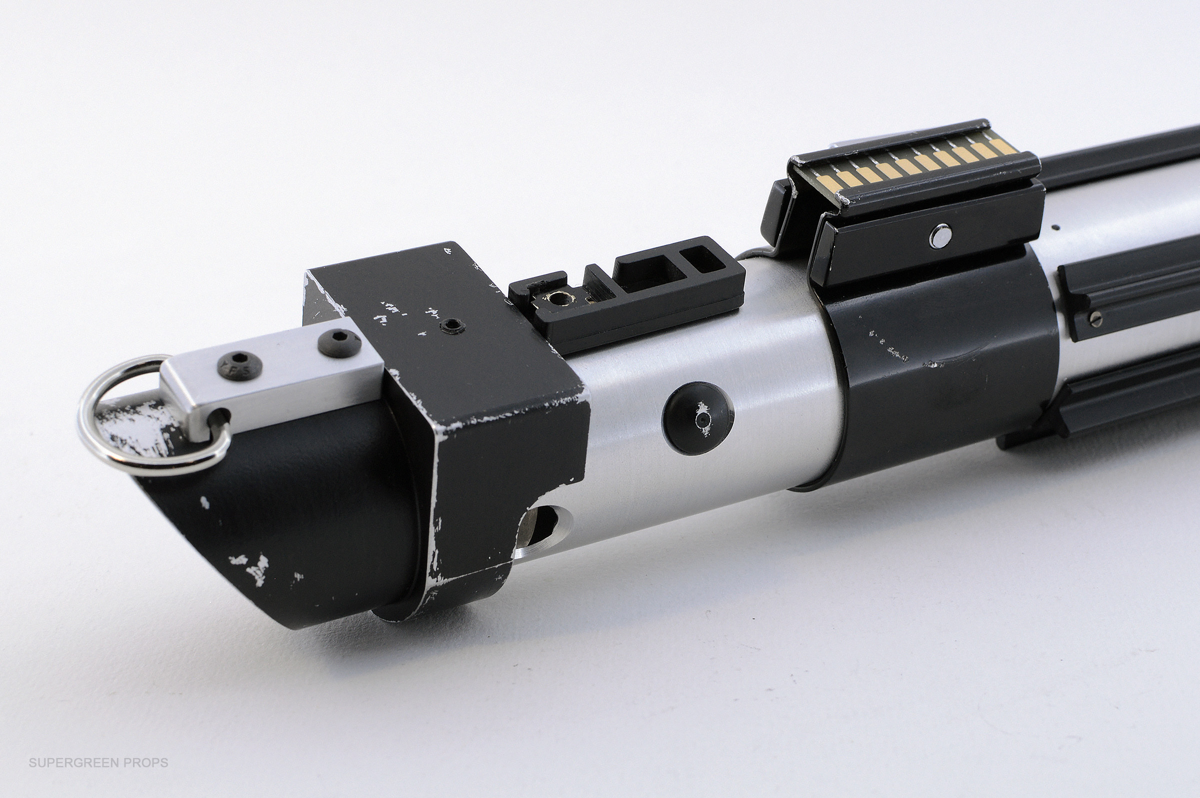

Clamp question: all three would be black sidebar clamps, correct?
well, the Barbican and severed hand are black sidebars version for sure, for the square shroud, no definitive proof for ANH, but since this is the same saber that was modified to become the Barbican later on, and we can also see black bars on square shroud from ESB, I would say yes as well for the square shroud saber :)
