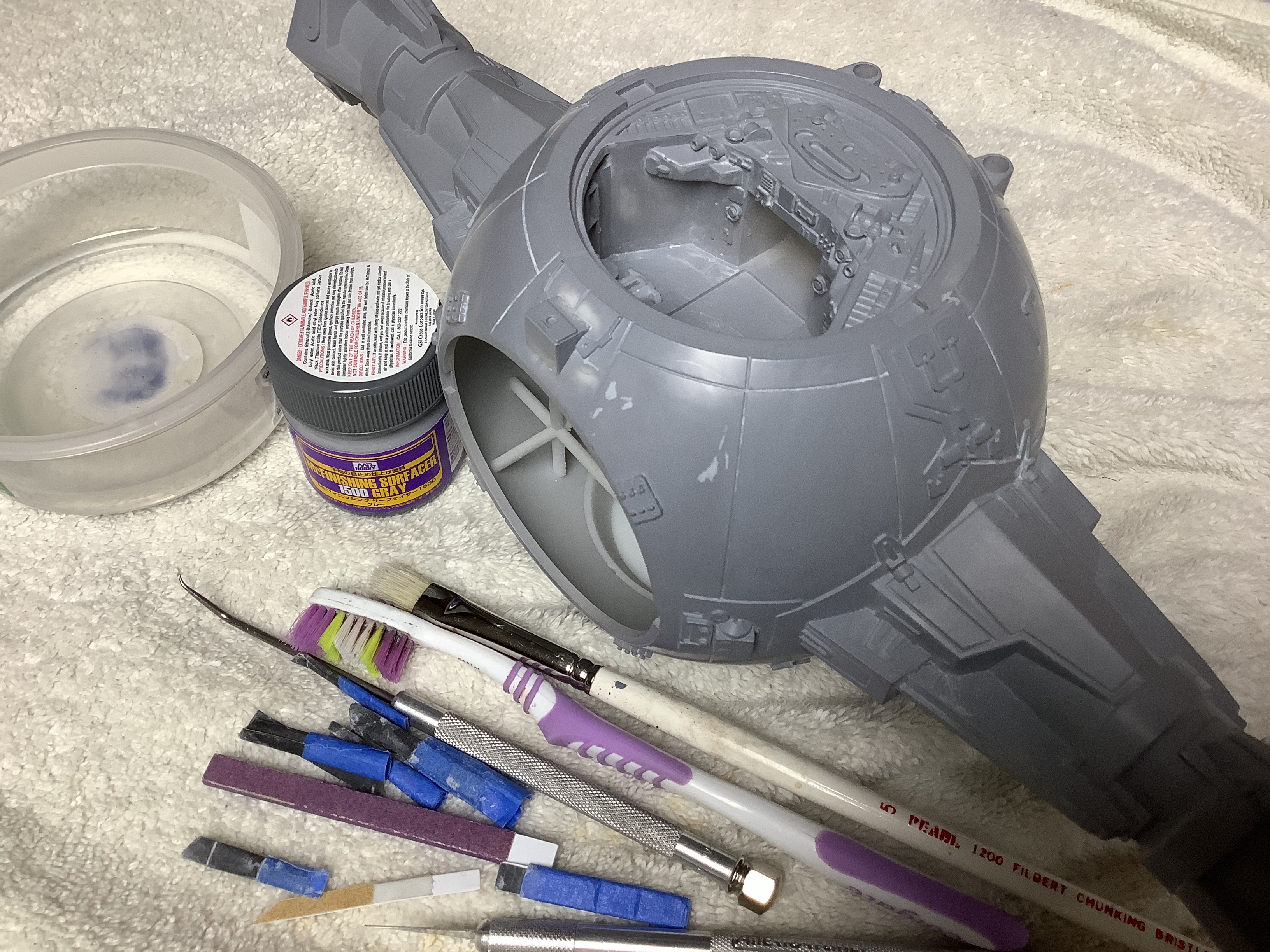

I have a quick update to share. There are some impurities in the factory applied primer and some artifacts left over from the 3D printing process. I am using 1,000 grit wet dry sandpaper and Mr Hobby 1500 to clean things up.
More to come soon. Thank you for looking.

Hello, I have a quick update to share. I have been working on the Tie interceptor, using a scribing tool to clean up the panel lines and some 1000 grit wet dry sandpaper to buff out the primer. I should be painting the interceptor with the base color soon.
