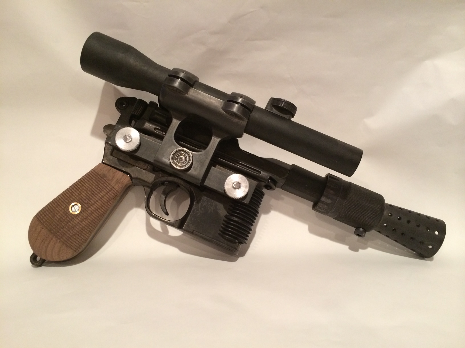

What a fun day. I still have to blacken the scope nuts and adjust the color on the scope and flash hider, but the machining is done. I was not happy tapping for the scope mount in the thin metal ammo magazine, so I added a 1/4" brass plate on the inside of the mag and bondo'd it in. Then drilled and tapped through the combination of the magazine side and the brass. That gave me a really good thread depth. Blackening the aluminum is a struggle. I used up all my PAX Al Black and will need to buy some more.

What a fun day. I still have to blacken the scope nuts and adjust the color on the scope and flash hider, but the machining is done. I was not happy tapping for the scope mount in the thin metal of the ammo magazine, so I added a 1/4" brass plate on the inside of the mag and filled the void with bondo. Then drilled and tapped through the combination of the magazine side and the brass. That gave me a really good thread depth. Blackening the aluminum is a struggle. I used up all my PAX Al Black and will need to buy some more.

Made a lot of progress in the past few days!!
