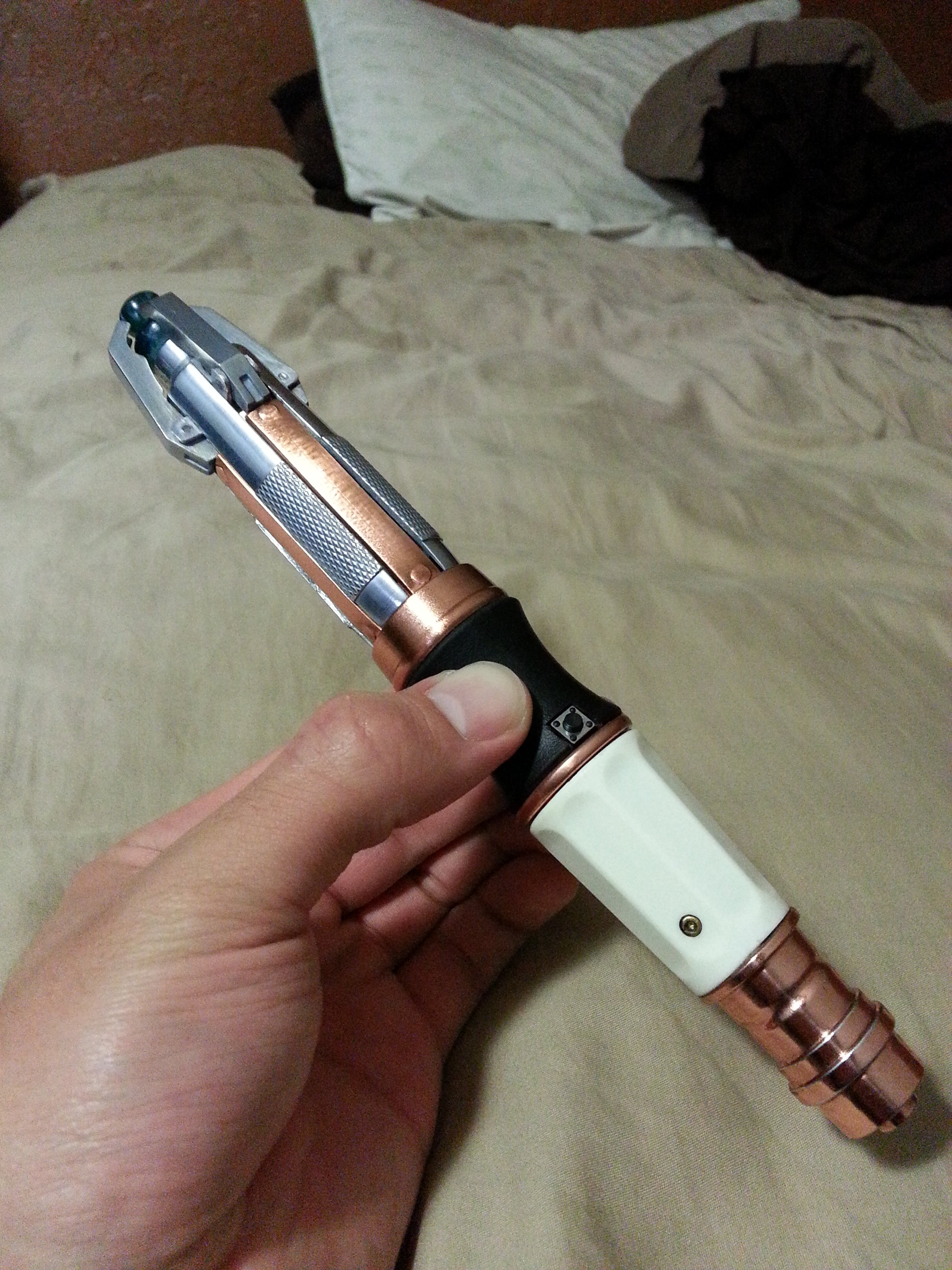

The standard sonics use the claws that come with the remote and are held on by 4 individual L shaped brackets. While they look quite nice, when opened one can see the claws are hollow on the inside. (see image below) The new claws are waterjet cut from 3/16th aluminum are completely solid and thus more accurate. The new claws are mounted to the sonic via a single cut piece that holds all 4 claws at once like the original prop.

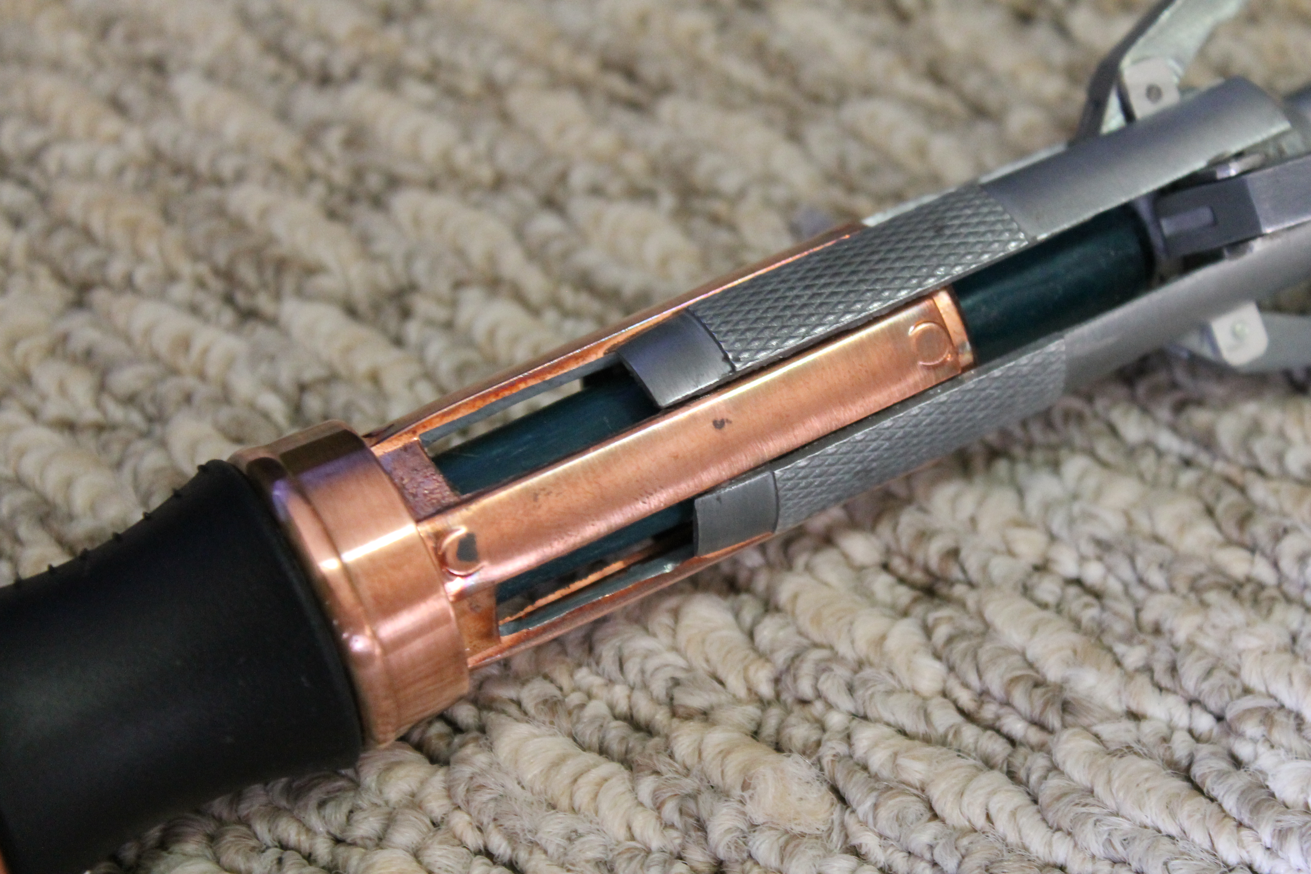

A bit of an update, i currently have 6 sets left of the deluxe claws, so if anyone wants either a completed deluxe sonic drop me a line. These last sonics will also feature simulated brass rivets on the copper cage.

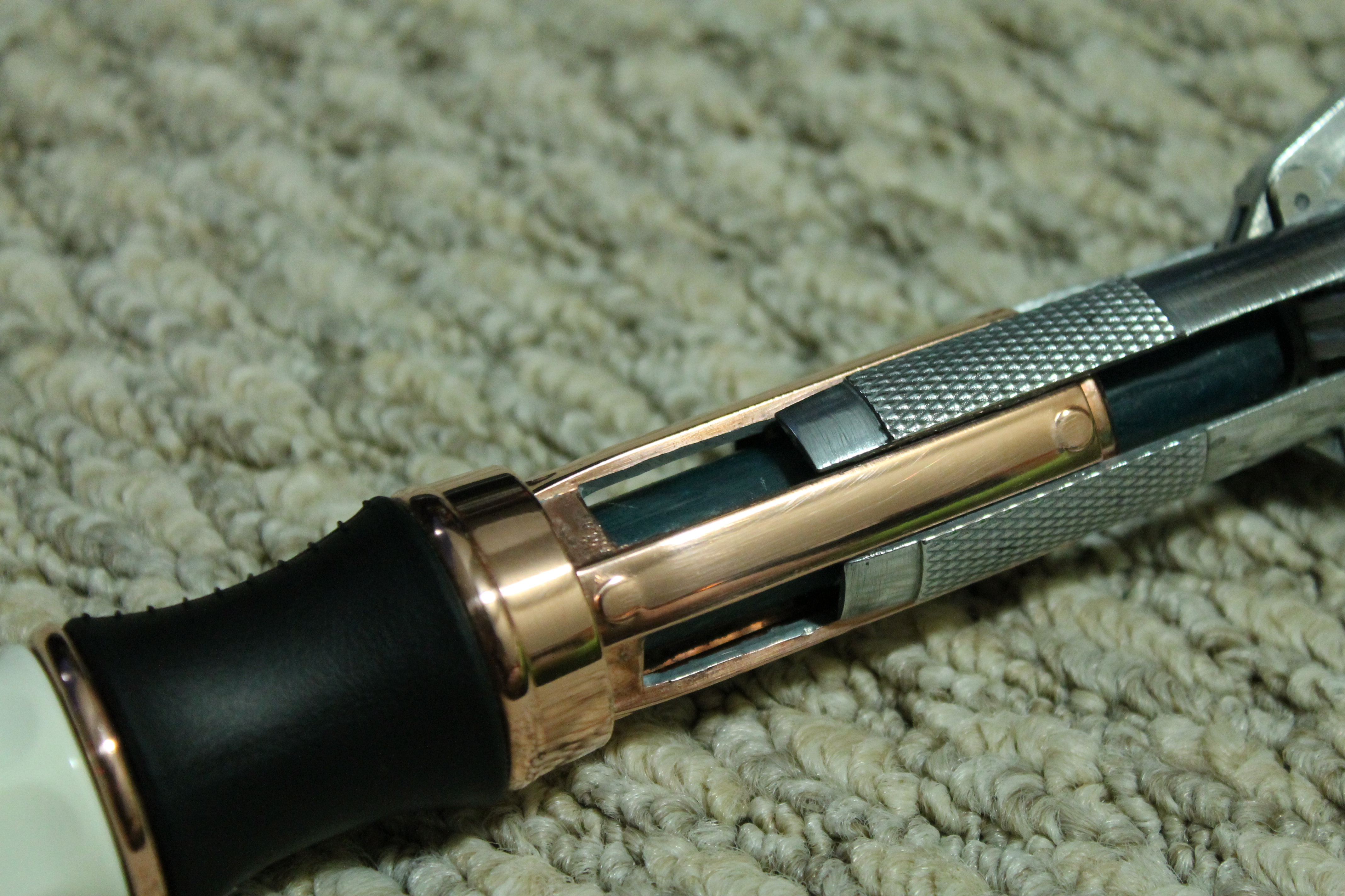

While subtle, I think they add a great deal to the overall aesthetic. Perhaps I got a little too enthusiastic with the steel wool when polishing this up. This last batch of the deluxe sonics will all feature the brass detailing. Furthermore, they will also have a copper/brass coupler in the middle for greater durability. It will take a while to wear in and get a fluid flick, but It will get there. I almost forgot to mention, the fillister screws are back! Anyone who wants one of these will get the choice of the brass fillister screw or the black allen head screw.

Looks fantastic, man! Although the emitter crystal looks a bit on the blueish side... In any case, I love the finish. It's just the right balance between shiny and not-too-shiny. And it looks great with the brass rivets. How are they attached?

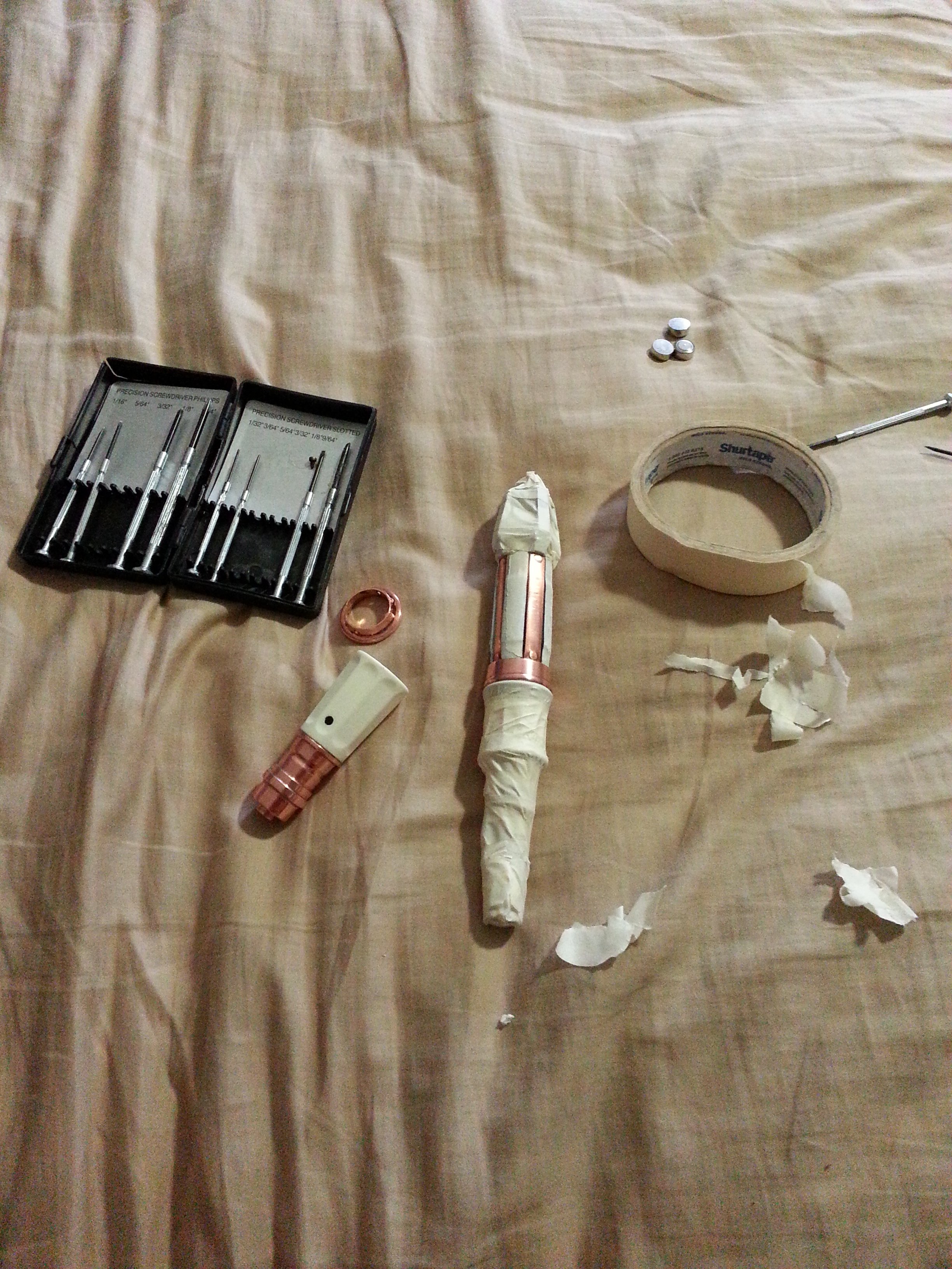

Has anyone had any problems with their sonic tarnishing/oxidizing on the copper parts? I'm not sure if it's because of the way I polished it or if it is just something that always occurs. I've tried using renaissance wax and haven't had any luck.
The way I polish my sonic:
1) I use the #0000 steel wool
2) Clean up using Cape Cod polishing cloth
3) Apply thin layer of renaissance wax
Maybe if I skip the Cape Cod cloth? Also one of the pins securing the claws seems to pop out when I flick it. Any ideas on how to secure that would be awesome.
Re: Completed 11th / 12th Doctor Sonic remote conversions Last call for deluxe sonic
To secure the pin apply superglue with a toothpick to the inside of the claw where the pin sits.
As for the oxidation of the copper, that is perfectly natural. i have never used renaissance wax so im not sure if it would slow it down.
I should note that if you are using the cape cod cleaning cloths, you can actually just skip the steel wool. Just wipe the piece with a microfiber cloth after the cape cod and your done.

I solved my oxidizing problem on my sonic. I was sick of having to polish the screwdriver every day, so I decided to use some rustoleum clear enamel on the copper parts. Its been a few days since I've applied it, and no tarnishing effects! I gave the metal a good shine before applying the clear coat, and it still has a glossy shine to it.
