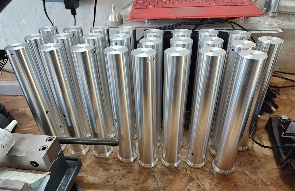

Hey there, quick update, almost there with the square shrouds sabers, sorry life really is extra difficult with us lately and my wife health is worrying us a lot so things are slow.
Here is a quick video, if it works, of how my small workshop is drowned in parts!

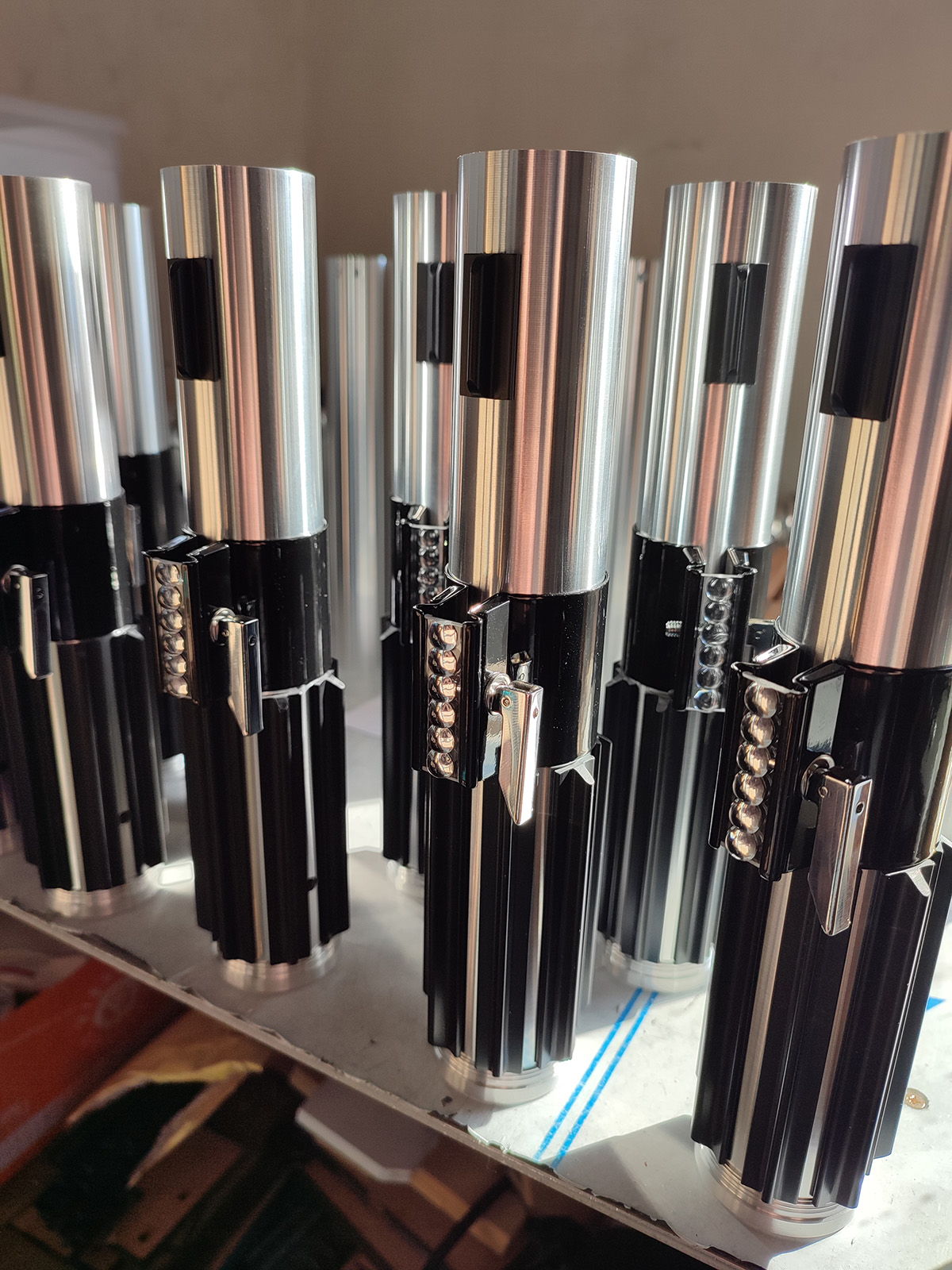

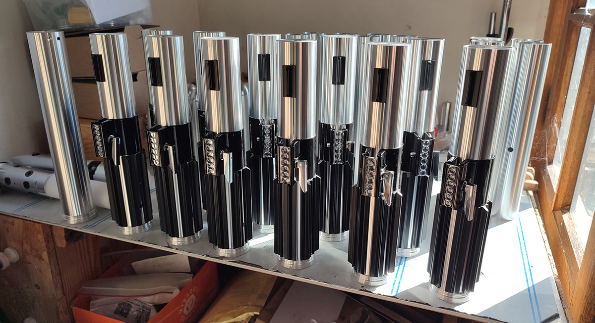

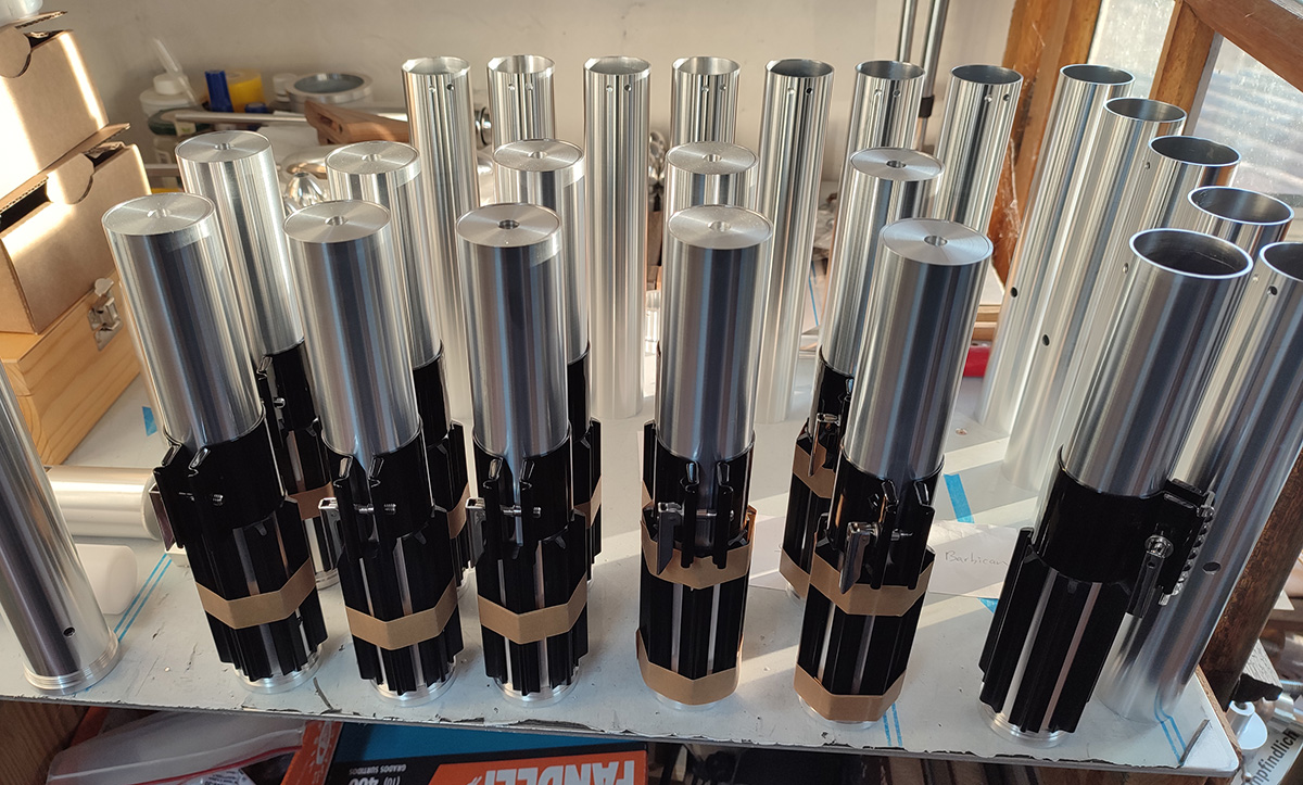

Hello guys,

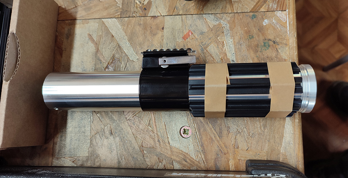

here are the finished Square shroud tubes. I have glued the end caps with E6000 as well as attached the cores for everyone. It just made sense to do it as it's a bit annoying to do and it will be easier to pack in 1 part instead of 3 :)
the WIP finished square shroud sabers, I have decided to put a few on the website when I open the sales for the square shroud people only. Just made more sense than explain, alright for the people that are only on the list for a square shroud kit, for the people that want a finished square shroud, you'll have to wait for the main run to be released.
There are 7 people on the list for just a square shroud, 35 square shroud in total, and 10 will be assembled, so i'll just put 3 finished saber with 7 kits and see where this goes :)

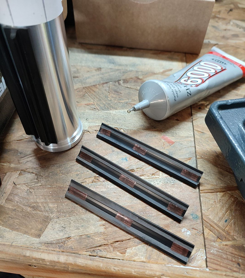

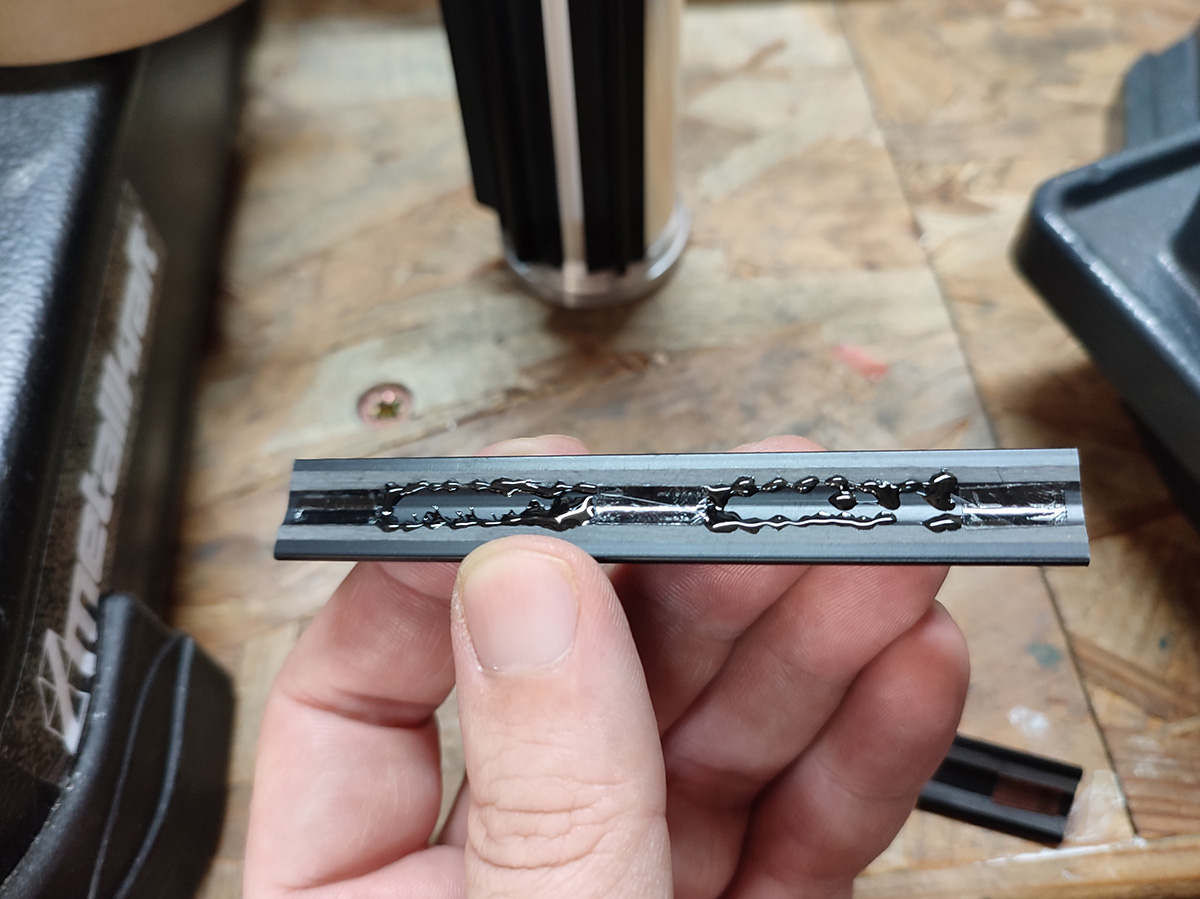

now, this is not a tutorial or anything, this is just how I attach grips that have no screws to be able to attach the 7 of them in one go and not have to do one grip per day or something.
I carve a bit the glue channel to get a better contact, attach 3 small pieces of thin VHB tape and put E6000 glue in between the tape. The tape holds the grip firmly while the glue dries and it's rather quick to put together. I don't know, it's just my technique :)
oh yeah, and I generaly put tape or rubber bands to be even safer, even though E6000 doesn't really need pressure.

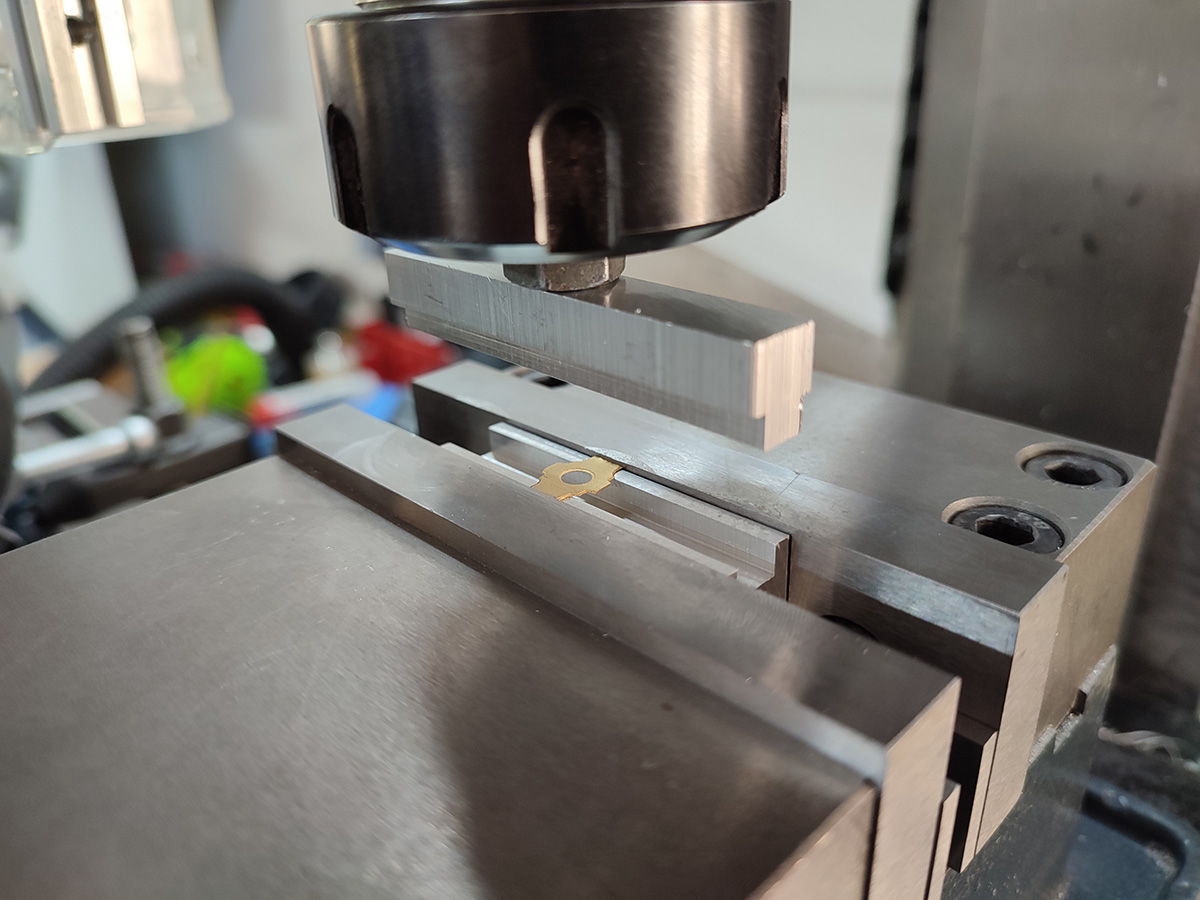

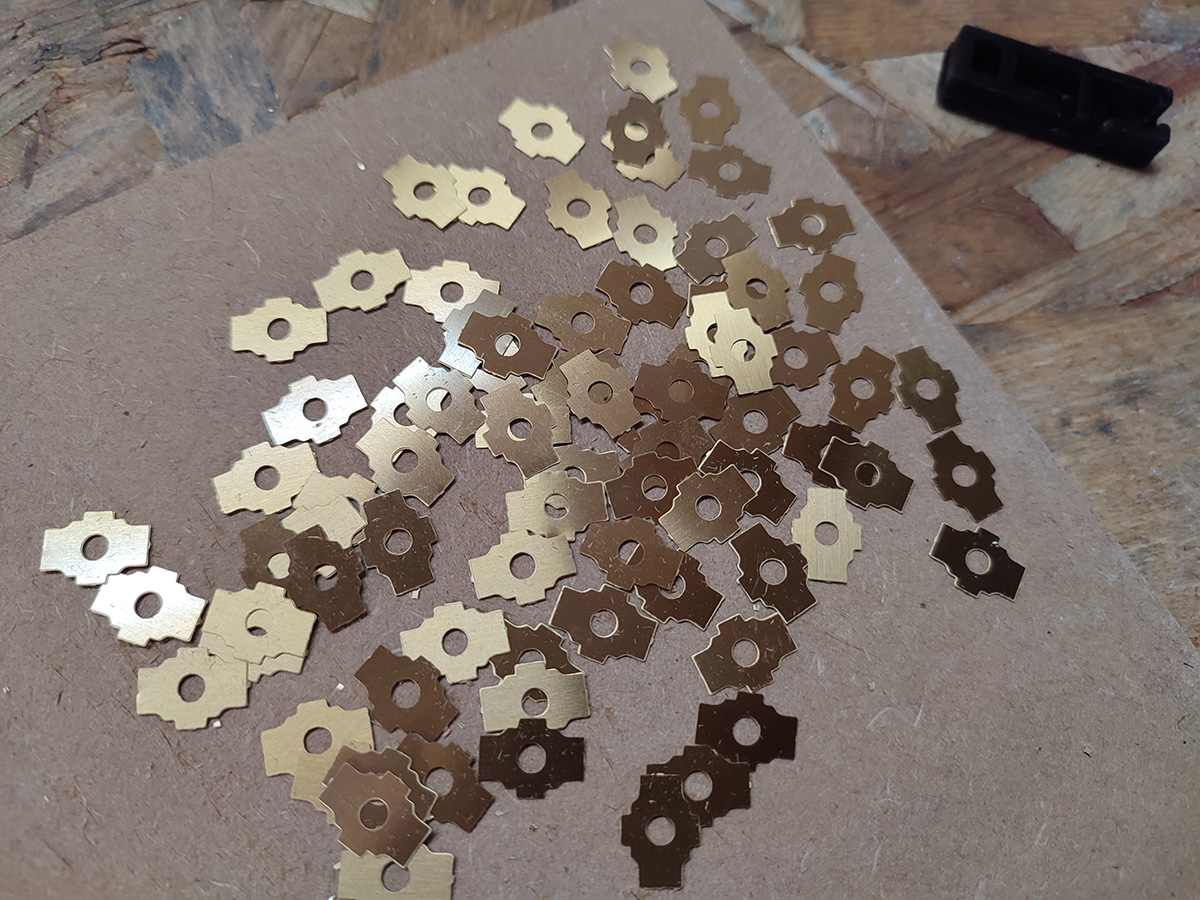

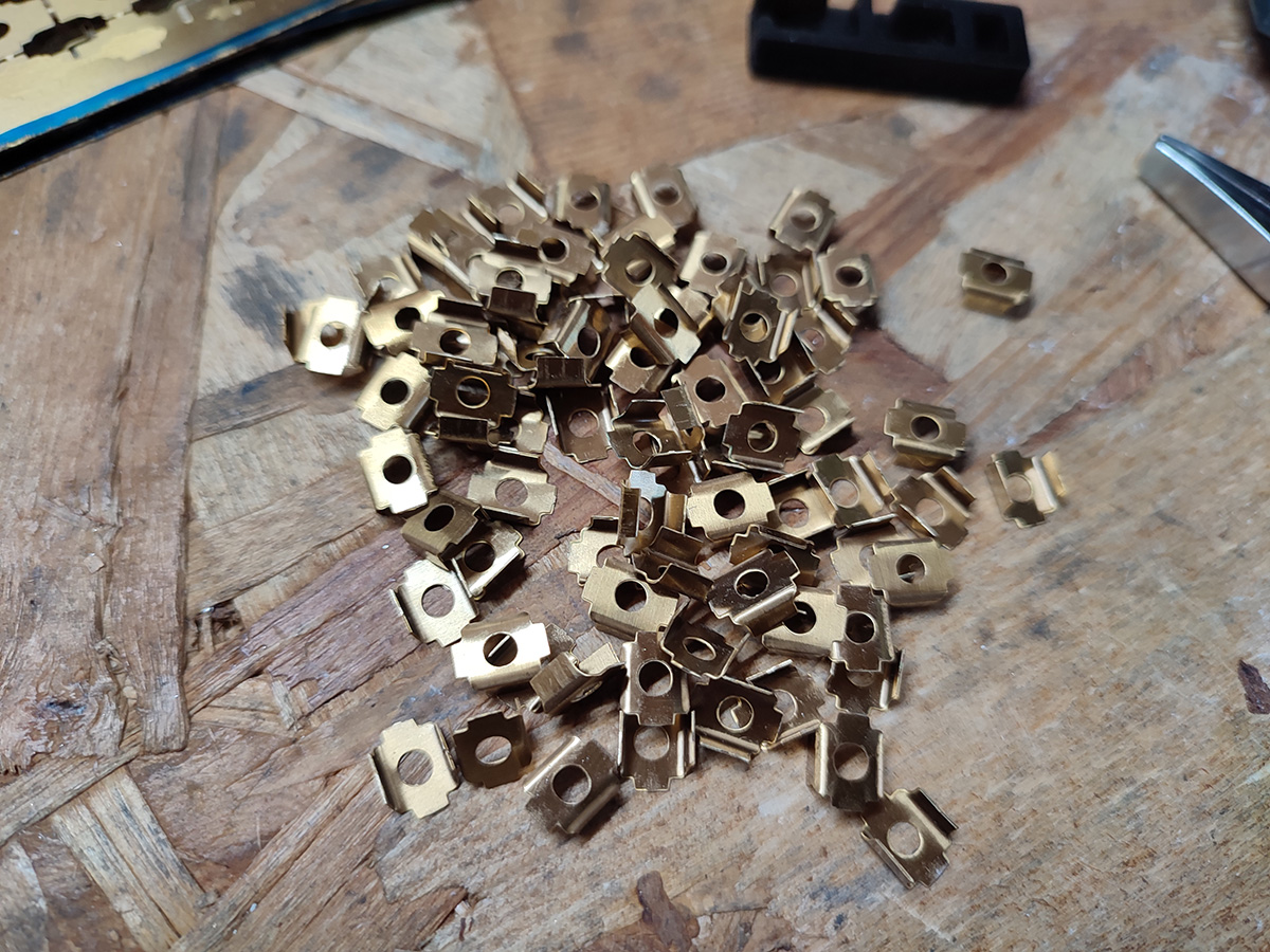

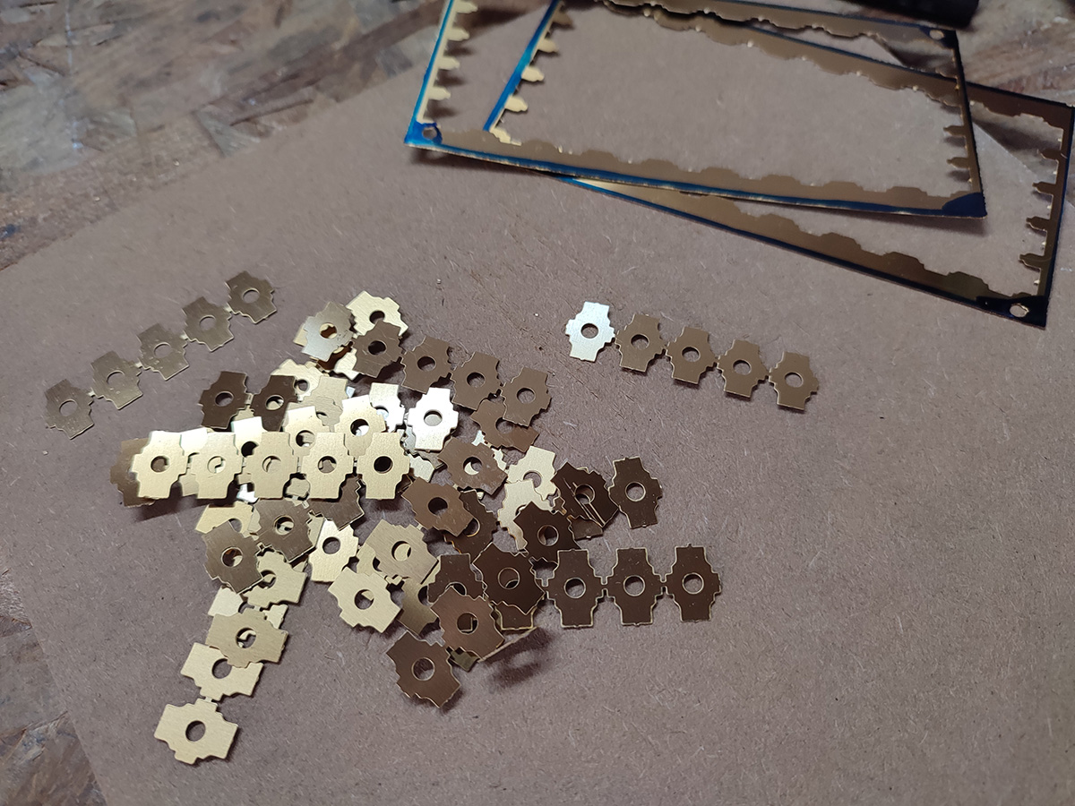

Hello there,

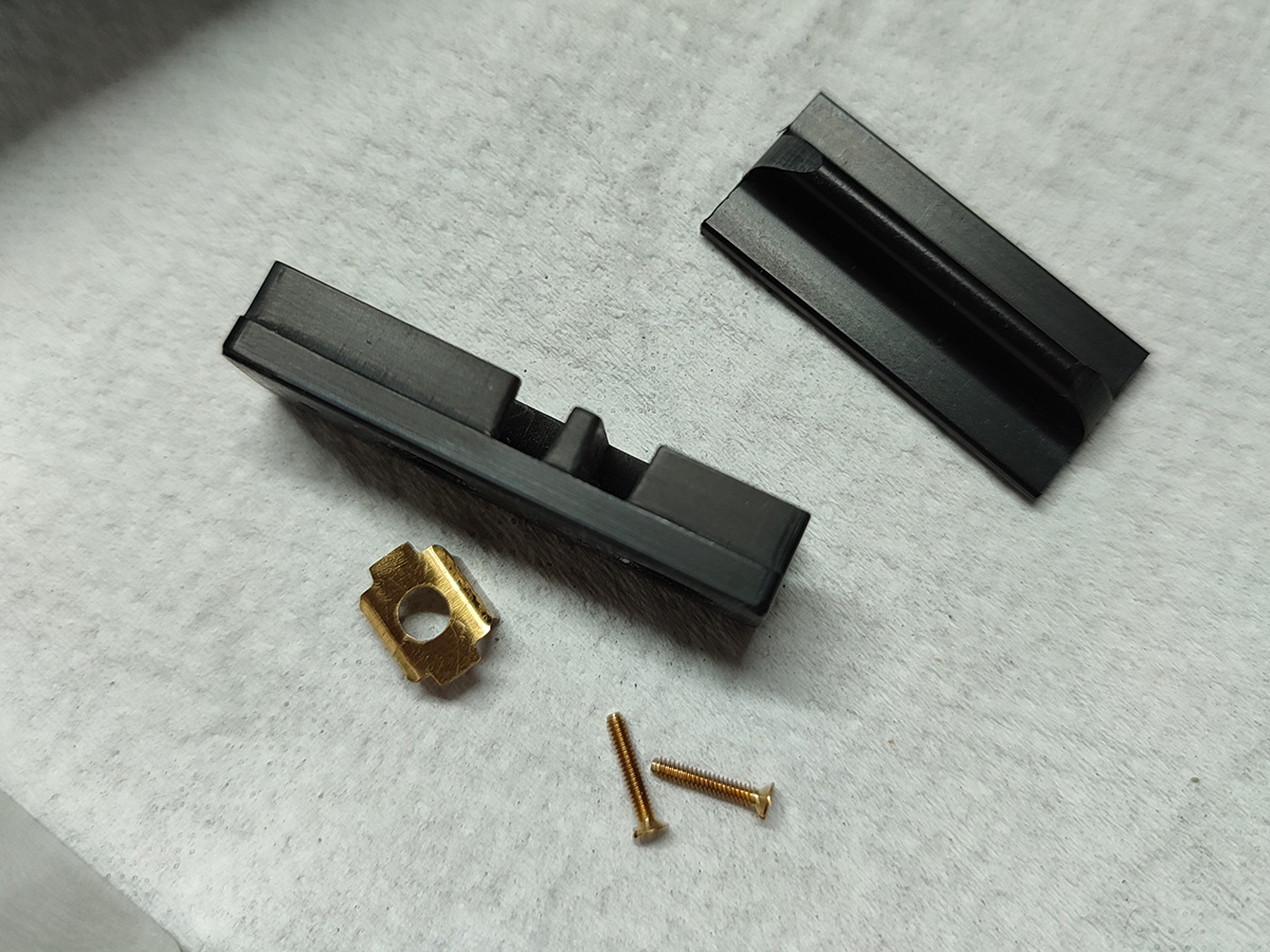

today, i did all the little brass brackets that go into the activation box,
first I had to detach them from the etched plaque:

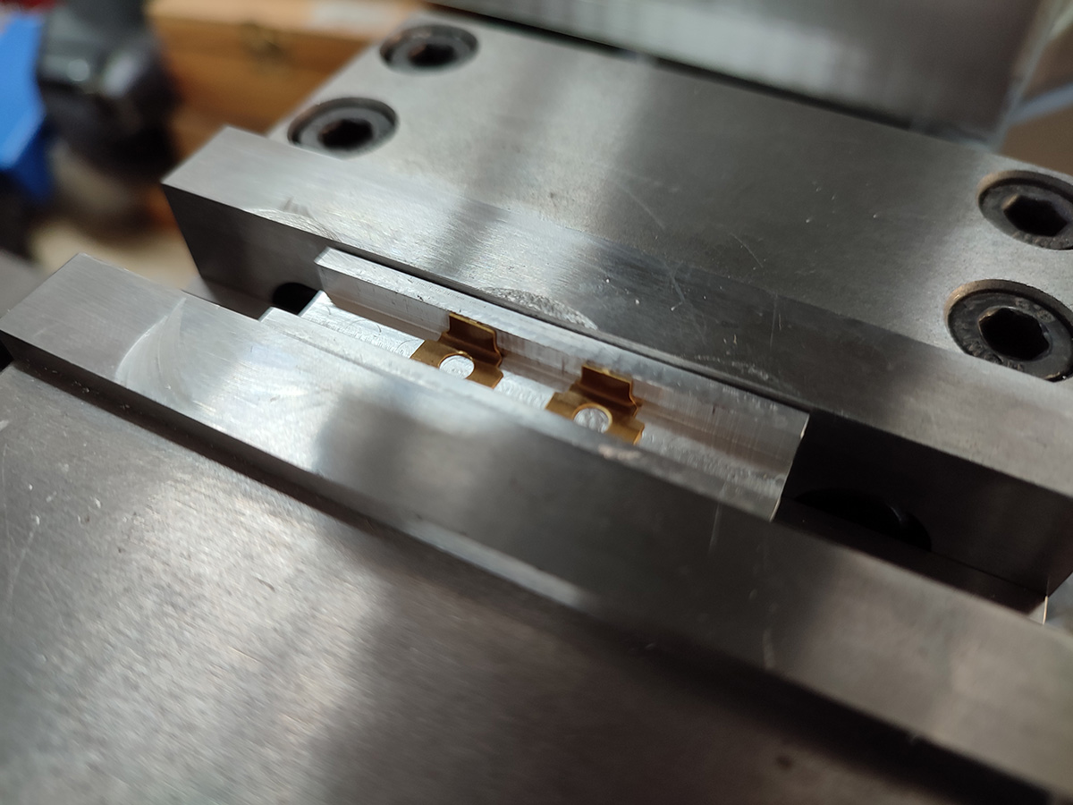

I created a pressing jig on the milling machine as those are difficult to bend correctly with pliers:
and here we go!

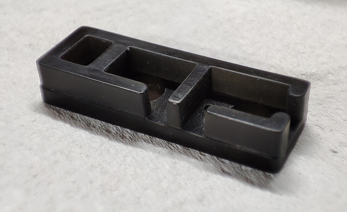

now, I also worked on the activation boxes themselves, I'm sanding each side flat then I added a polishing step on the polishing wheel (because i'm crazy and I care :)) to make it look like injection molded plastic as much as possible. I hope you guys will like it, I can't spend an hour on each part, but I think they look pretty good like this already :) To me, the most screen-accurate result will still be with a coat of gloss black paint, but this gives the option to some people to leave them as is if they like it :)

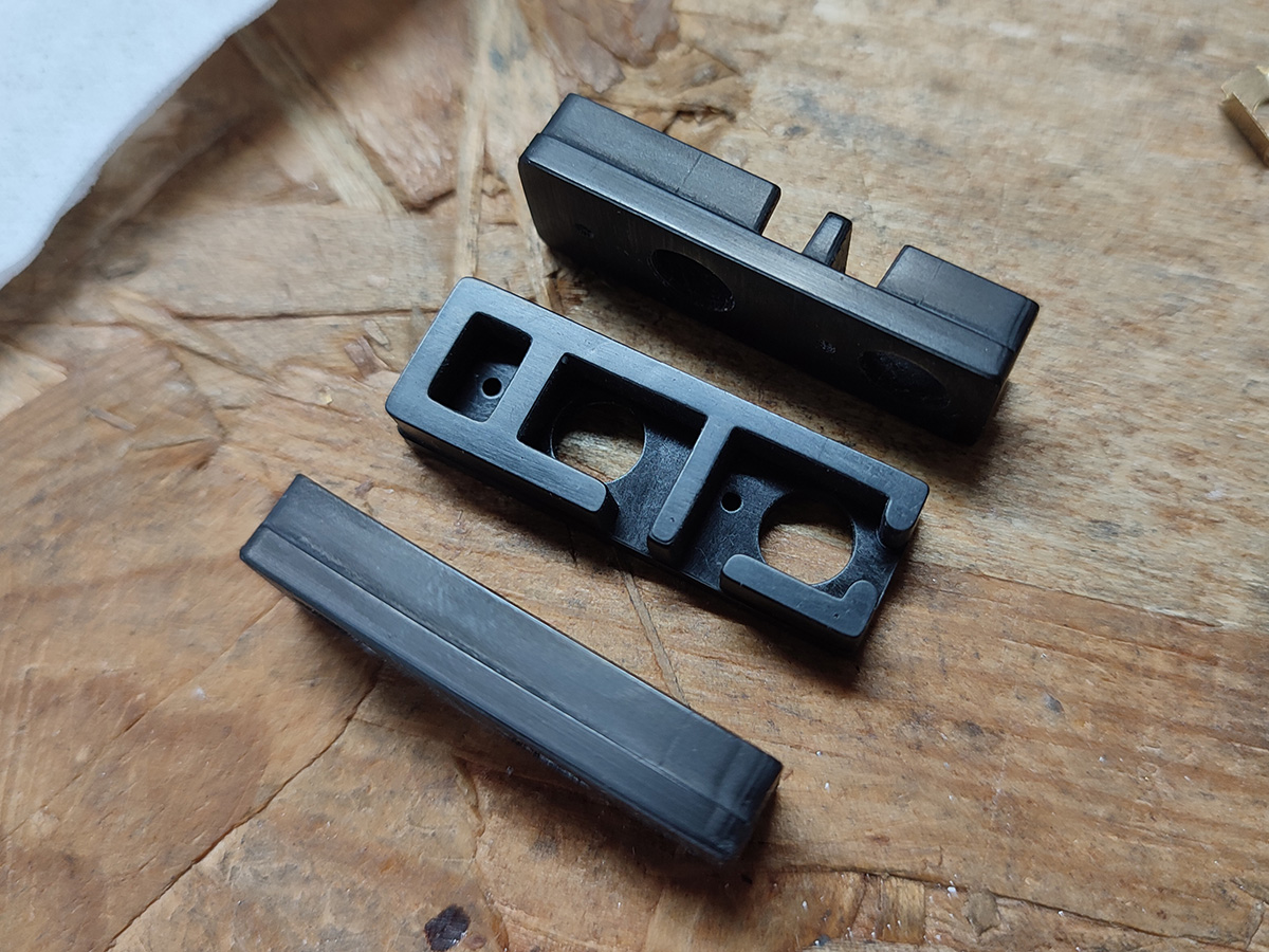

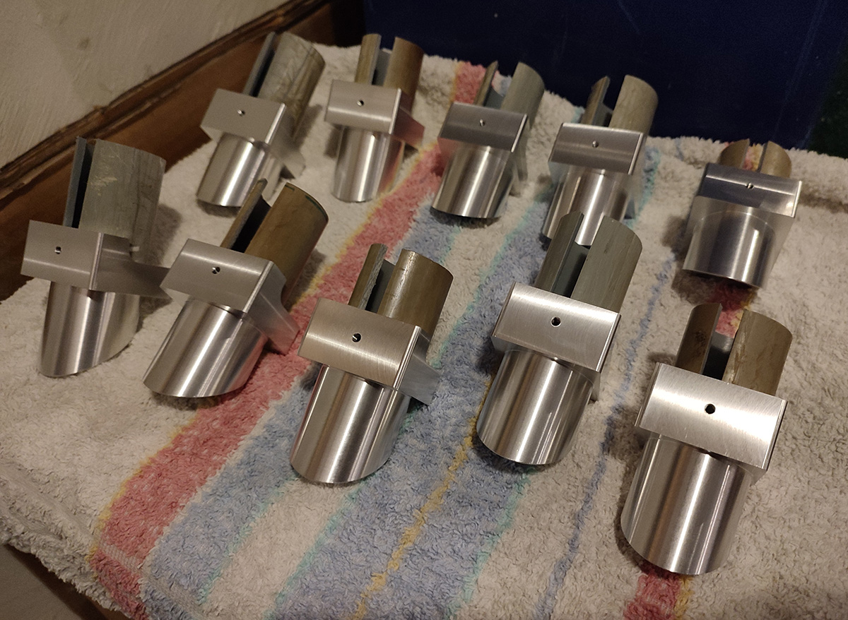

hey there,

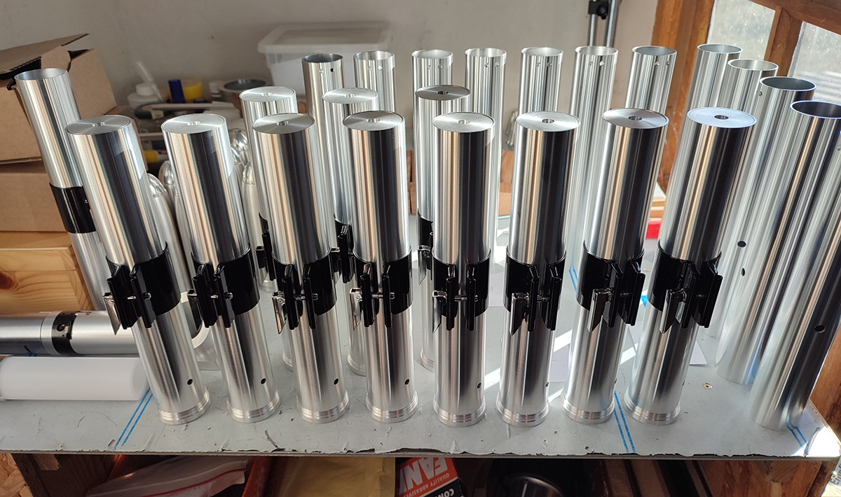

Removed the tapes on the grips, milled and attached the bubbles, turned the clamps around as their were the wrong side...! and attached the short grips under the emiters :)
Now it's just basically painting the shrouds that is left, but we are trying to find the best solution for this, painting is never easy... hopefully this works out and doesn't take too long either.
