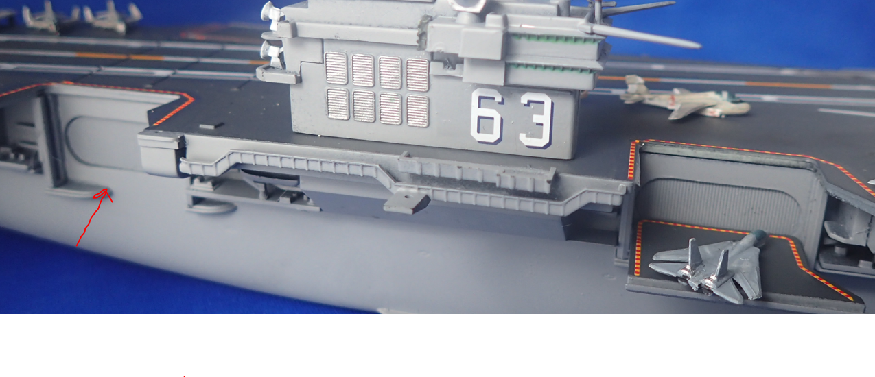

Looks like a nice plan.
As far as those "oval things" they look like the elevator/access doors on modern Nimitz class, KItty Hawk class etc... US aircraft carriers
for example, the Academy 1/800 USS KItty Hawk ( I modeled them closed, but the doors are sperate parts)

At any rate, the side oval doors typically found on aircraft carriers won't be of much use for a 1/2700 scale SD considering they are larger than many of the side walls
