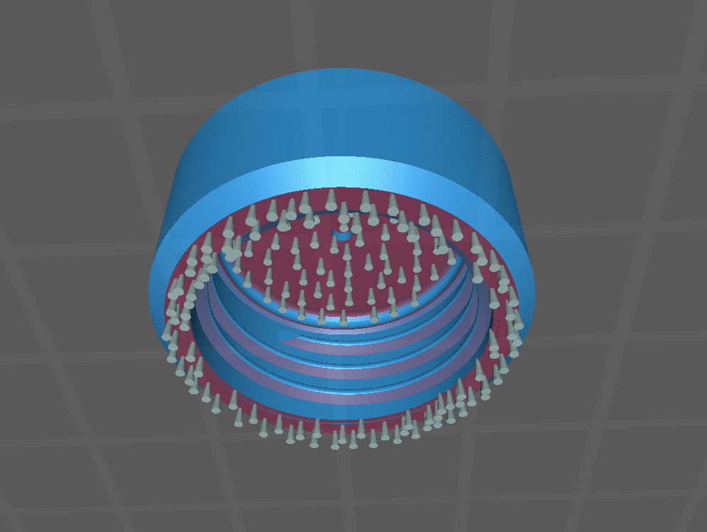

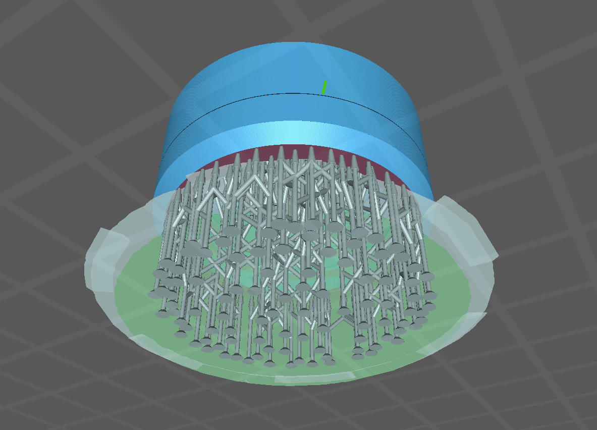

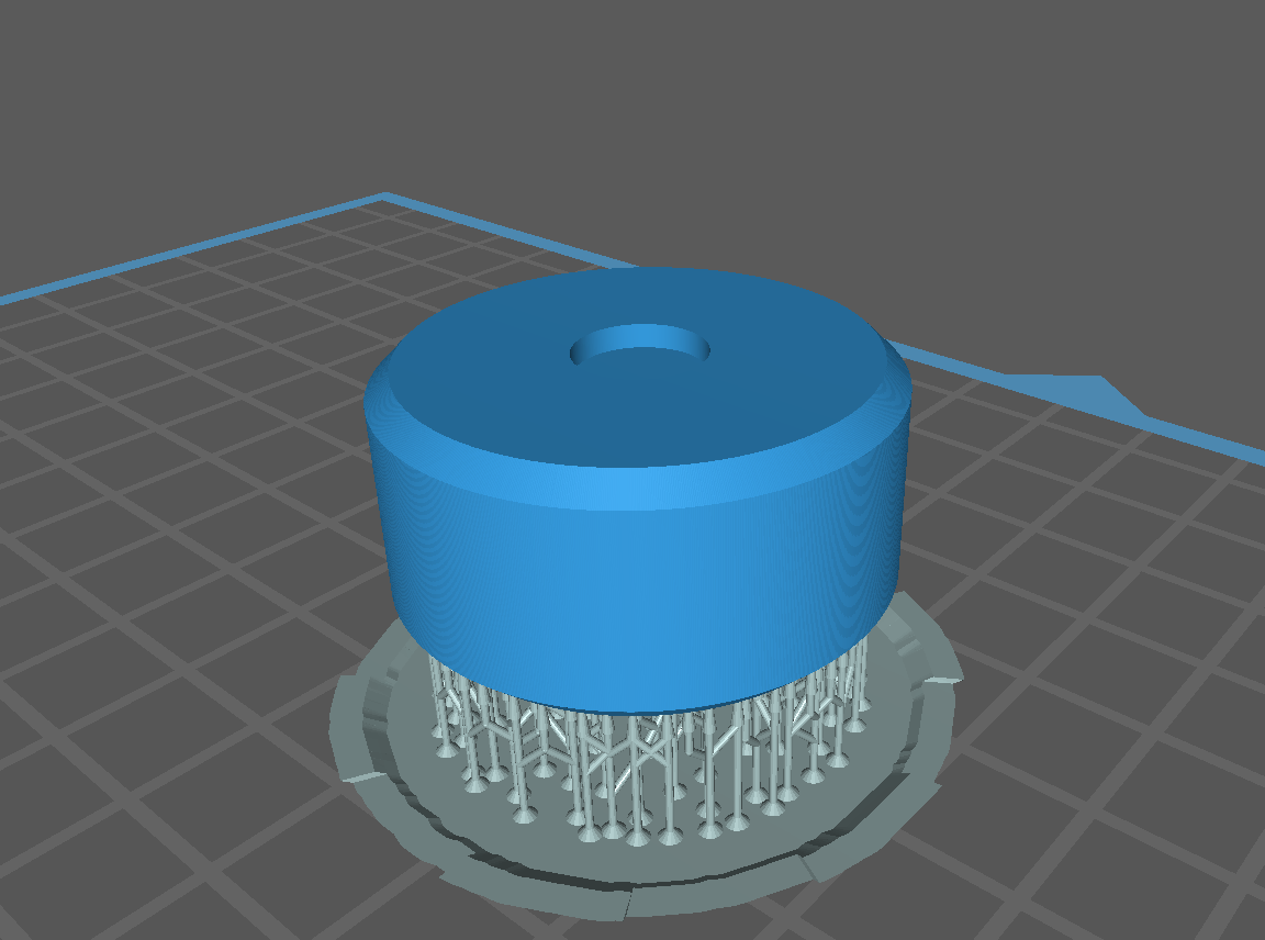

Yep, dealing with the suction cup is a nightmare with resin printing. I might have tried printing these open side down, raised on supports and kept the supports to the interior of the lid where they would be less visible, but there'd still be cleanup on the bottom of the lid and a reasonable chance the print would tear off the supports when it reached that large flat top surface. Angling would mitigate that a bit but result in even more supports on the lower rim of the lid and a high chance of the bottom rim losing its perfectly clean circular profile.
Only other work-around I can thnk of would be to print top/flat side down on the plate as you have and punch a small hole through the side to vent the interior cavity, but you're still filling in a hole instead of the stress line, so it's not really any better.
Not really any easy fix for this and I think you've chosen the best option.
Yes, I absolutely print them open-side down...it was just flipped for the screen cap. :)
I am desperate to avoid supports on the beveled surfaces themselves, because it seems even the lightest touch of sandpaper on those surfaces and I'm losing the integrity of the lines!
And yeah, thanks for the tips...that's the thought process I went through as well. After multiple painting attempts, it became obvious that the integrity of the bevels is crucial above all!

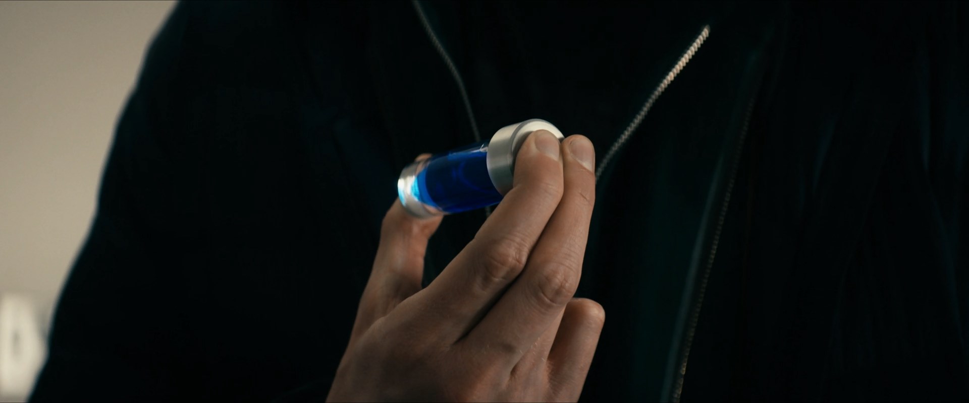

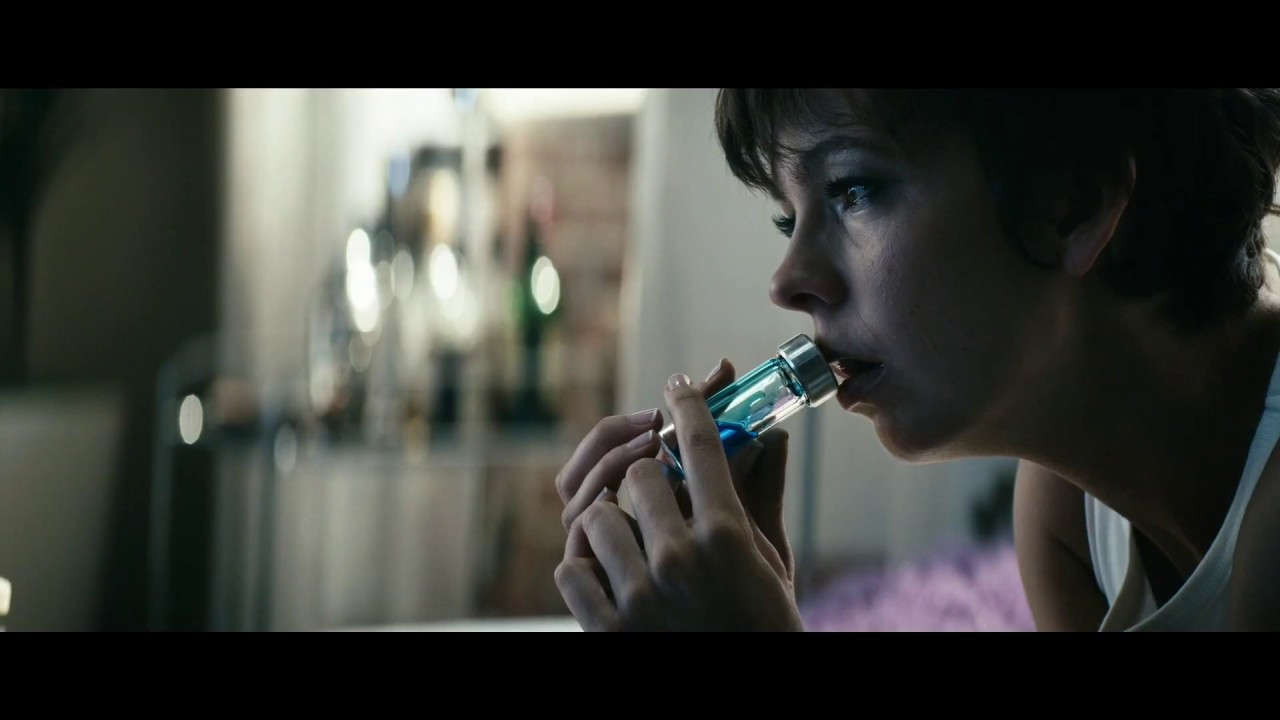

A couple fun updates:

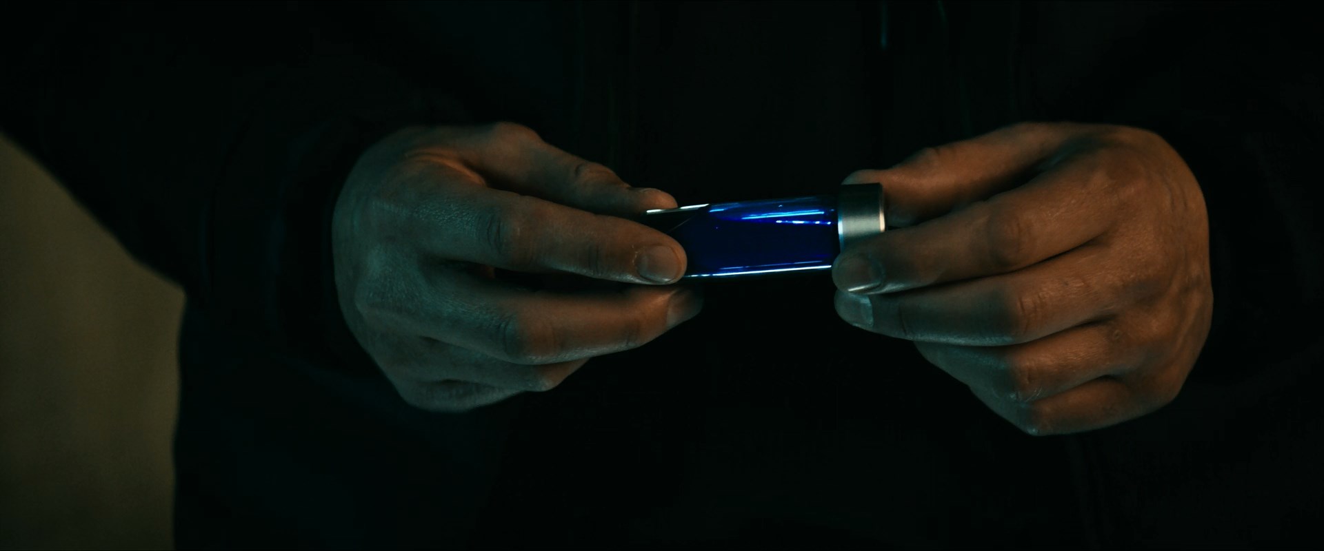

Tonight's episode gave us some much better looks, especially at the "septum lid".
The.Boys.S04e04.1080p.Web.H264-Ethel.mkv_snapshot_00.29.24_[2024.06.20_20.02.02].jpg The.Boys.S04e04.1080p.Web.H264-Ethel.mkv_snapshot_00.54.53_[2024.06.20_20.04.23].jpg The.Boys.S04e04.1080p.Web.H264-Ethel.mkv_snapshot_00.56.31_[2024.06.20_20.05.09].jpg The.Boys.S04e04.1080p.Web.H264-Ethel.mkv_snapshot_00.56.55_[2024.06.20_20.05.43].jpg The.Boys.S04e04.1080p.Web.H264-Ethel.mkv_snapshot_00.57.43_[2024.06.20_20.07.12].jpg The.Boys.S04e04.1080p.Web.H264-Ethel.mkv_snapshot_00.57.46_[2024.06.20_20.07.23].jpg
I'm now convinced the smaller hole covering is white, not cream.
And I'm absolutely convinced I have the right vial size.
Also, this season the liquid is thinner, no longer syrupy. And it's nice so see a cap that is less shiny chrome. So now we have some new canonical choices. Yay!

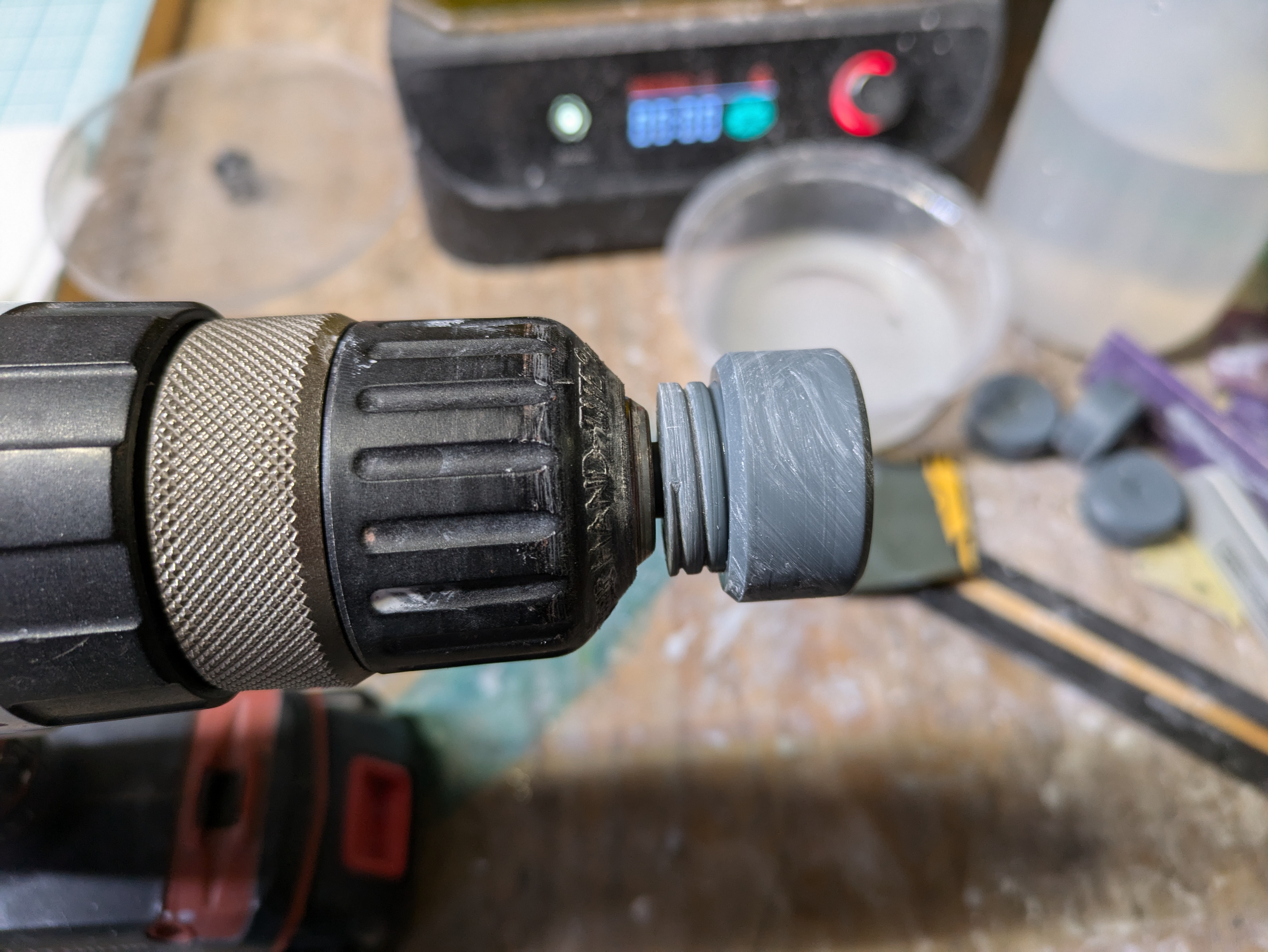

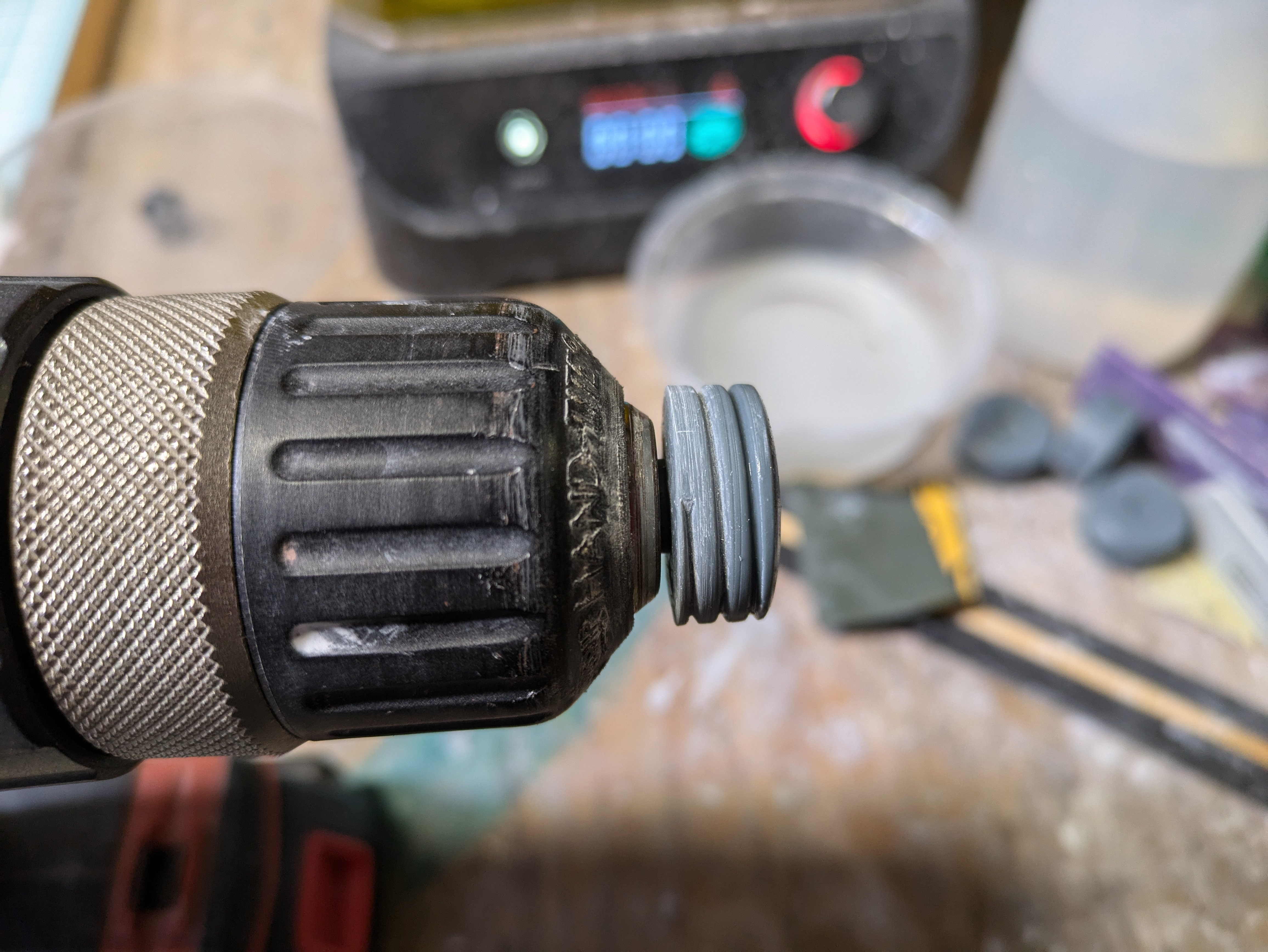

Secondly, I'm printing a screw-on "jig" for the cap:
I'm hoping I can screw the cap onto it, stick the other end in my drill chuck, and sand away! This would make for much more controlled and consistent sanding, instead of doing it by hand. And maybe I can crank out caps quicker! :)
After some shaping, the threaded jig worked!

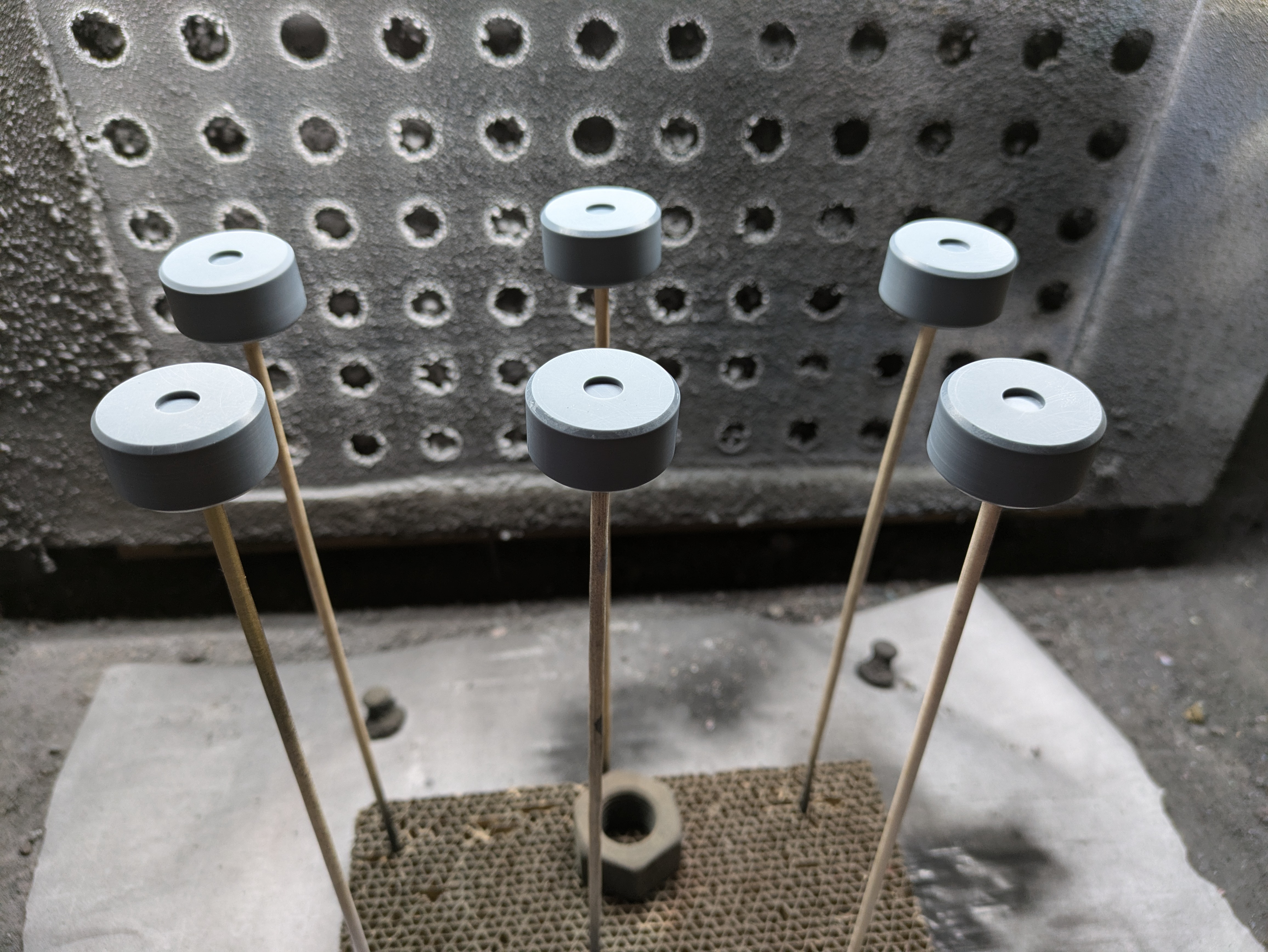

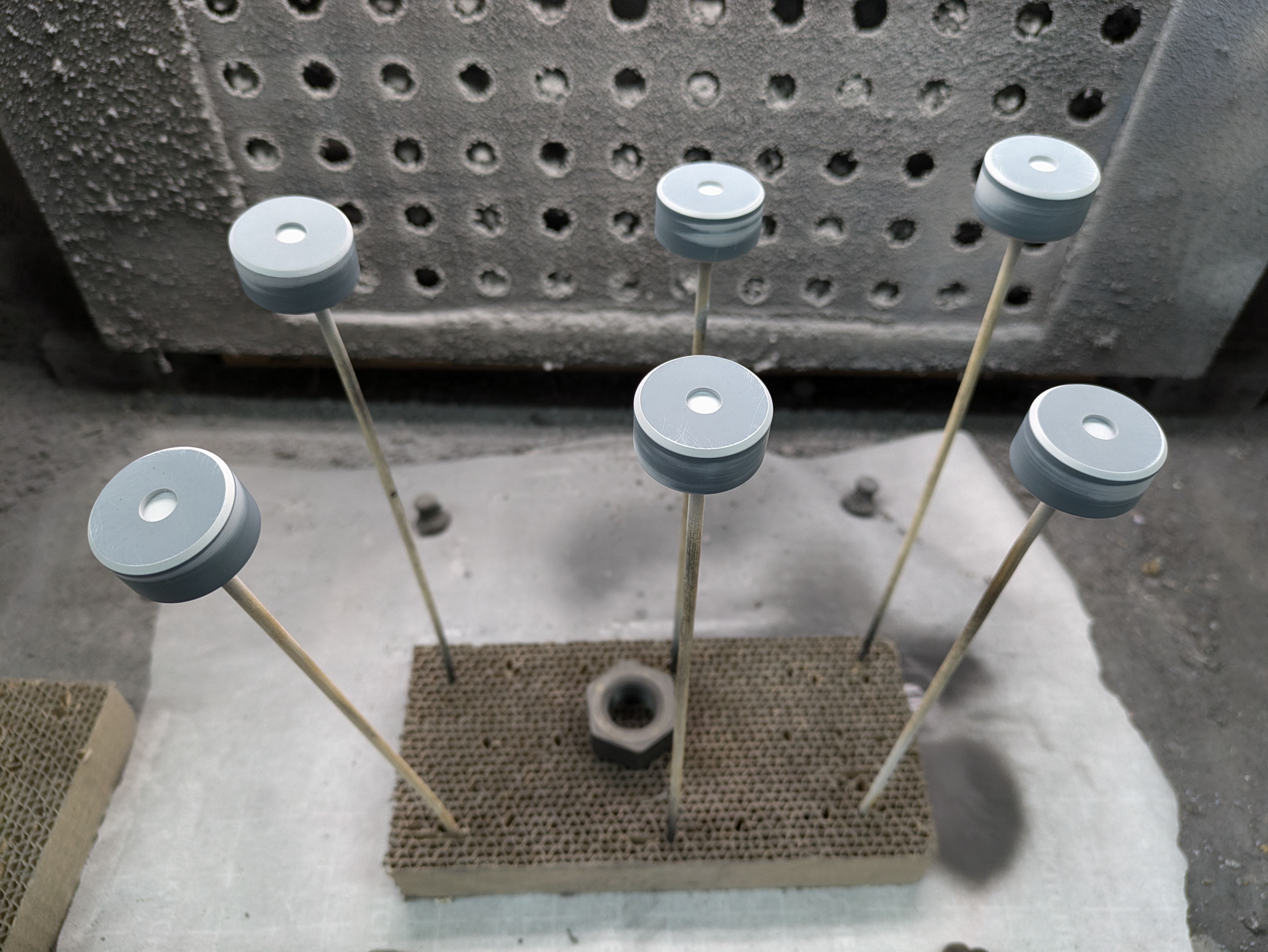

Washed thoroughly and ready for the first primer coat, which I will sand almost all the way back.

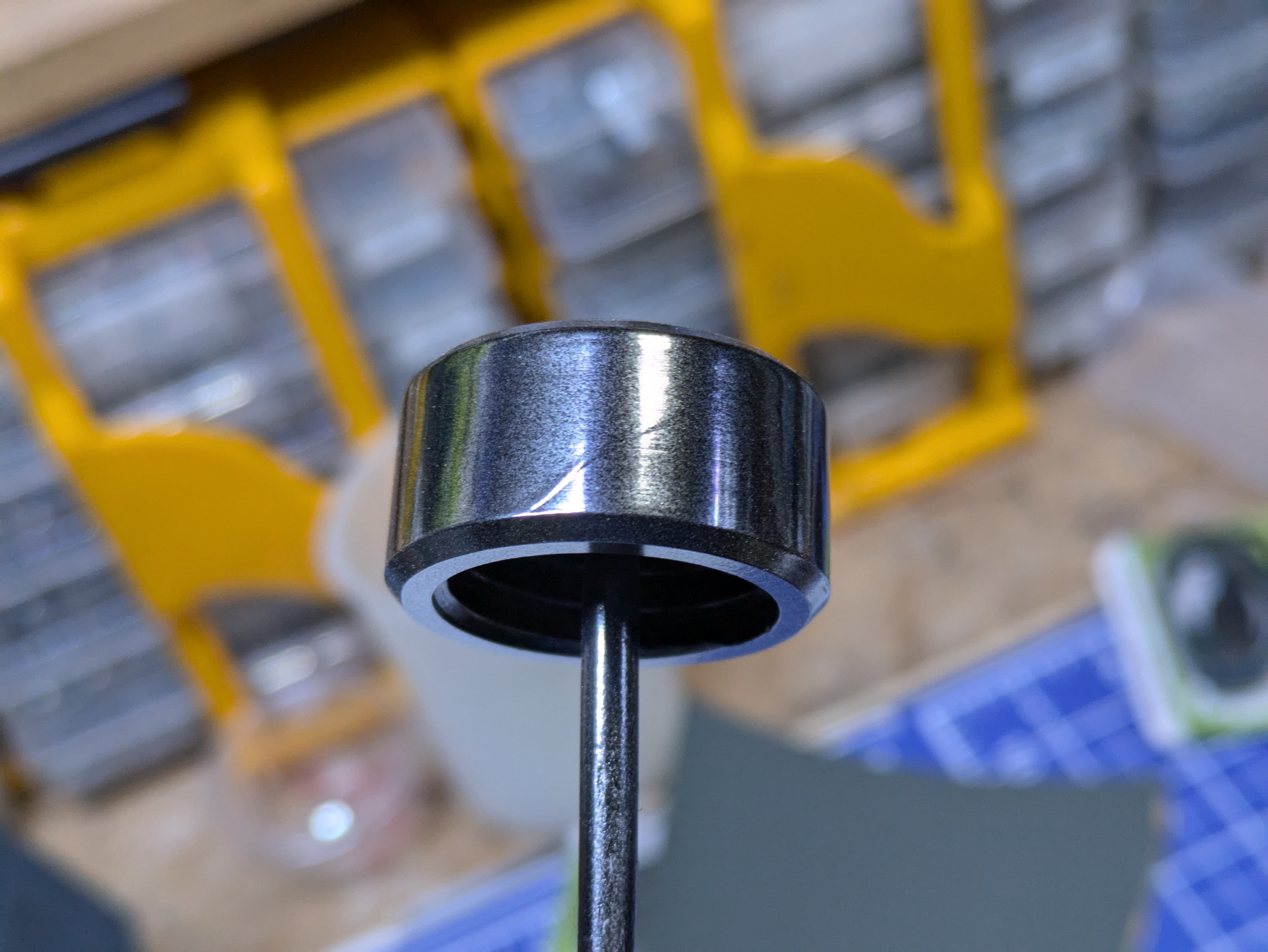

Sanded:
Black gloss undercoat. I'm very happy with this finish so far! The photos can sometimes be brutal about quality, as HDR and 16-megapixels show every micro-flaw. They're looking good in person, so far.
The Alclad II Polished Aluminum will go on tomorrow, followed by the Aqua Gloss about an hour after that.

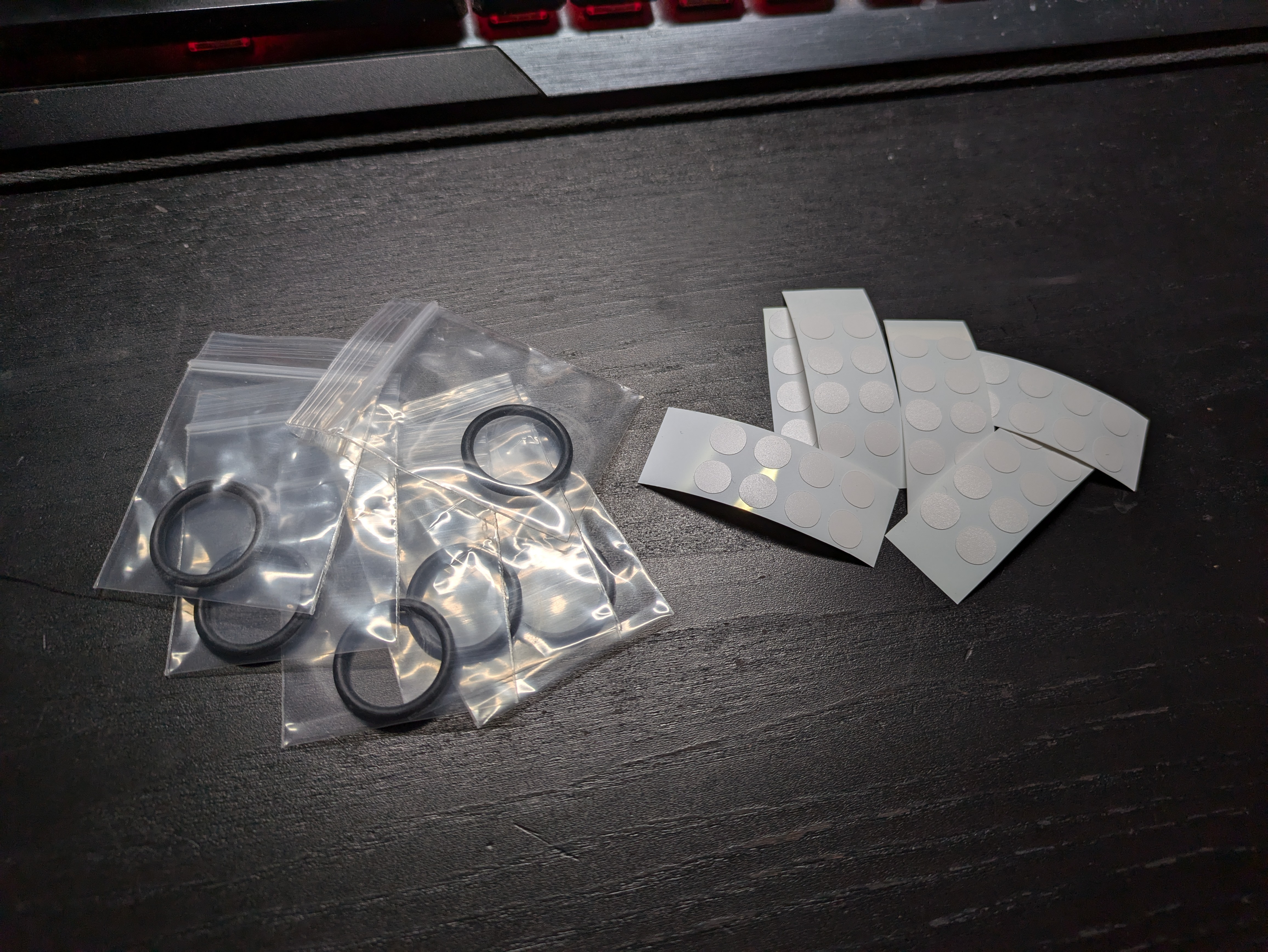

Also, cut some adhesive vinyl dots for the septum lids, and o-rings ready to go!

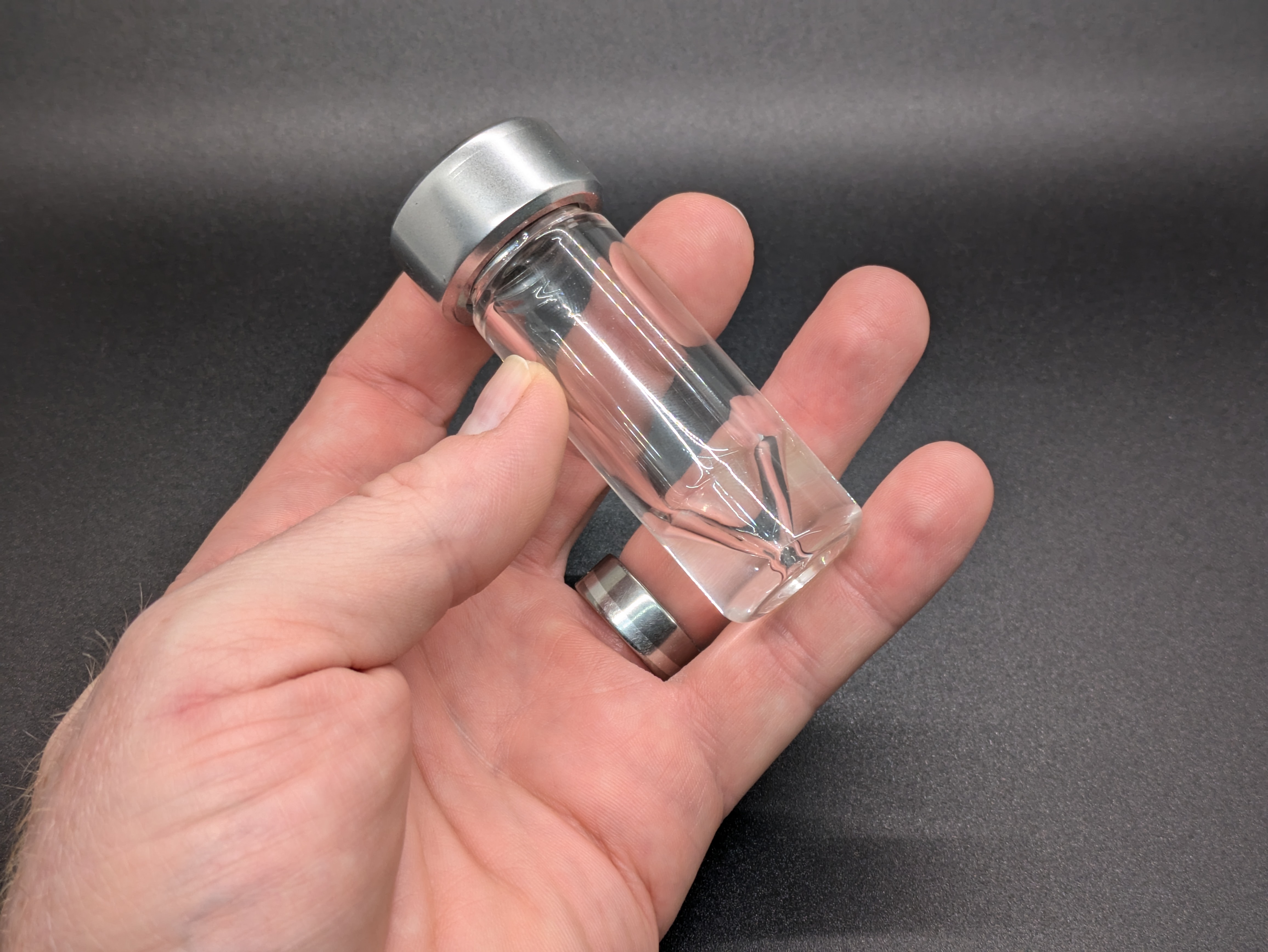

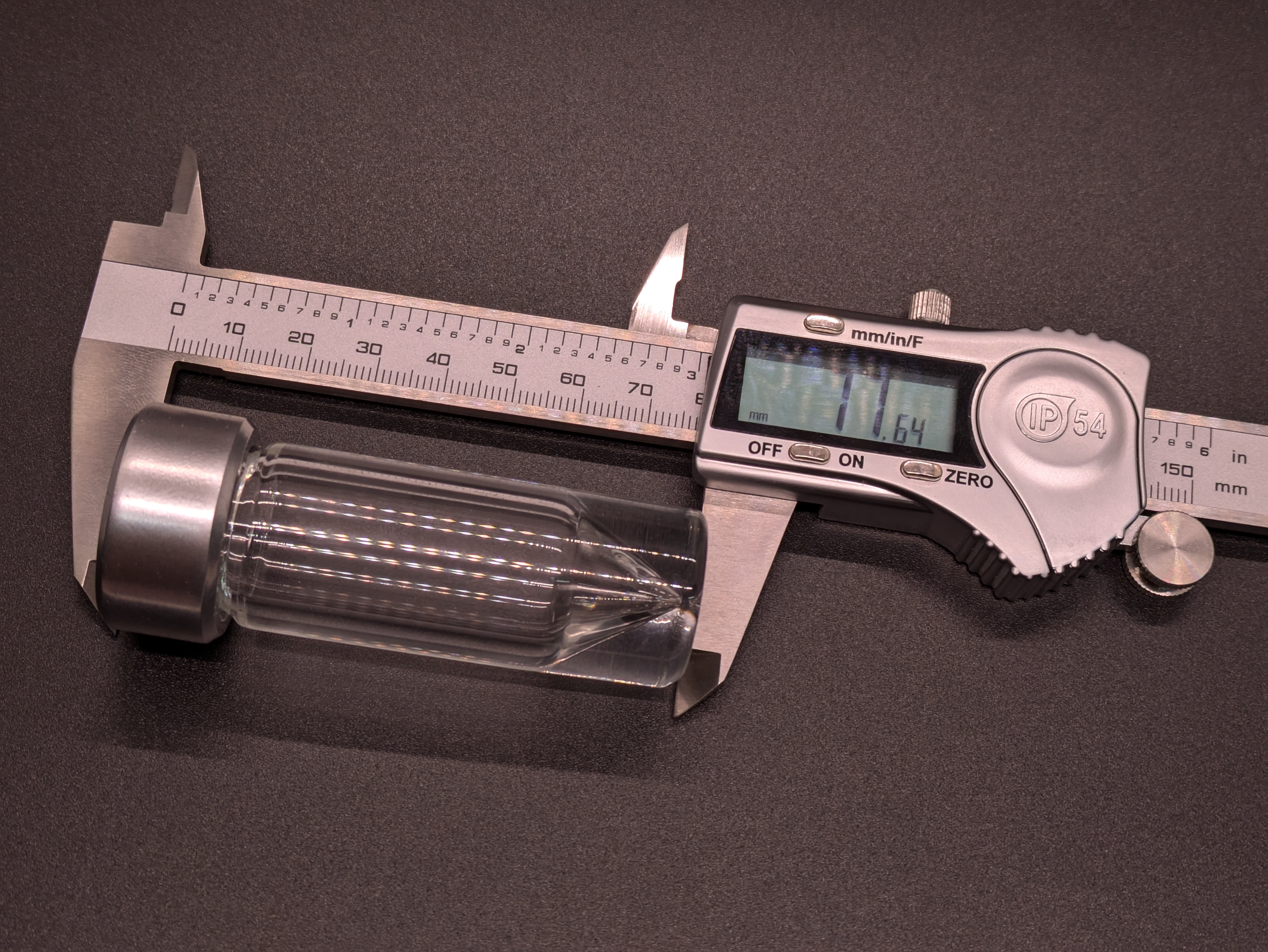

Guess I should have shown dimensions:
PXL_20240622_131640918.jpg PXL_20240622_131704283.jpg PXL_20240622_131720282.jpg
And in my hand for scale:
The vials hold 10mL of liquid, and were the biggest available. I had almost gone for the 5mL, but after capturing more screenshots at the time came to see that these things are bigger than we realize!

One of the downsides of sharing all the details of my prep steps is that you get to see all the setbacks as well.
Turns out my black gloss painting did not go as well yesterday as I had thought, and I had quite a bit of paint running that I was only able to see once I applied the polished aluminum:
So I'm just about fed up with this Rustoleum 2X, because if I spray it too light, it goes on grainy or orange-peels, and if I spray it too heavy it runs! I've taken this approach many, many times, so I'm not sure what's so different. Humidity is in the high 50% range, temp is 70 degrees.
So I'm heading south to pick up a can of Tamiya TS-14 and will see if I can do a better job with that.

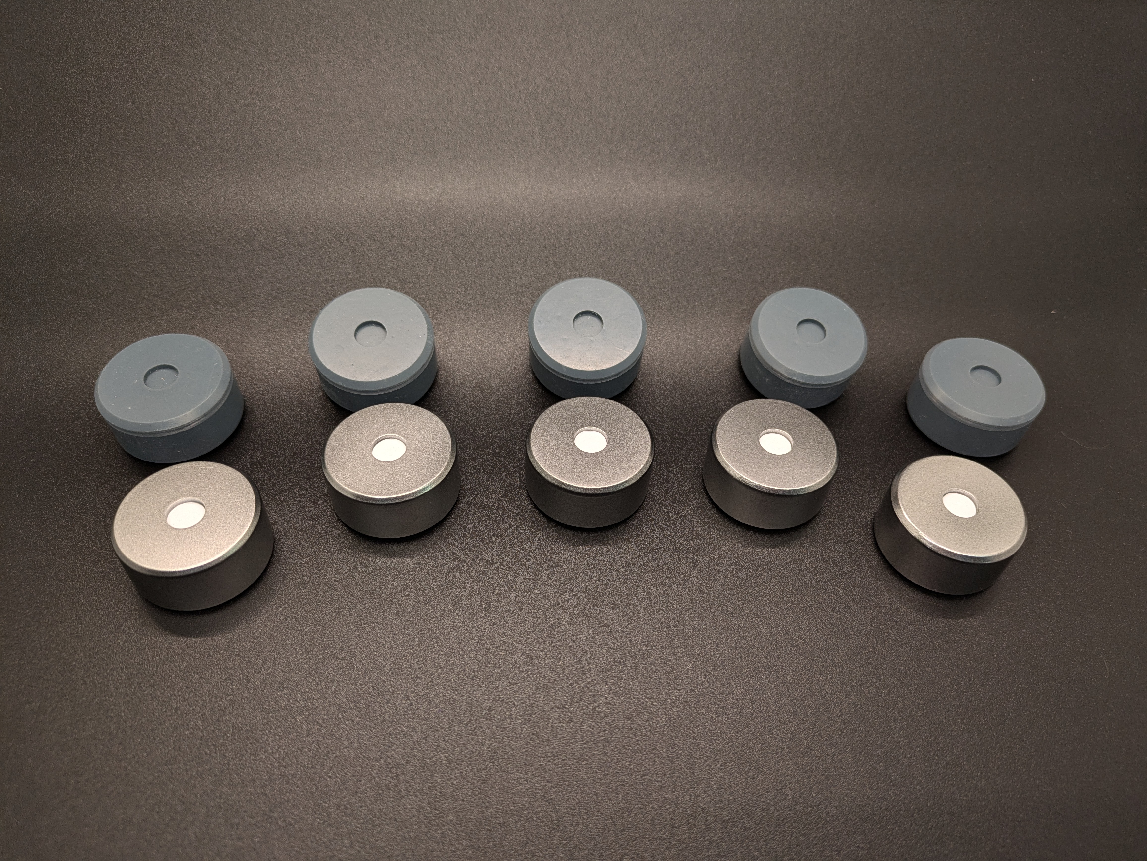

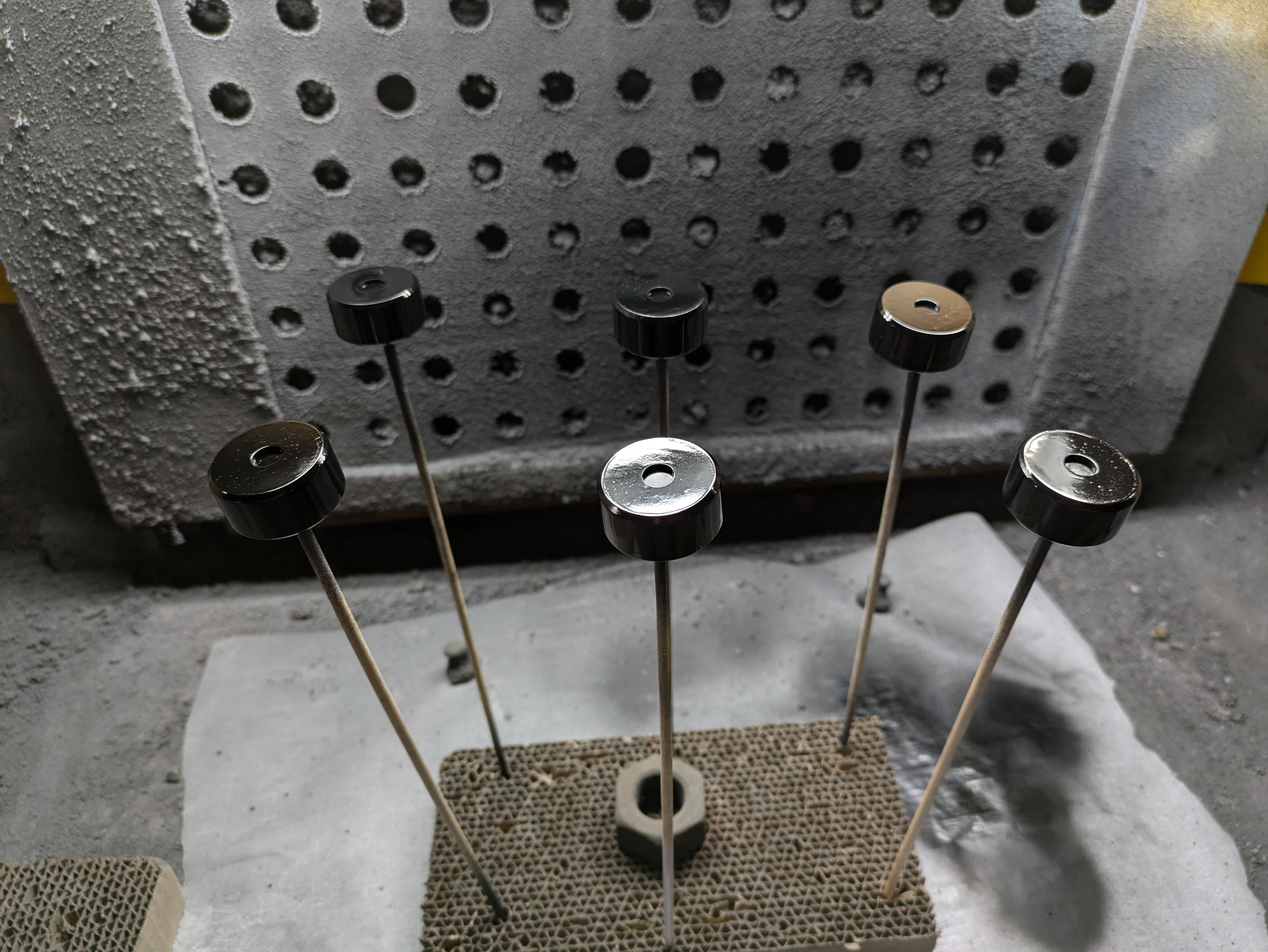

Hey all:

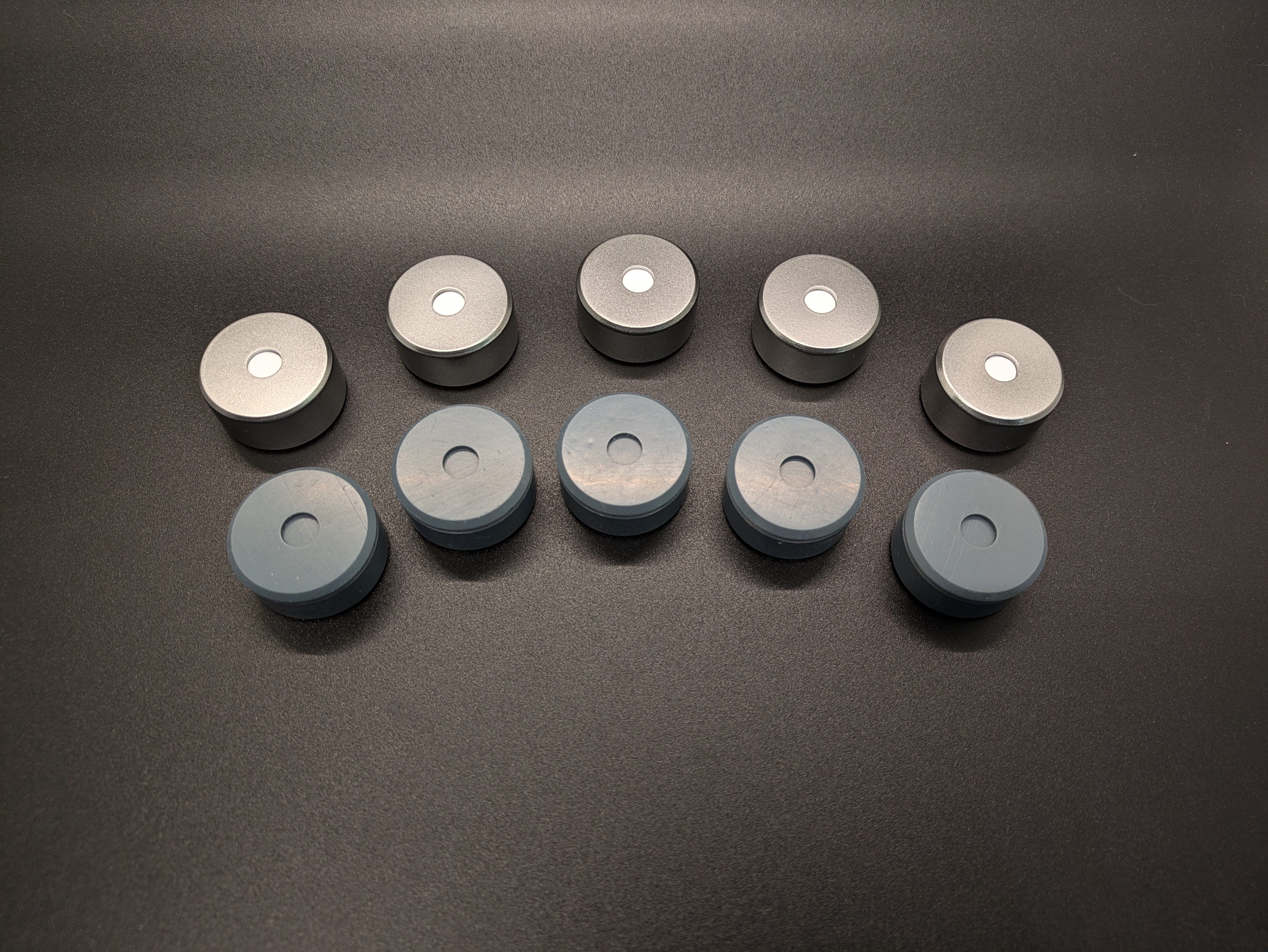

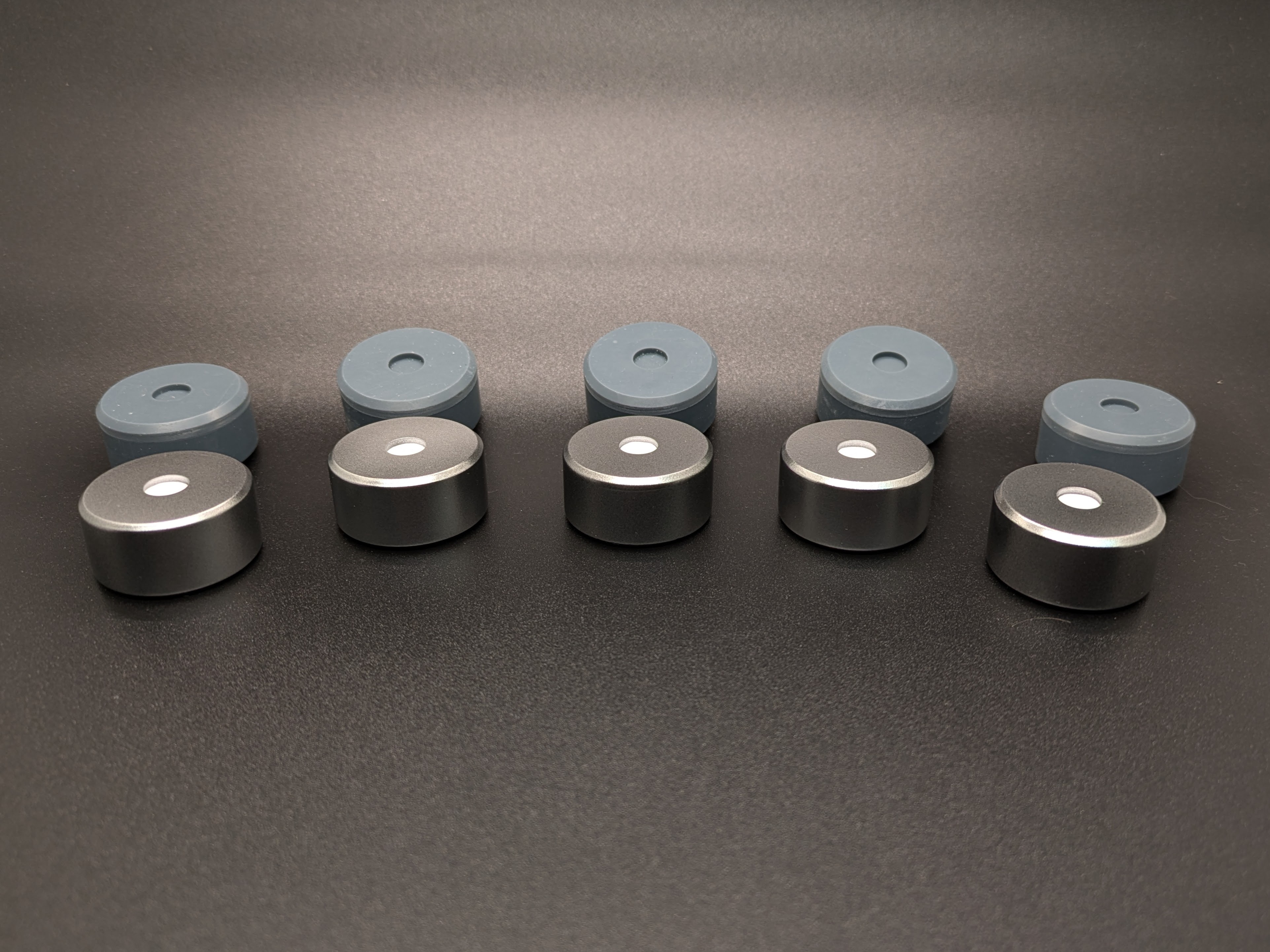

Well, I'm only marginally happy with the final lids, but I feel this was about as far as my skill was able to take them:
PXL_20240623_211230358.jpg PXL_20240623_210659461.jpg PXL_20240623_210730060.jpg
At least we see them in the show at varying degrees of shininess in different scenes, so I can call these final. There are some scuffs, random lines, and other imperfections, but every lid seems to have a "good side". I'm making sure that every vial also comes with an unfinished lid and extra vinyl dots so that you can do your own if you prefer!
Hope that's acceptable to everyone. Tomorrow I will reach out to you with payment information and next steps. Thanks again for your patience!
Bill

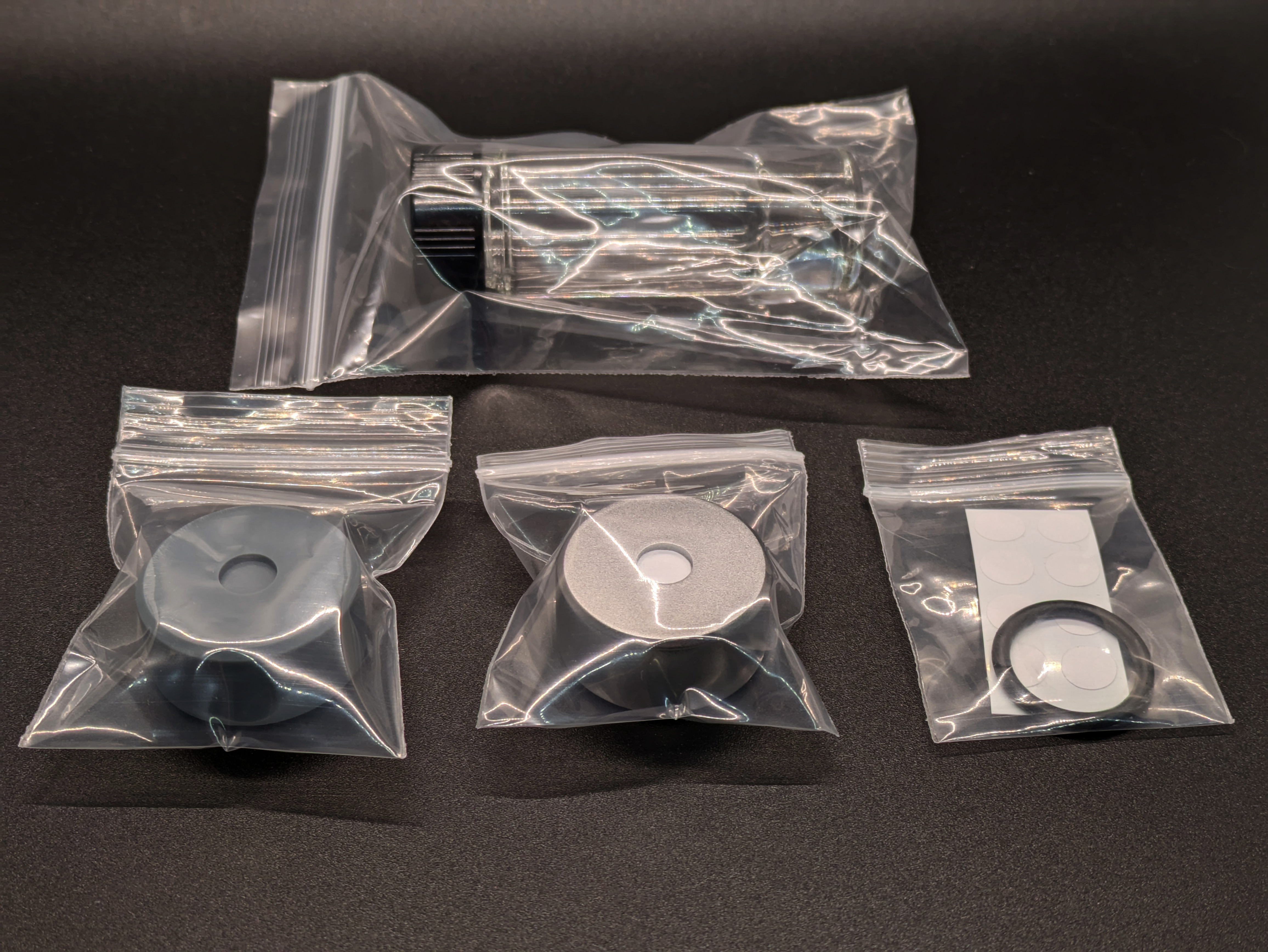

All right folks, kits are ready! This is what you'll get:
  • 1 x 10 mL V-Vial with closure
  • 2 x 3d-printed custom lids (1 finished, 1 unfinished)
  • 1 x o-ring (R-12, AS568 #115, 11/16" ID, 7/8" OD)
  • 8 x pre-cut vinyl dots
I'm ready to collect payment, so please watch your PM inboxes. Shipping for paid kits will start tomorrow.
Thank you!
Bill
