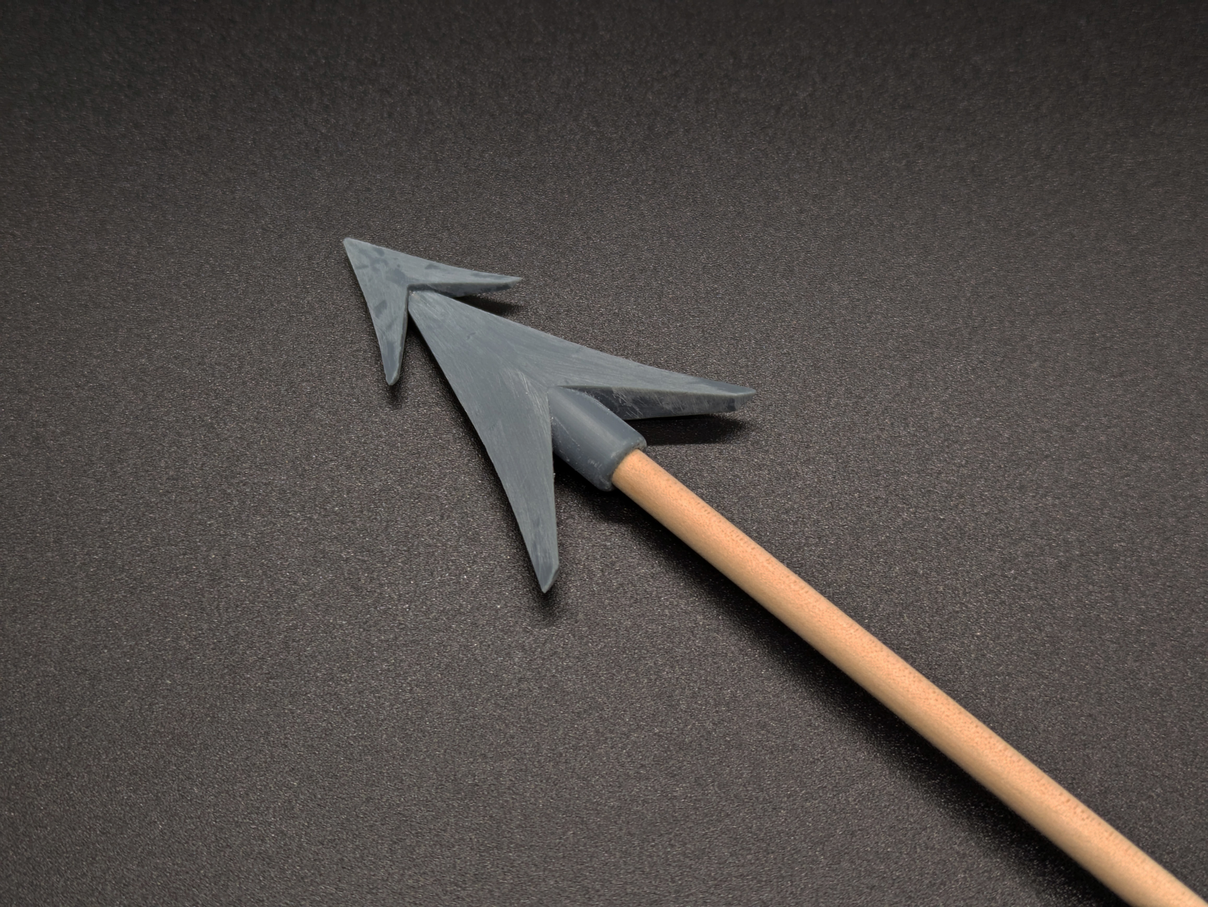

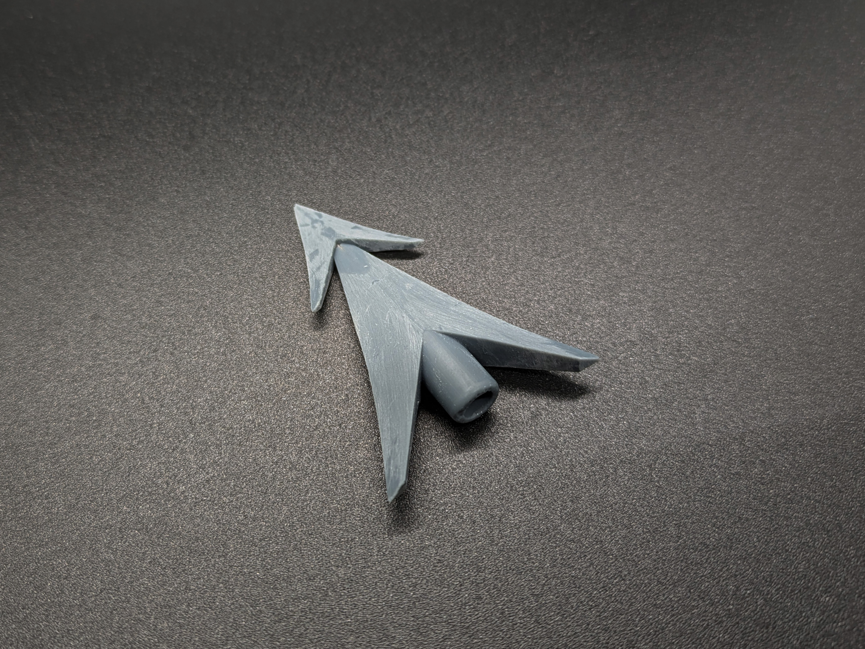

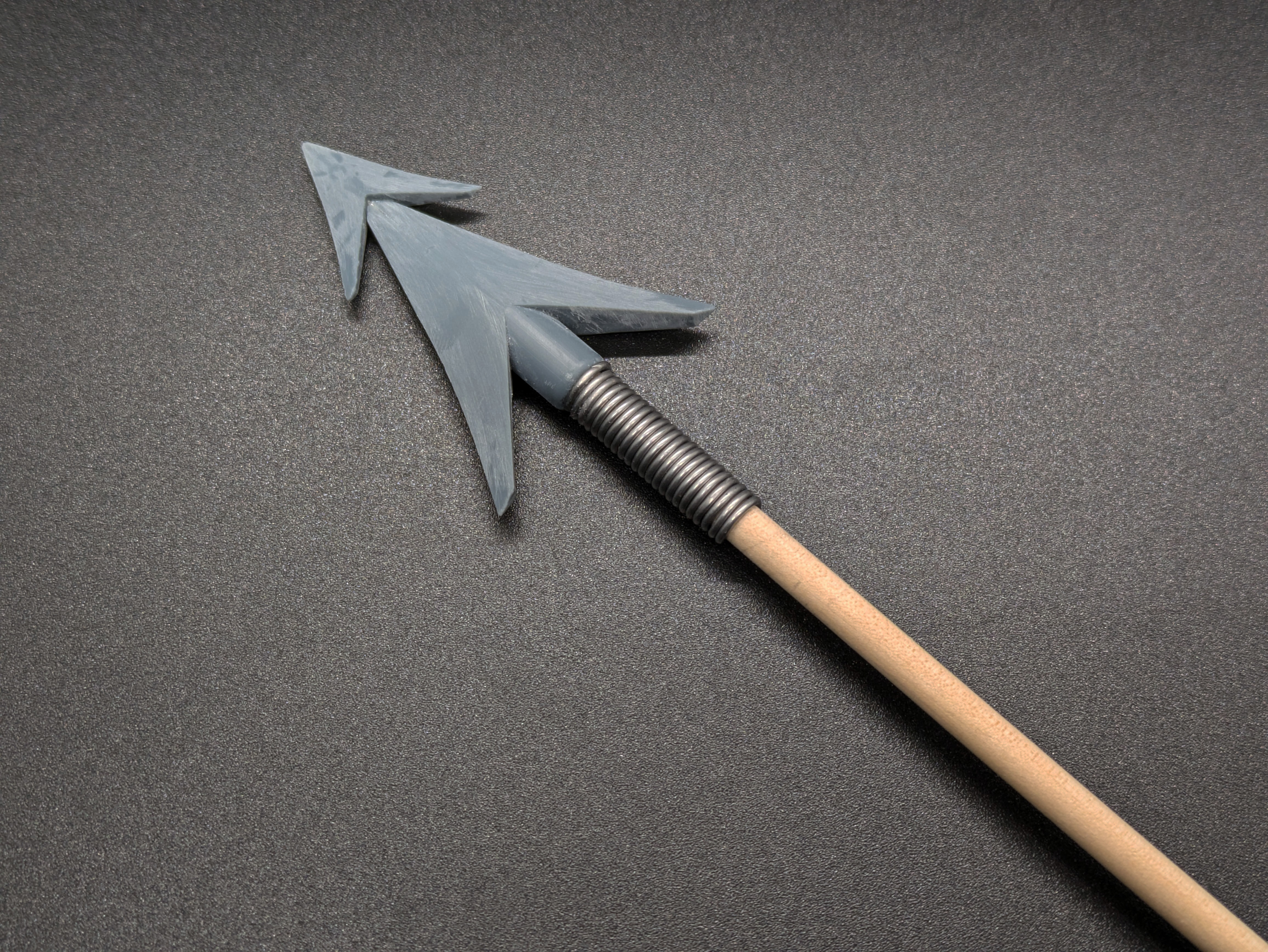

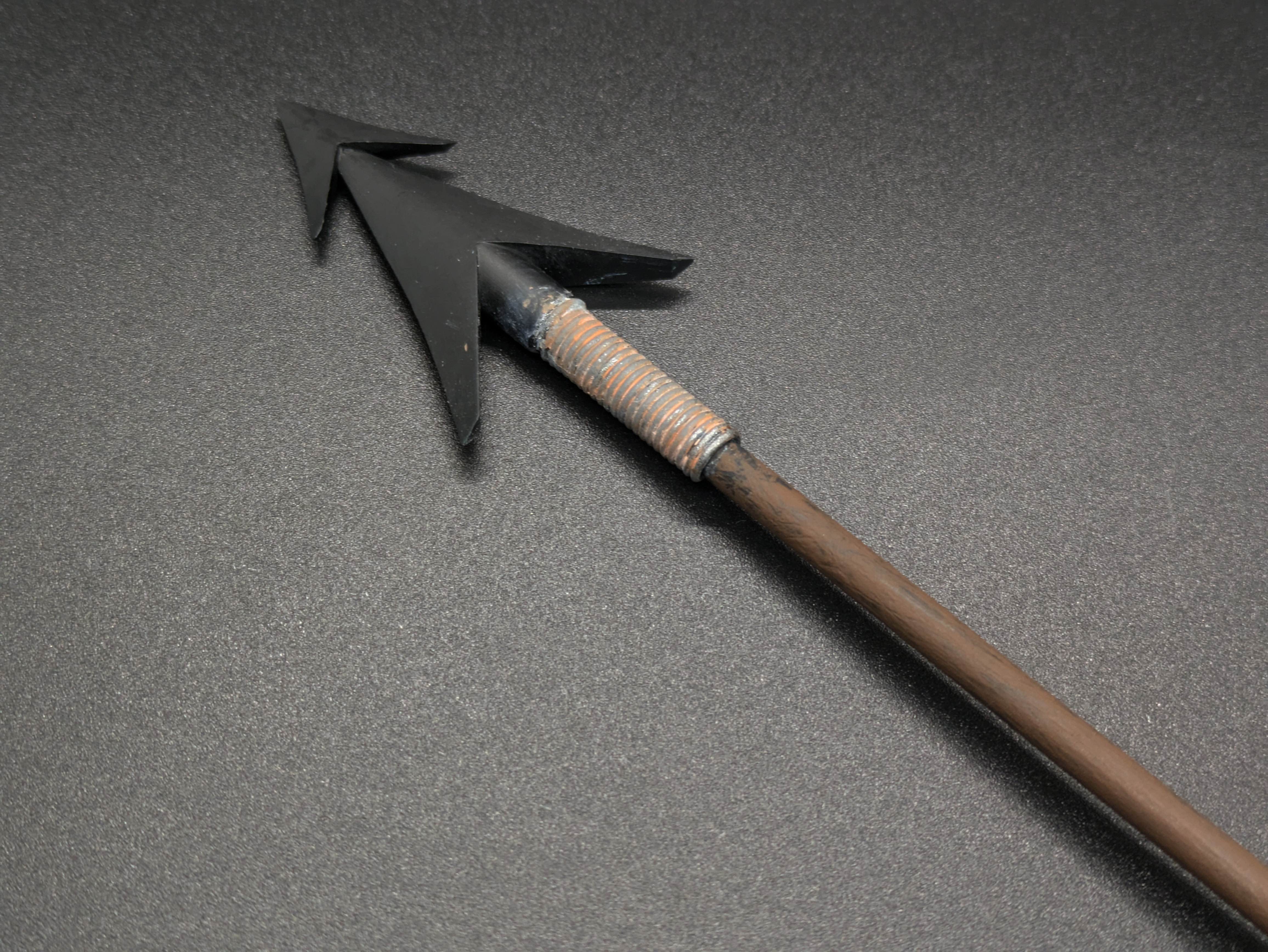

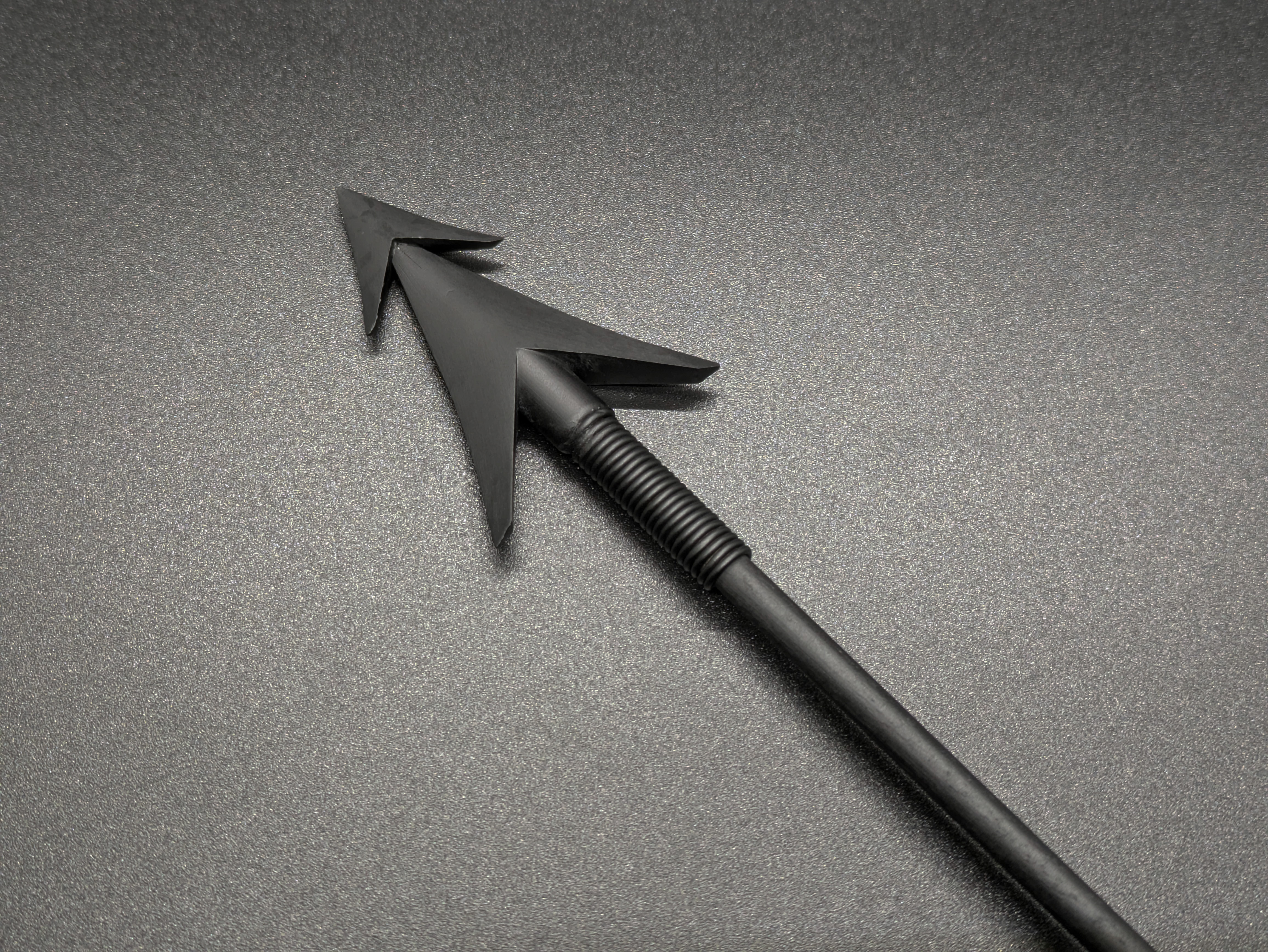

Sanded...not too finely, as this is supposed to look hand-made. Just enough to get out the geometry and layer lines.
Glued together...
A wire wrap...actually using solder, because it holds in place better for gluing.

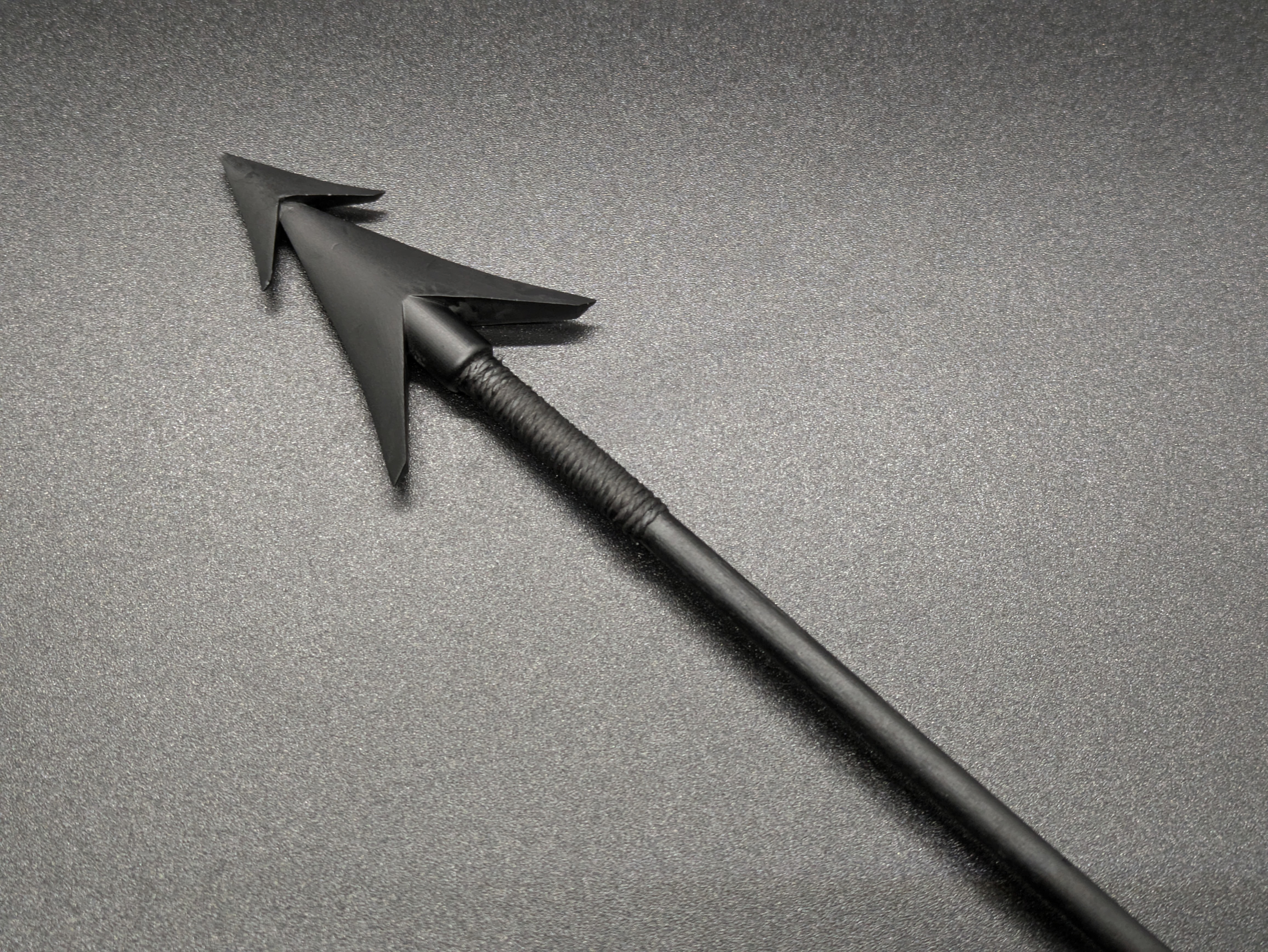

Primed in black...

  1. Arrowhead: Dark bronze with heavy patina
  2. Wire wrap: Dark metal, rusted heavily
  3. Shaft: Dark wood
I'm thinking I would then give the whole thing a black wash, only lightly removed. That way, the colors underneath would peek through but not cleanly. And then a heavy dusting of Fuller's Earth and a brushing off.
So that will be the first test. Appreciate any feedback!
Bill

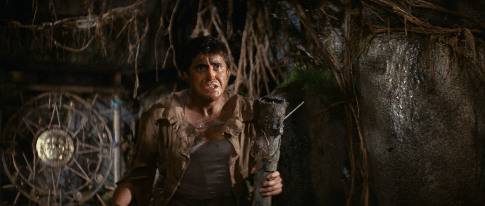

The dowel needs to be fairly straight looking...near perfect, as the dart is supposed to fly straight without any fletching. This means good balance.
Remember, these are the people who made countless booby traps and cast a smooth gold idol with detailed eyes. They can handle a smooth dowel. ;)
Also, see how straight it looks in this cap:

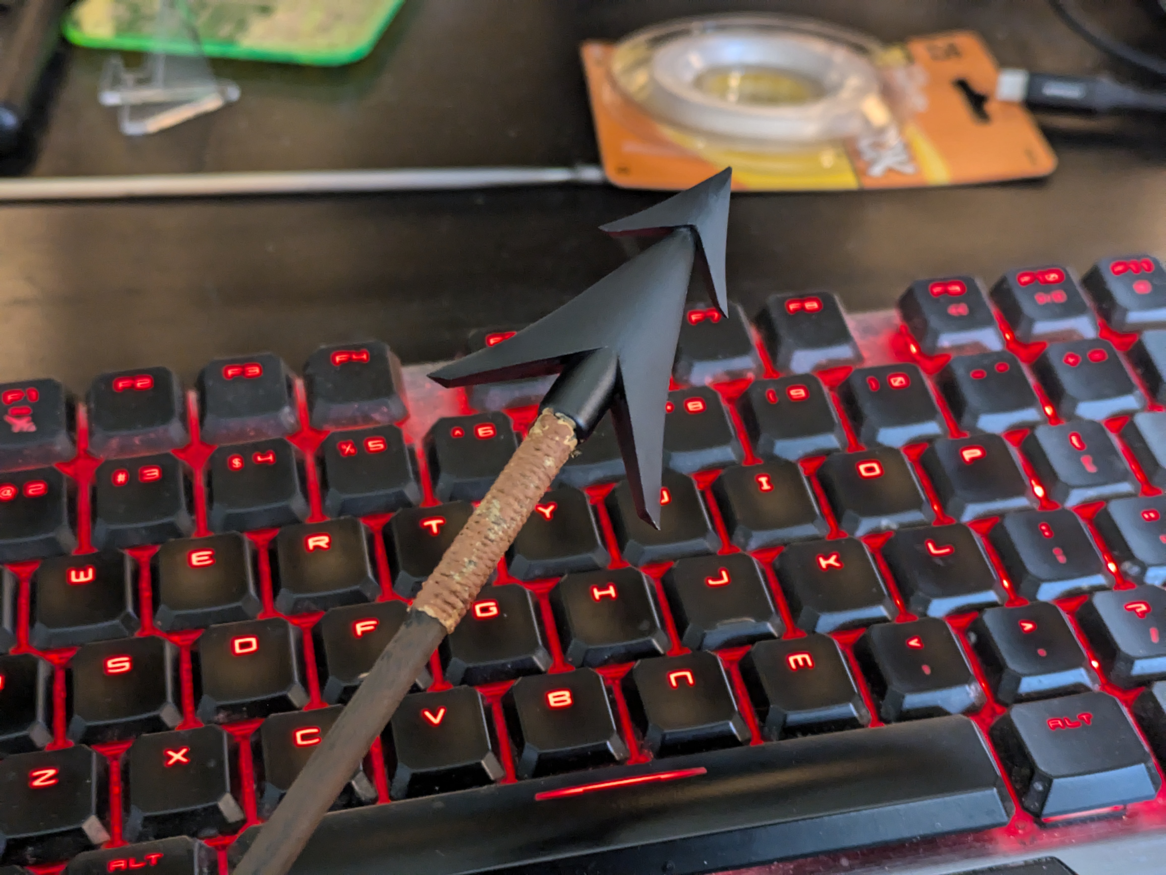

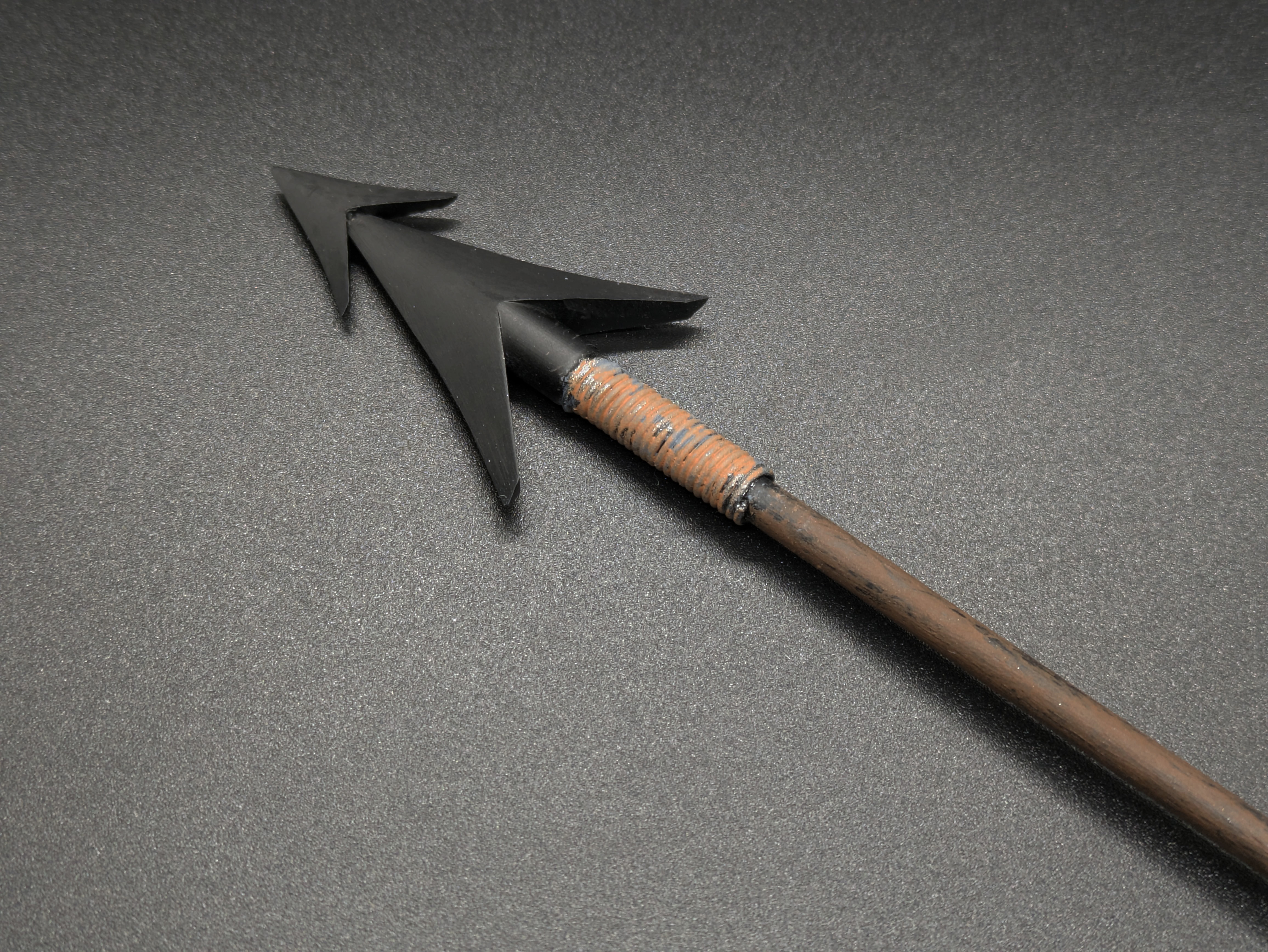

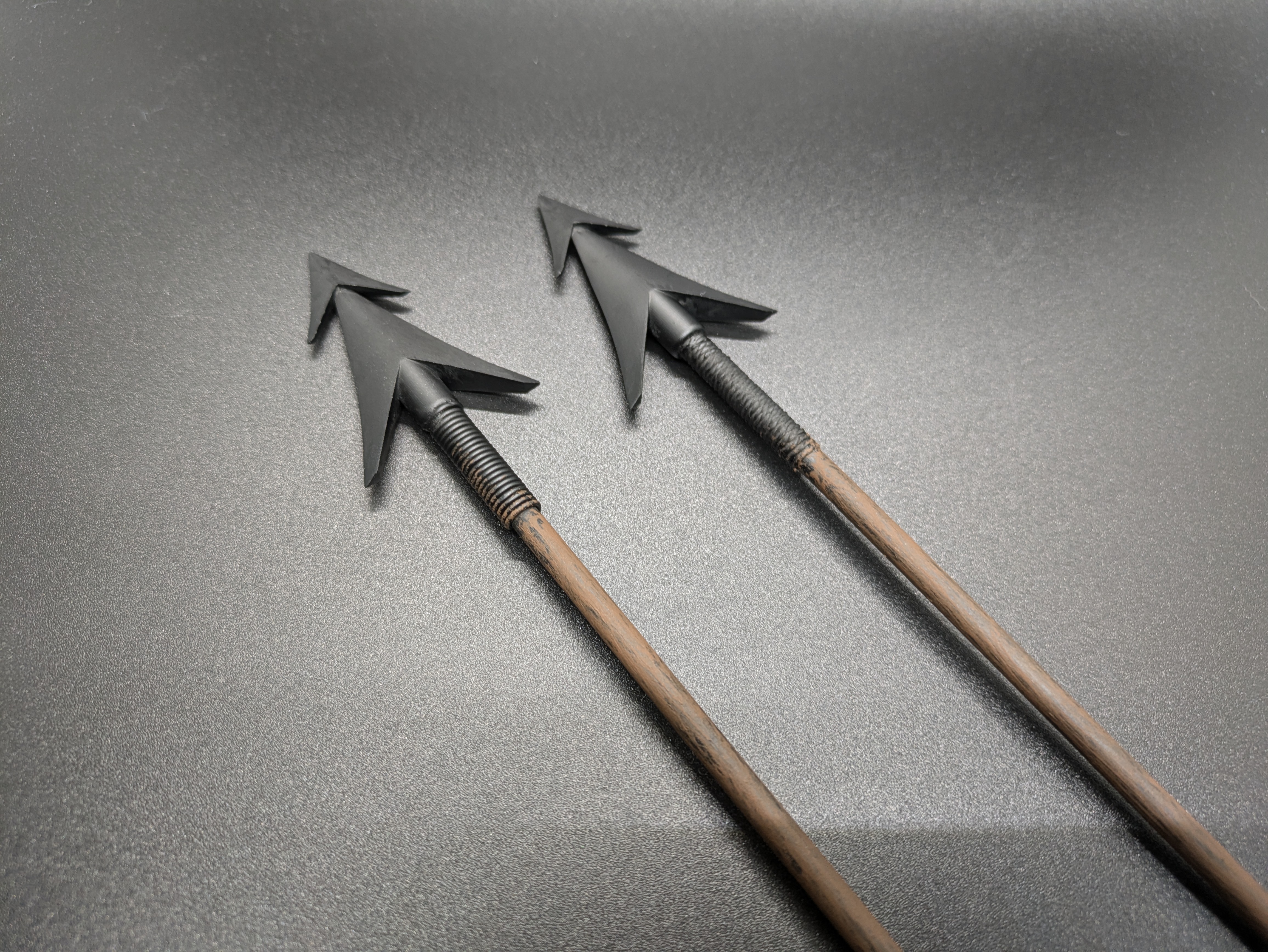

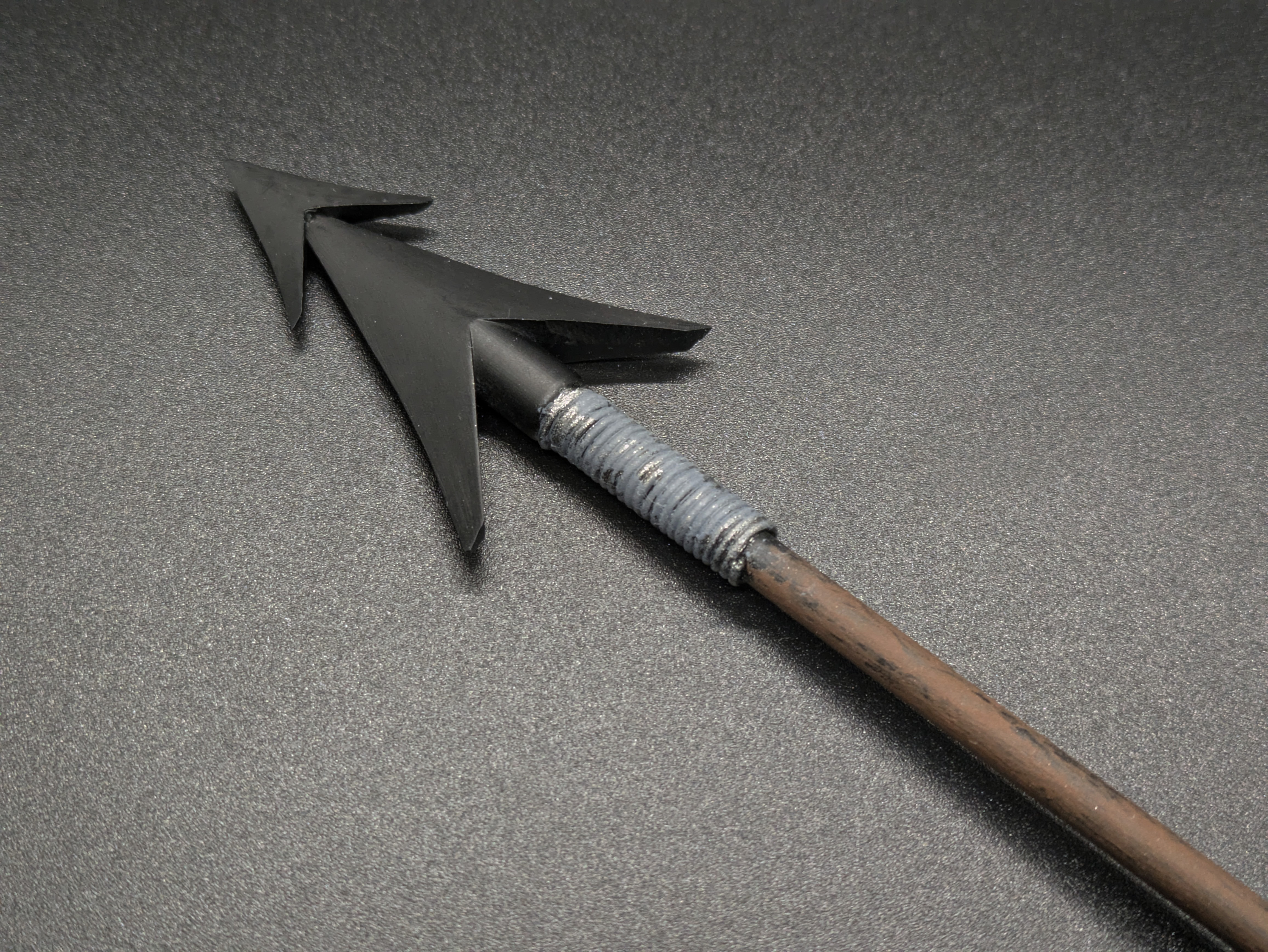

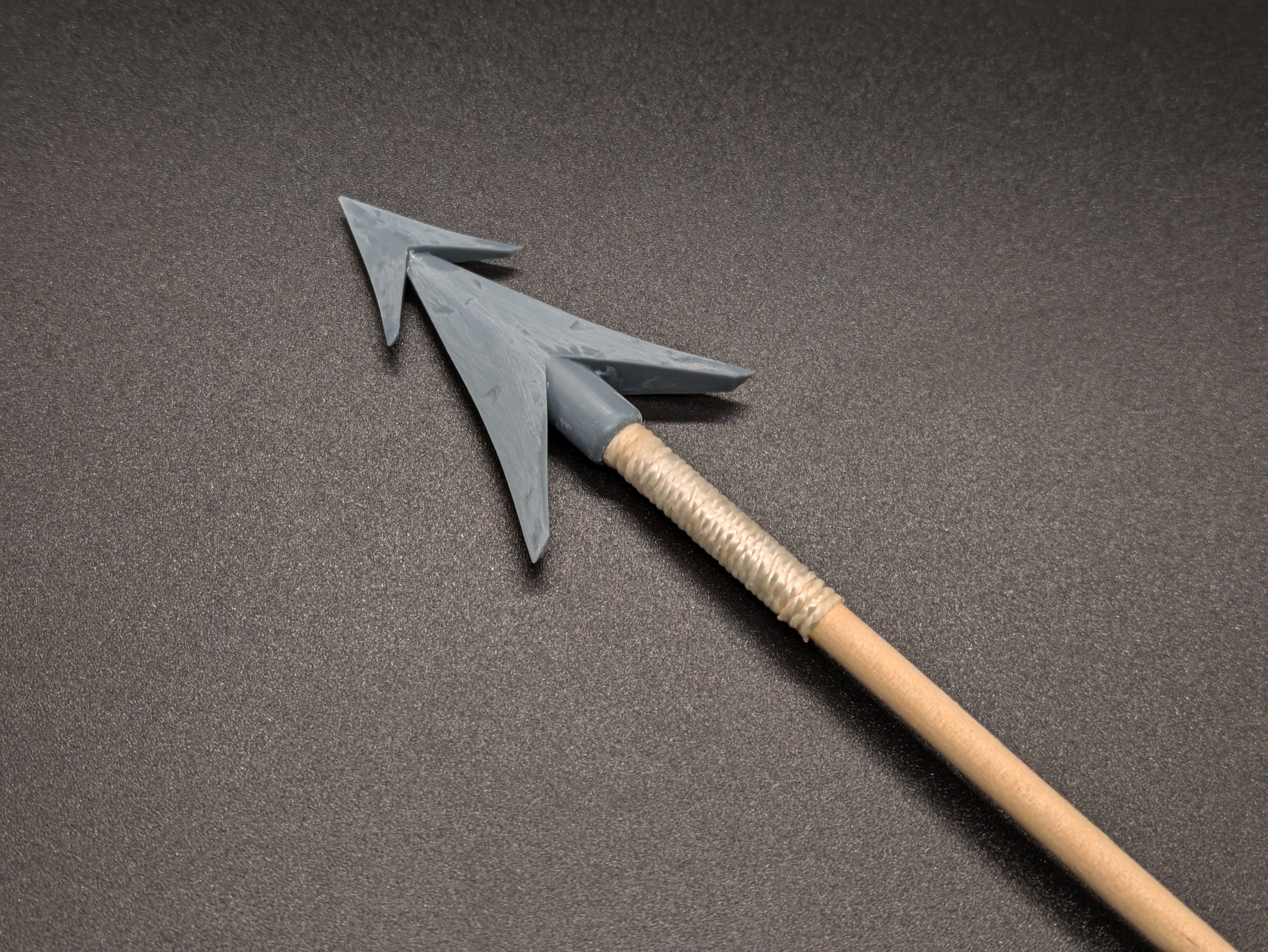

First passes of color on the wraps...
The string wrap has two browns on it, to look extra dirty. I avoided black because that's coming later. The string wrap is done for now.

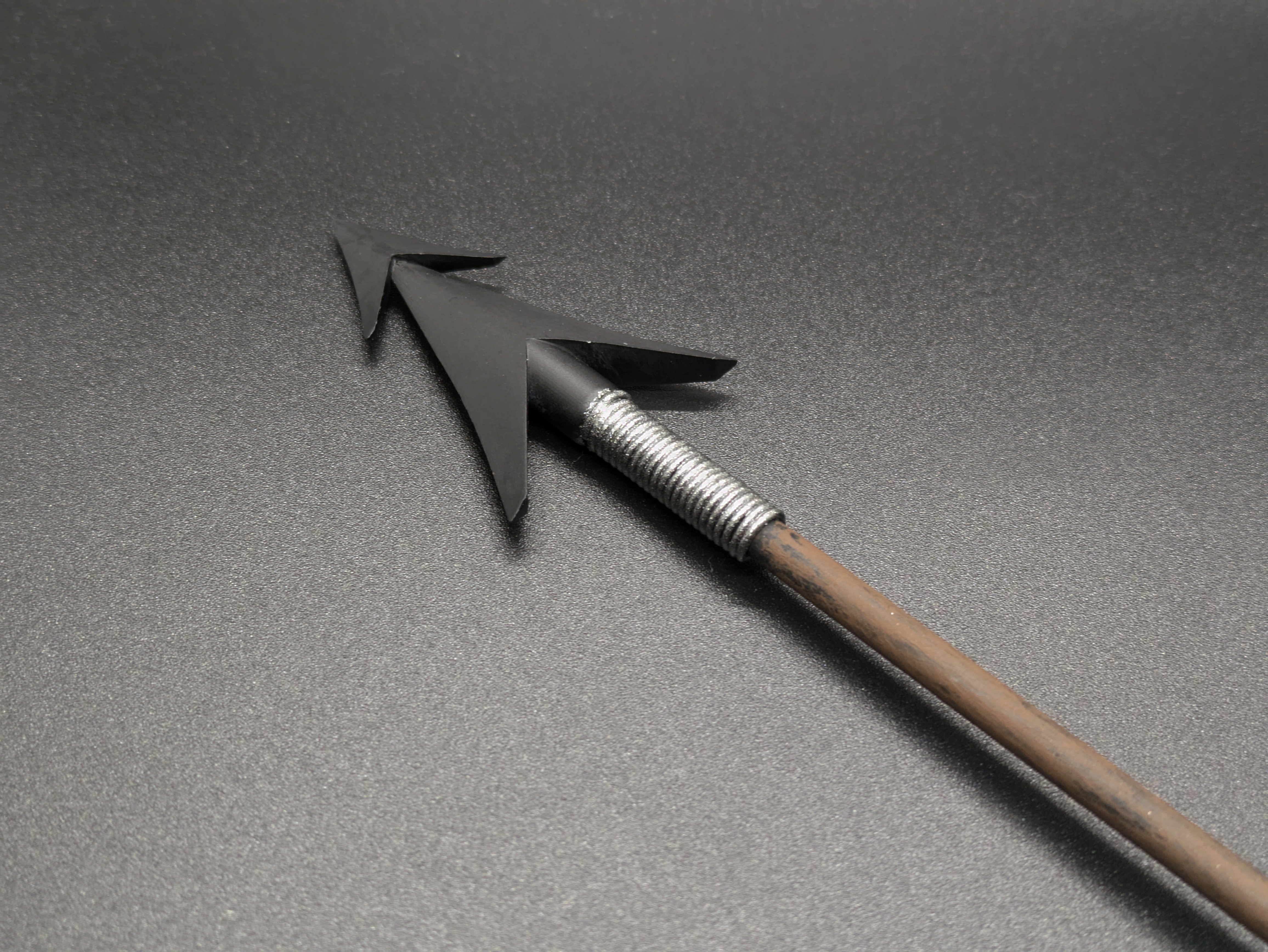

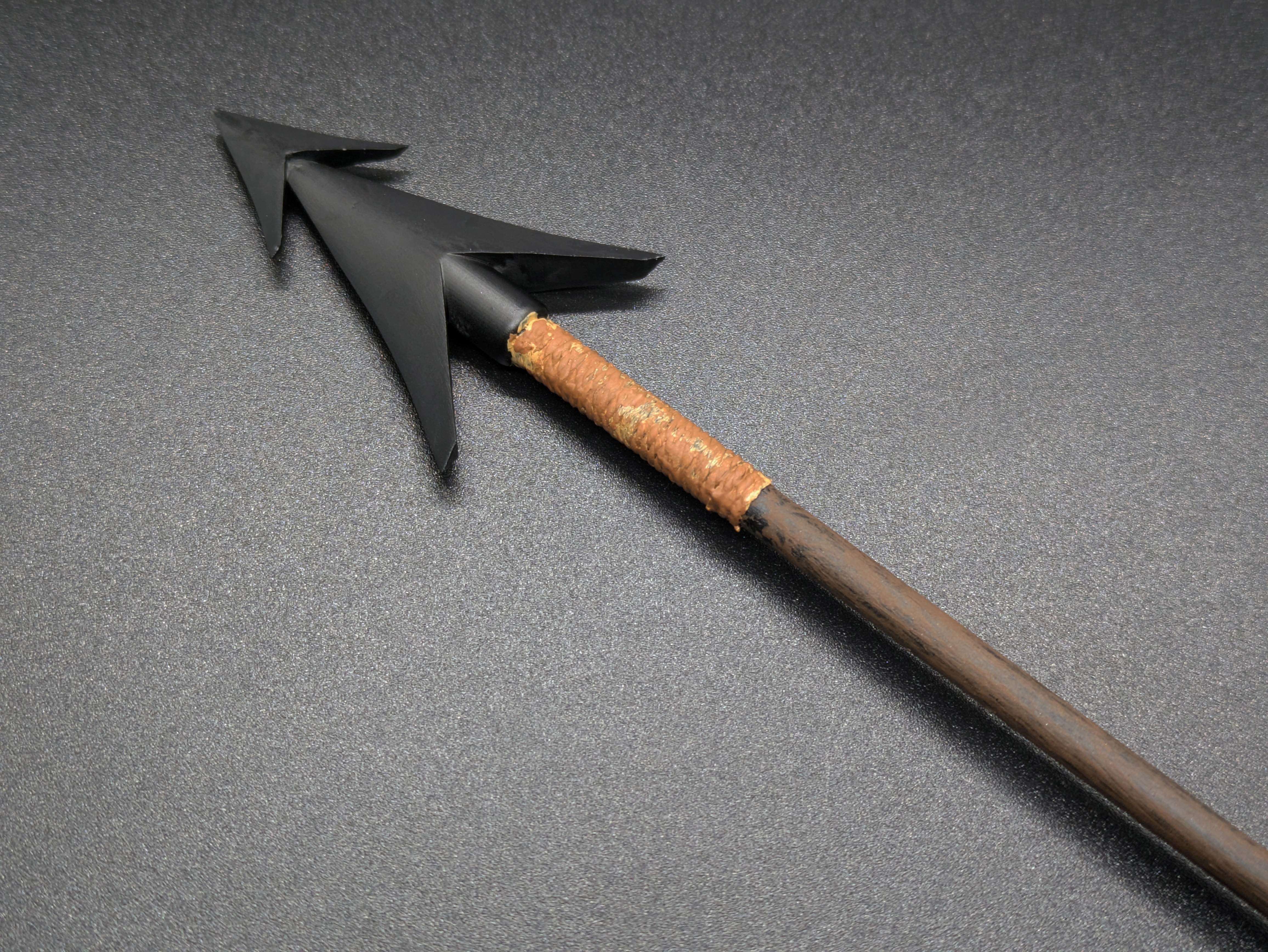

The wire wrap got a layer of Iron spray paint. Several layers of "rust" effect are coming next.

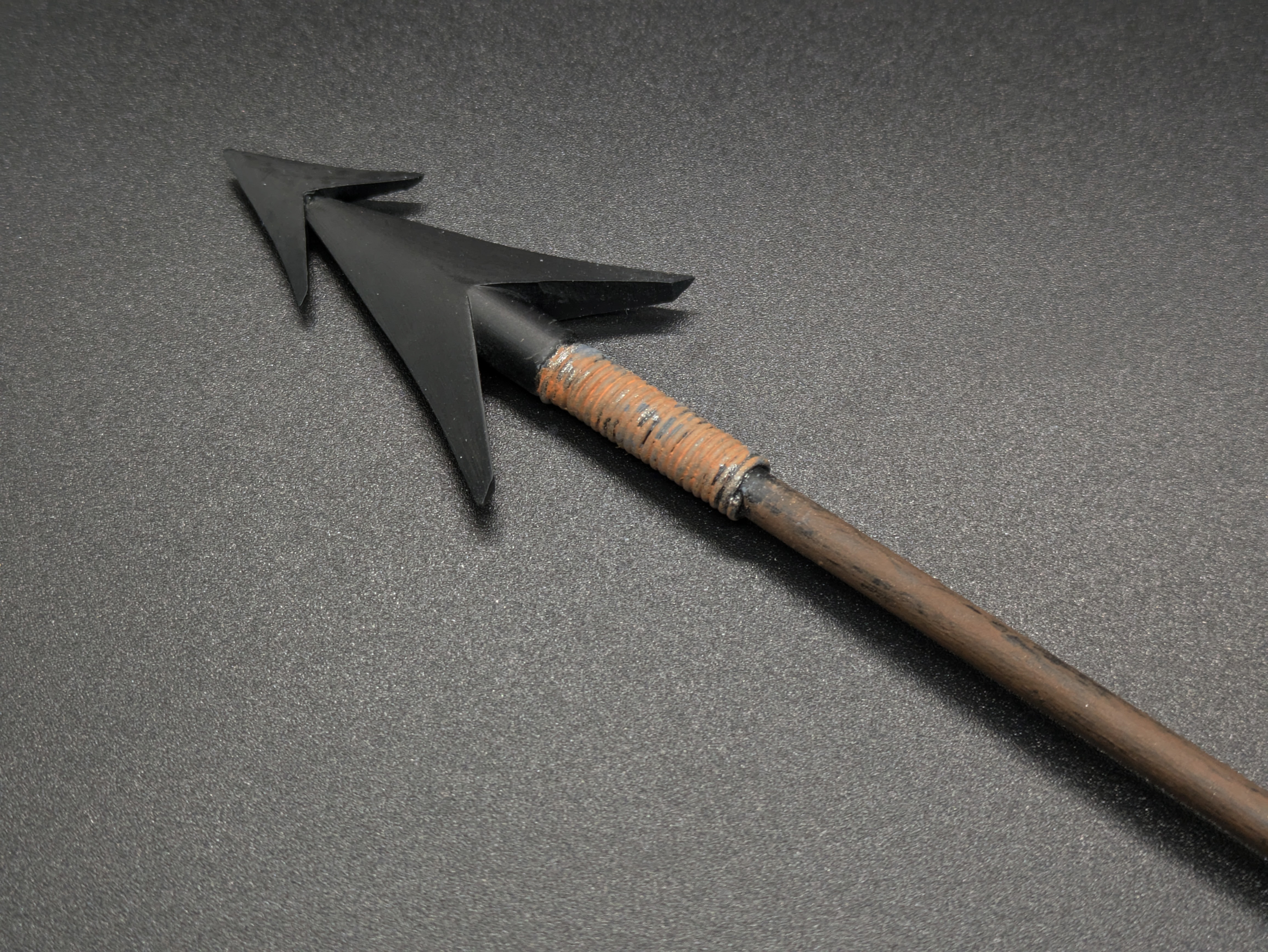

You're going to notice that the colors are going to appear far too bright in the photos. This is for two reasons: (1) my photo booth is extra bright, and (2) too bright is better than too dim, as I will have the freedom to "knock it back" as much as I want in the final black wash and Fuller's Earth powder. The finished dart should be nearly all black, but it will have lots of layers to it.
Observe in more normal light:

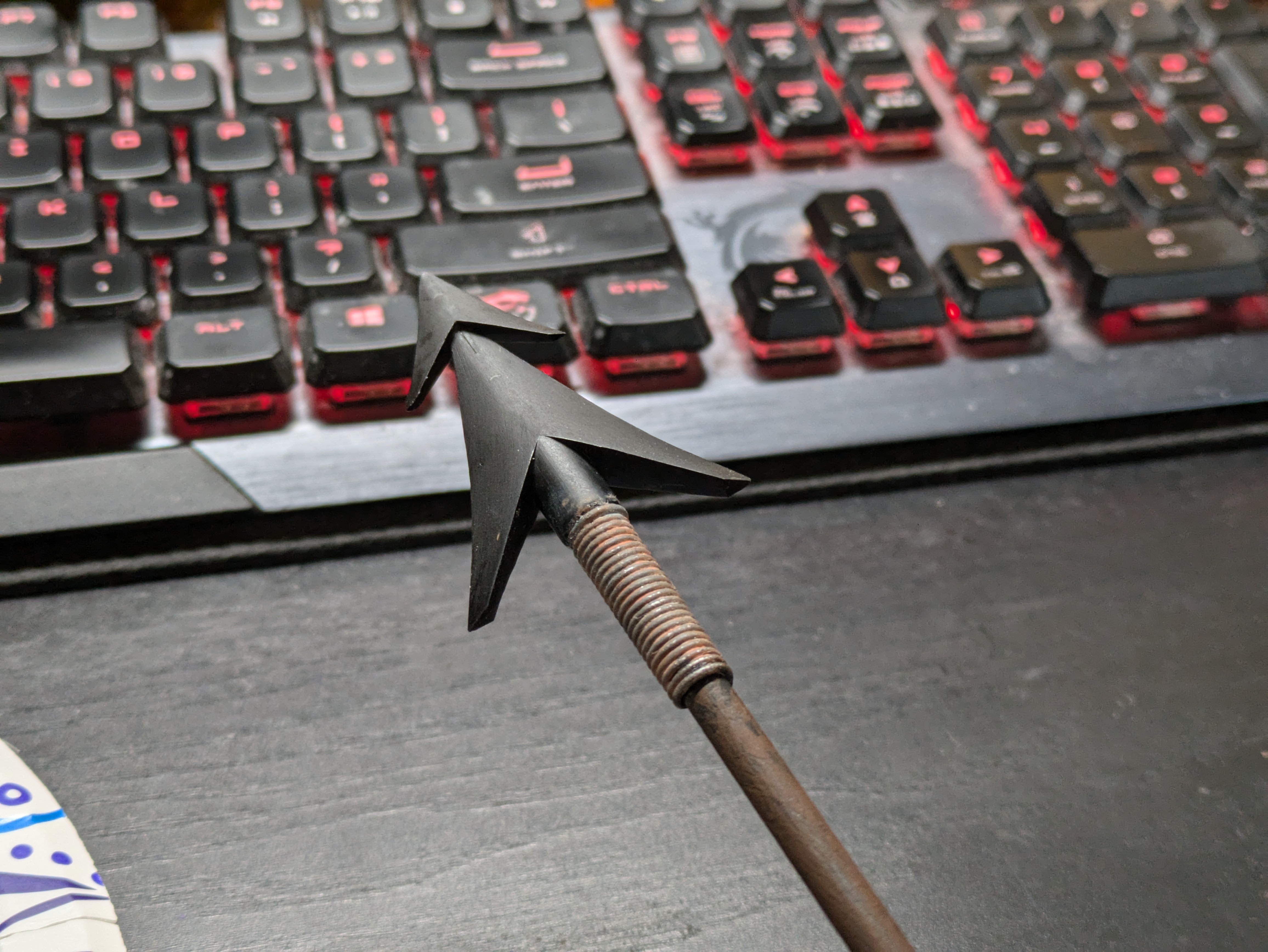

I think I've finished the rust work on the wire wrap:
PXL_20240714_182834231.MP.jpg PXL_20240714_184851604.jpg PXL_20240714_190053120.jpg PXL_20240714_200332270.jpg PXL_20240714_190649983.jpg
Hard to see how it really looks from the photos, but I'm quite convinced:
I followed this really helpful technique (using similar acrylic colors instead of enamels):

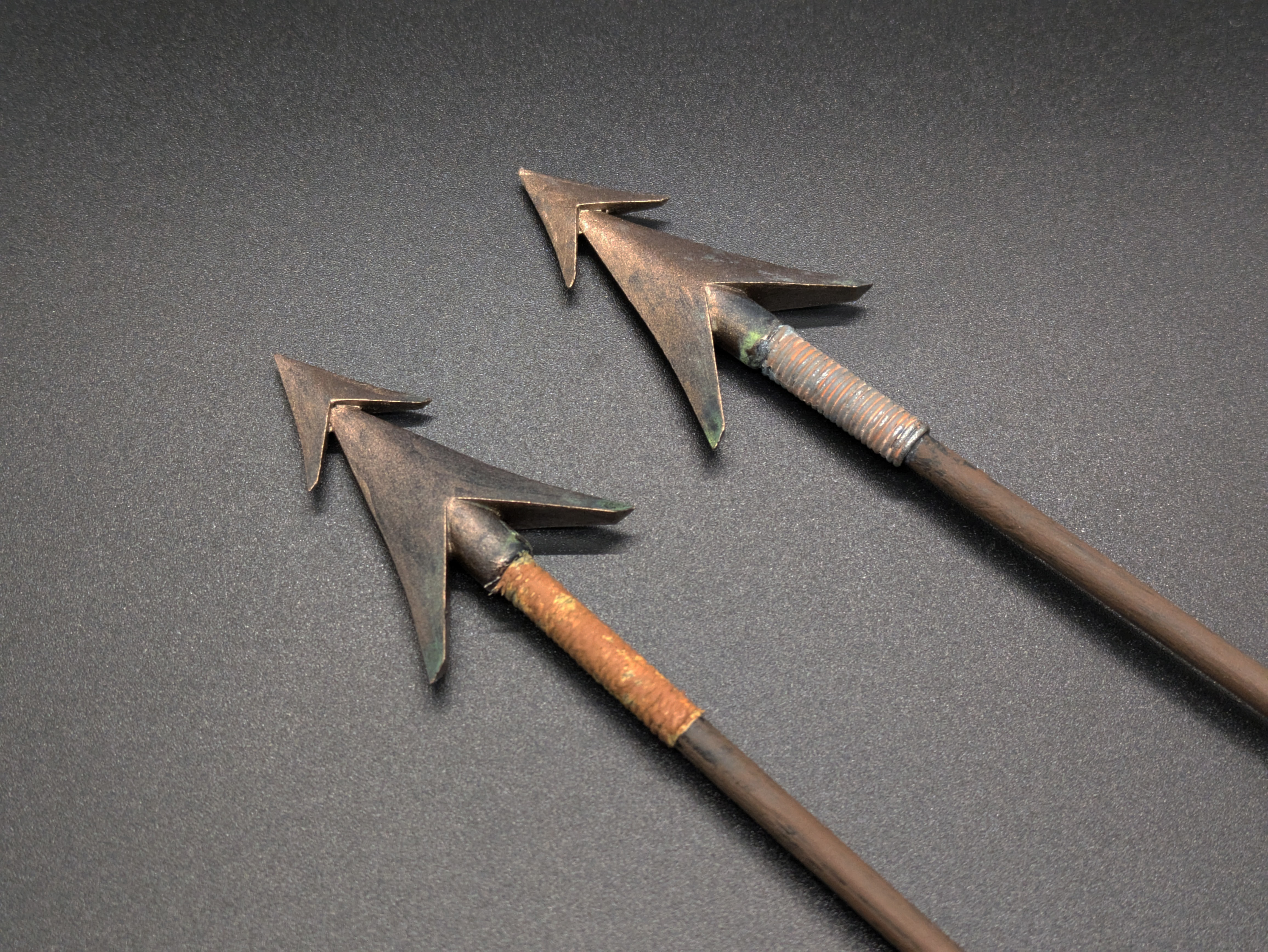

Now just waiting for the bronze & patina kit to arrive later today!

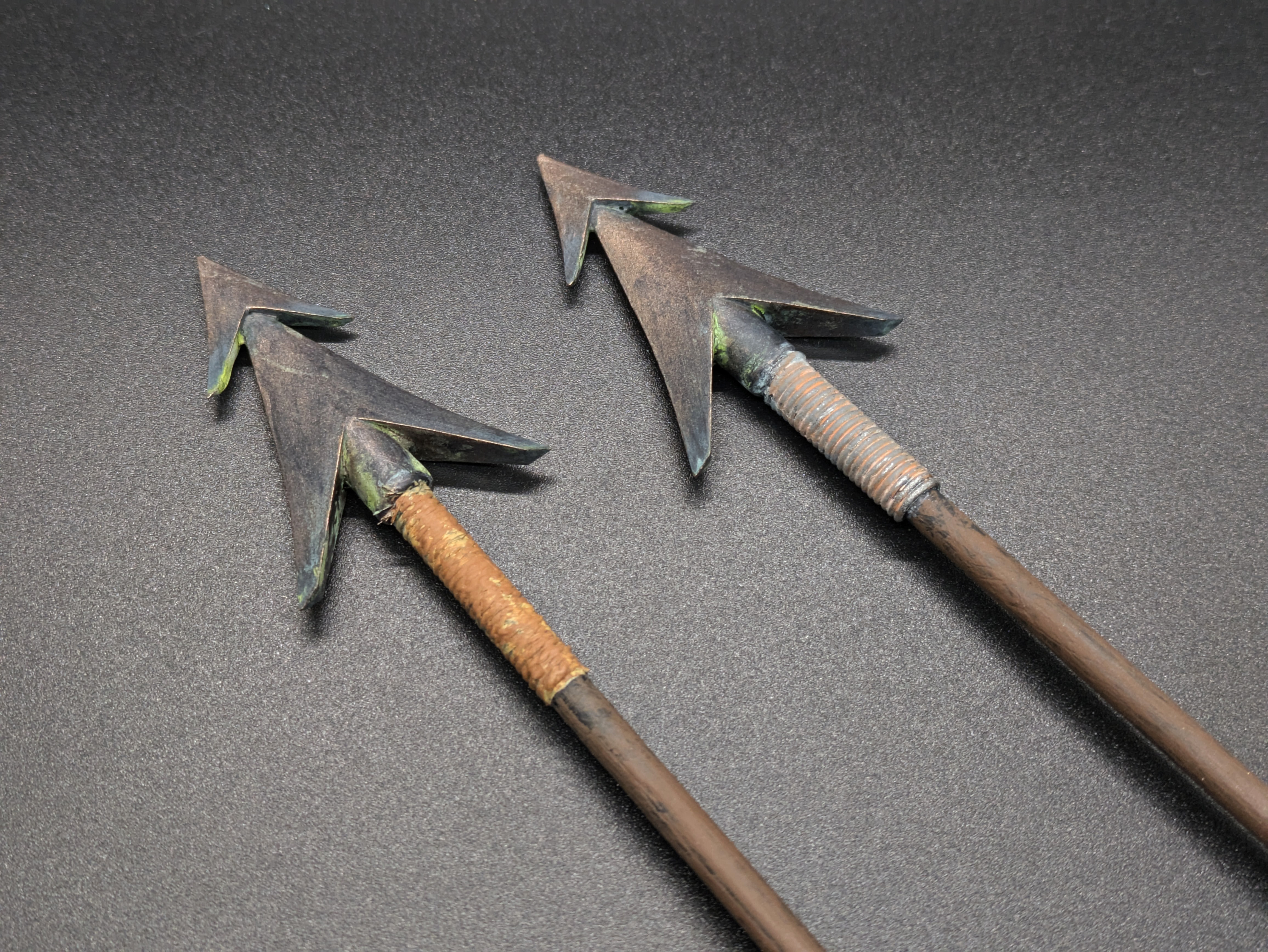

The bronze worked out quite well!
Two coats of bronze paint, with light application of patina activator on the second wet coat:
Another coat of bronze and a heavier application of the activator...now we're talking!
Black wash is next!
