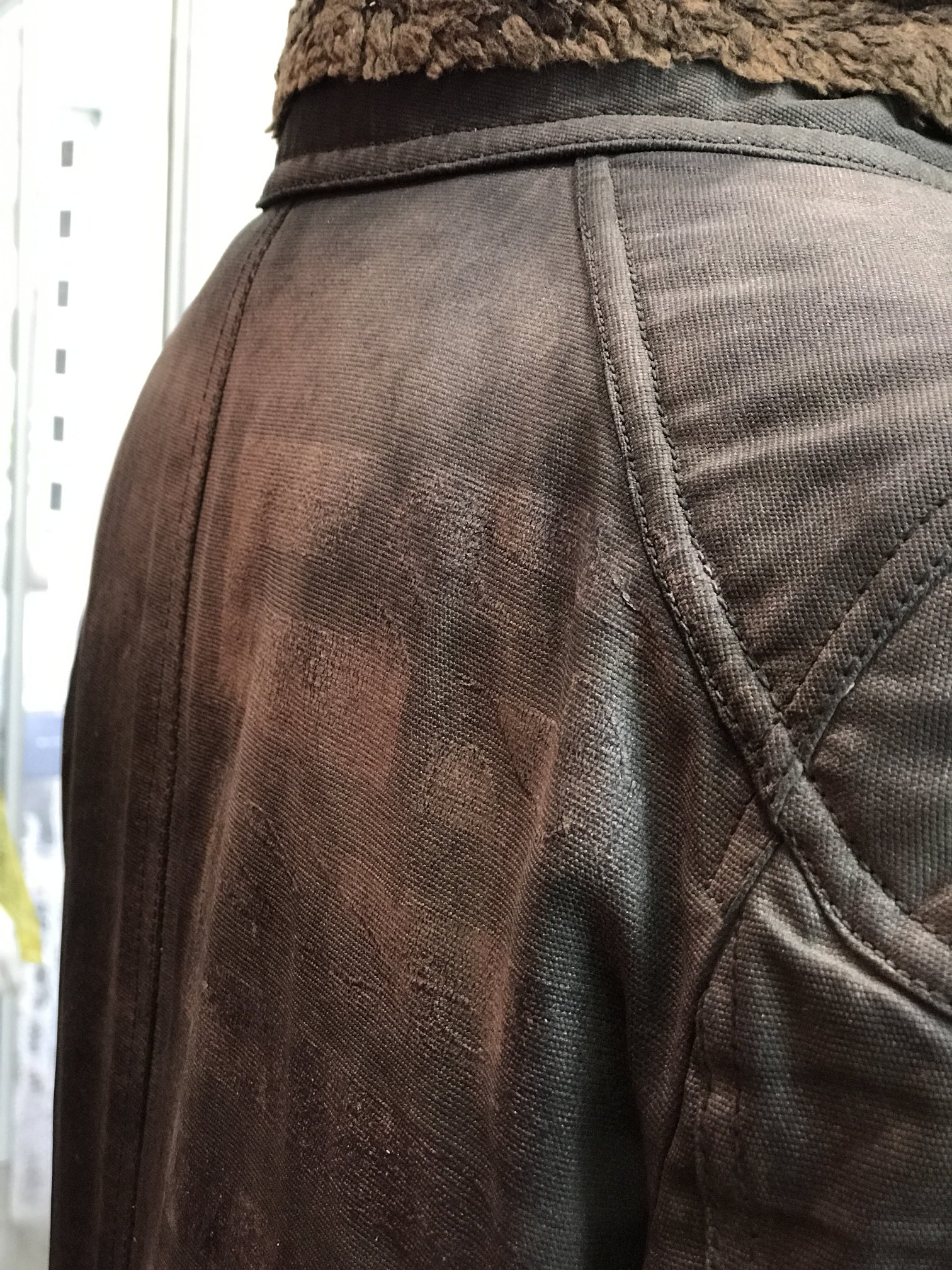

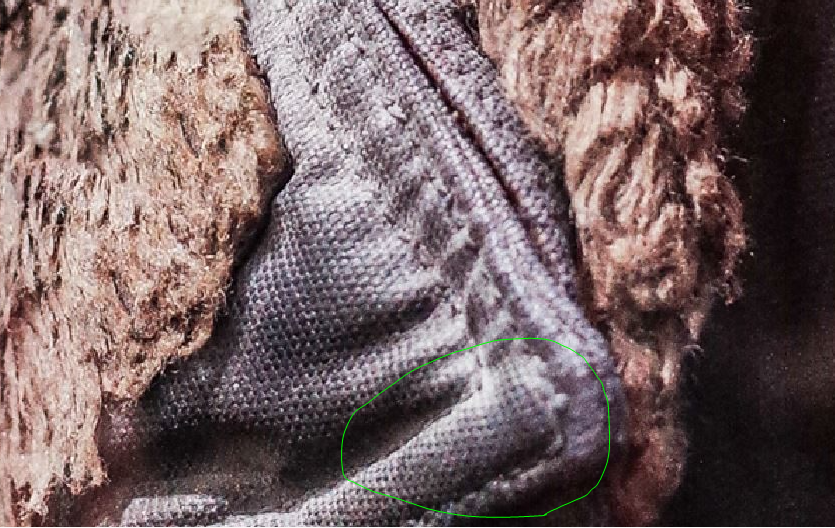

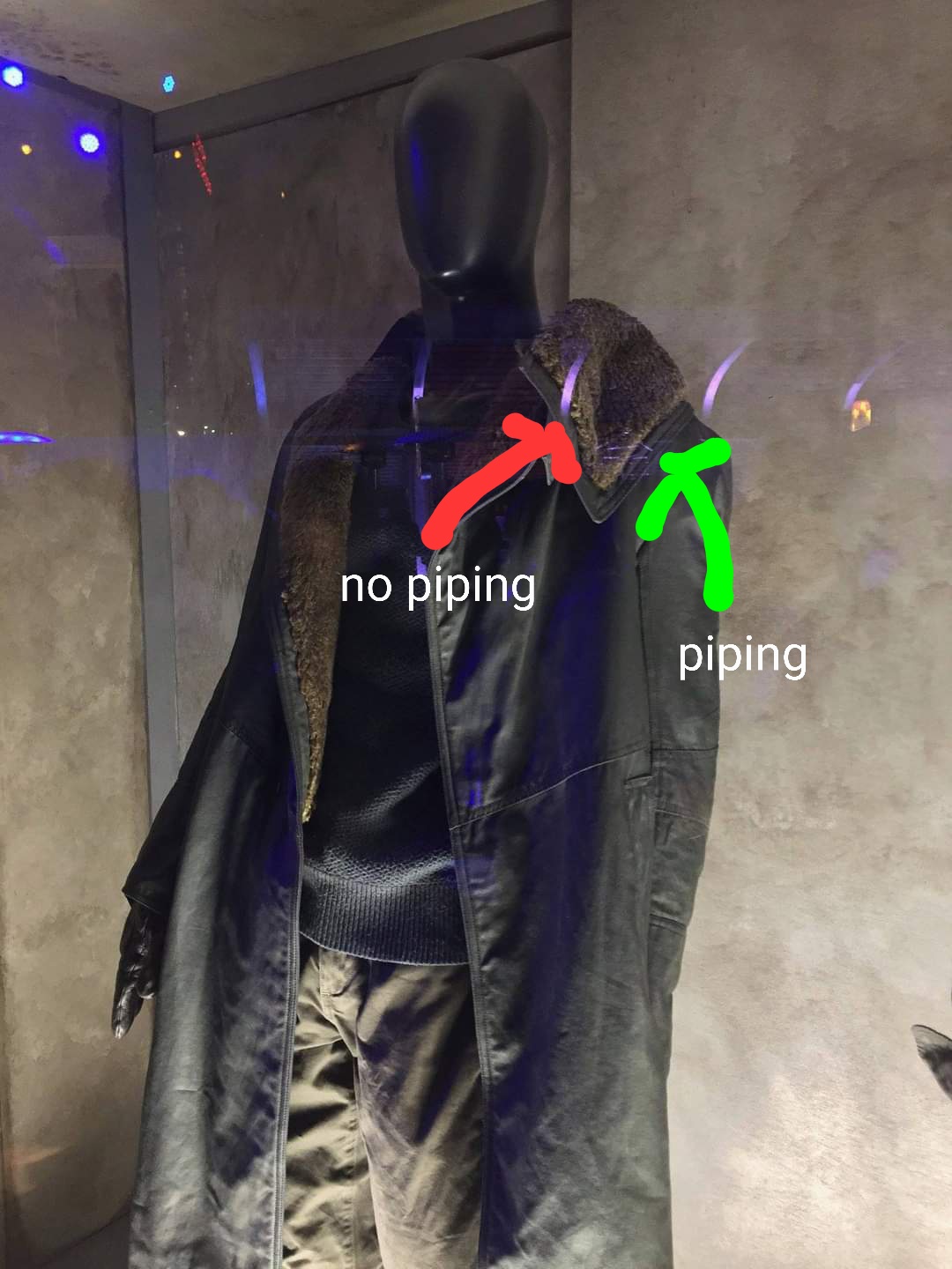

Mechanismo , for the piping, it definitely runs around the lapels. Does it run around the collar edges as well? In some shots, at some angles it seems to me like it doesn't and it could just be the collar stitching...but in other shots like the prop coat on the mannequin display it seems like there's definitely piping there. My default inclination would be to add it all the way around the collar edge just to make it look uniform with the lapels when the collar is worn up, but wondering what your take is here.

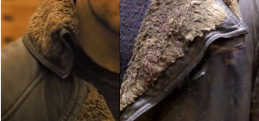

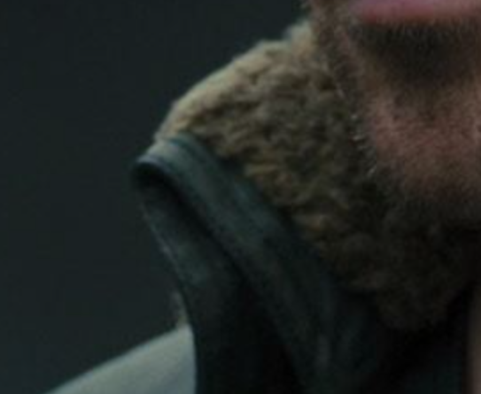

Just as a follow up, the collar's short edges do not appear to have much in the way of piping or piping effect:

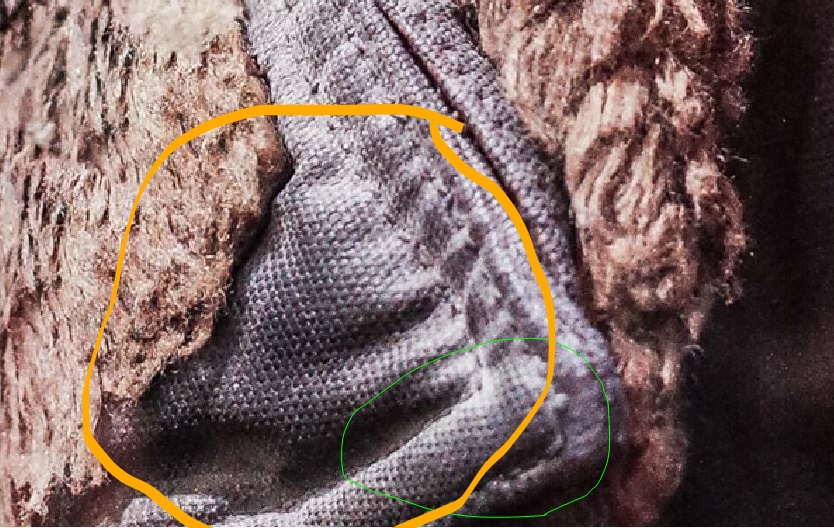

Does anyone think the pipping might be some malleable wire to form the collar shape for certain looks?
So, these two pics give the impression of perhaps having some of that the malleable piping you mention, but it's really hard to to say. It could simply be the way the coat rests on the wearer. One thing is for sure, the coat's construction has heft and weight to it.

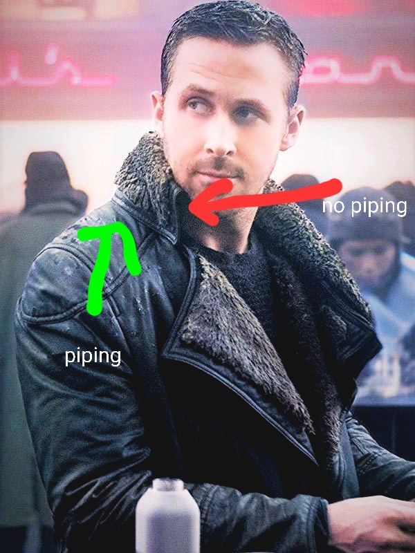

So like this? Essentially no piping along the side of the collar that folds down or the belt buckle edge? My tailor is doing the collar today so want to be as sure as I can be here.View attachment 1554645View attachment 1554646

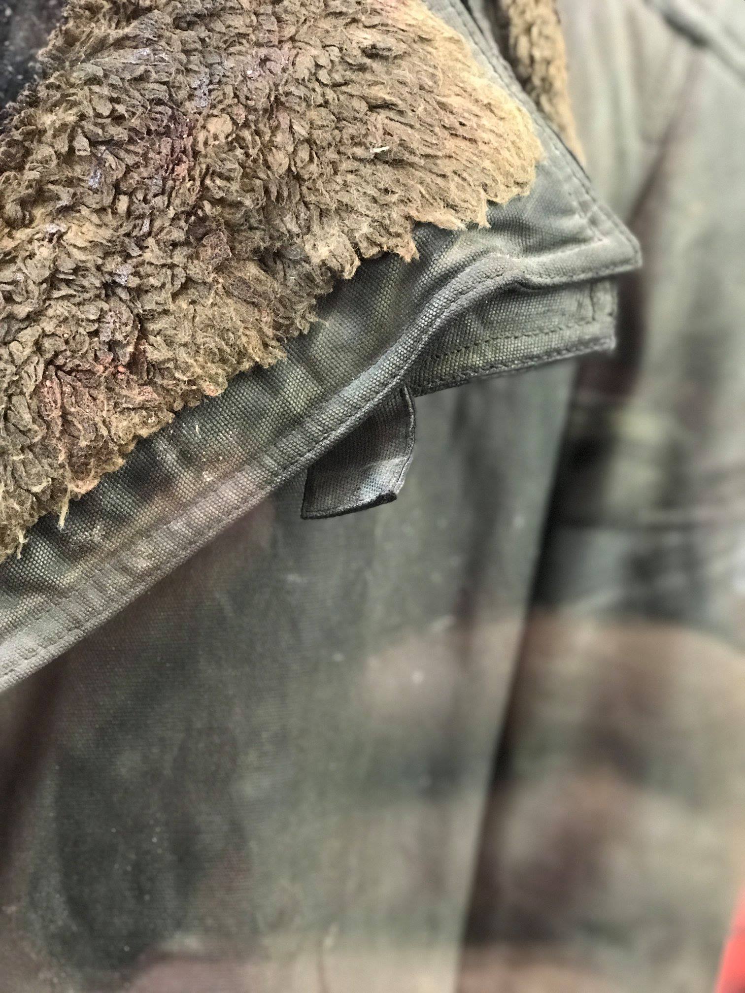

It appears that way, but again, bear in mind that it may be a piping effect. What I mean by that (and Egon mentioned this some time ago) the way the fabric presses/squeezes together between two narrow parallel lines of heavy-duty stitching could give that effect also. Having said that, in this picture of the lapel, there appears to be clear piping starting at the edge:

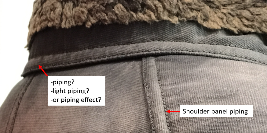

The shoulder panels appear to have piping as well. With the collar edge, however, it's a little trickier. That edge definitely has a lip, but what is it exactly? Maybe Jameel Ur could weigh in here as well.
Hello friends,
There is no piping in collar, lapel and shoulder panels.
Shoulder panels have thick foam/ padding that usually use in jackets and coat as shoulder pads.
Second, under the the shoulder panels has body fabric, so now there are four layers in shoulder panel.
1. body fabric layer.
2. 10 mm thick foam layer, that makes piping look. ( I'm using 10mm might be possible others using more thick or thin).
3. Shoulder panel fabric layer.
4. Shoulder edge fold layer.
Now let's discuss about lapel and front edges.
There is no solid avoidance about piping or puffy look on collar and lapel.
Could be designer put foam or something inside front final stitching to make same look as shoulder panels.
So, we put foam in front final stitching to make sure front and shoulder stitching look same.
As Egon mentioned and I also wrote somewhere, fabric seam allowance can give puffy look too.

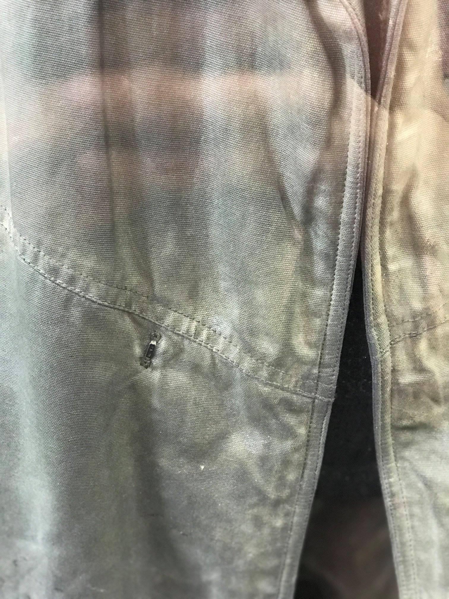

Hello guys,
Take a look at these images and after seeing them, I was right before when I don't using any puffy stitching or inserting foam in final front stitching.
Coat fabric is slightly thick and seam allowance reflection puffy look.

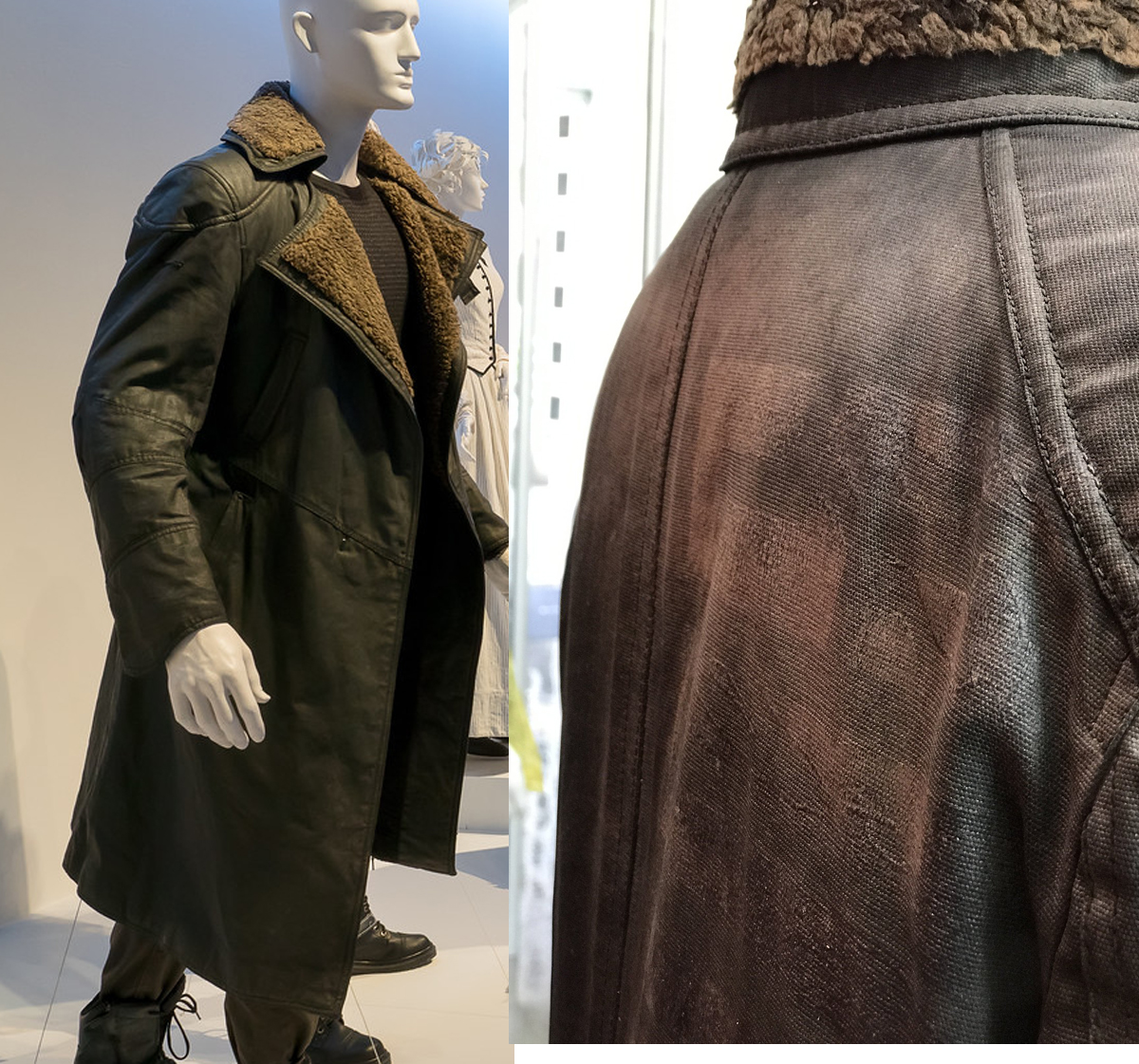

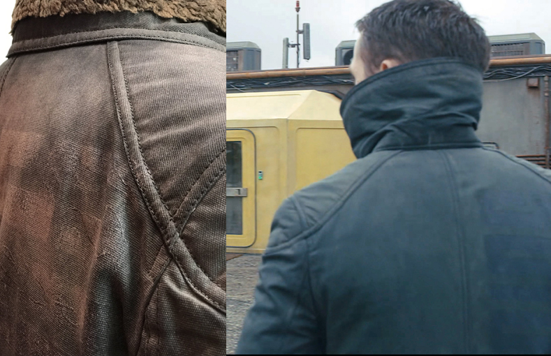

In the last, as I wrote early in this thread, how we can develop a single with different details.
There are different coat that has different shape, different design details and different fabric.
Take a look at their shoulder panel shape, are those same?
Are those coats fabric same?
Definitely no, so Why are people asking SA SA?

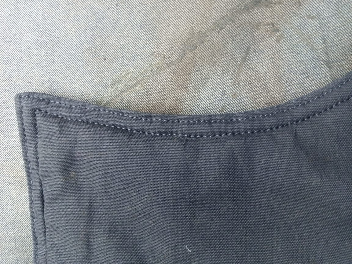

How about this puffy stitching?
There is no piping, just lux foam, that used in BR coat shoulder panels.
I think this looks great, Jameel!
Throughout this conversation, I kept thinking that the piping on K's coat was more subtle than the type of piping that I've seen on other garments. Because of this, I was worried that adding "real" piping to the replicas would look exaggerated or overly-rounded compared to the movie coat.
The slight puff you've achieved by stitching over the foam...to my eyes, this is the perfect mid-point between a regular flat stitch and traditional piping.
