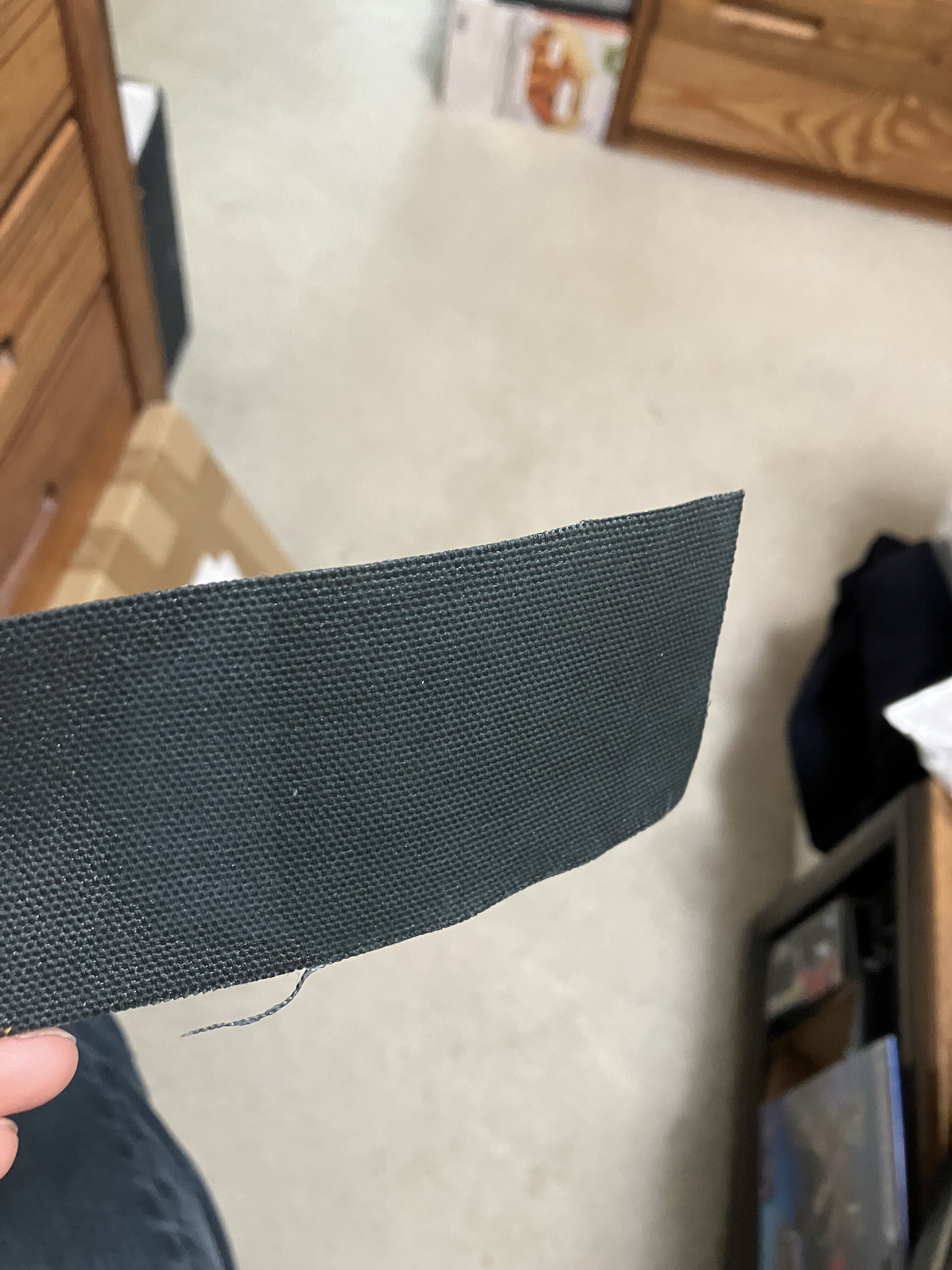

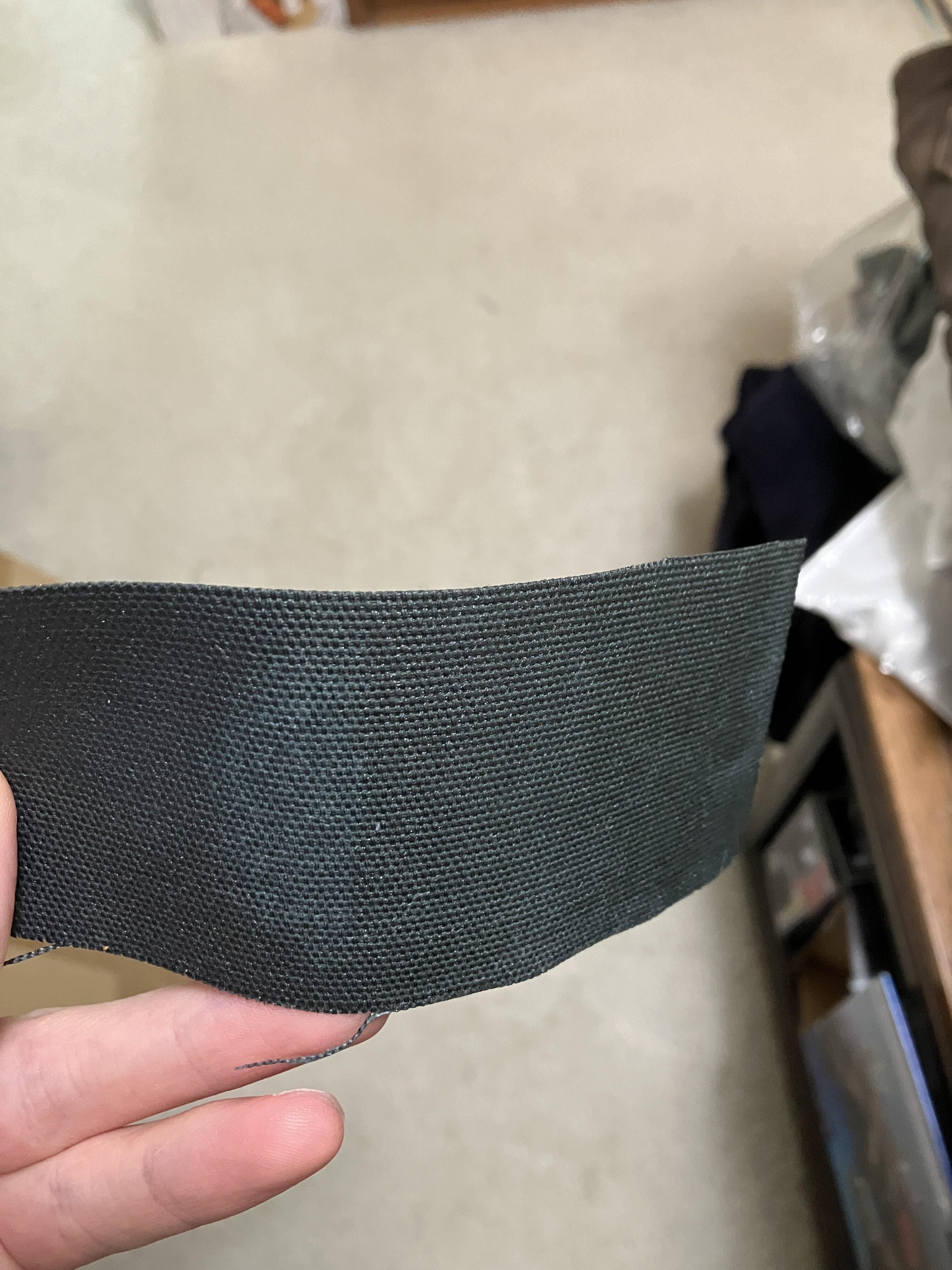

I'll have to do a little more testing but I think I might have figured out a solution! The Angelus Acrylic Finisher is very thin, basically like water, so on its own it completely soaks into the canvas and dries very stiff and not at all shiny. But I figured since it's meant to be applied on top of paint or leather, maybe it'd work better as a coating over the Liquitex medium, so I tried that on one of my smaller samples. It went on very smoothly, dried with a perfect level of sheen (a tad shinier than the Liquitex which I'd felt wasn't quite as shiny as would be ideal) with minimal additional stiffening, and most importantly seems to be sufficiently water resistant to both protect the Liquitex from getting re-activated and turning milky as well as completely stop it from soaking through the fabric.
These aren't very good pictures, I'll take better ones once I paint a larger sample and let it cure, but this entire piece was has 2 or 3 coats of Liquitex on it, and then half of it has one coat of the acrylic finisher over that. I got it wet under the faucet and you can clearly see the line in the middle, with the side on the left being the plain Liquitex that you can see is turning milky where it's wet. There's a little bit of the milkiness on the acrylic side at the edge, but that might be where it's thinner, so I think I just have to make sure I apply a thick and even enough coat.
These aren't very good pictures, I'll take better ones once I paint a larger sample and let it cure, but this entire piece was has 2 or 3 coats of Liquitex on it, and then half of it has one coat of the acrylic finisher over that. I got it wet under the faucet and you can clearly see the line in the middle, with the side on the left being the plain Liquitex that you can see is turning milky where it's wet. There's a little bit of the milkiness on the acrylic side at the edge, but that might be where it's thinner, so I think I just have to make sure I apply a thick and even enough coat.View attachment 1942419View attachment 1942420
not bad, I really hope you can do it. Maybe if I have time in the winter and no one else has found a definitive solution yet, I will also try other acrylic coatings like that acrylic wax I posted some time ago.
Besides, more than making do, and managing your own fabric that you have in front of you by giving some possible ideas, there's nothing else to do I'd say...if someone who has contacts with the production wanted to explain the method properly, by now it would have come out, but maybe he would have referred to a result obtained on the cotton used in the film, which for us may be unobtainable of the exact same type, and even if it seems the same, even in that case, it could then react differently to the coating and attempts to wash or wet it.
I fear it would be even less understandable, even if the person who got one of the coats at the auction decided to speak out here: I don't see how he could still give certainties on how the result he has in front of him was obtained, without having obtained it himself, indeed
