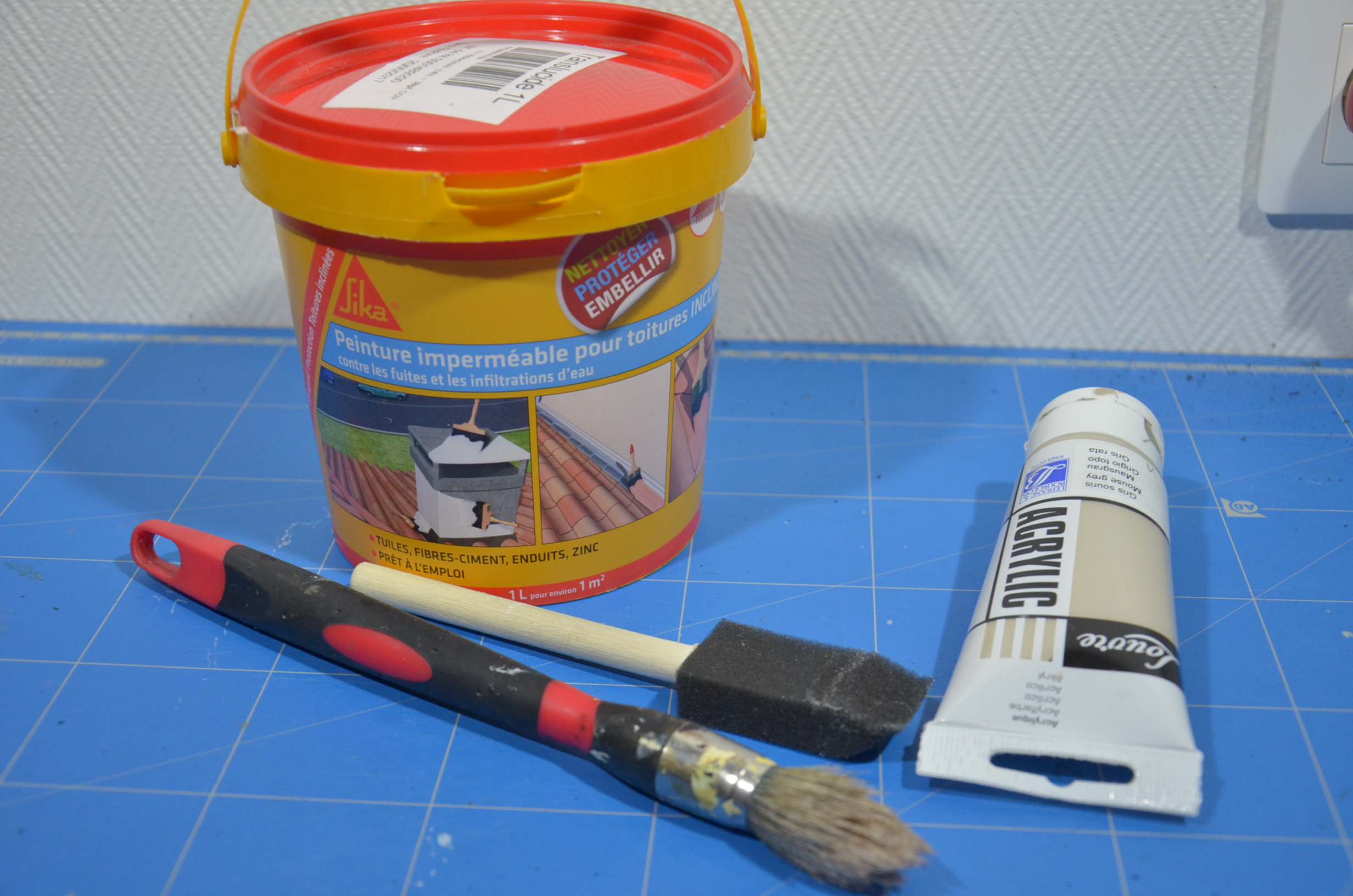

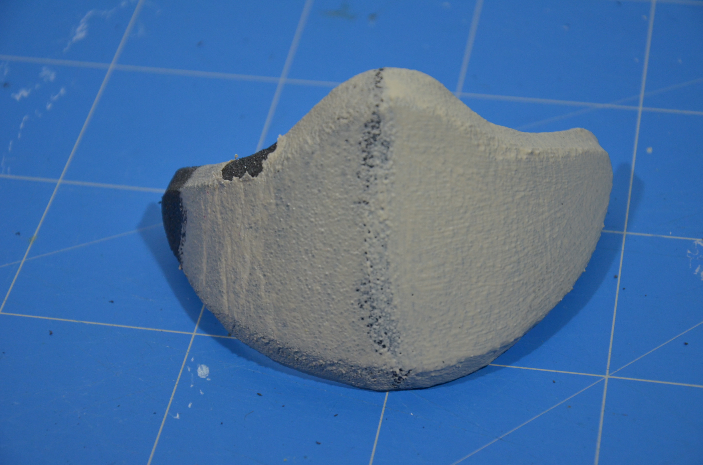

I tried 2 mixes to coating foam. N°1 (to the left on pic): white glue (used for wood) + acrylic paint. N°2 (to the right of pic): Sikagard + acrylique paint. As you can see, after twist and bend foam, mix N°1 peels and crack unlike N°2 which resits (3 coats minimum needed).
So mix 3 doses of sikagard for 1 dose of acrylic paint. That what I've done for this picture but I'll try 2 Sikagard doses for 1 acrylic paint and test it, it probably be enough.
Sikagard is a rubber coat for waterproffing inclined roof. It resists to UV, to weather and I choose the clear one in order to tint it with acrylic paint. Sika is available over the world but I don't know if Sikagard is the name used everywhere.
Here pics of it but in french.

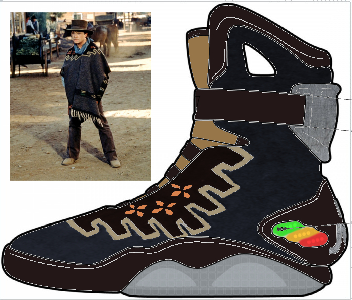

Given this seals foam, might be also be useful in the foam builders section for projects like PEP. Then again, your heel cup looks like a PEP unfold ;)

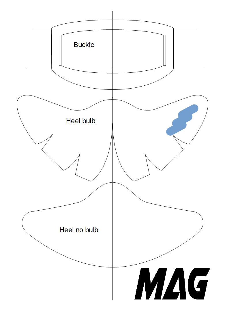

Do you have a pattern for the cutout of the bubble light? I want to add that to the Sketch Up file so that the pattern can be used to create left and right symmetrical parts.
I don't know if it works on V2. I have not any pair of Nike Mag. But I think yes, maybe sanding a little bit your sole before. The notice explain that you can coat metal, PVC, Polyester with it.
I don't have bubble light pattern (this is the 3 colors light on heel I suppose), cause as you can see I don't integrate any electronic in my model, but I can try. I was thinking about "glowing in the dark" tape possibly for sole for different reasons (no battery needed and a lower cost of shoes). But it's tempting :)
Maybe something like that
Perfect! I'll add this to the file.
What are you wanting to do with the little bit on the back of the heel?
Sorry, I have some difficulty to translate your question in french. What do you call "the little bit on the back of the heel"? is it a specific part of the pattern?

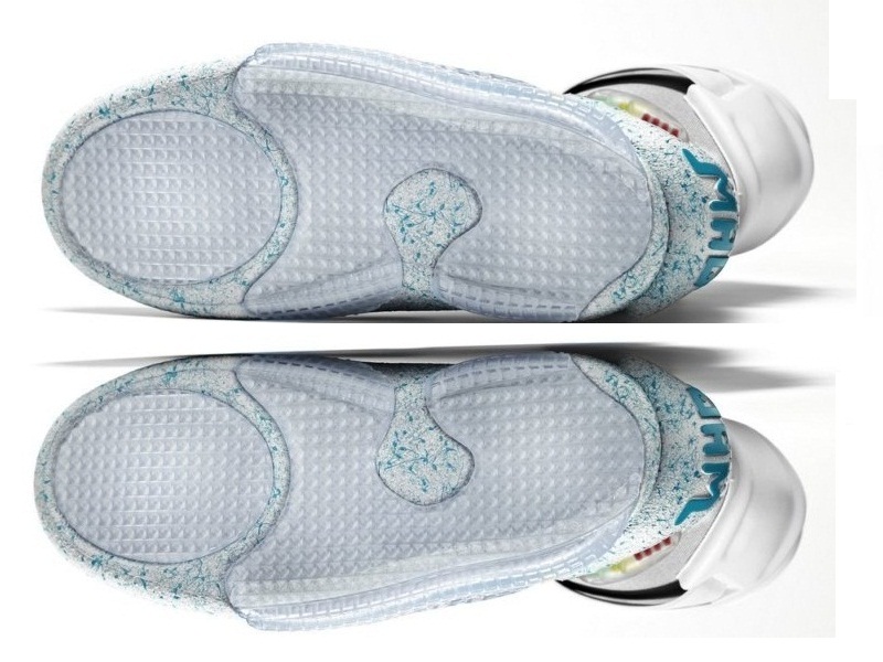

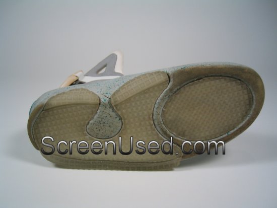

If you look these images of the both the 2011 MAG and screen used shoe, you can see what I am talking about. Interesting, it seems they changed the shape slightly on the 2011 shoe.

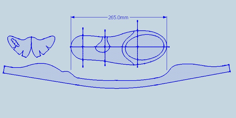

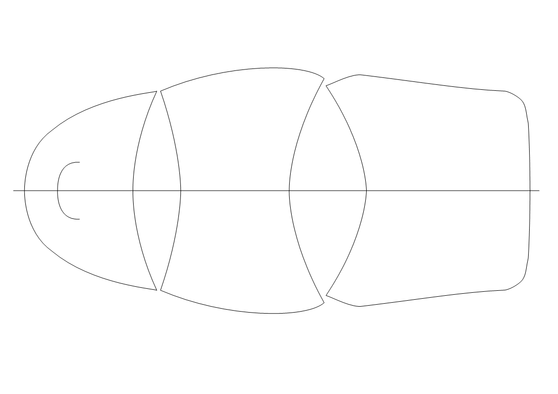

Jewan I have added the cutout to the heel cup file. Now all I need to do as sort that bit on the heel, convert this to a DXF file and I can then have these laser cut.
attachment.php
I would have to break the sole into a few "layers" as well for the laser cutting to be effective.

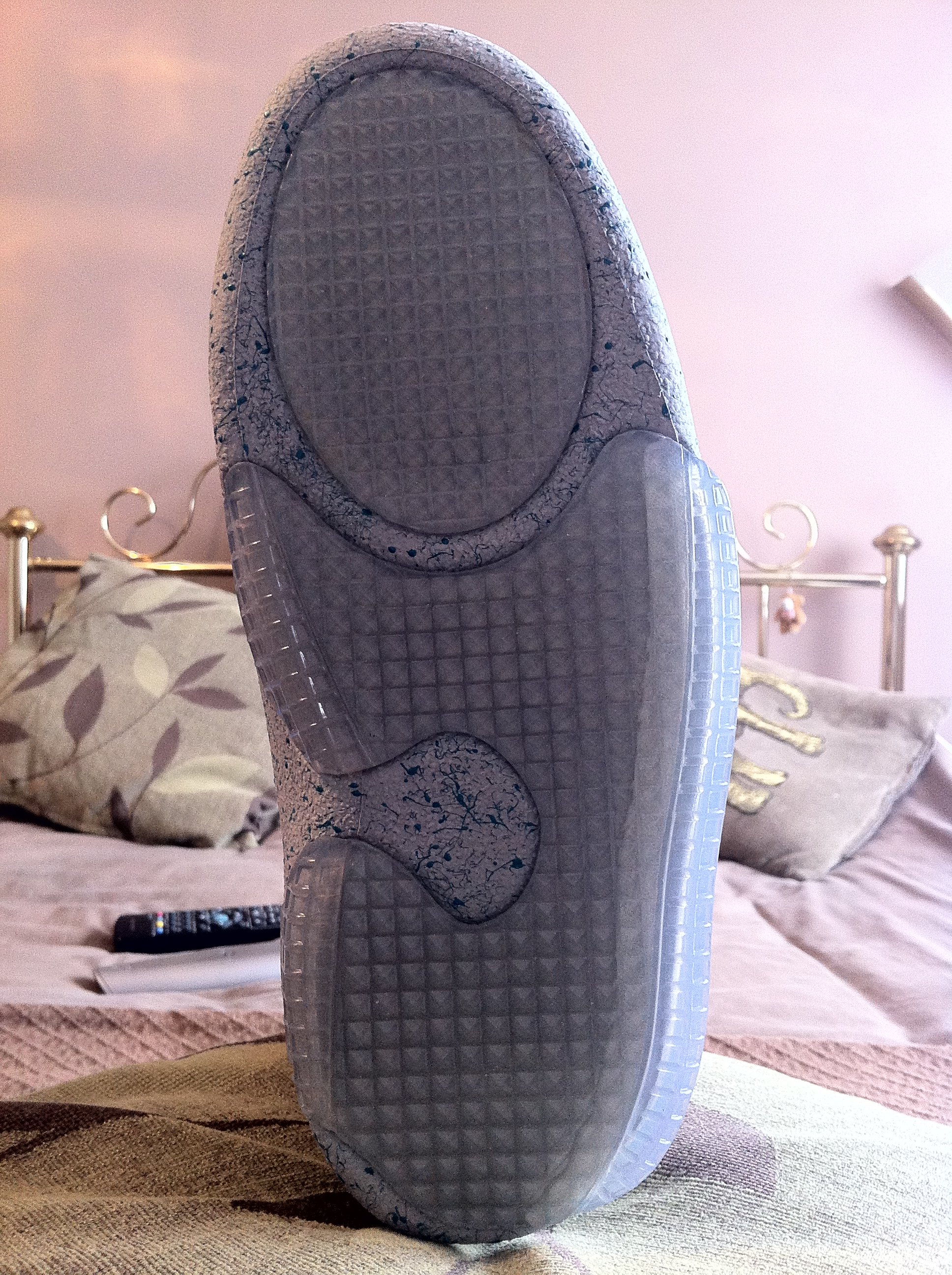

You cut foam with laser ?
You can, but I will have these parts cut from rigid plastic, texture them, then make an open back silicone mold.
I had considered #40 grit sandpaper to make the master, but plastic coated with vaseline and fine sand (like that used in a sand pit or fish tank) will probable work best. The silicone will capture all the details in a female tool. After that, I will use the same rubber (tinted light grey) to make a positive that can be glued up and BOOM, done.
If I am really anal, I can rub the inside of the mold down with aqua rubber first, then after that cures, pour in the grey. The two fuse and the splatters become the texture bumps only.
Actually, thinking about this, I need to include the base of the clear sole, pour the clear base first, then add all the other layers. You won't get better fusion or bond than that.
