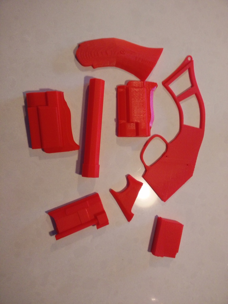

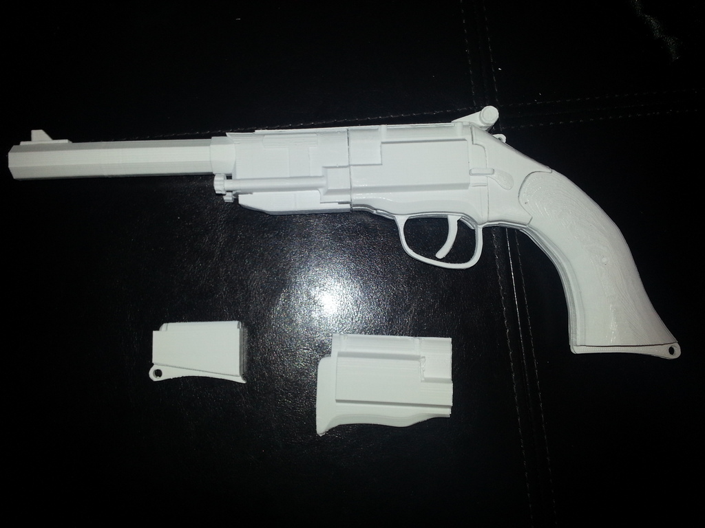

Assembly Guide:

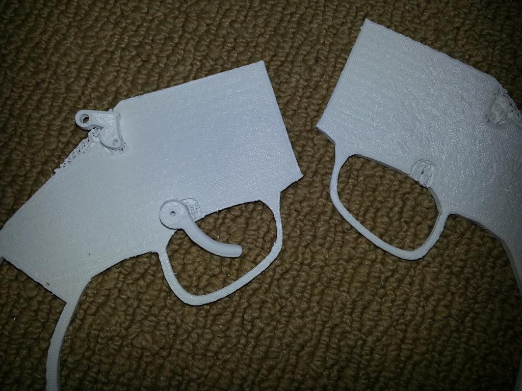

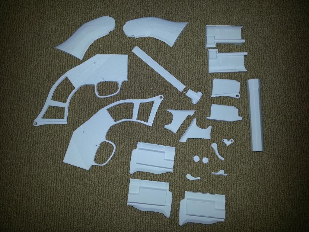

This is a pretty easy one to do, but remember sand, sand then sand some more. I usually start at 80, then 150 then 220 grit. Crazy or super glue is all you'll need to stick it all together.
1) After sanding, clean out the areas where to trigger and hammer fit.
http://i1154.photobucket.com/albums/p533/rgriesbeck/Firefly/2014-07-01192059_zps8bfb8306.jpg
2) Then what I did is using the spare piece of filament, cut 2 pieces that will go through one side of the gun through the trigger and into the other side. Do the same for the hammer, you may have to drill out the holes if they're a bit small. Once everything fits, glue the inner sides of the body and clamp it together. Don't glue to close to the trigger or hammer or you'll glue them in place.
http://i1154.photobucket.com/albums/p533/rgriesbeck/Firefly/2014-07-01192122_zpsa5bdd1bc.jpg

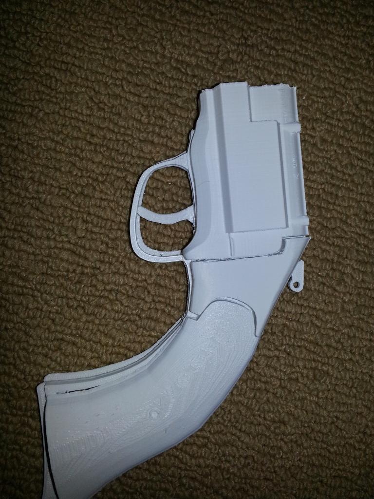

3) That's really the biggest part. now just start assembling the pieces onto the body. Pick and choose which side pieces you want to make either the movie or TV gun
http://i1154.photobucket.com/albums/p533/rgriesbeck/Firefly/2014-07-01192157_zpse0a42ca5.jpg

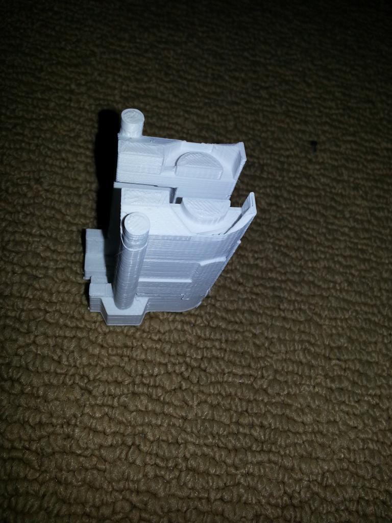

4) Assemble the 2 pieces that hold the clip in place, then glue it onto the body.
http://i1154.photobucket.com/albums/p533/rgriesbeck/Firefly/2014-07-01192225_zps7343ab62.jpg

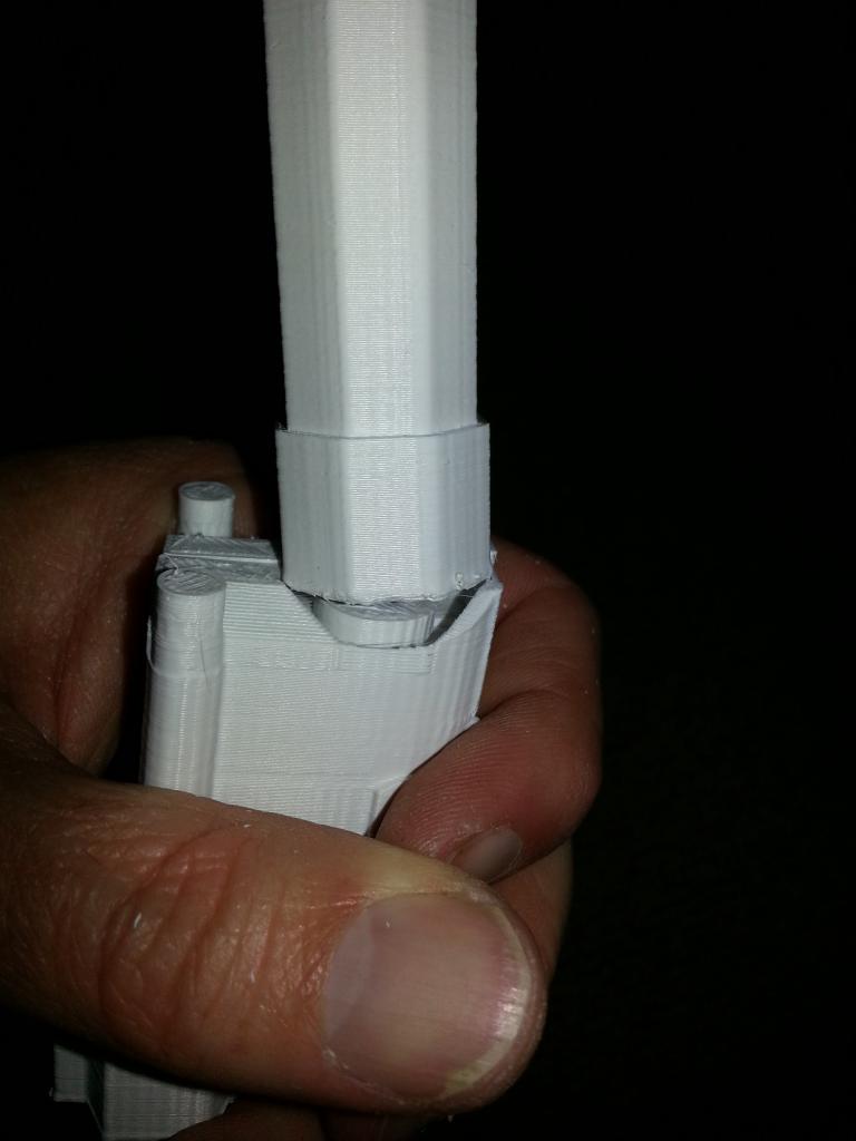

5) The barrel is a real tight fit, Sand and/or cut bits away until it slides into place, then glue.
http://i1154.photobucket.com/albums/p533/rgriesbeck/Firefly/2014-07-01192335_zpse42df90c.jpg

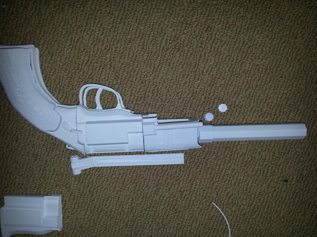

6) Now it's just simply just gluing the rest of the pieces on, then using some filler to fill the seams. Then sand and paint.
http://i1154.photobucket.com/albums/p533/rgriesbeck/Firefly/2014-06-13224517_zpsac6c3f02.jpg

Here's what I was able to steal back from Photobucket
