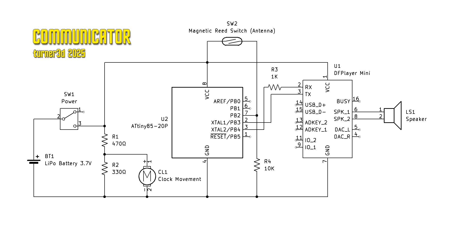

My ATtiny85 microcontroller was delivered today, so it was time break her down again. I'll be redoing part of the wiring harness, but it's going to live attached to a breadboard for a while so I can iron out the firmware. I'm pretty psyched - here's the plan:
  • When the antenna is opened, it will randomly select one of 27 different chirp patterns to play, based on how often each of those patterns were present in the show
  • If powered on with the antenna open, it will just spin the moire silently for as long as it remains open. 10 seconds after closing the antenna, it will start making the incoming-call beep every 7 seconds until the antenna is opened again, cancelling the beeping and playing a random chirp
I've never worked with an ATtiny85 before, but it doesn't seem like it's going to be too bad. I've already set up my UNO as an ISP and successfully burned the bootloader and uploaded my first primitive sketch to the ATtiny.
I think I'm finally ready to call this one done! 31 unique chirp patterns, timing fixed, and some more fun stuff worked in.
The final sound system wound up consisting of an ATtiny85 microcontroller directing a DFPlayer Mini board over a serial connection.
The relatively simple microcontroller sketch for this setup can be snagged here: https://app.arduino.cc/sketches/34a15c65-3cf0-431c-ba50-ef761802dfaa?view-mode=preview

I spent some time arranging things in CAD, and landed on a motherboard setup that has the DFPlayer, stepper motor driver, and microcontroller mounted to it in the back shell. If I learn for sure that I can do the stepper motor quietly enough, I'll be working it up in KiCad and getting a run of circuit boards printed at PCBWay. This is SO different from the first model - the clock movement was so big that there was no room in the back shell for anything but the battery and power switch. Now, pretty much everything lives back there. This will mean 8 wires needed to connect the shell halves - I may have to go with a little ribbon cable.
Also, for serviceability, the FAT32 MicroSD card in the DFPlayer is easily accessible for updating sounds, and the microcontroller can be removed from its socket for reprogramming via Arduino. I'll be making the parts list, schematics, and microcontroller sketch all freely available.
