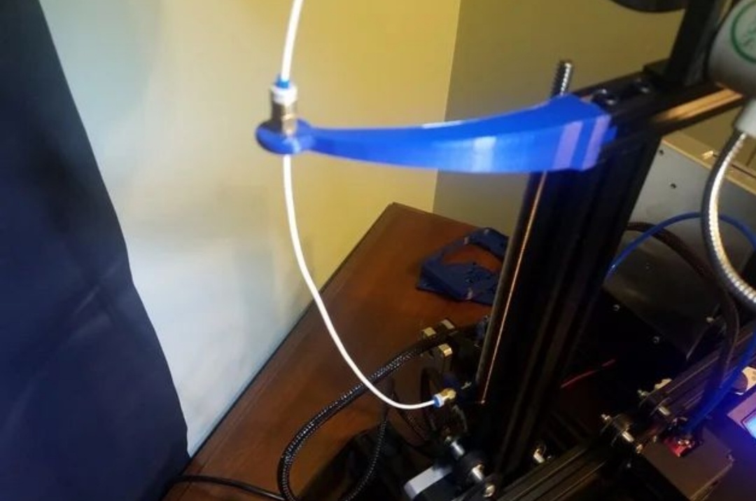

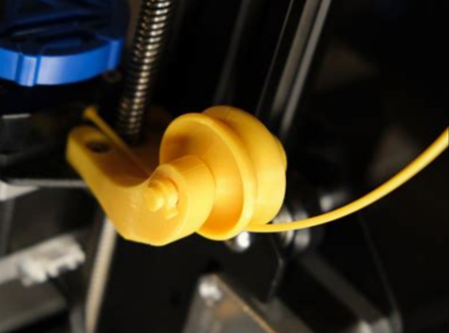

I had my second "non feeding" filament issue and already had my suspicion as to its cause. The filament reel is straight up from the feed motor but the feed motor's intake is horizontal, so 90 degrees to the reel. It already sets off alarms in my head as I expected the reel to feed straight into the motor gears.
I lucked out and was standing there when the incident occurred again. When the gcode (print instructions) tell the printer to load, unload, load, unload the filament, this jittering causes fast intake at the 90 degree intake point and binds. When it binds the load wheel teeth grind away a portion of the filament's edge. When in this jitter mode for too long, it eats away enough of the filament to not be actually touching it any more, no forward or backward movement happens.
Please note: this is NOT the same error as a misaligned feed wheel, worn feed teeth, or weak feed motor.
So, I went online and with the correct issue description found several print spool assist adaptations that others have done to overcome this same issue.
But the print I was wanting to save from failure was already running so I had to improvise. This is a coat hanger and a ribbon roll. Welcome to old school:
At 41 inches, that ribbon roll was one inch away from being the right answer.

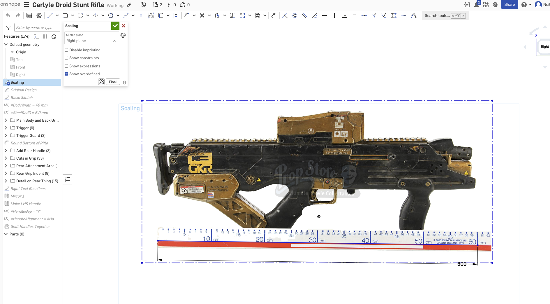

greenmachines prompted me to post. So here I go.
I wanted to cover the basics on how I turn a set of pictures, into a full 3d model.
I'm using OnShape, but this process is going to be the same for 360 (or other parametric CAD apps).
I'm going to post a bunch of pics and try to go from "how to hell do I start" to "hey; I've got my first thing".
Step 1:
Scale. Gotta know how big it is right?
In my case I lucked out. One of the pictures I was using as a reference had a measurement on it.
So, you have to get it into your CAD app, and tell it how wide a measurement is. In OnShape, the first time after you've imported a pic, if you put a line on the sketch and then give it a distance, it scales the image to match.
So that's step one. Getting some kind of reference thing in place.
I should mention this whole process is going to work OK for things that have "planar" geometry. This gun is mostly good. The handles? Those are a whole other ballgame (of pain). Don't bother trying to do them in CAD. It's hard. Painful.
I should have mentioned above: If you pic is not rotated right, square, visible (etc) - then fix all that first BEFORE importing into CAD.
Any "wrong" stuff you import up front stays with you through the entire design process.

I had my second "non feeding" filament issue and already had my suspicion as to its cause. The filament reel is straight up from the feed motor but the feed motor's intake is horizontal, so 90 degrees to the reel. It already sets of alarms in my head as I expected the reel to feed straight into the motor gears.
View attachment 1912683View attachment 1912684View attachment 1912685
View attachment 1912680View attachment 1912682

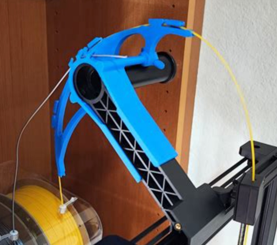

I picked up a stand-alone spool holder from Amazon.
Works well for me, but I understand that a top mounted takes up less space. Myself, I don't like the top mounted ones because the extra weight of the hardware and the roll, can cause slight torsion in the frame which may affect bed levelling, if there isn't angle brackets to stiffen the frame.
