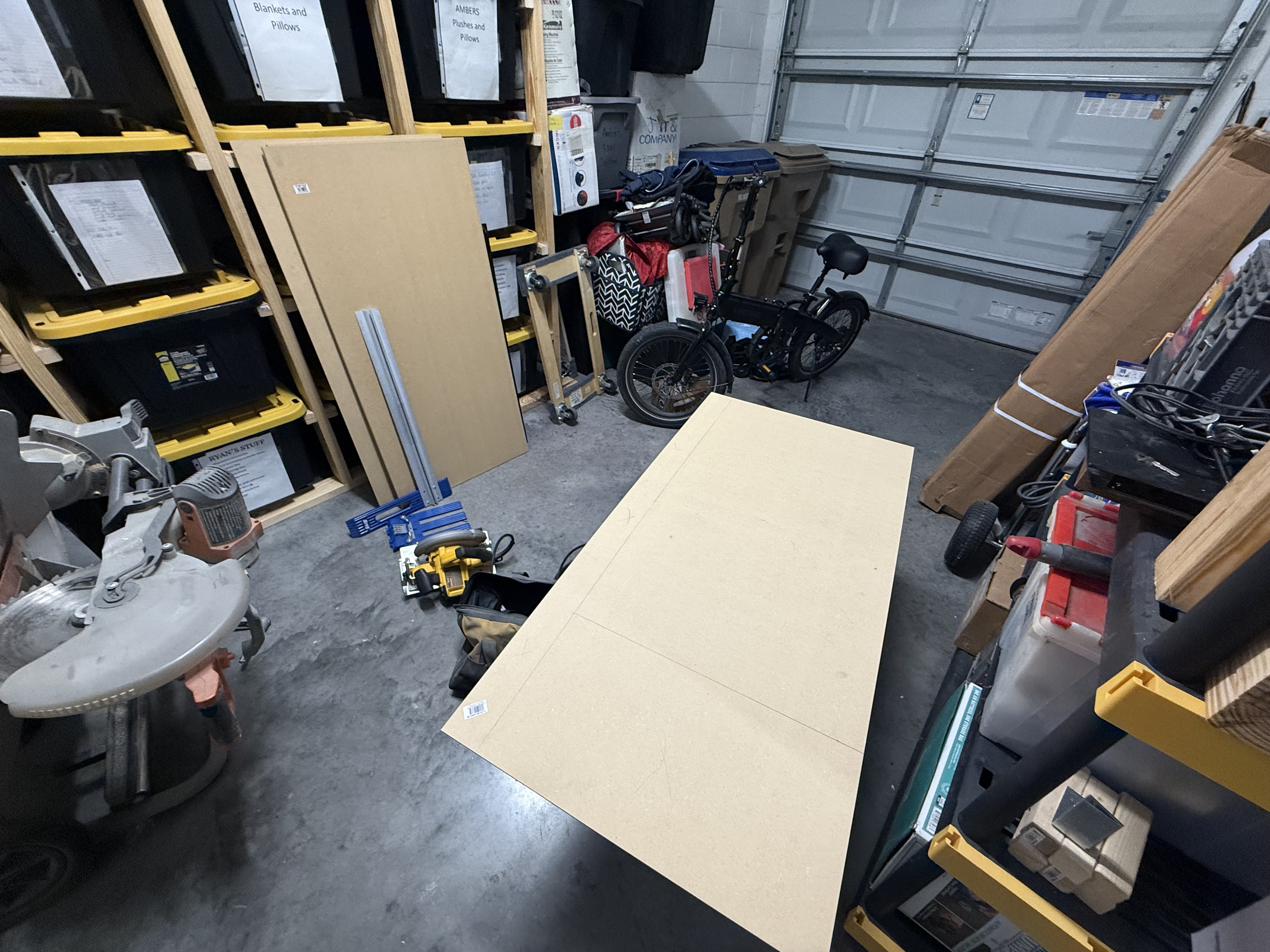

I subscribe to x so I get access to their AI
I uploaded the two parts list images and asked for a shopping list.
Here is what it gave me.
Let's break this down by analyzing the MDF (Medium-Density Fiberboard) requirements for your "Raiders of the Lost Ark" 3D print project, specifically for the base and lid parts as shown in the images. The goal is to create a shopping list for MDF boards that you can purchase from Home Depot or Lowe’s, bring home, and cut to the specified dimensions using a table saw.
### Step 1: Identify MDF Requirements
From the images, the MDF pieces needed are:
#### Base Parts:
- **Short Side Verticals**: 0.75-inch thick MDF, 3.412” x 15.678” (4 required)
- **Short Side Horizontal Top**: 0.75-inch thick MDF, 11.175” x 3.339” (2 required)
- **Long Side Verticals**: 0.75-inch thick MDF, 3.412” x 15.678” (4 required)
- **Long Side Horizontal Top**: 0.75-inch thick MDF, 25.00” x 3.339” (2 required)
#### Lid Parts:
- **Base Panel for Lid**: 0.75-inch thick MDF, 36.75” x 21.135” (2 required)
### Step 2: Standardize MDF Thickness and Check Availability
The project specifies 0.75-inch (3/4-inch) thick MDF for all pieces, which is a standard thickness. Both Home Depot and Lowe’s typically stock 3/4-inch MDF in various sizes, such as 4 ft x 8 ft (48” x 96”) sheets, as well as smaller pre-cut panels like 2 ft x 4 ft (24” x 48”). These stores also often carry project panels in sizes like 2 ft x 2 ft (24” x 24”) or 1 ft x 4 ft (12” x 48”), but availability can vary by location.
Since you’ll be cutting the MDF to size with a table saw, we’ll focus on purchasing the smallest sheets that can accommodate all the required pieces while minimizing waste. Let’s calculate the total area needed and determine the best sheet sizes to buy.
### Step 3: Calculate Total MDF Needed
Let’s list the dimensions and calculate the area for each piece:
- **Short Side Verticals**: 3.412” x 15.678” x 4 pieces
Area per piece = 3.412 x 15.678 = 53.46 sq in
Total for 4 pieces = 53.46 x 4 = 213.84 sq in
- **Short Side Horizontal Top**: 11.175” x 3.339” x 2 pieces
Area per piece = 11.175 x 3.339 = 37.31 sq in
Total for 2 pieces = 37.31 x 2 = 74.62 sq in
- **Long Side Verticals**: 3.412” x 15.678” x 4 pieces
Same dimensions as Short Side Verticals, so total area = 213.84 sq in
- **Long Side Horizontal Top**: 25.00” x 3.339” x 2 pieces
Area per piece = 25.00 x 3.339 = 83.48 sq in
Total for 2 pieces = 83.48 x 2 = 166.96 sq in
- **Base Panel for Lid**: 36.75” x 21.135” x 2 pieces
Area per piece = 36.75 x 21.135 = 776.71 sq in
Total for 2 pieces = 776.71 x 2 = 1553.42 sq in
**Total MDF Area Needed**:
213.84 + 74.62 + 213.84 + 166.96 + 1553.42 = 2222.68 sq in
Convert to square feet (since MDF is typically sold in sq ft):
1 sq ft = 144 sq in
2222.68 sq in ÷ 144 = 15.44 sq ft
### Step 4: Determine MDF Sheet Sizes to Purchase
Now, let’s match this to available MDF sheet sizes at Home Depot or Lowe’s, considering both area and dimensions to ensure the pieces fit.
#### Option 1: Use 4 ft x 8 ft Sheets (48” x 96”)
- **Area of one 4 ft x 8 ft sheet**: 48 x 96 = 4608 sq in (or 32 sq ft)
- **Number of sheets needed for area**: 2222.68 sq in ÷ 4608 sq in/sheet = 0.48 sheets (so 1 sheet is more than enough for the total area).
However, we need to ensure the largest pieces—the Base Panels for the Lid (36.75” x 21.135”)—fit on the sheet with room for cutting:
- A 48” x 96” sheet can easily accommodate two 36.75” x 21.135” pieces side by side (e.g., 36.75” x 21.135” fits within 48” x 96”, and you can fit both pieces along the 96” length: 21.135” x 2 = 42.27”, which fits within 48”).
- The remaining pieces (all smaller than 25” x 15.678”) can be cut from the leftover space.
**Conclusion**: One 4 ft x 8 ft sheet is sufficient for all pieces.
#### Option 2: Use Smaller Pre-Cut Panels
If you prefer smaller sheets for easier handling, let’s consider 2 ft x 4 ft (24” x 48”) sheets:
- **Area of one 2 ft x 4 ft sheet**: 24 x 48 = 1152 sq in (8 sq ft)
- **Number of sheets needed for area**: 2222.68 sq in ÷ 1152 sq in/sheet = 1.93 sheets (so 2 sheets cover the area).
However, the Base Panel for the Lid (36.75” x 21.135”) won’t fit on a 24” x 48” sheet because 36.75” exceeds the 24” width. You’d need to cut this piece from a larger sheet or join smaller pieces, which adds complexity.
### Step 5: Create the Shopping List
Given that a single 4 ft x 8 ft sheet provides enough material and accommodates all piece sizes, that’s the most practical option. Both Home Depot and Lowe’s typically stock 3/4-inch MDF in this size. For example:
- **Home Depot**: Often carries a 3/4 in. x 4 ft. x 8 ft. MDF Panel (e.g., Columbia Forest Products 3/4 in. x 4 ft. x 8 ft. MDF).
- **Lowe’s**: Often carries a similar product, like a 3/4 in. x 4 ft. x 8 ft. MDF Panel (e.g., from brands like Georgia-Pacific).
#### Final Shopping List:
- **3/4-inch MDF, 4 ft x 8 ft sheet**: 1 sheet
- Available at Home Depot or Lowe’s for approximately $30–$40 (prices may vary by location and date; as of May 2025, this is a reasonable estimate based on historical pricing trends).
### Step 6: Cutting Plan (For Your Reference)
Once you have the 4 ft x 8 ft sheet, you can cut the pieces as follows:
1. **Cut the Base Panels for the Lid First**:
- Cut two pieces at 36.75” x 21.135” from one end of the sheet.
- This leaves a remaining area of approximately 48” x (96” - 36.75”) = 48” x 59.25”.
2. **Cut the Remaining Pieces**:
- From the remaining 48” x 59.25” section, cut the Long Side Horizontal Tops (25.00” x 3.339” x 2), Short Side Verticals (3.412” x 15.678” x 4), Long Side Verticals (3.412” x 15.678” x 4), and Short Side Horizontal Tops (11.175” x 3.339” x 2).
- These pieces are small enough to fit within the remaining space with careful layout to minimize waste.
### Notes:
- **Double-check dimensions** before cutting to account for the saw kerf (the material removed by the saw blade, typically 1/8 inch per cut).
- **Availability**: While 4 ft x 8 ft MDF sheets are standard, check your local Home Depot or Lowe’s for stock. If they only have smaller sizes, you may need to adjust your plan (e.g., buy two 2 ft x 4 ft sheets for the smaller pieces and a larger sheet for the Base Panels).
- **Safety**: Use proper safety equipment (goggles, mask, etc.) when cutting MDF, as it produces fine dust.
Let me know if you’d like help with a more detailed cutting layout or if you need to explore other sheet size options!

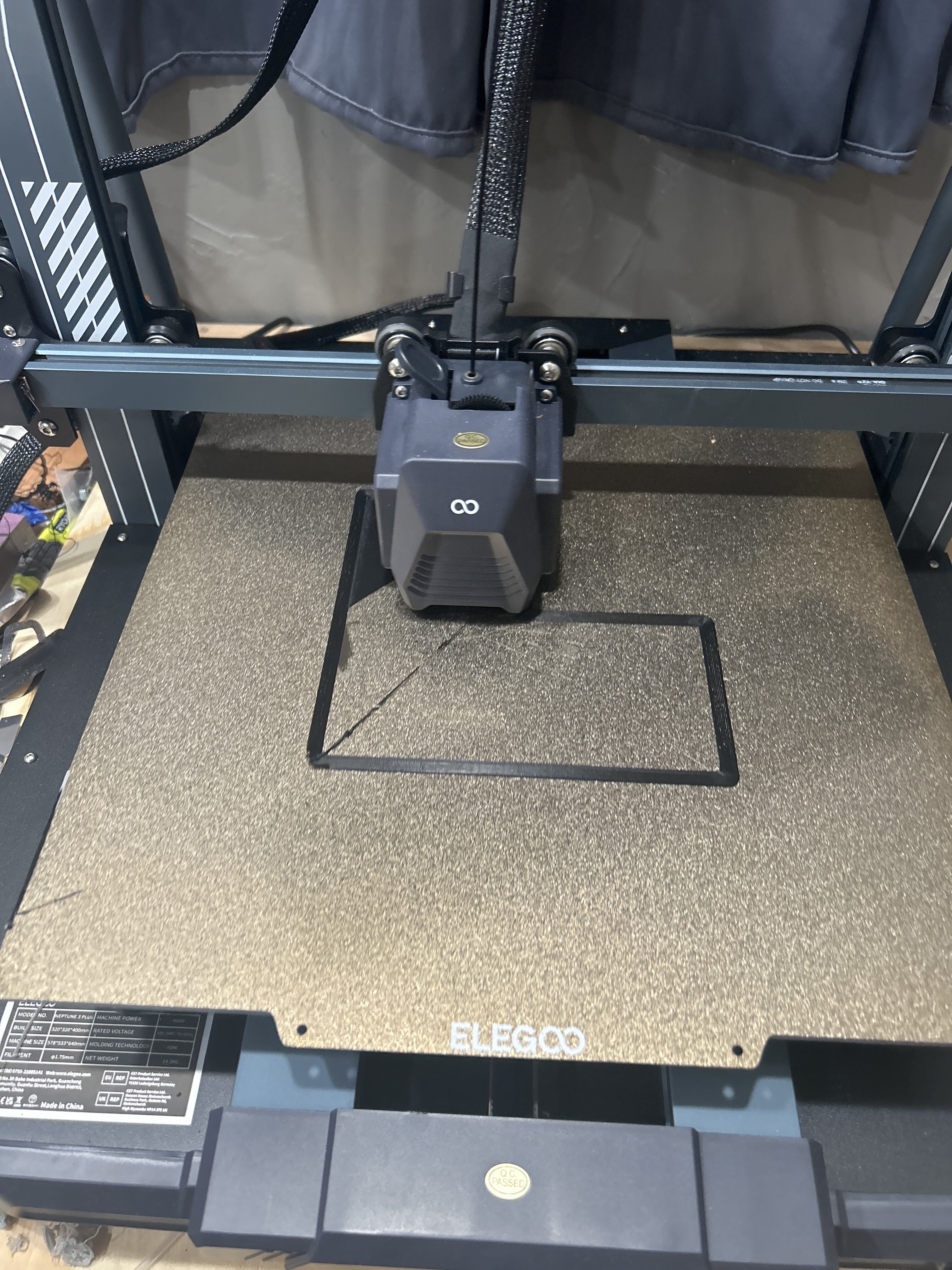

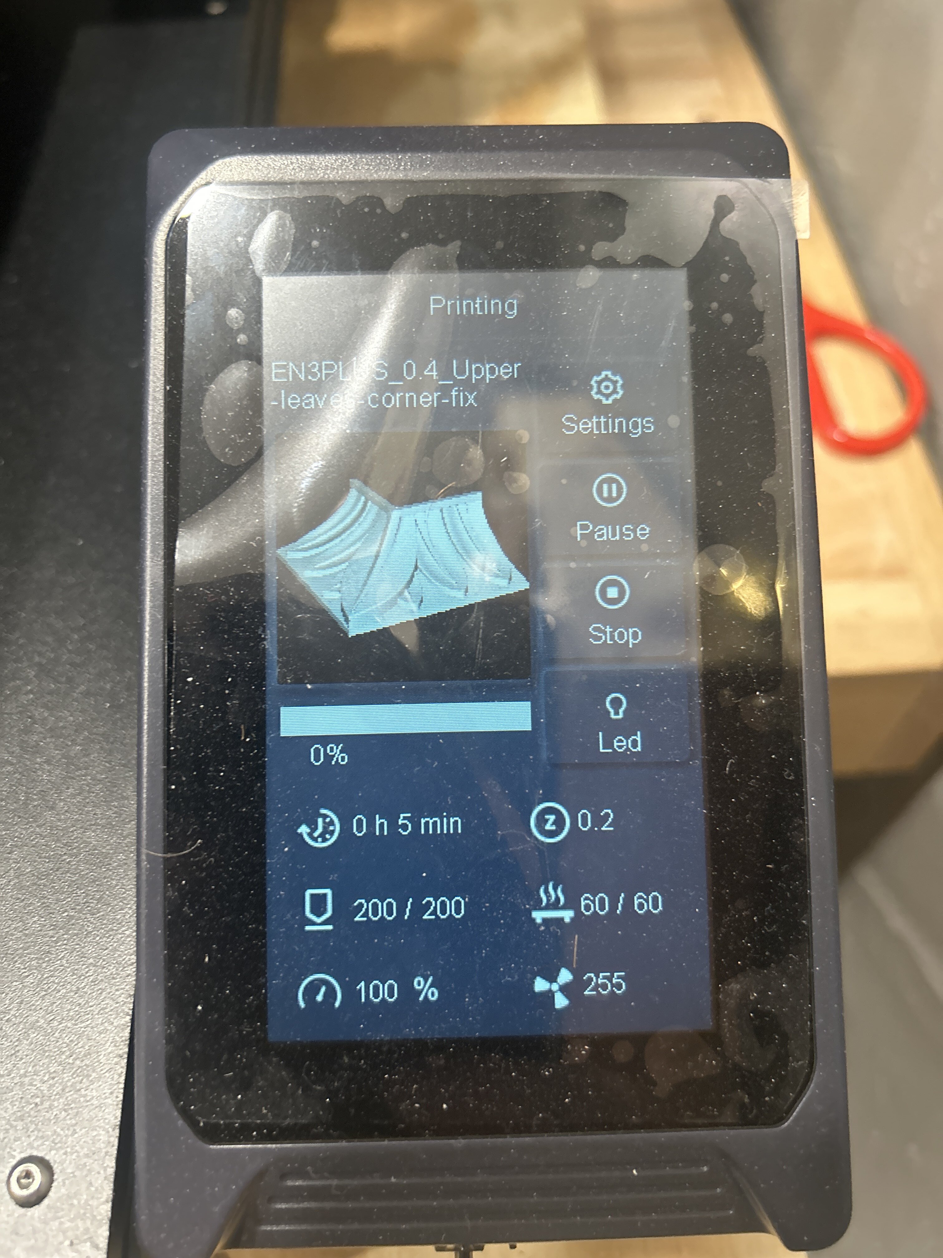

Here we go with the first print. No time tables, no rush. Plan is to print everything and then will probably sit in kit form until I can clear out my back room that’s my workshop to make additional display area. I’ve had these files for as long as they’ve been posted but you bad influences made me start :lol:
Here we go with the first print. No time tables, no rush. Plan is to print everything and then will probably sit in kit form until I can clear out my back room that’s my workshop to make additional display area. I’ve had these files for as long as they’ve been posted but you bad influences made me start :lol: View attachment 1935440View attachment 1935441
have fun.

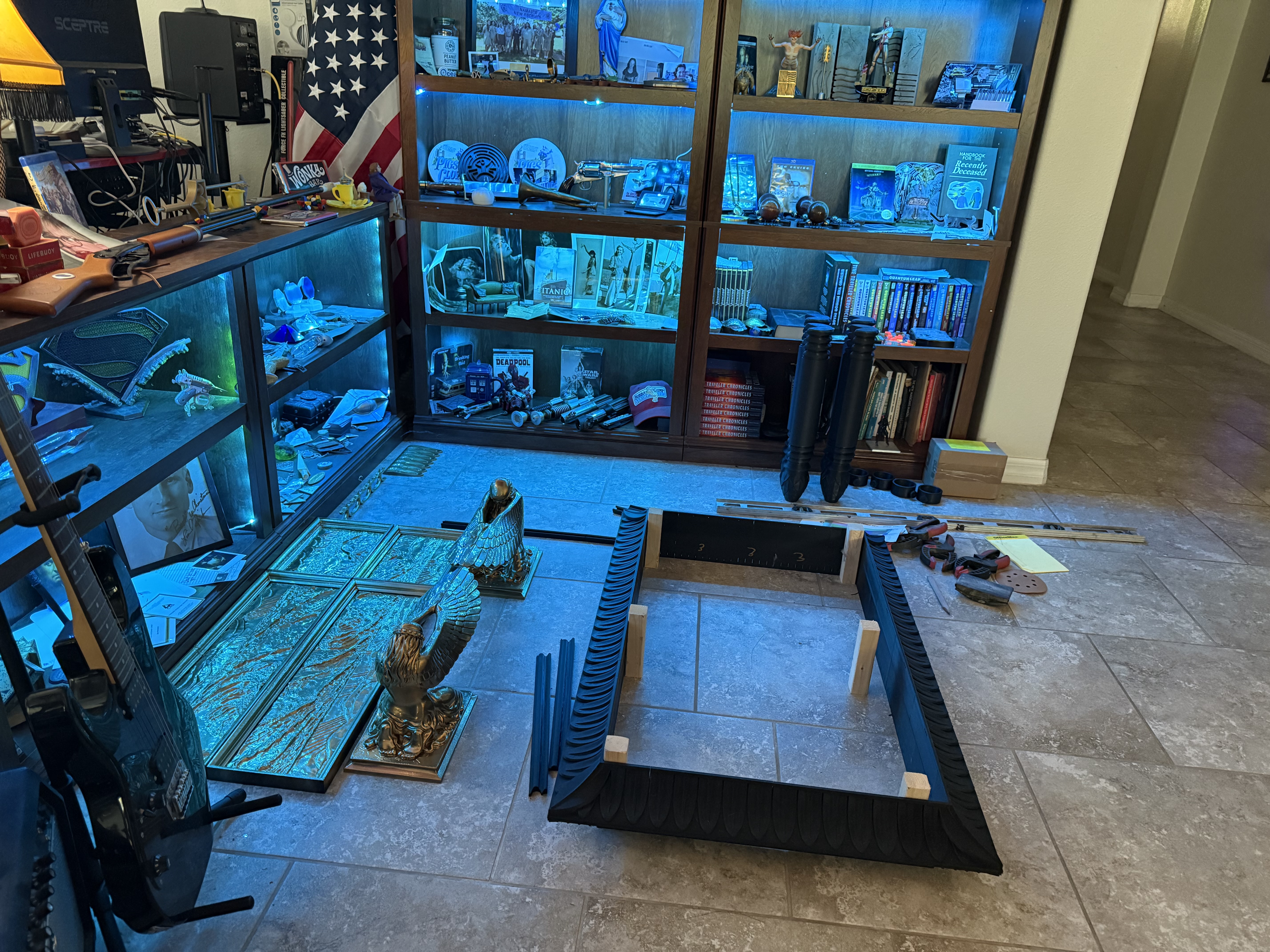

Do it to it! Lol we just started building.
