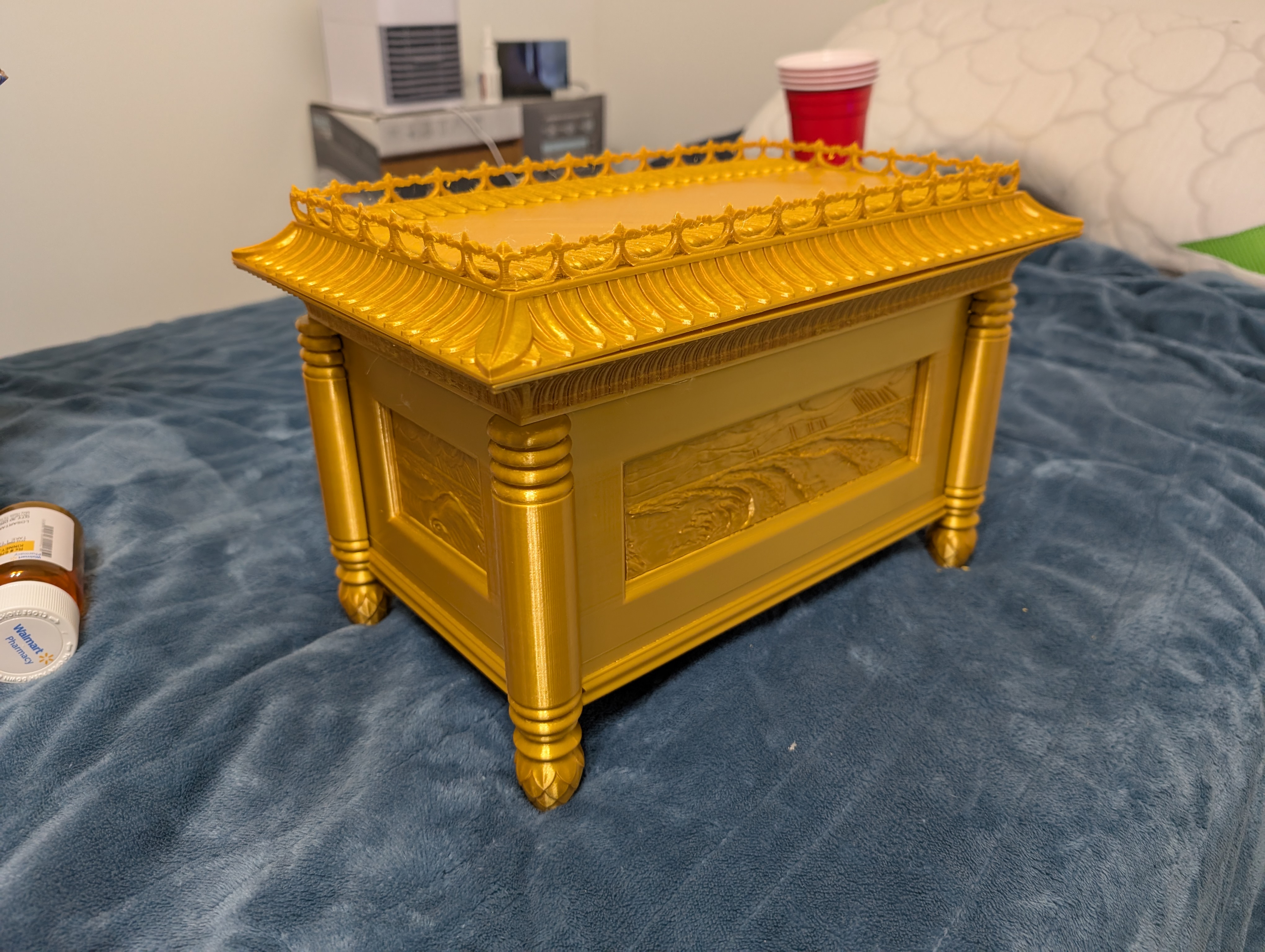

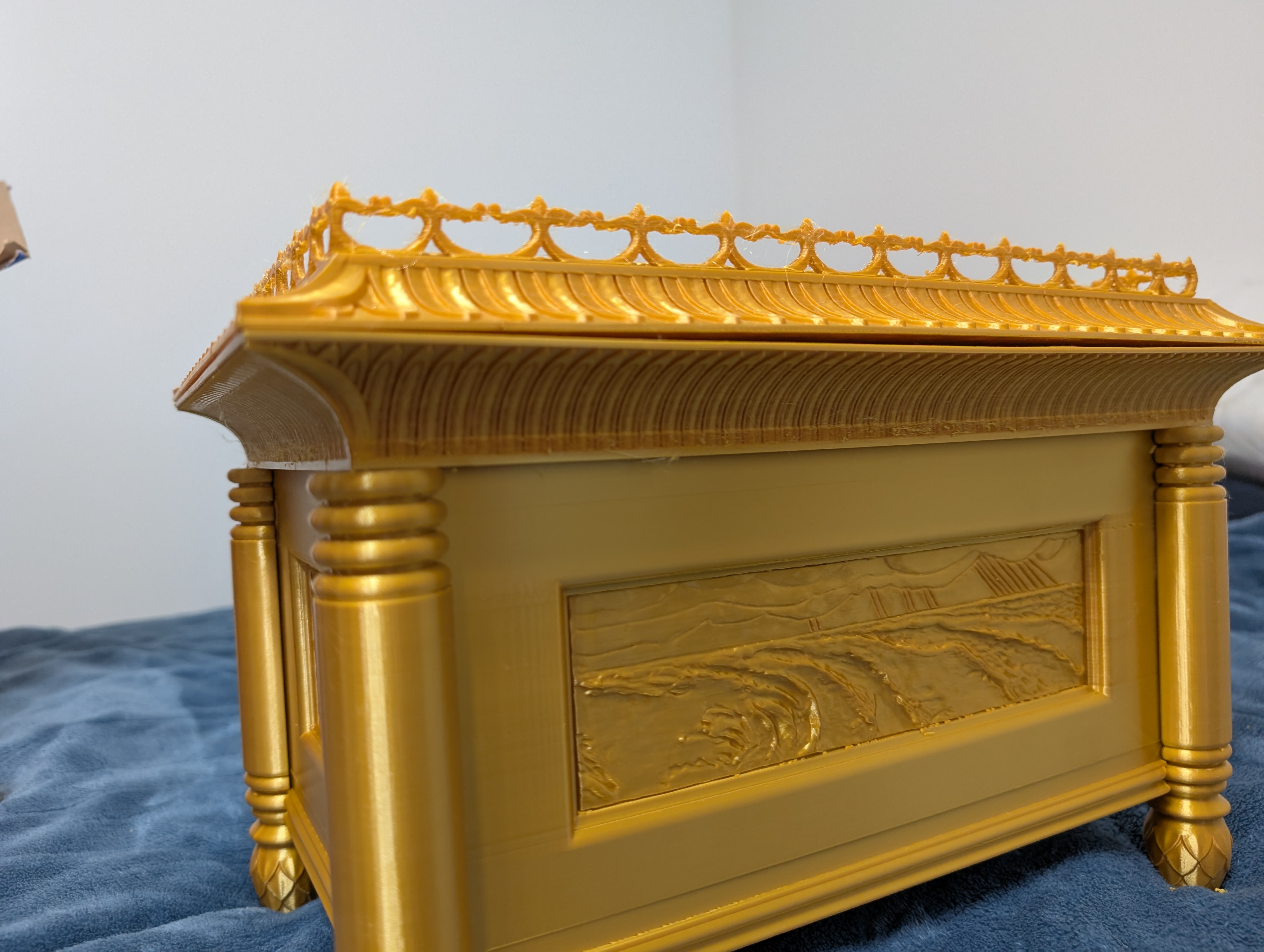

Im just using gold spray paint as the final step. Not the varnish and food colollring. That white gloss and silver metallic paint makes the rust oleum metallic gold really pop.I did this with my idol same exact way. I don't think it will be a good idea with such a large area. It was hard enough to blend a small piece
If you're feeling adventurous-try a nice shinny yellow in place of the white and tell me what you think after-Im just using gold spray paint as the final step. Not the varnish and food colollring. That white gloss and silver metallic paint makes the rust oleum metallic gold really pop.
Interesting. I have been thinking about doing some more paint testing.If you're feeling adventurous-try a nice shinny yellow in place of the white and tell me what you think after-- I picked that trick up from a train specialist
yellow makes the chrome-silver or aluminum popInteresting. I have been thinking about doing some more paint testing.
So primers,yellow makes the chrome-silver or aluminum pop
Im working on a yellow base coat and a triple glaze coat over white right now. We shall see.If you're feeling adventurous-try a nice shinny yellow in place of the white and tell me what you think after-- I picked that trick up from a train specialist

Thanks. Im pretty happy with it so far. Although 4 layers takes forever. Lol.Wow, that gold looks fantastic!!!
I didn't notice a difference in using yellow. So I went with the original plan. Grey primer. White gloss coat. Metallic silver coat. Gold metallic coat. All rust oleum.Can I ask how you did it, and what you used?
