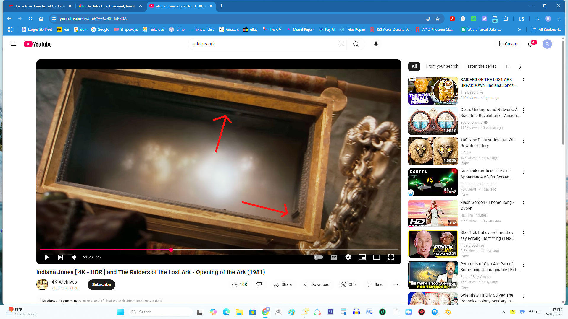

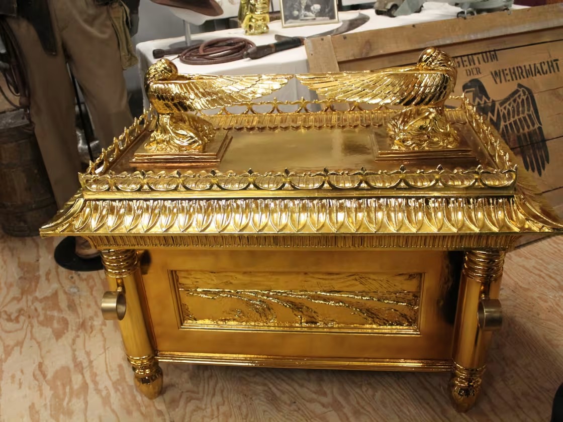

Yes, intended is you make the INSIDE of the chest smooth. Here's a pic of a commercially available 1/6 scale ark.
You can see the frame of the insert sticks out.
Are you sure? here are the screen used props The Ark of the Covenant, found at last! A peek at famous props from Indiana Jones' movies
