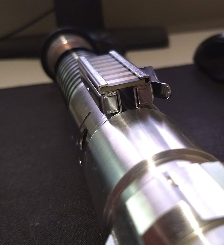

Last question (I think), can I close the clamp tighter than what's shown? It doesn't seem like I can, but the card slides freely, so it seems like I should be able to tighten it further, but no matter how I twist, it doesn't tighten.
I got the card from slothfurnace, perhaps there's a slightly wider version that I should've purchased?
On all my graflex clamps I oval the square hole in the clamp box. Which allows me to”dial in” the tolerance
But even with that many after market clamps have little differences
Sloths cards are the top of the line and the only cards I use or recommend
But to fix this issue I “pad” the back of the card with 2 layers of scotch tape.
It gives the card just a tad bit more thickness and the clamp holds it in place
You never over tighten a graflex lever it will either pop the locking block out of the clamp box or break the lever pin..
The scotch tape has always worked amazing for me

Okay, I think I've almost got it.
For a situation like this, I'd cut an o-ring, to make a round rubber strip, and place it in one, or both, grooves to take up the slack as well as provide a cushioned grip. Most o-rings are black, but silicone ones are typically orange, which might add visual interest as well. Leave the rubber long and trim it flush after it's all together, or, cut it short so it's completely hidden.
PS Rubber cord can be purchased on a spool as well, but I think a bag of o-rings will be less expensive.

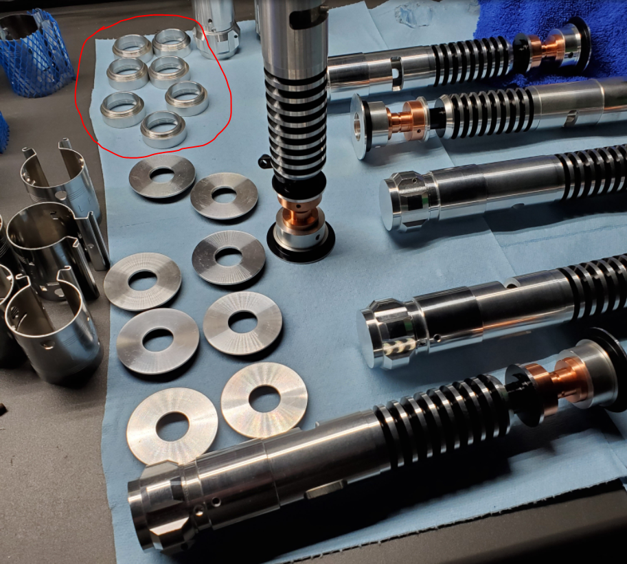

Got one of these spacers in the package, but I'm not sure what is it for?
