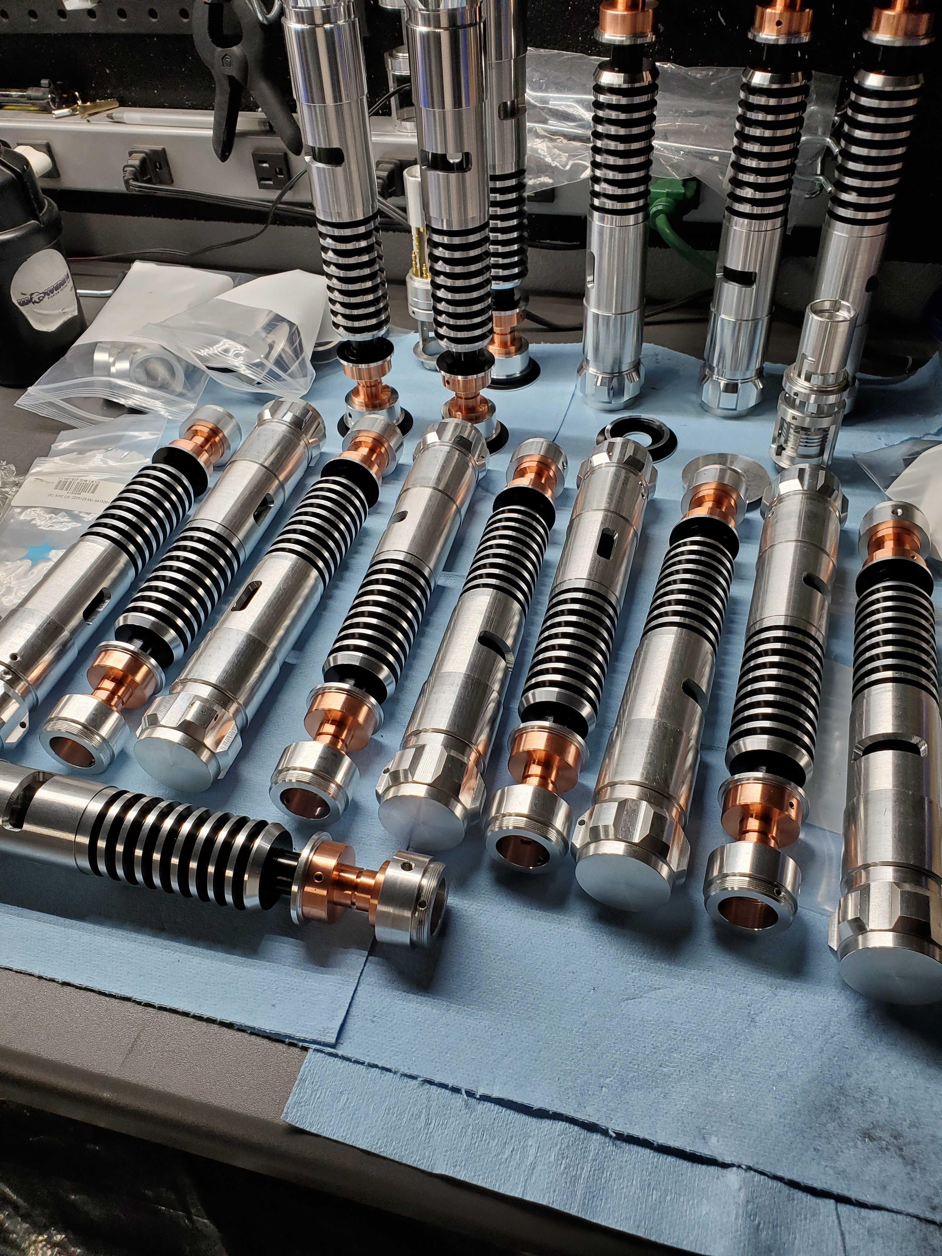

Still working through,. Sending another batch out today. All the should be shipped by Monday, unless your ordered a crystal chamber ! :) Thanks everyone
Mine came in the other day, it's beautiful. I haven't decided quite what I'm going to do with it, but I'm really happy to have been in on this run!

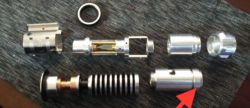

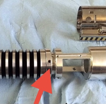

I'm having a bit of an issue putting mine back together. The chamber doesn't close flush. Looking at the picture I posted earlier, I think I may have lost a part somewhere along the line.

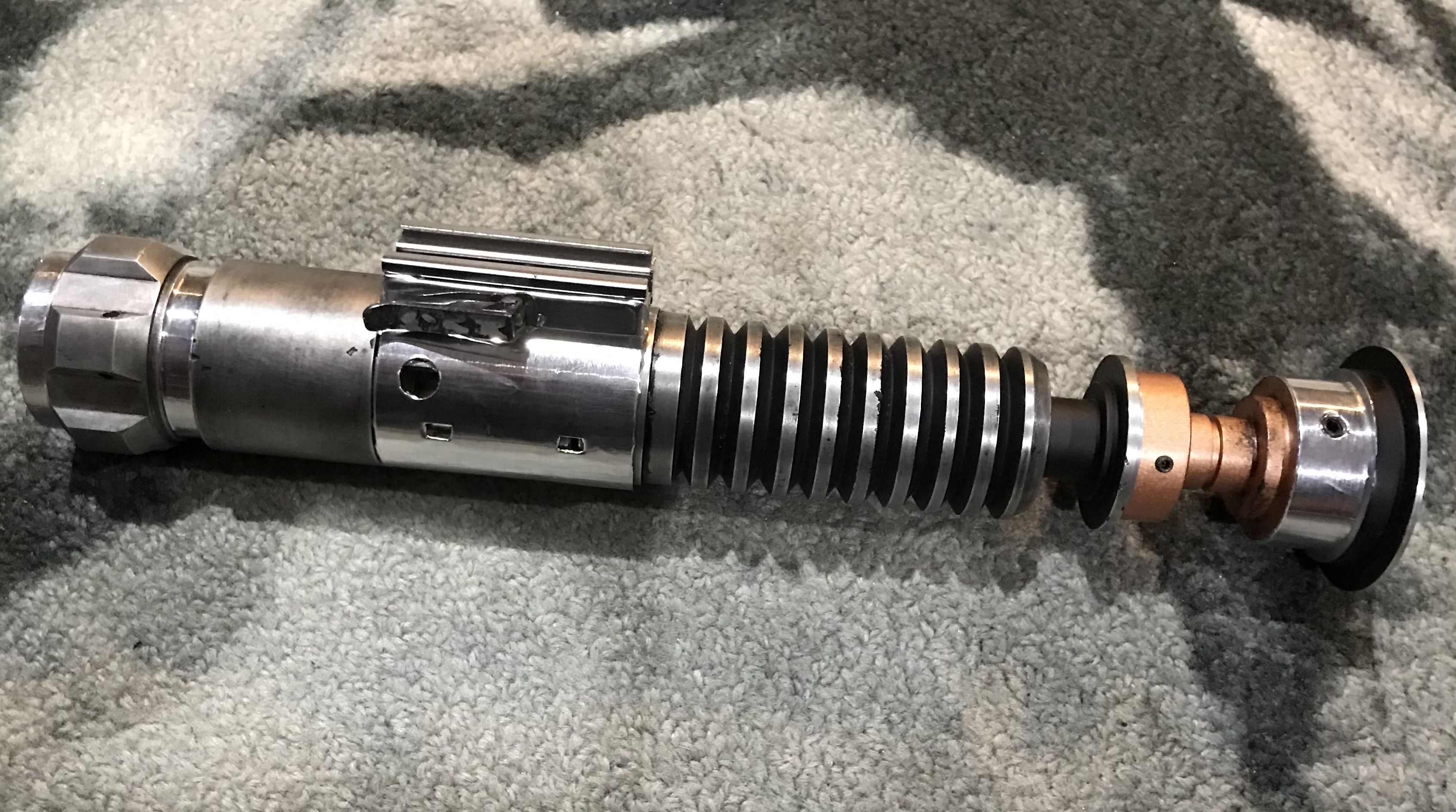

Here you can see I've screwed the chamber in as far as I can, but along the L-channel on the inside, it won't fit all the way. I think I'm missing a sleeve that screws in between the ringed section and the chamber.

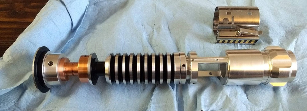

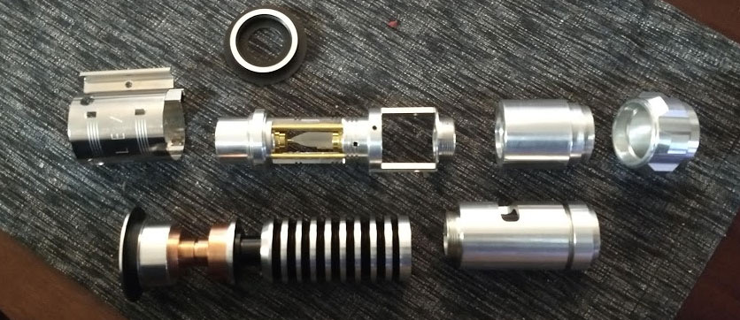

Here are the parts I have in hand right now
I'm thinking I may have lost a part somewhere, sometime over the past few days, as I played with it, waiting for my clamp card and D-ring to arrive. Can someone advise what I'm looking for?
With the shorter spacer the chamber is bottoming out up inside the ring section
The taller spacer gives it just enough room
Just to confirm the spacer I need isn't in the photo I posted above?
I must've lost it someplace ... my apartment isn't that big, it must not have gone far :D
Thin spacer is on it now, looks like the tall spacer is here

Awesome, thank you much. The 'thick' spacer was stuck on that end, so I thought it was machined all as one piece. But I was able to twist it free.

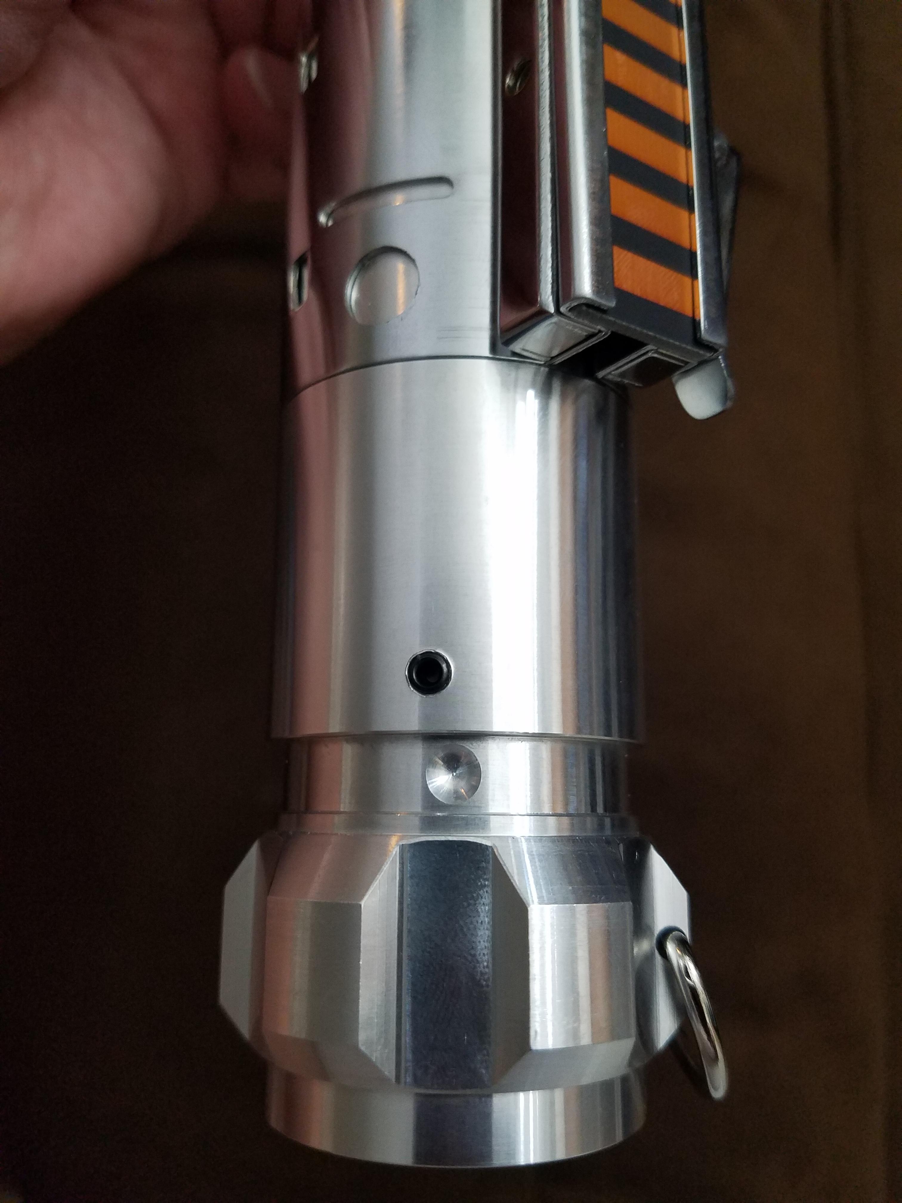

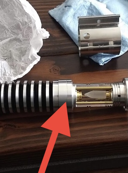

Last question, now that I've got the assembly sorted, when I put the clamp on over the chamber, is there a 'correct' orientation? It seems like the clamp can line up with the holes in the chamber like the pic here, is this right?
Last question, now that I've got the assembly sorted, when I put the clamp on over the chamber, is there a 'correct' orientation? It seems like the clamp can line up with the holes in the chamber like the pic here, is this right?View attachment 1425649
Holes closer to the pommel.. I have a video coming out the second I get my
D ring from Roy
The correct position is in between the 2 holes and the Dring
But you will need to file down the tabs of the graflex clamp so it can rotate freely i posted the info earlier in the thread, Plus the gralfex clamp has been moved, it needs to be upside down., :)
