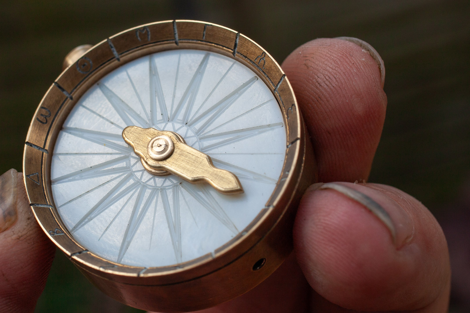

A little surprised how simple the mechanism is, prototype works well and should be possible to do in bronze. Parts need to be milled from both sides, maybe some detail turned and then drilled, which just adds quite some more human interaction than 3D printing.

So a first test milling mother of pearl (not veneer) was successful. Quite a robust material. Now it’s time to add detail and then get the compass rose darkend.
Also quite happy with aging the sterling silver ring and beads. Now I just need to do it for several hundred (basically having some dozens between two sandpaper sheets, then aging fluid and sandpaper again).
Another work in progress shot, now the new body and mechanism keys in metal (prototype is brass, final will be bronze).

More experiments with mother of pearl (rather history accurate) and acrylic MOP (more screen accurate and looks like they might have used it for the original prop) are underway. Anyway, the rose will end up as an inlay, not all done in one piece as initially planned.
So the first batch of chains is ready, now "screen accurate" with 13 oval and 14 "sinker" beads each.
Compass body tooling and brass prototyping will be done over the weekend and then the bronze part production will commence. Still testing different mothers of pearl, but I am confident shipping will start (early) November.

Metal processing nearly done. Took a little longer as projected, but no surprise with the work needed for the mechanism and being done by hobbyists.
Mother of pearl next, expecting prototype in the coming two weeks with payment due in the case of success - and shipping shortly after.

Milling, turning and engraving the bodies took a few weekends and the guy who finished it also has some other life with family and full time job. I am still determined to get the final product in your hands before the holidays.
For those with some interest in the work done, here is (a quite technical) video of the last step:
