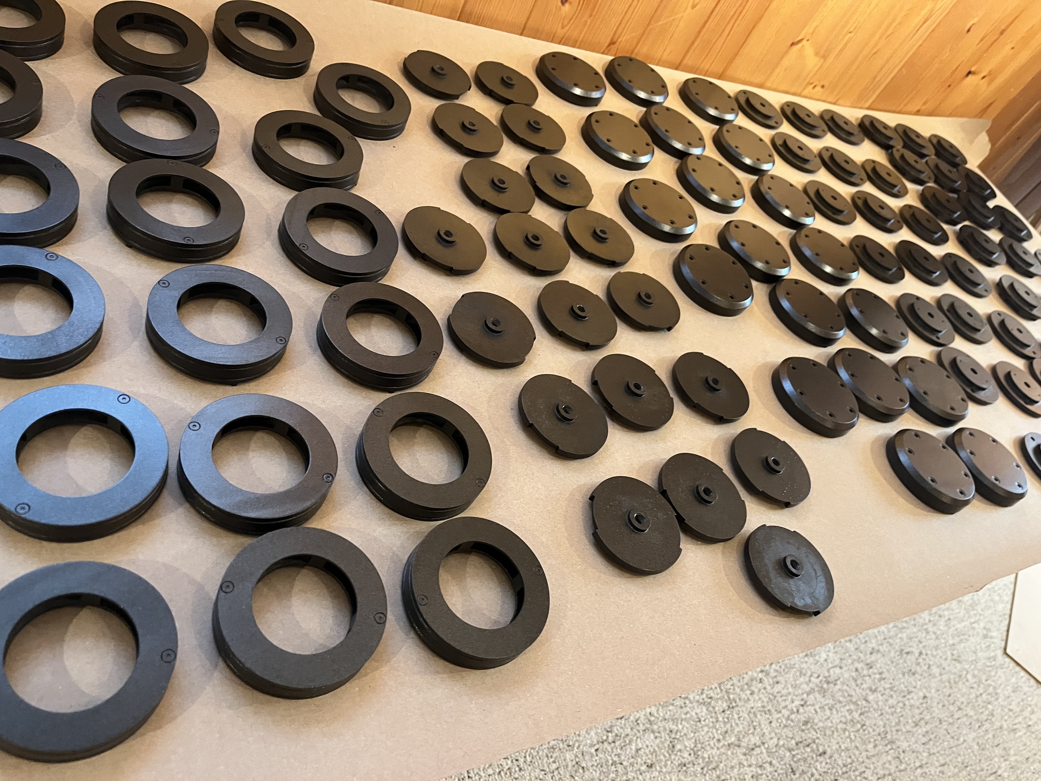

Hey friends, I've had a couple ask if this project is moving forward despite not hitting 20 people. IT TOTALLY IS... I'm making 20 of these no matter what. I'm been printing and building components for the last two weeks. Mostly done with printing. I'm hoping to move into paint next week. Hoping to ship these in 4-5 weeks, but maybe less.

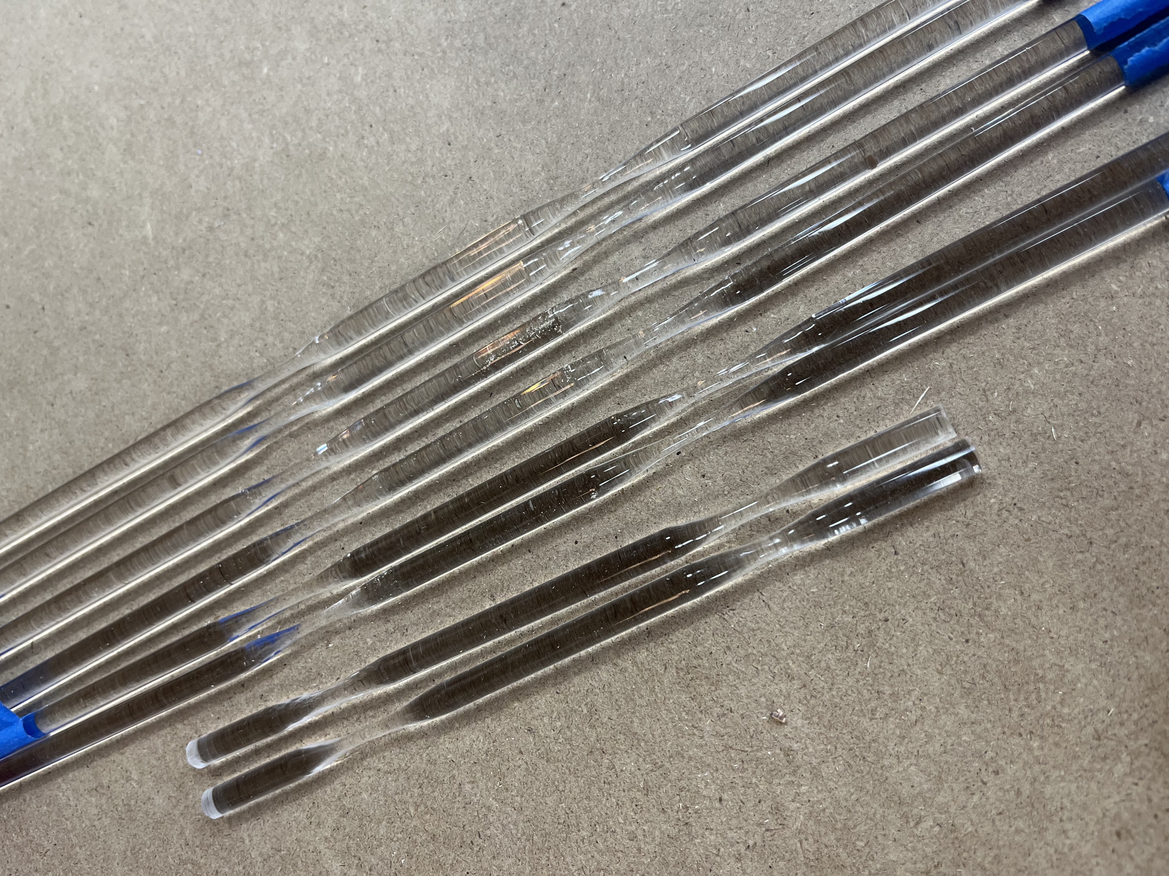

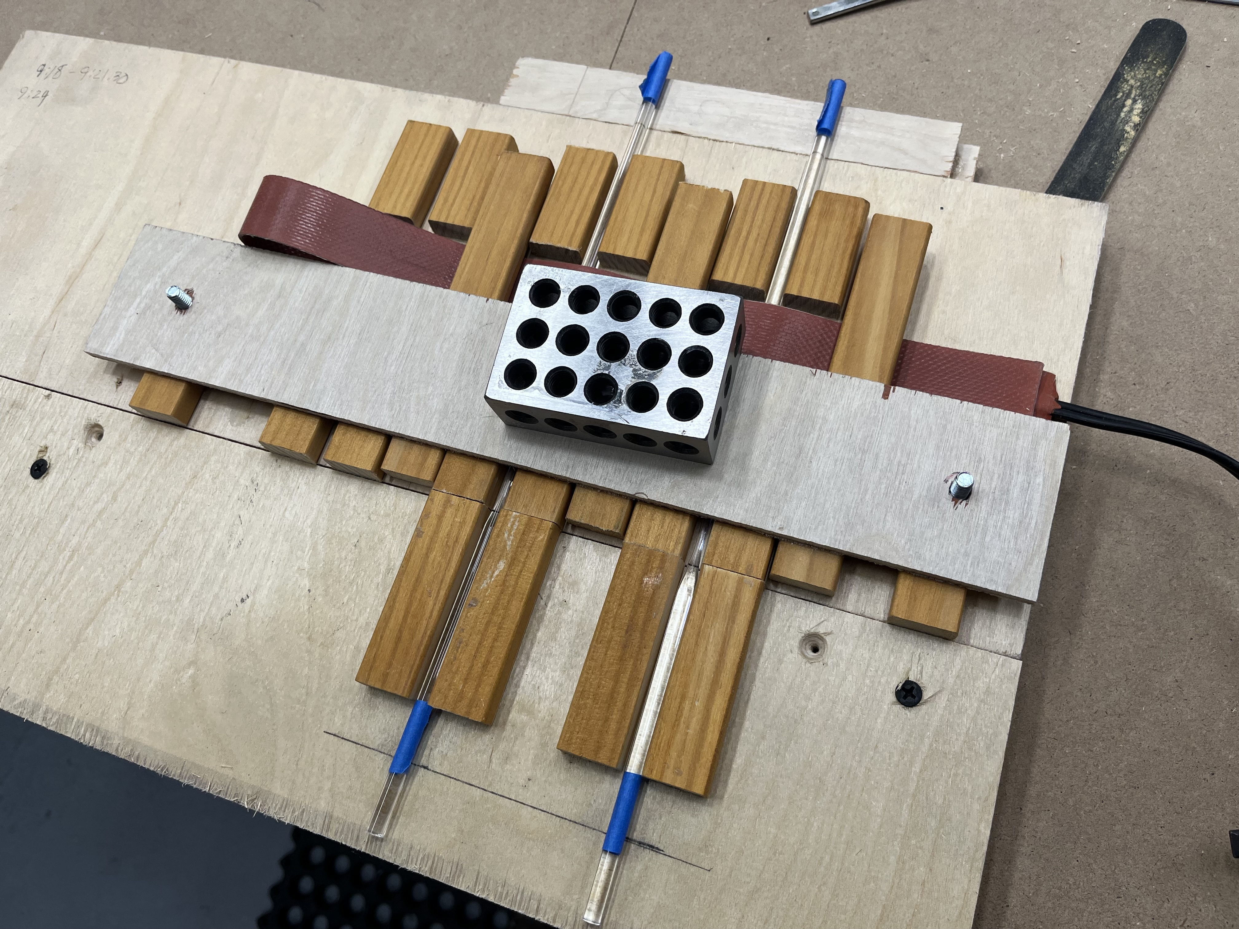

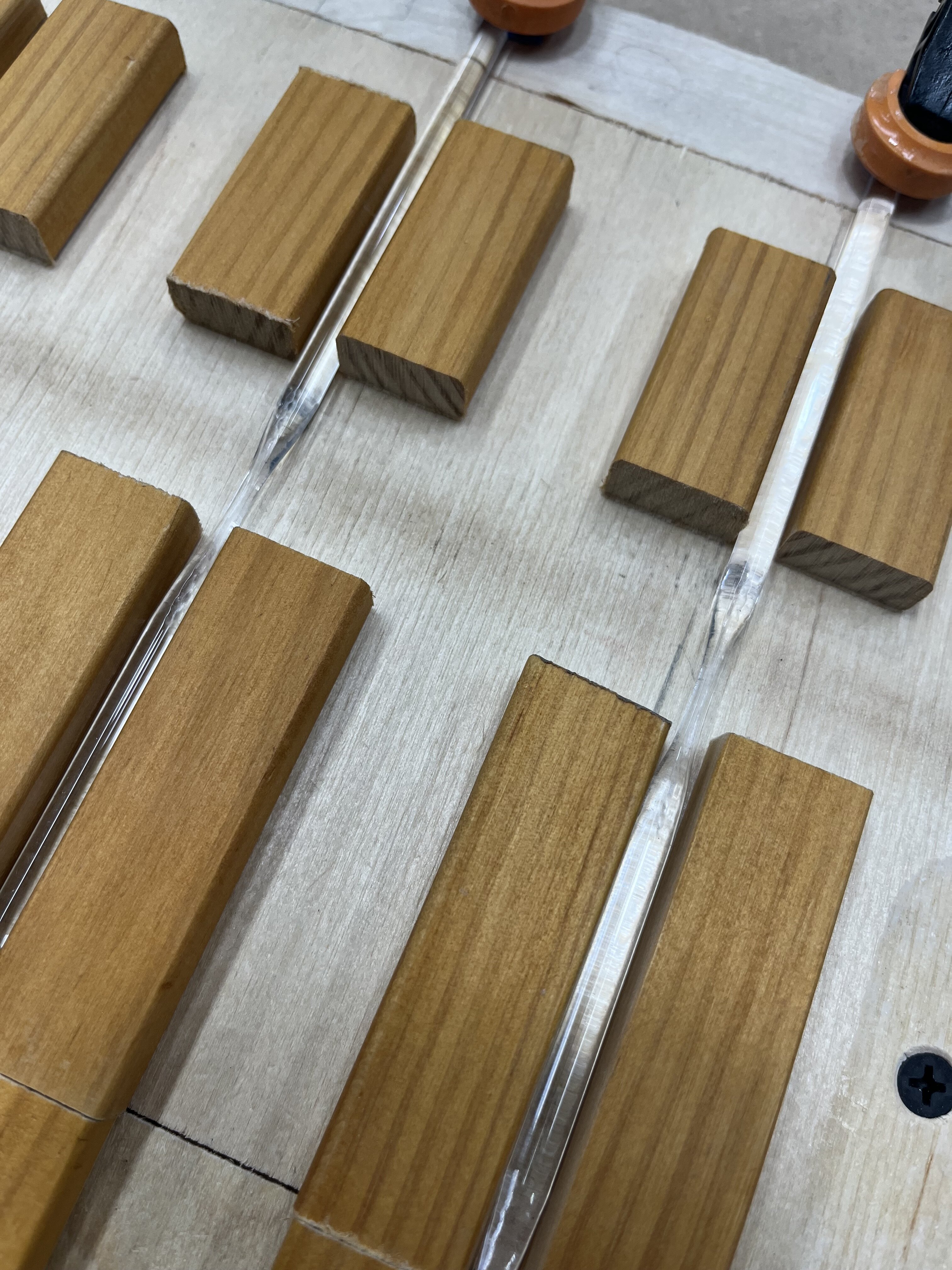

It's been a busy paint week. Also, I created a jig and process for creating those cool little narrow spots in the acrylic rods. I think they are called tamper rods. ... I thought about trying to sand them into a rod, maybe using a drill. That sounded like a pain. So I tried using my acrylic strip heater, wrapping it arounf the rod. In a couple minutes I was able to pull the rid like taffy creating exactly the right look. Then it was building a jig so I can replicate exactly the same effect 40 time!

Melting and stretching the acrylic looks dead-on to MI:3. I wonder what the real tamper rods are made of?

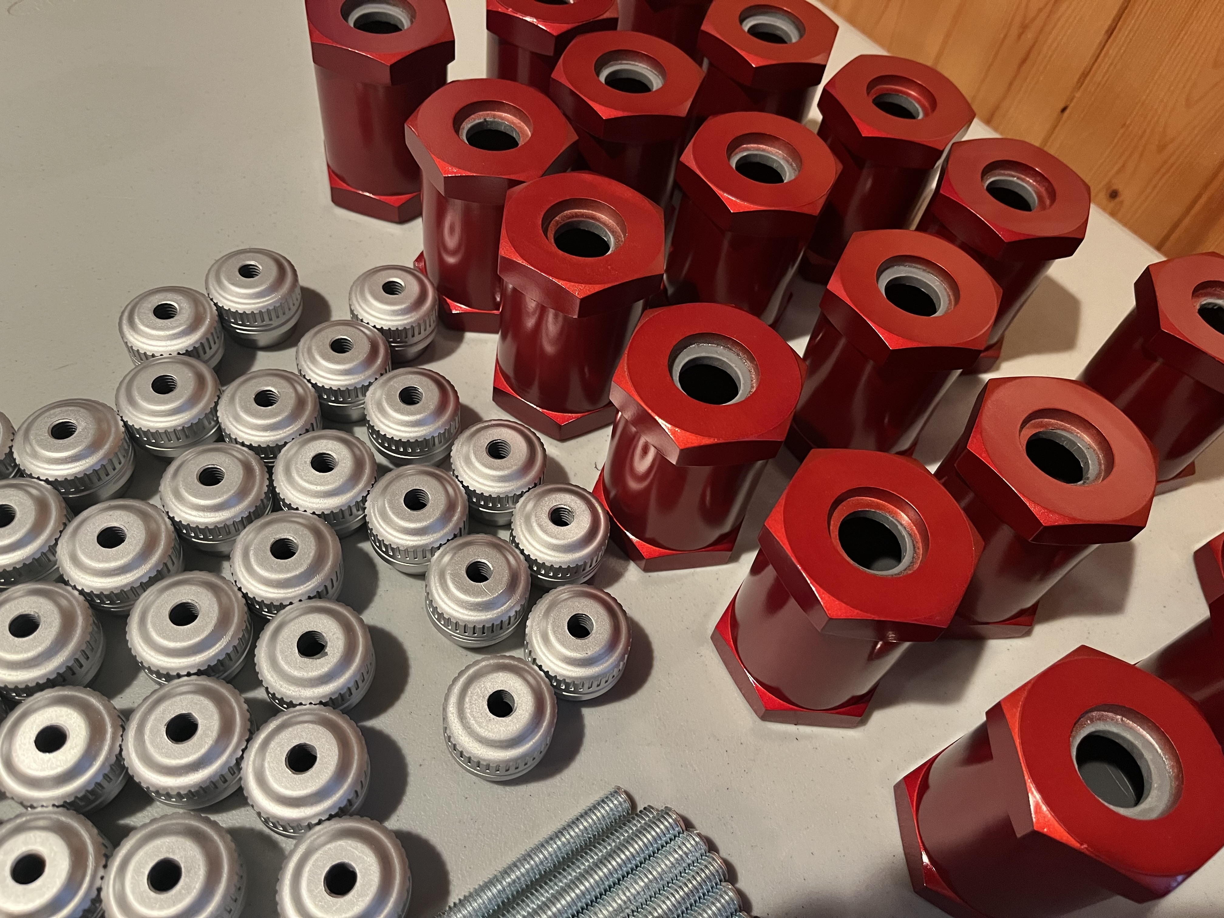

Out of curiosity and not a critique: The chrome paint on the screw caps on either side of the red canister seem a bit diffuse, and less metallic than the original. Is that a difference of like vacuum chrome plating on plastic versus a paint application?
I’m curious how one could achieve a more chrome-like appearance as a side project at home
It’s all looking gorgeous in any case. That red color is :chefkiss:
Real tamper rods are made from glass. They’re meant to be a fragile element that would break to show that someone has tried to enter the device.
