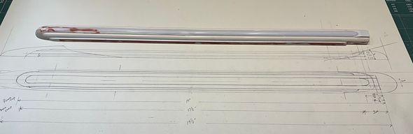

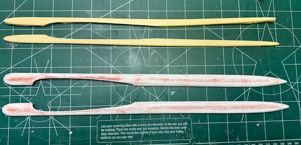

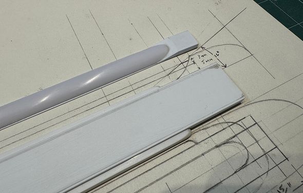

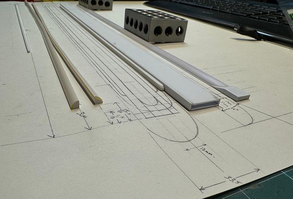

Scratch building the components to the top details of the Warp Nacelles. There are six sections to make the shape of this assembly. A section was cut out of a 1/2" styrene tube that I saved from a yard sign, then cemented to a strip for styrene to keep its shape. Here the aft tip has been ground away before applying Epoxy dough to fill it in and shape it to a taper.
IMG_1195

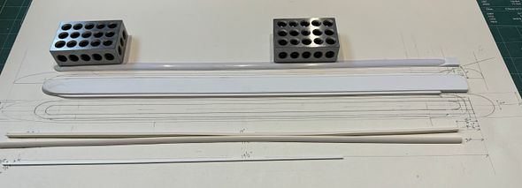

The base is made into a box. 1-2-3 blocks are being used to keep this assembly flat, and square as the cement cures.
IMG_1197
Two of the six sections are complete. The other four will have to wait until a special-order of styrene shapes arrive.
The Nacelle cowl masters shown at the top are not included in that count.
IMG_1209

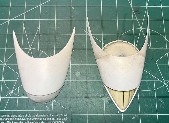

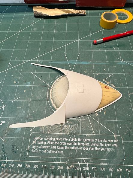

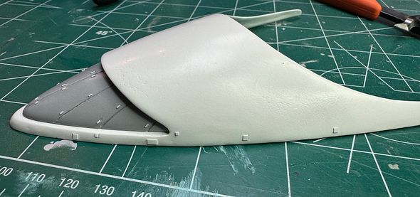

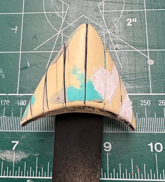

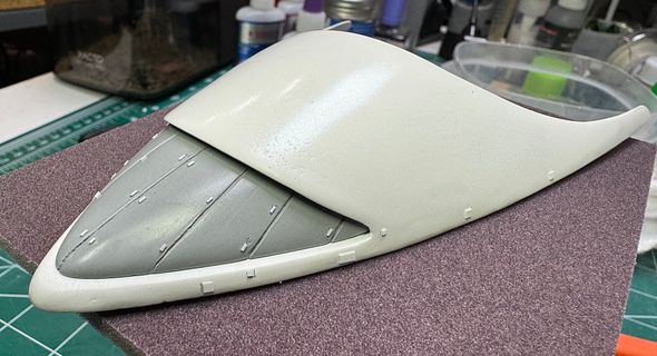

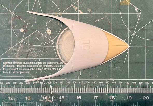

While I wait for those styrene products, I moved over to the Main Shuttle cowl. The vacuum formed part from the Collective version of the kit had more to work with than the Lunar kit cowl. It actually didn't come out of the sheet half bad, but still have some significant detail and shape issues. The resin hanger bay doors are from the LM kit. Note their current shape here. I will have to modify them to get things to pull together correctly.
IMG_1202
First off, the doors are elevated on a thin platform. They do not set directly onto the top surface of the secondary hull. Second, material needed to be removed so the Observation Dome slips under the cowling to the proper depth.
IMG_1205
... as seen here.
IMG_1206

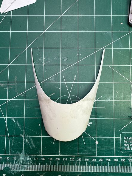

The cowling is decent but still needs work. The pencil lines depict where material will be removed so a more correct shape can be added back on - Note the paper template. The two squares on the top have already been backfilled on the inside surface with sculpting dough and has since been sanded out smooth.

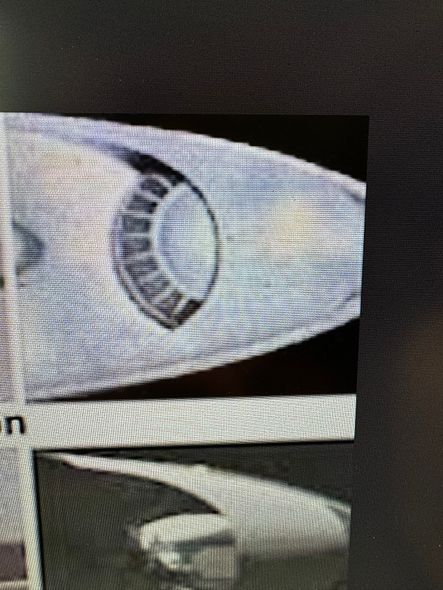

Reference on the NX Dome. Note that the center of the dome is covered by the cowling, and only eight vertical window stanchions are exposed outside the shadow of the cowling.

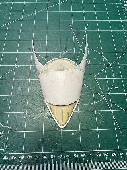

I think I removed just enough material from the bay door parts to get it to look right. To give the thin vacuum formed cowling some strength, I applied a thin layer of epoxy dough to the inner surface to give it strength and hold its shape - as well as allow me to sand out that pair of nasty raised panels that do not exist on the studio model. Once it cures, I'll remove the forward sections at the pencil lines and install the corrected shapes.

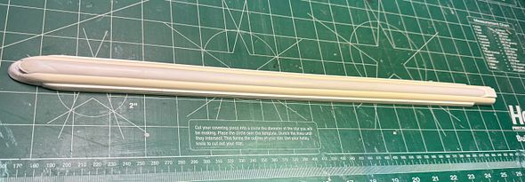

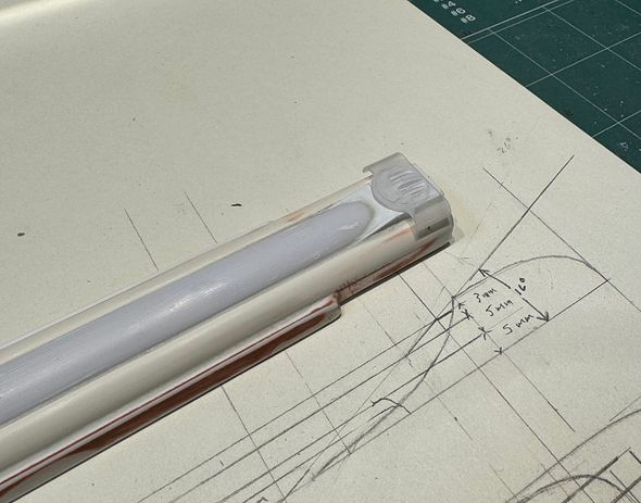

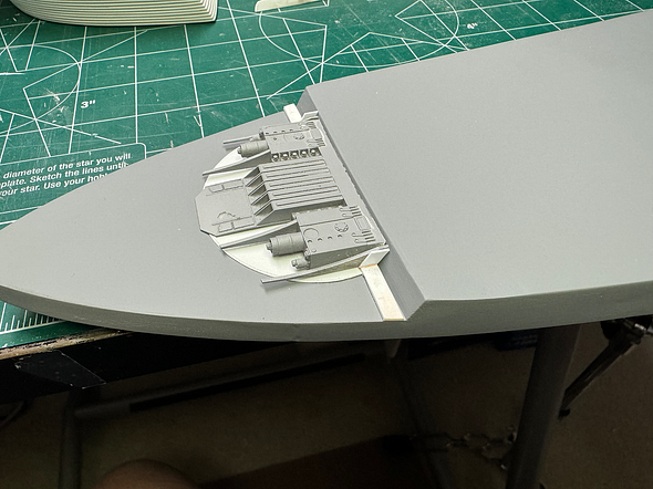

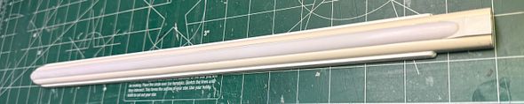

Wrapping up the top master to the Warp Nacelles, and more progress on the main hanger bay doors and cowl...

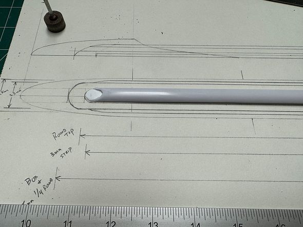

Here the 3mm x 3mm styrene strip outriggers (for lack of a better word) have been added to the bottom box. I would later decide to stack a 2mm x 2mm styrene strip on top because it looked better to the eye from the references I have.
IMG_1245
The box with a sloped side has been added to the front of the top assembly.
IMG_1248

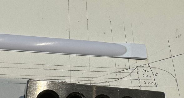

I had to search the world for 5mm quarter styrene dowel. I found some in France at a Doll House company. To my frustration, they rolled the dowels up like a rope and stuffed it on a small bag to ship. It took some time heating it up in hot water to get it somewhat straight again. (Who does that?!!!)
IMG_1247
IMG_1244

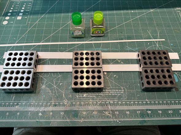

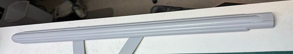

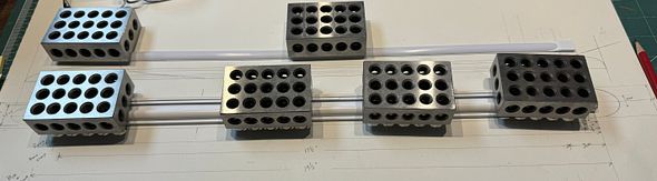

5mm dowel cemented to the bottom box assembly. 1-2-3 blocks keep it flat as they cure. I cemented 2mm x 2mm styrene strips on the inside 2mm from the top to use as a gluing surface for the top assembly.
IMG_1249
Top assembly cemented into place. The front and aft ends are still open. Later I filled them in with epoxy dough to seal them off. This master will be molded so I can slosh cast two top assemblies for the nacelles.
IMG_1252
IMG_1251
Top assembly complete after filling and blending all the sub-assemblies together.

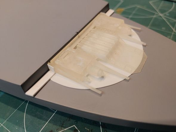

The 3D printed part placed in it position...
IMG_1262

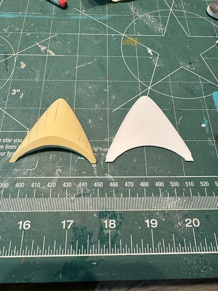

Original part to the left with a modified part to the right.
IMG_1259
Other differences...

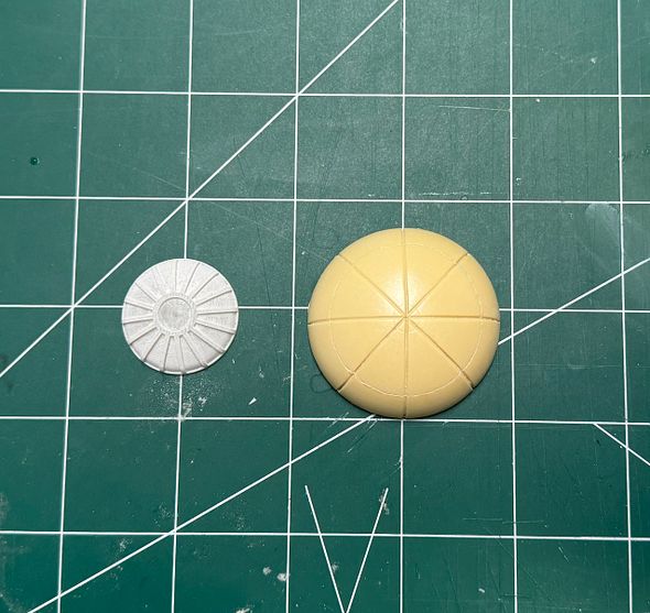

3D modeled and printed Trans Warp dome with the solid resin Warp Models offering.

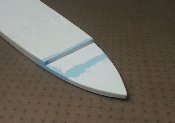

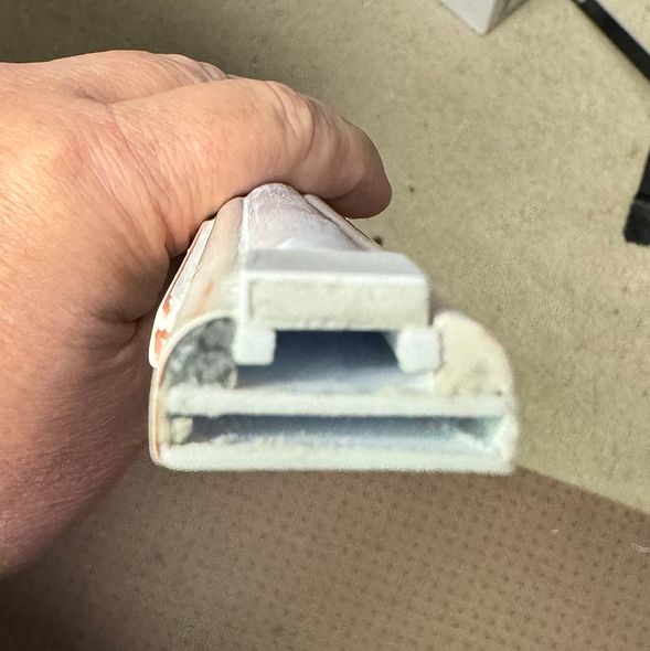

Here's the front end of the nacelle top master before filling it in to show the layers of scratch building.
IMG_1256

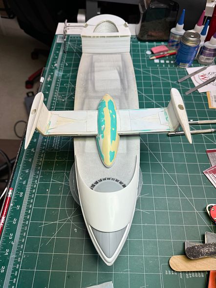

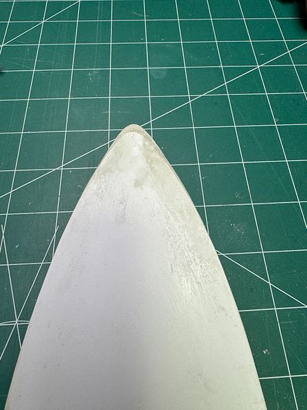

After getting the new extensions on and blended them in, I discovered this subassembly is based on the original shroud that matched the original incorrect shape of the secondary hull. Since my secondary hull has been corrected, the shapes here are considerably off.
You can see here that the sides are too flat, and the door deck aggressively bends inward to the stern of the hull.
IMG_1258

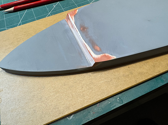

After sculpting in light weight material to the outer skin, layers of filler are added to smooth the surface. Note the new continuous gradual curve of the assembly throughout the outer edge of its base.
IMG_1292
The original Lunar Models solid resin bay doors have been filled in and re-scribed in at their proper shapes.
IMG_1295

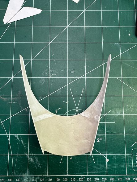

Before all the above, I also discovered some serious symmetry problems in the original shroud part as well - particularly at the overhang of the bay doors.
IMG_1255
The new bay door deck I added was thrown off centerline due to the asymmetry above, so sculpting clay was added to re-shaped the crest to centerline.
IMG_1289
After layers of fillers and primers, I'm really happy with how this sub-assembly matches the contour of the corrected secondary hull.

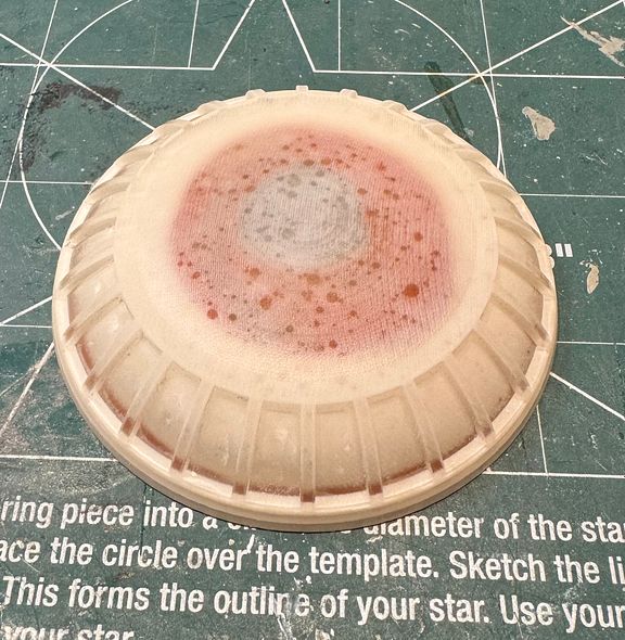

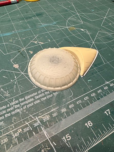

The 3D modeled hanger bay dome came out as a near perfect success. However, due to printing limitations at Shapeways (at the time), The inner surface was going to cause a distortion problem for lighting.
IMG_1320

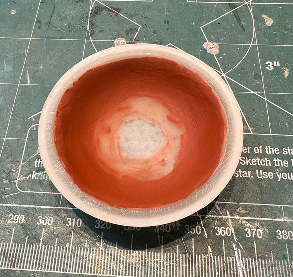

The base of the dome required to approve the print was too broad. The inner radius of the base caused a vertical wall straight up into the inner surface of the dome right at the window level. This caused a seem line to develop horizontally all the way around the inner surface right through the middle of all the window panels. The fix was to grind away the material until there was a smooth inner dome shape that went all the way to the base.
This is the inner dome surface being filled and smoothed out. After primer, the dome will be ready to mold, then be cast with crystal clear resin.
IMG_1319

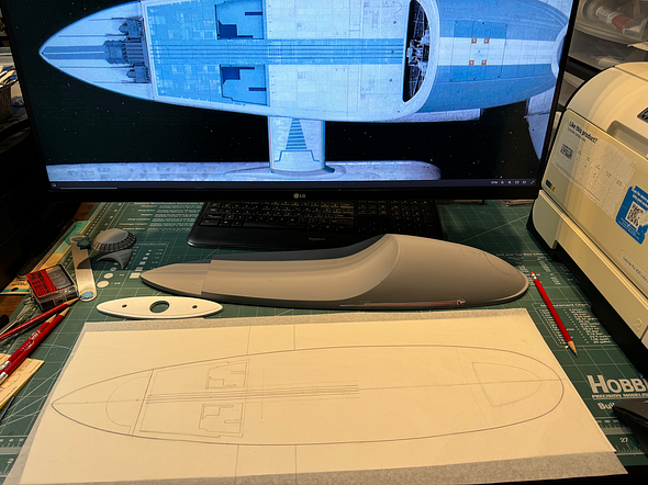

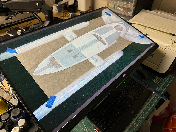

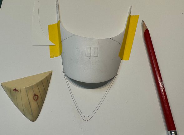

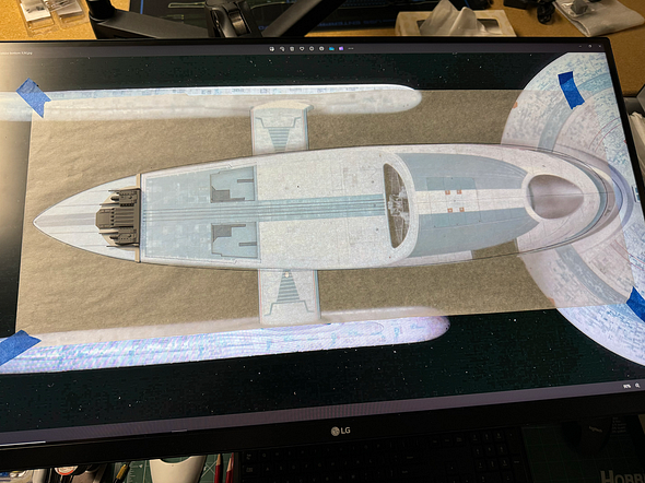

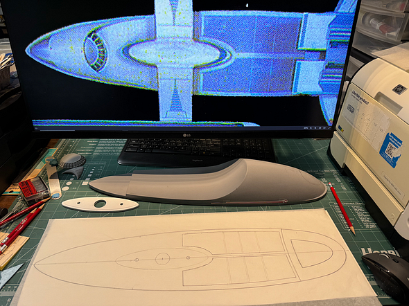

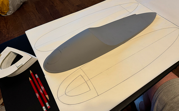

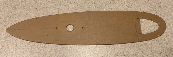

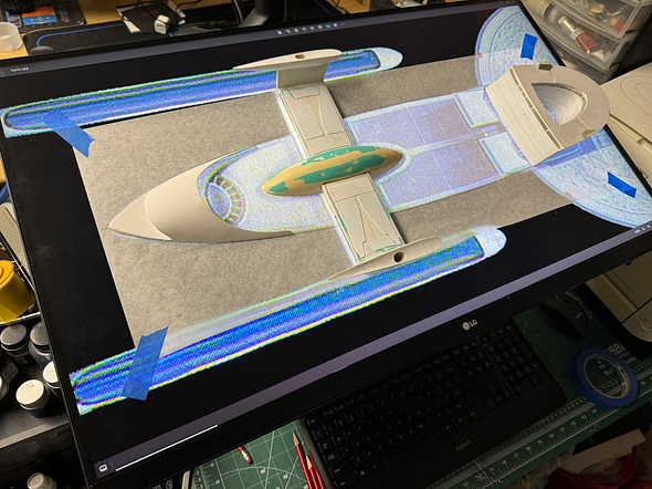

This is where I make several templates on both card stock drawing paper and translucent tracing paper for the secondary hull. There are recessed details, raised panels, and junctions to other sections of the ship that need to be plotted so they can be cleanly transferred to the vacuum formed secondary hull part during assembly.
The traced shape for the top of the secondary hull will be used as a template to create the upper deck/surface of the secondary hull. It will be cut from 3/8" thick clear acrylic. This upper deck will be re-enforced with two clear acrylic stripes to act as armatures. The inside of the dorsal seen below has been traced out to depict where material will be removed from the acrylic deck to allow for wiring of the lighting kit to pass from the saucer into the secondary hull.
IMG_1405
Recessed details are being traced in-scale so that they can be transposed to the surface of the vacuum formed secondary hull part. These openings in the bottom surface will be cut away so that the scratch-bult recessed panel details can be cemented into position at these openings.
IMG_1411
Checking that my scaled image matched some of the 3D printed parts.
IMG_1413
Top details placed in position to again check for scale and determine their positions for the assembly phase.
Note: this is where I discovered the hanger bay shroud is too short.
IMG_1414

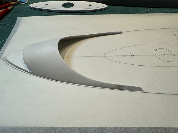

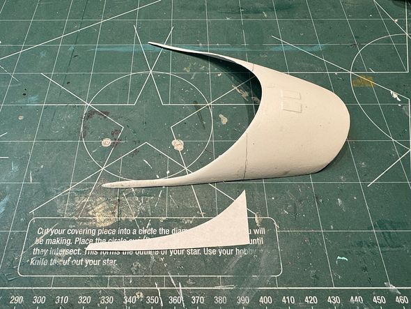

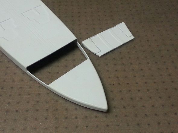

Here, new modifications to the main hanger bay cowl have been made. The extensions were too short. You can see how short they are a few images above. The ends were nipped off for a flat gluing surface so 40mm more material could be cemented on to lengthen them to the correct profile - as depicted by the tick marks on the template. Filler has already been applied and awaiting to fully cure before sanding and blending in the new extensions.
IMG_1418

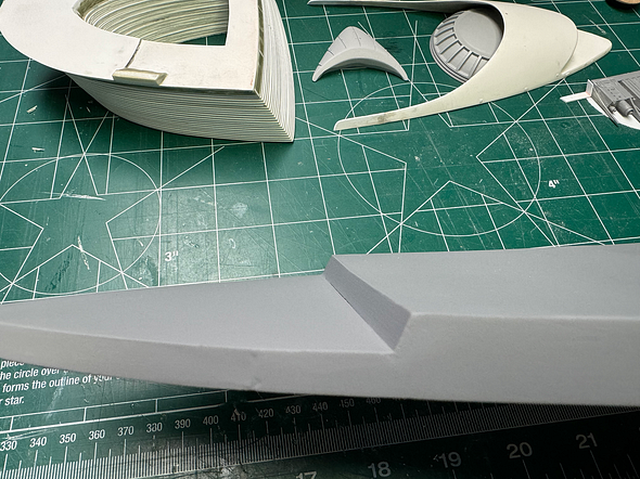

This is what I did to fix it... It's not 90deg.
1ea604a8-dcdc-4809-bd5b-94357eecc886
098c14c1-3391-43f5-8bb2-6091a3d35aaa
Had to grind out the proper angle in the 3D part and alter the vertical stanchions of the scratch-built cradle to meet the corrected step angle.
83f3306e-78ac-4a80-9e43-09ec5a28745e
2798d17e-b3cc-41af-a923-43919d63c6bb
Whew! Glad I found this before I cast the secondary hull buck in plaster for vacuum forming the secondary hull shell.

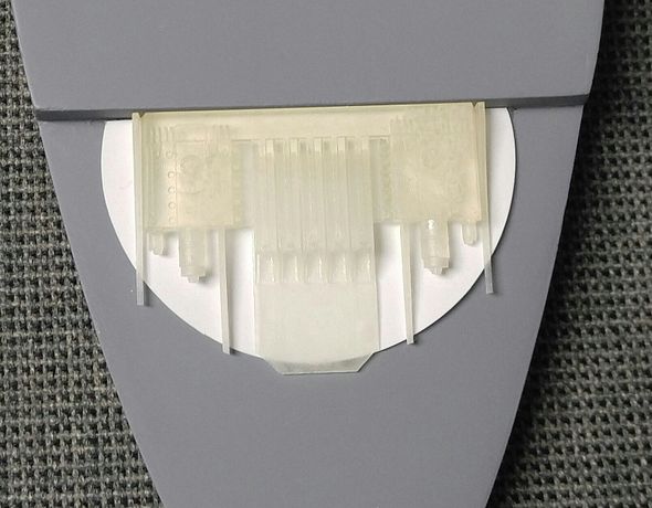

Small update...

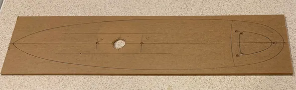

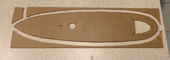

The template that positions all the cut and drill points into the top deck plating of the secondary hull have been established on the paper lining of 3/8" thick clear acrylic.
Carefully trying to determine how to cut into to this material without making a molten mess. Three sheets, three tries...

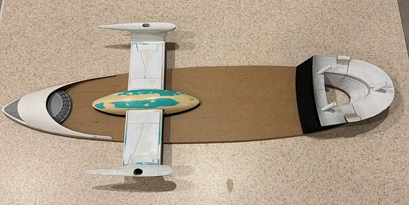

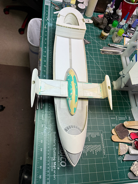

I have finished the rebuild of the dorsal assembly and have a series of photos of the In-work progress, but for some reason, I cannot upload photos to my Photobucket account. A query is in to Support, and I hope to have it resolved soon.
Tracy
A completely new rebuild of the dorsal/neck section was needed. I was not happy with how the spacer plates did nit align, particularly at the rear corners where they are most noticed. I came up with a more restrictive 3-tube jig to ensure everything aligned during the stacking of the plates.

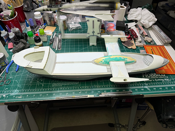

I've delayed this long enough...
I managed it on the very first try. ;-)

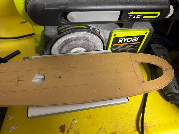

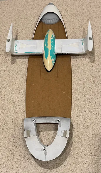

Cutting the top deck of the secondary hull out of clear acrylic.
Here the pilot holes for the warp pylon assembly with its wiring opening have been pre-cut. The three holes for the styrene tubing that run through the dorsal assembly have been drilled through at the correct angle which will properly align the neck onto the secondary hull during assembly.
The excess acrylic was cut from a safe distance with a jig saw and acrylic cutting blade to reduce the chance of mistakes and/or accidents. The opening for the wiring between the secondary hull through the neck has also been cut out.
I elected to grind the shape down to the guidelines to have more control.
Cutting and grinding complete, the outer edge was further sanded then polished so light will flow through easily to the edges. To create an armature, two square clear acrylic dowls will be cemented to the internal surface with acrylic Weld-On 3 from fore to aft - from the opening in the neck back to the step in the hull by the aft torp launchers to act as a spine that will support the weight of the entire ship.
Here, the brass tubes secure the pylon assembly, and the styrene tubes keep the neck aligned on the secondary hull.
If you're not seeing it, the major hull parts will be vacuum formed in clear styrene for lighting just like the studio models were. This acrylic hull roof will fit inside the secondary hull's shell flush to the top edge secured with clear UV resin/glue. This will allow lighting of all the windows in the secondary hull, including the ones at the very top of the hull.
Before primer and paint, all the window masks will already be in place.
With the paper still on the acrylic, I can pencil in the top hull panel details, then scribe them in.
