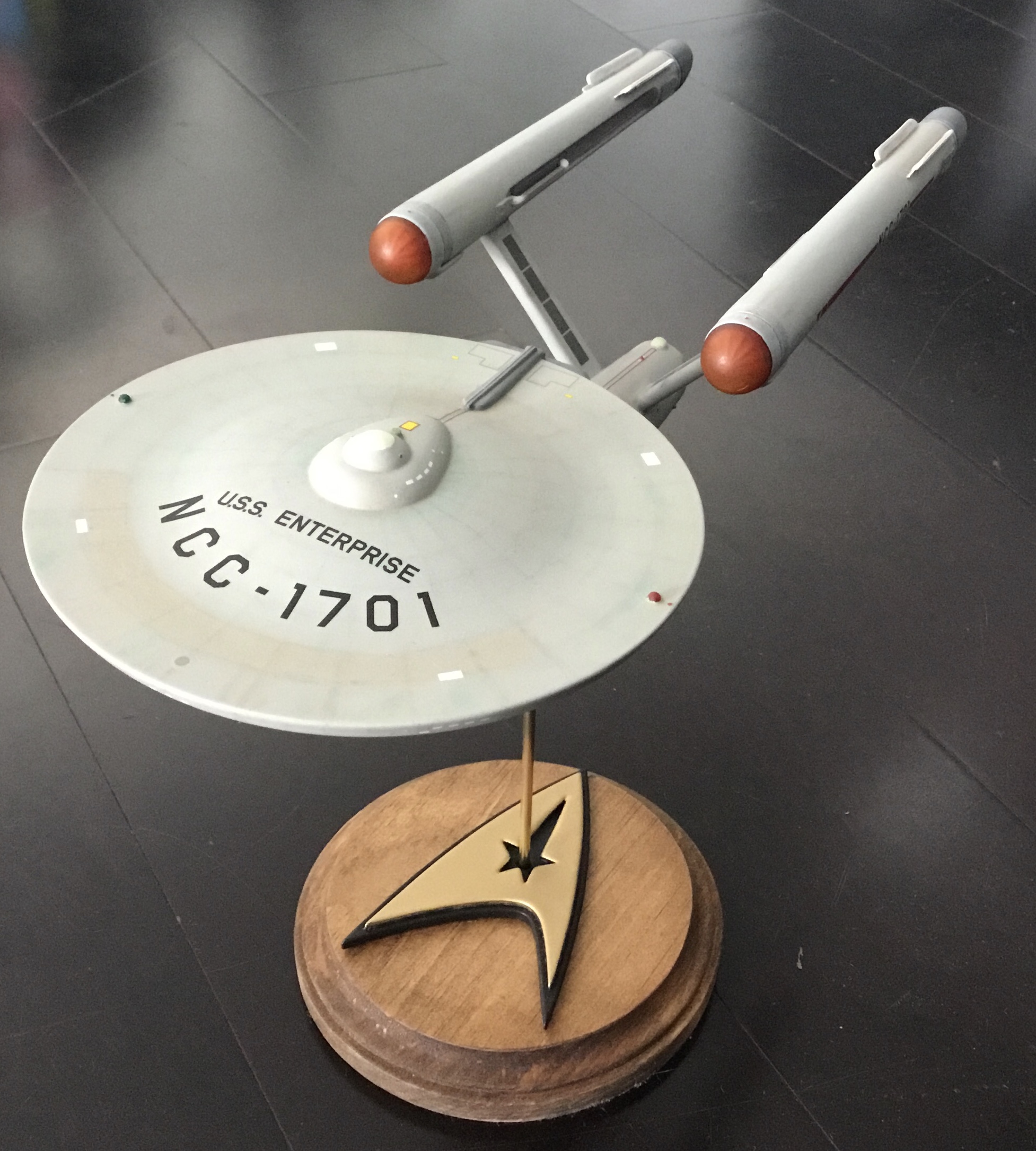

Fact of the matter is, drawing the grids on is tedious, although I do like the results I’ve gotten in the past. I’m also currently building an Enterprise for a friend, and will probably go the pencil route on that build, as I did on my own personal build (seen below).

On the flipside, i just finished the misting coat for my aforementioned Enterprise build (the one I’m making for a friend), after I penciled on the gridlines and applied pastel chalk weathering. Once that’s fully dried, I can apply more chalk to both bring back the gridlines in certain spots, and calibrate the degree of weathering/streaking.
It should be interesting to compare the results of both techniques (decals vs. pencil/chalk) on each of the models.

My Endeavor build (Aztec decals mist-coated with the base hull color) vs. the Enterprise I'm building for a friend (pencil with pastel chalk weathering/accents, mist-coated with the base hull color):
