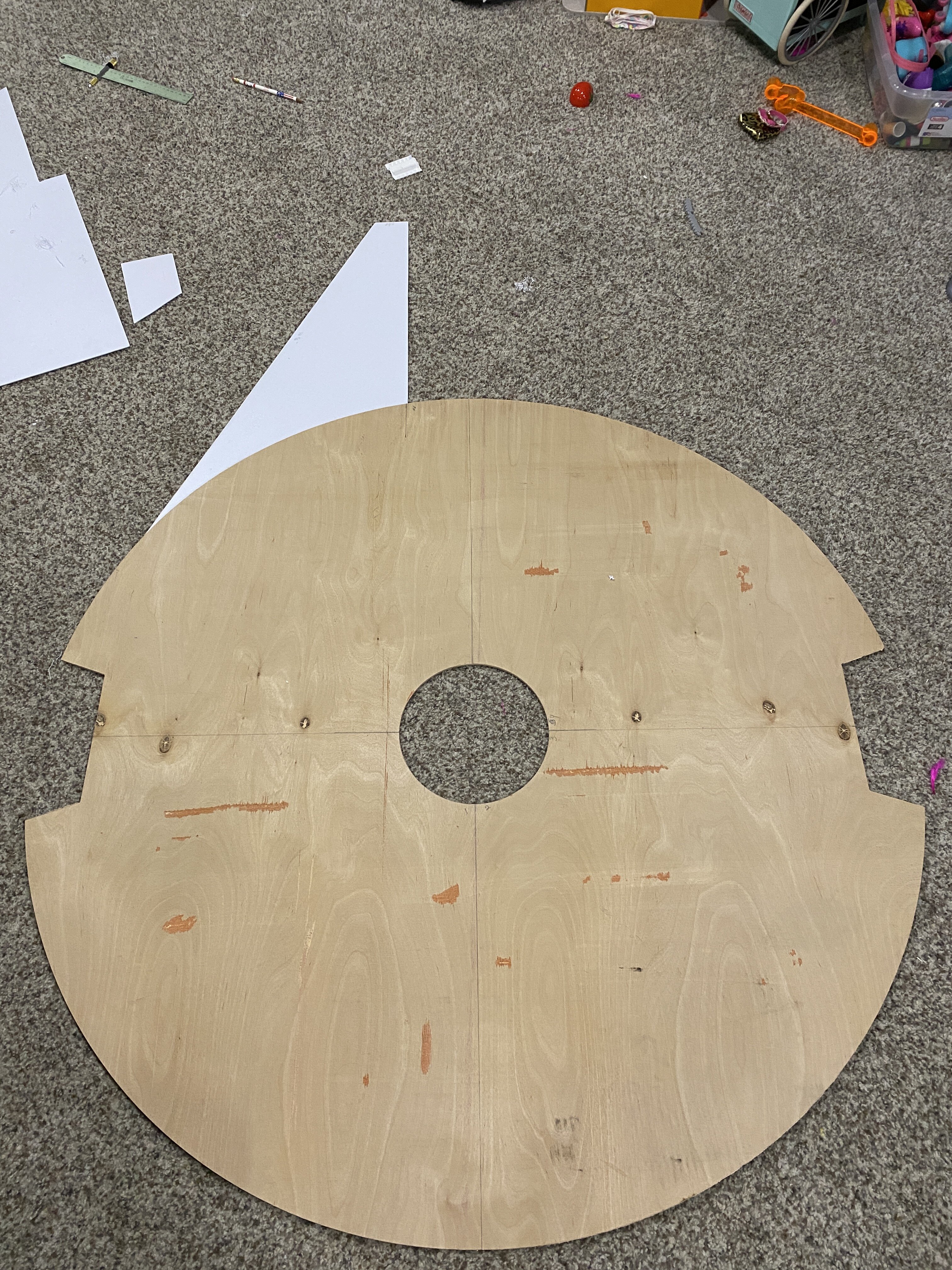

Here's mine to compare mate. I think your hole template needs moving over to the left to get centered better. That's what I'm seeing anyhoo...
We're never going to get things sitting perfectly John, never 100% accurate, just we do our best!
Thanks Stu. I appreciate your logic. :)

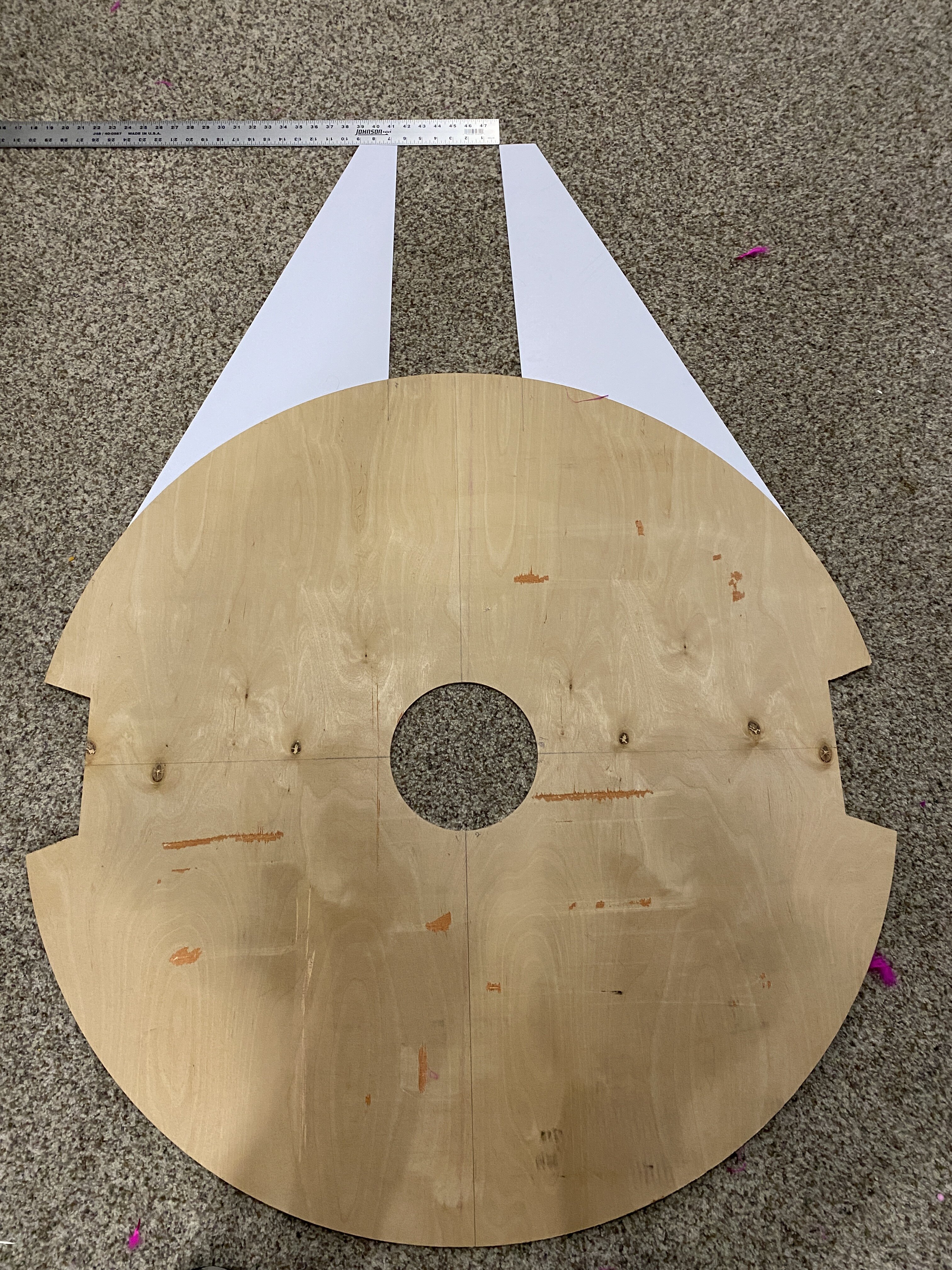

Here's a revised and further up. I think it will work.
Nice work John!
I wouldn't go less than 3". I think that's the magic number for these guys. If anything, a hair over which will probably come about with cutting and sanding.
Totally agree with Treadwell's comments re picture alignment by pulling back a bit. It will reduce the parallax to some degree.
Nice work John!
Thanks! Is three inches the standard for all 8 holes?

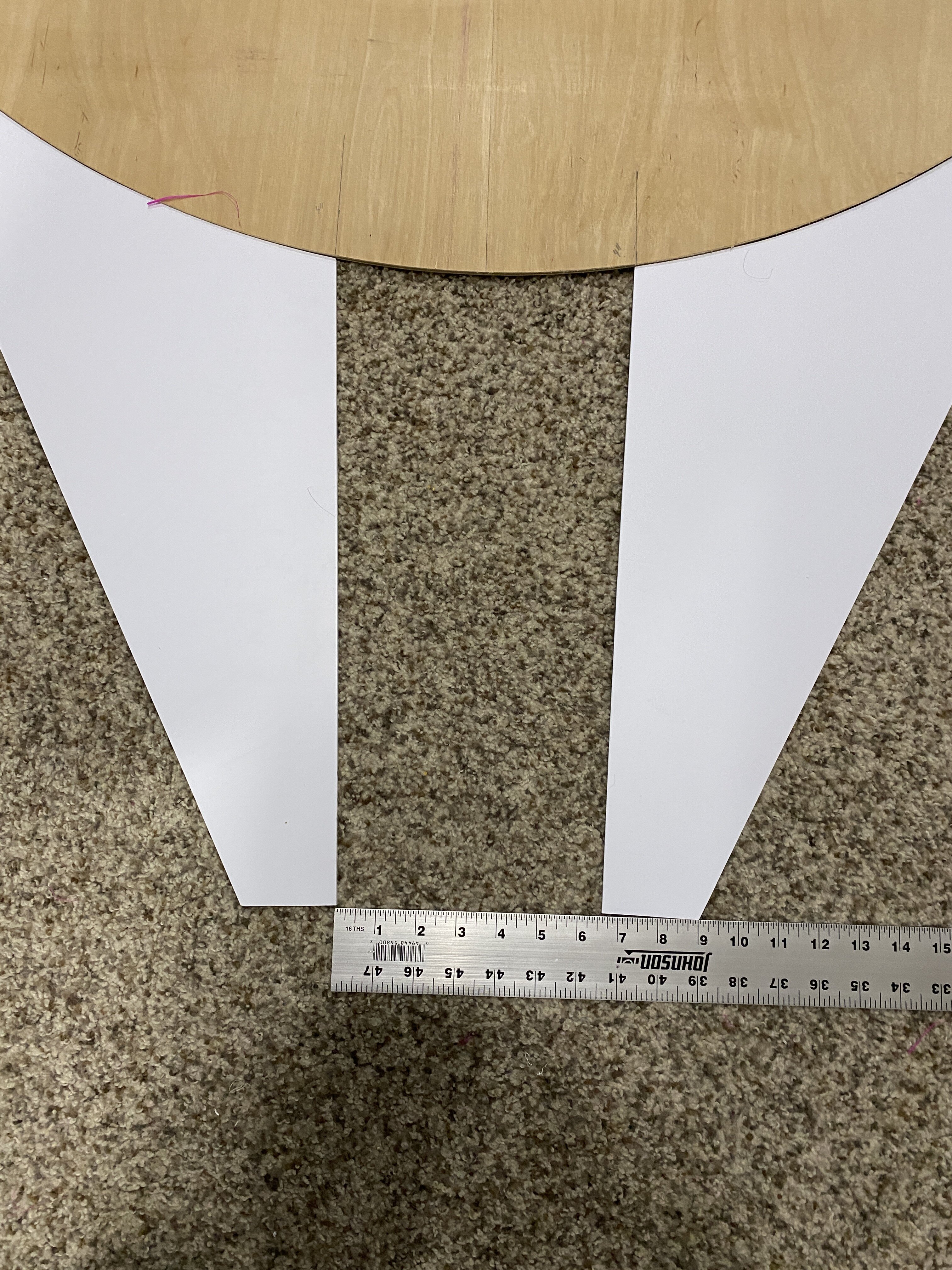

One cut and sanded. Thoughts?
Looks so small in comparison to the burger, doesn’t it? Like mini-mandible. I know the thing is so big we can’t get head on photos of it without a 15 foot ladder to stand above it. LOL
Starting to smell like victory around here, huh? After more than a year (or 2, or 3, or 10) of research into this darned thing! Looking good John!
Thanks…but it’s wrong. Lol. Screwed up the pinch somehow. Gotta try again. :)
It doesn't look toed-in enough in the photo, but I know how deceiving these can be. You're showing 9" to DR I'm guessing? What about laying out a right side template and get your 6.65" (this is my guesstimate for now), or whatever you're going with. (If you have a big enough piece of cardboard to do that.) Or run a straight edge down centerline to the tip so you can measure? Since there is toe-in the front I am assuming the front 2.4" cut won't be square, if you know what I mean.
Looks good. Did you run a straight edge down centerline too and measure each side from center so you know your square to the burger too? (Not that ILM was square to everything, or anything! LOL) Just one more way to check things and square up. Might end up being asymmetrical anyways.
