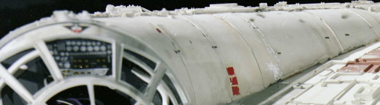

For example, this is just one of the many of the cockpit area pics that are public, this one shows a detail yours is missing, the other side there are several more of these little masked off shapes. If you aren't using all the information out there and didn't confirm an area, it's not fair to say you have made an 'accurate' build. Trust me, I have lots of errors and incorrect details on my projects, it's necessary to keep moving forward, so as long as we make it look good or close, then we made a pretty great model. There's just that line when someone says their build is 'perfect', when like I said earlier, none of these builds are perfect, and never will be.

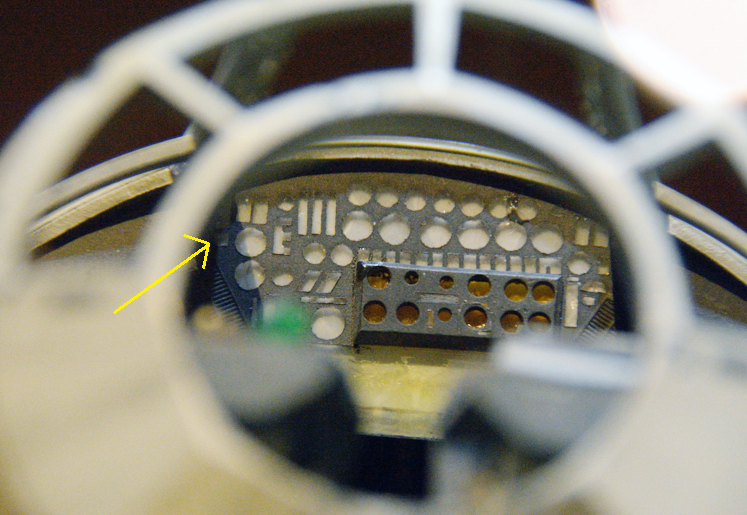

Well, you've been provided pics (evidence) by me above from the original model, showing the Morgan Headlight (part E71 in fact), which you said you'd never seen, and instead of a THANK YOU, you complained. But there's the proof for you that your yellow circle is inaccurate.

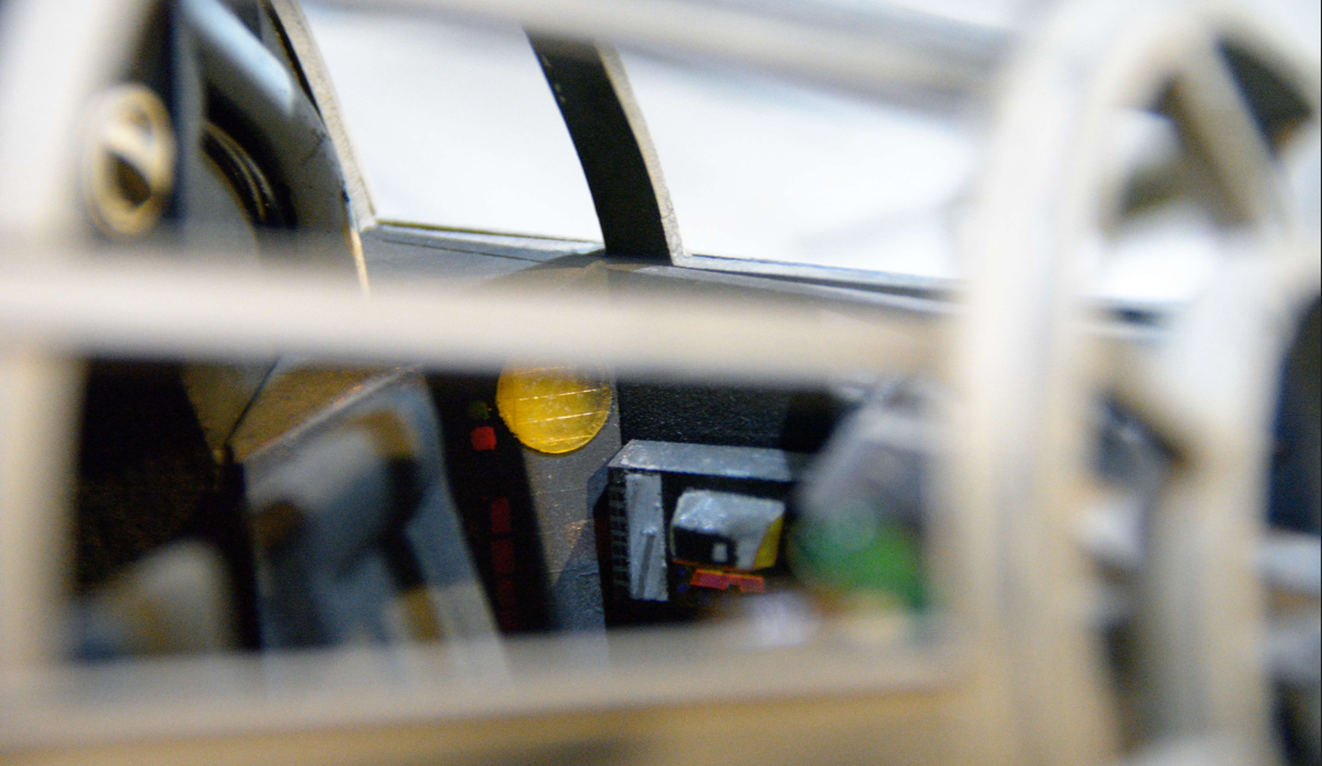

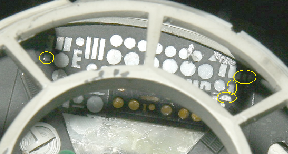

So, in addition to the actual photo evidence I provided for you on the Morgan headlight, below is a photo that shows the missing details on your backplate (but will you believe the real evidence?)
Below that, a vintage ILM pic that obviously shows the orange film in the Hurricane part just like the black panel above it (cropped from an original full hi-def image of the full model in depth of field, others in focus aren't being shared)
This photo - proof for you again that your part is inaccurate. (you might also note what you think is a 'blue' wire is actually purple for the fan)

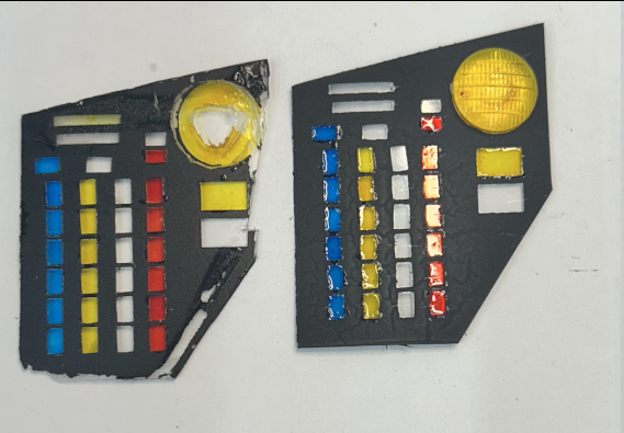

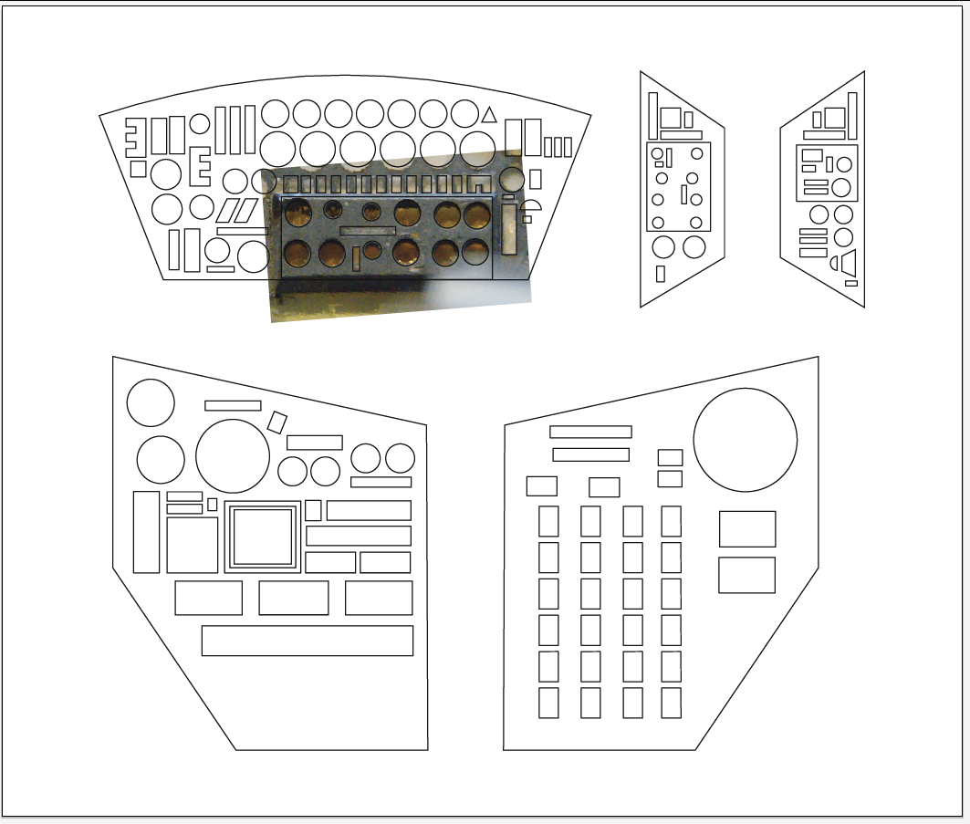

So with the help of t2sides's additional photos, I've updated my cockpit to use one of the Morgan Roadstar headlights. This part is called for on the parts maps, but I was not able to find a clear photo that showed it. All the photos I had showed what looked like just a coloured circle.
The one of the left was what I had, and was damaged during removal. I tried to cut out a hole in it to accept the headlight part, clearly that didn't work. So I've just made a new one, on the right. It will replace the part I ripped out.

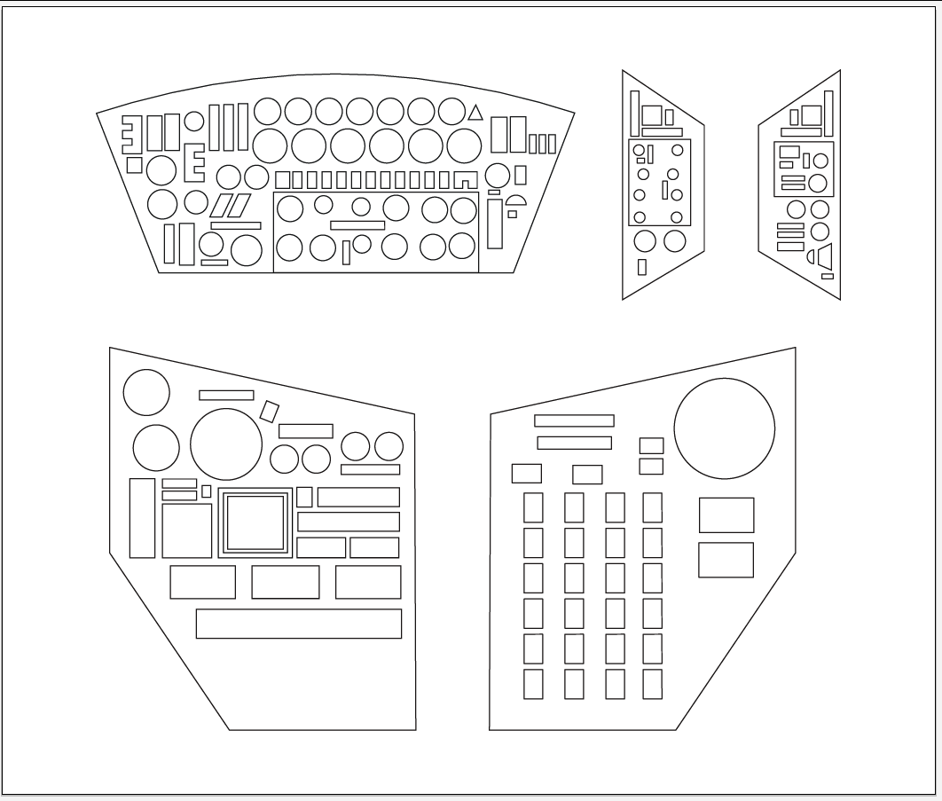

Thanks to t2sides additional photos, I've been able to update the console panel mask cutting document. I think these are closer to the real thing, but if anyone has some additional corrections, please let me know.
Some of the holes on the raised portions of the panels really hug the edges of the part, so just something to be aware of.
thanks
  • ConsolePanels.pdf

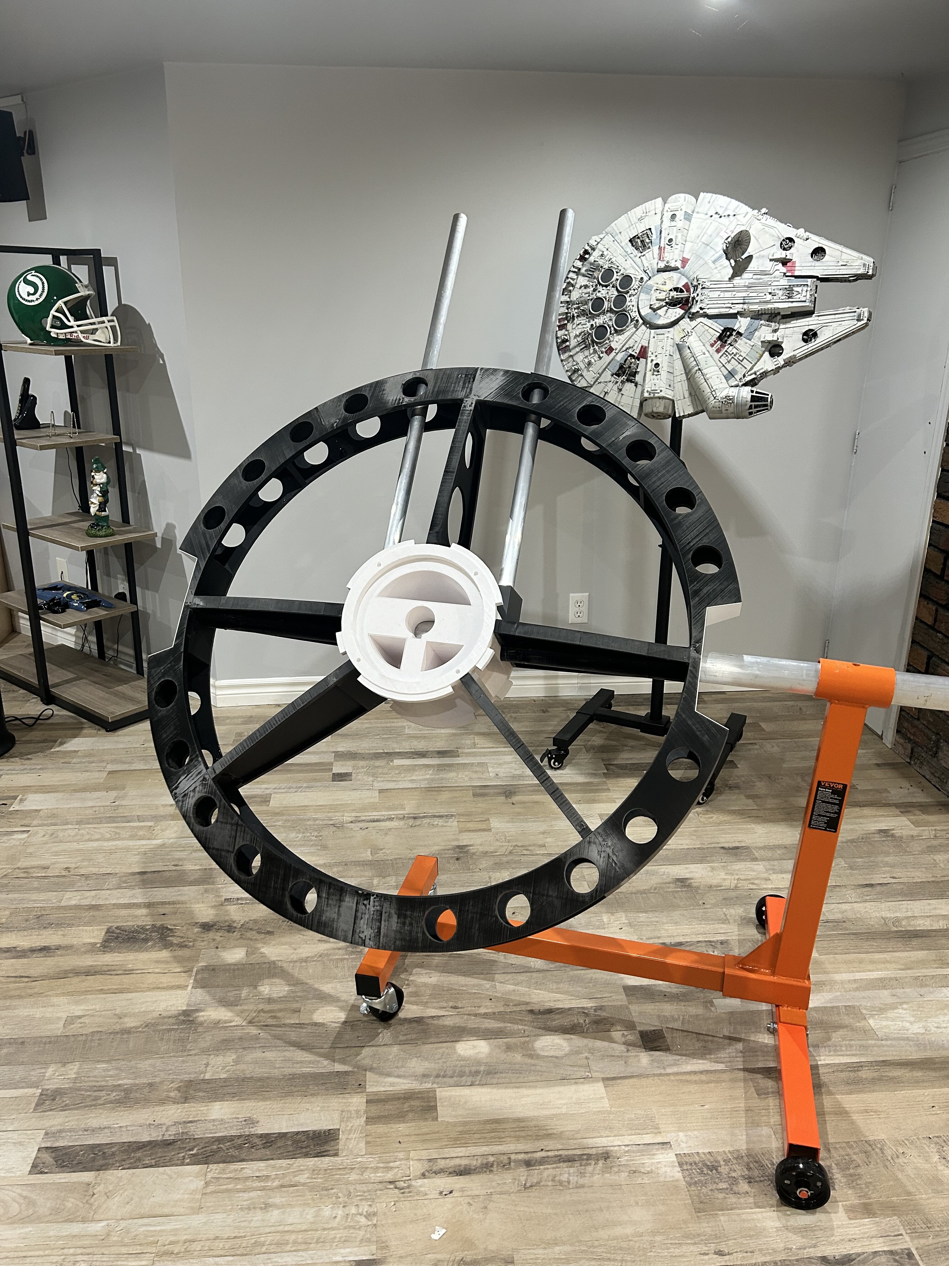

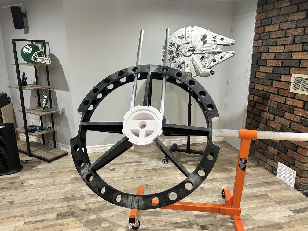

So it is starting to look like a thing now. Or at least, the bare bones of one. I purchased the engine stand off of Amazon and sort of got a bit of a dud. The casters do not sit level on the floor because there's a twist in one of the extrusions? Maybe? I haven't really looked. The 2.25" aluminum tube also needs to be cut down to length because there's a full 2 feet poking out the back of the stand out of frame.
I also completely overlooked the fact that this model would end up nose heavy, and it rolls down around the mounting tube. So, that was a bit stupid of me. I'm not sure how I missed that. Anyway, I'll have to come up with an insert that goes up the centre hub that will pin the model in place.
I posed this up in front of my 32"er just because I find the size difference between the two mildly hilarious.

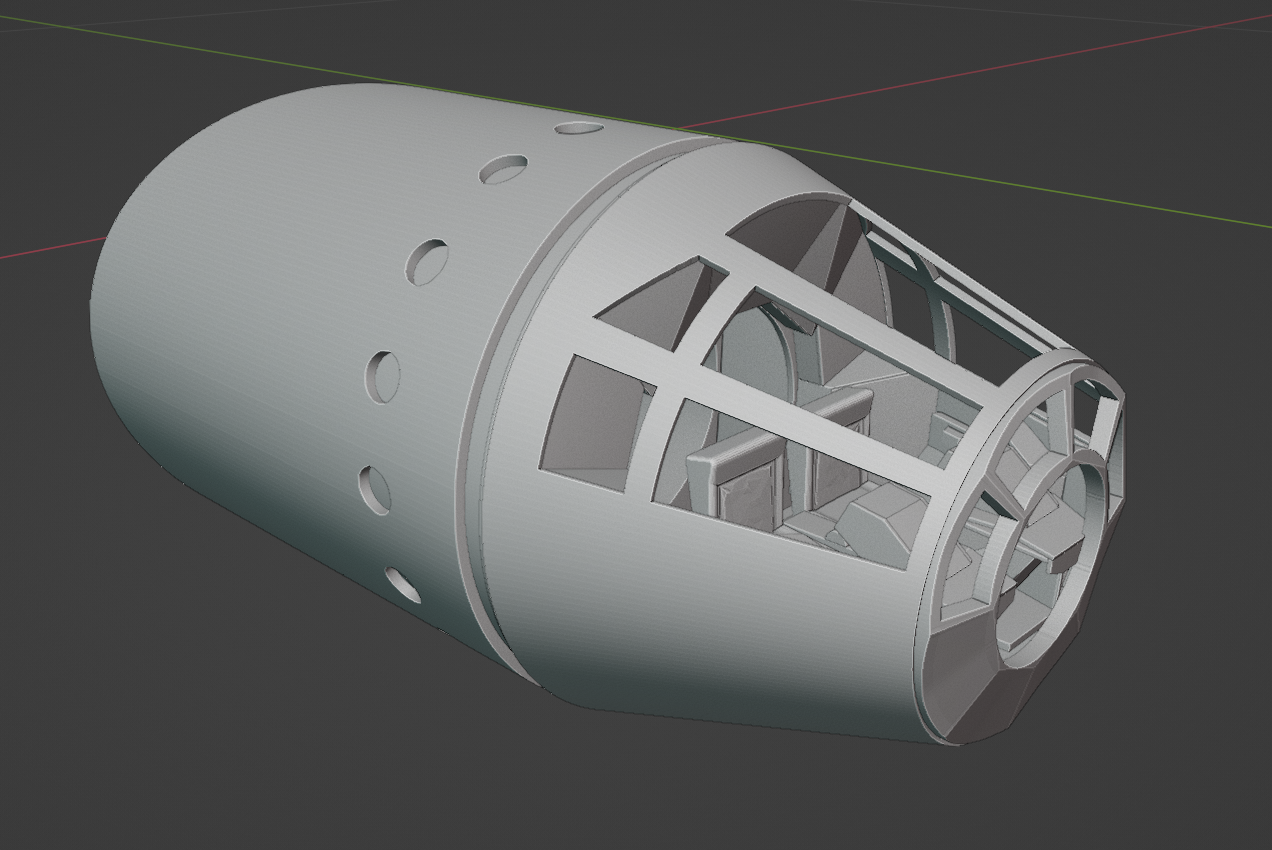

For anyone that cares, I've posted all the 3D files I used to help build my cockpit over on Cults3D. Sorry jcoffman99, I tried to post these to your reference site but the files were too large. Feel free to grab them and post them up there if you wish.
While I scratch built my cockpit from kit parts and sheet stryene, I find it extremely useful to model everything in Blender first. That way I can resize and move things around as required. It saves me cutting up parts from $200 kits and getting it wrong.
The collection comes with rudimentary versions of the Morgan Roadstar seats and floor but they are not intended to be used in a final build as they're missing a few details. They were made just well enough to serve the purpose of being the correct size and basic shape.
I've included the cockpit cone as well, but I used these to generate flat patterns and made the cone from rolled sheet plastic. You can certainly print the cone if you wish, but I'm not sure how well it would turn out.
None of the other greeblies are included either. Those would come from kits as well.
Click here: Cockpit Interior and Cone
Maybe this will help someone.
