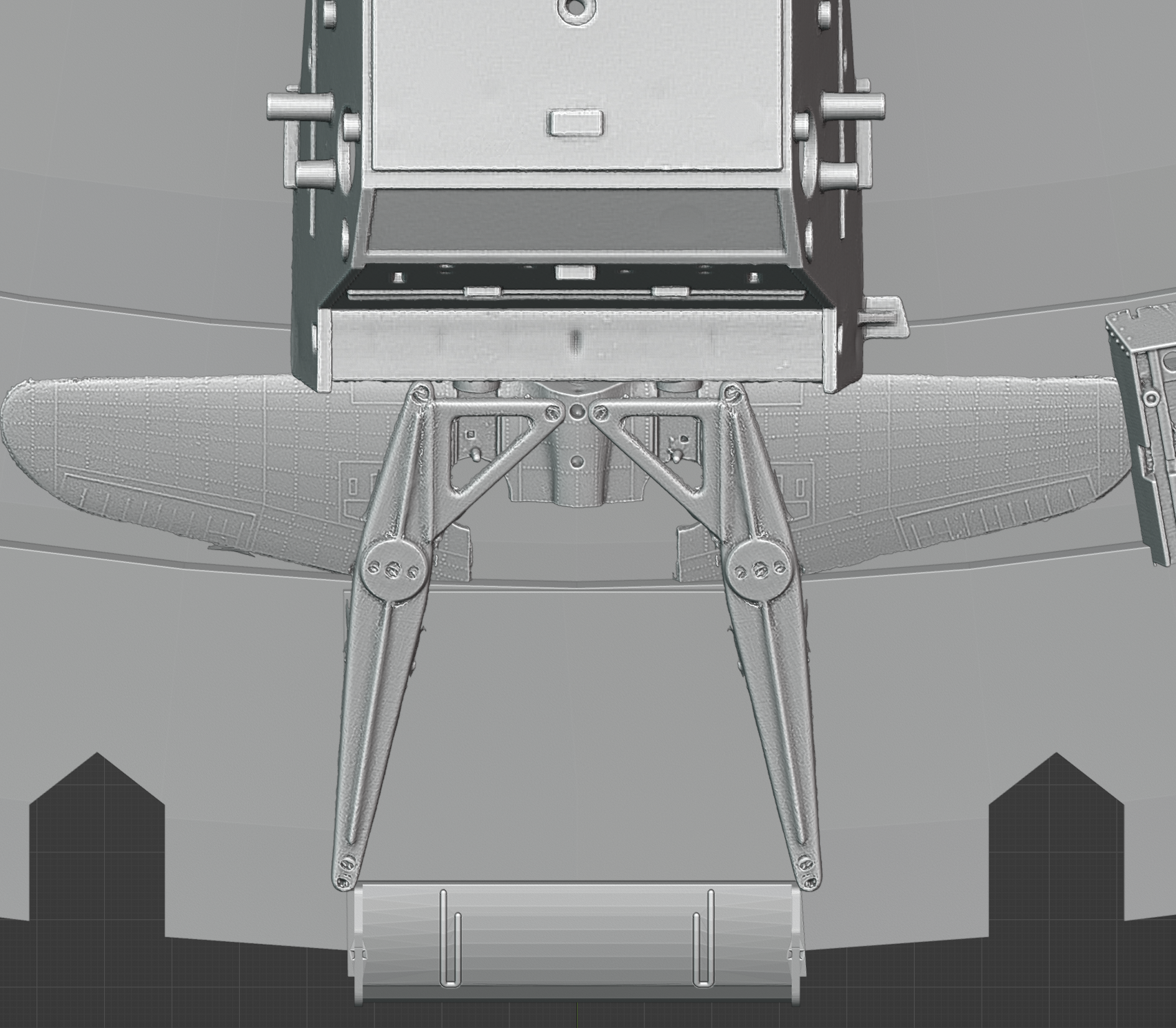

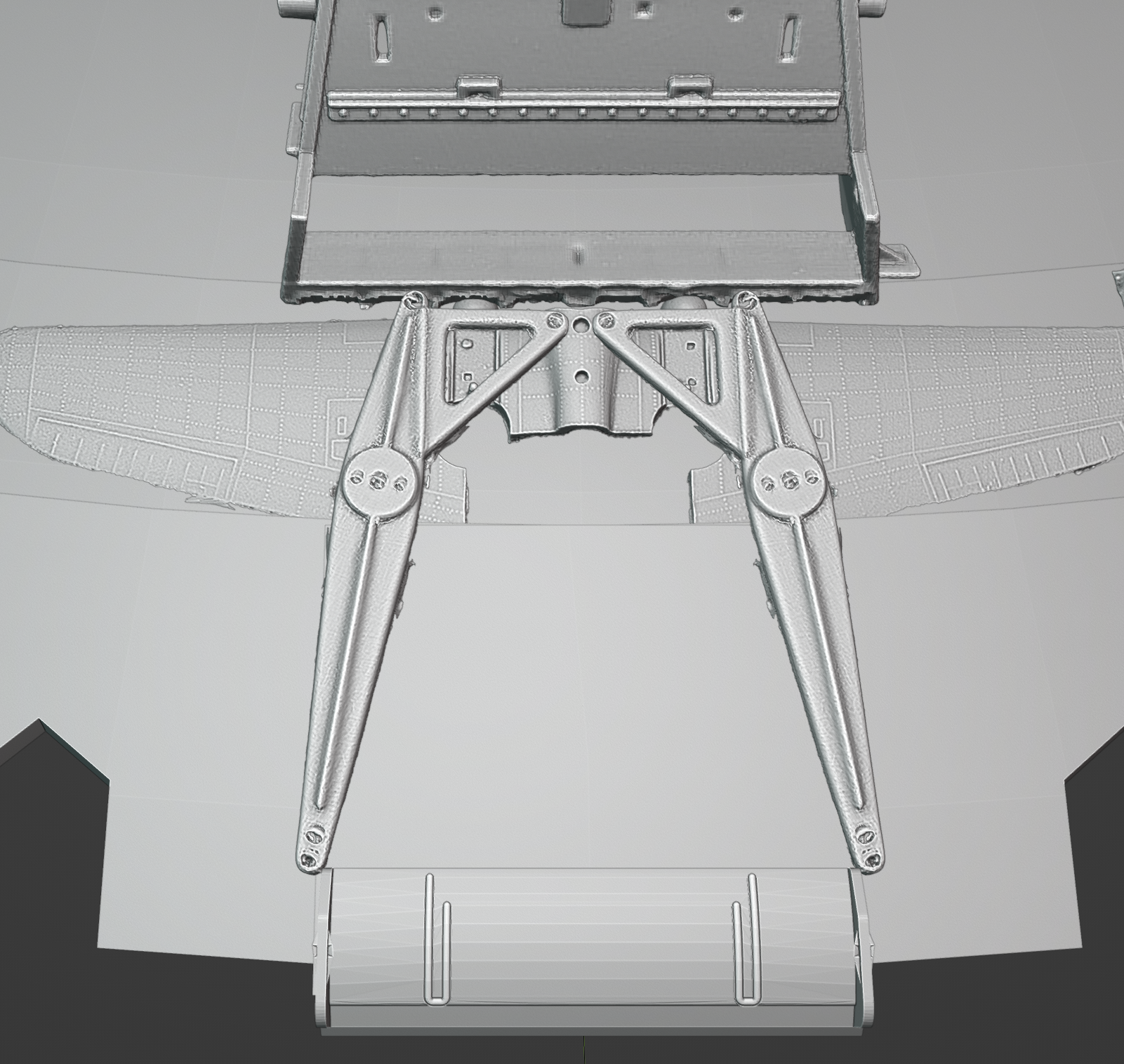

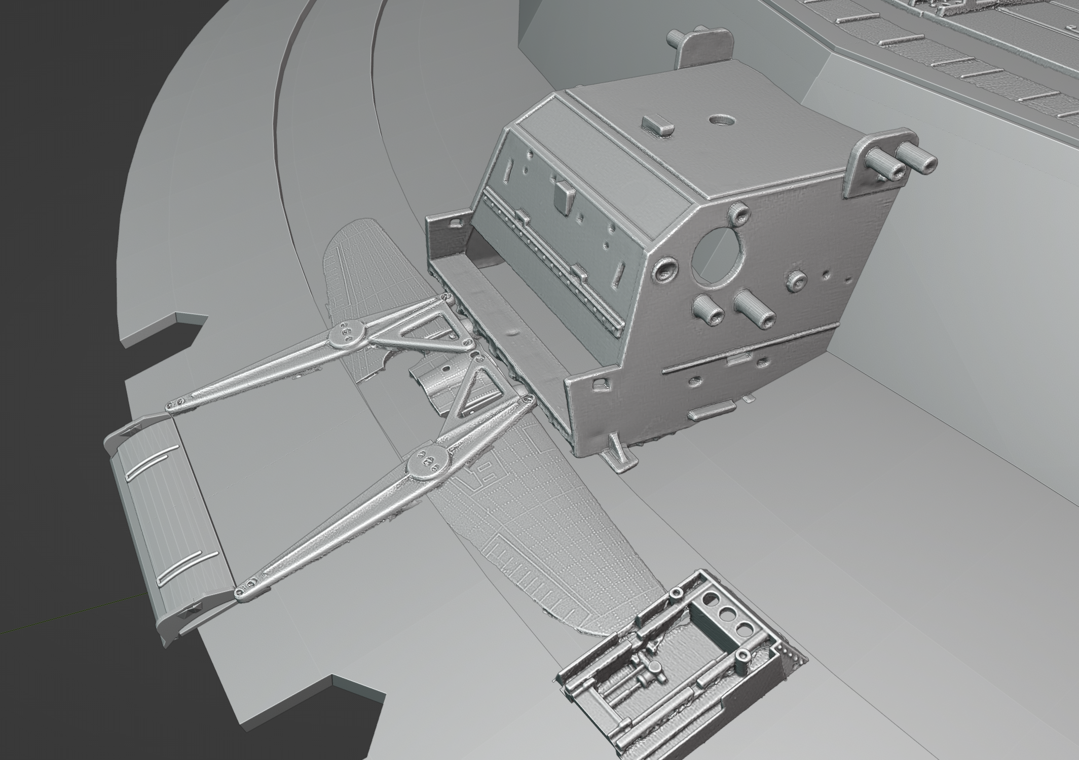

Using Blender and some laser scanned greeblies to determine positions and measurements for the two 3mm 'lips' on the lower hull. Do these positions look correct? I have a couple of clear photos, but they're all from, more or less, the same angle. I don't really have any clear photos looking straight down. The only really good 'straight down' image I have is out of the Chronicles book, and that's not very clear.
Obviously the P-40 wings have not been cut down and that 8Rad part also too long. But am I in the ball park?

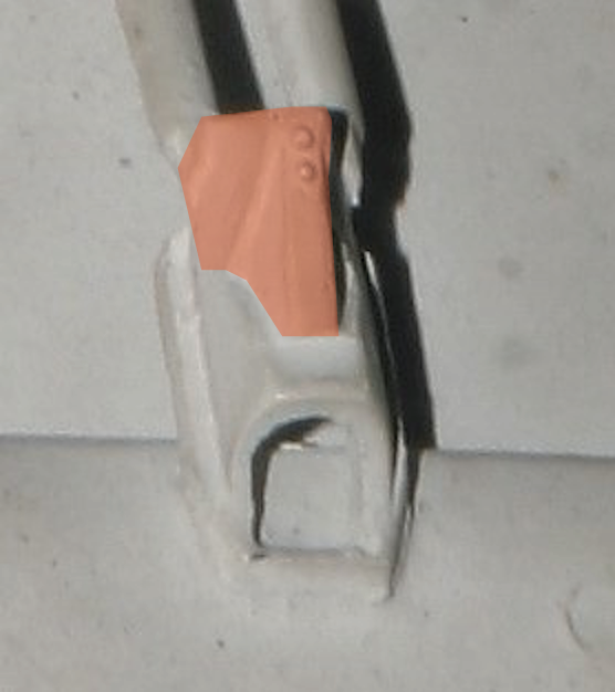

Am I correct in saying that bit in red has not been identified yet? So many things found lately, it's been hard to keep up.
