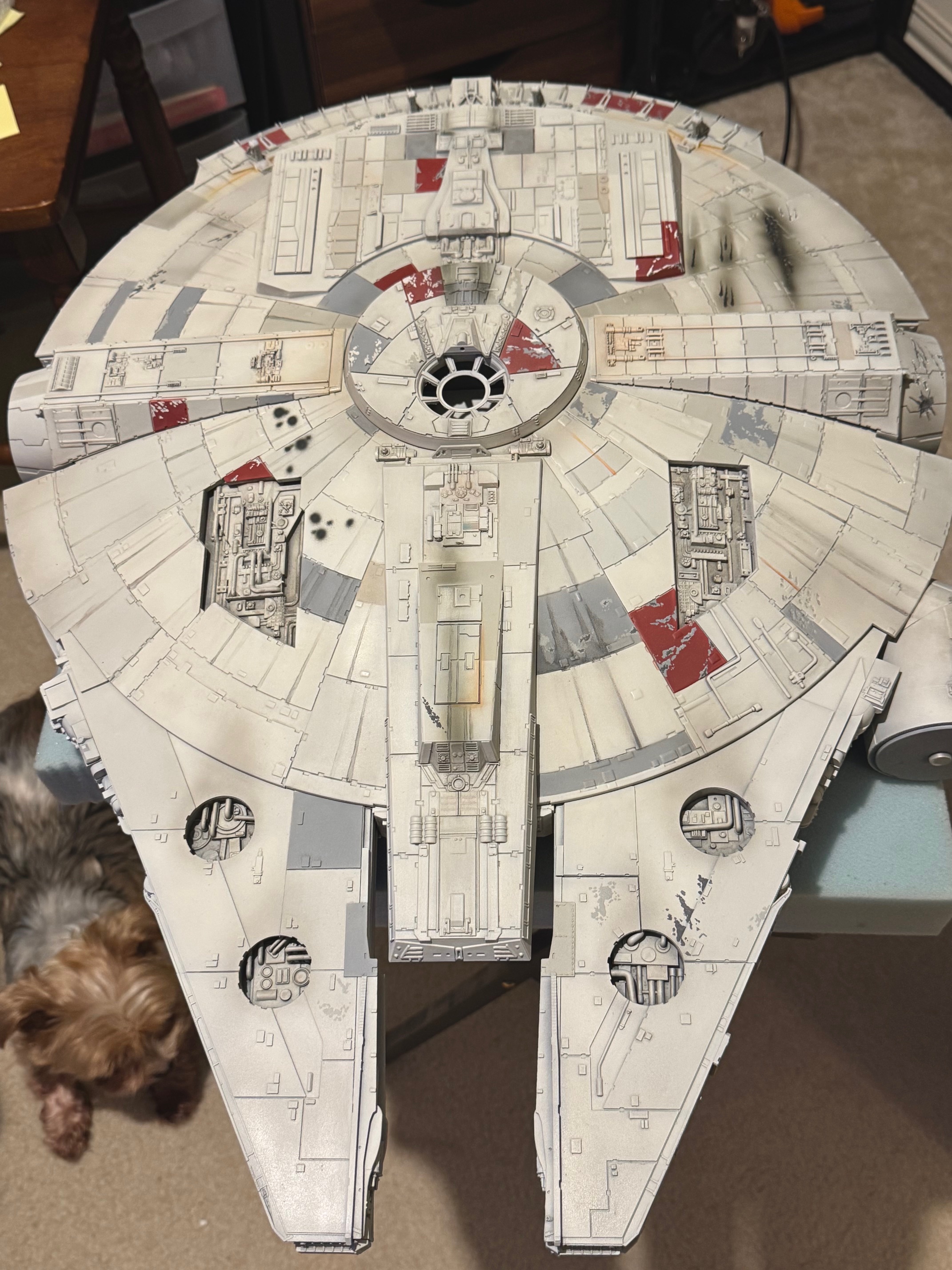

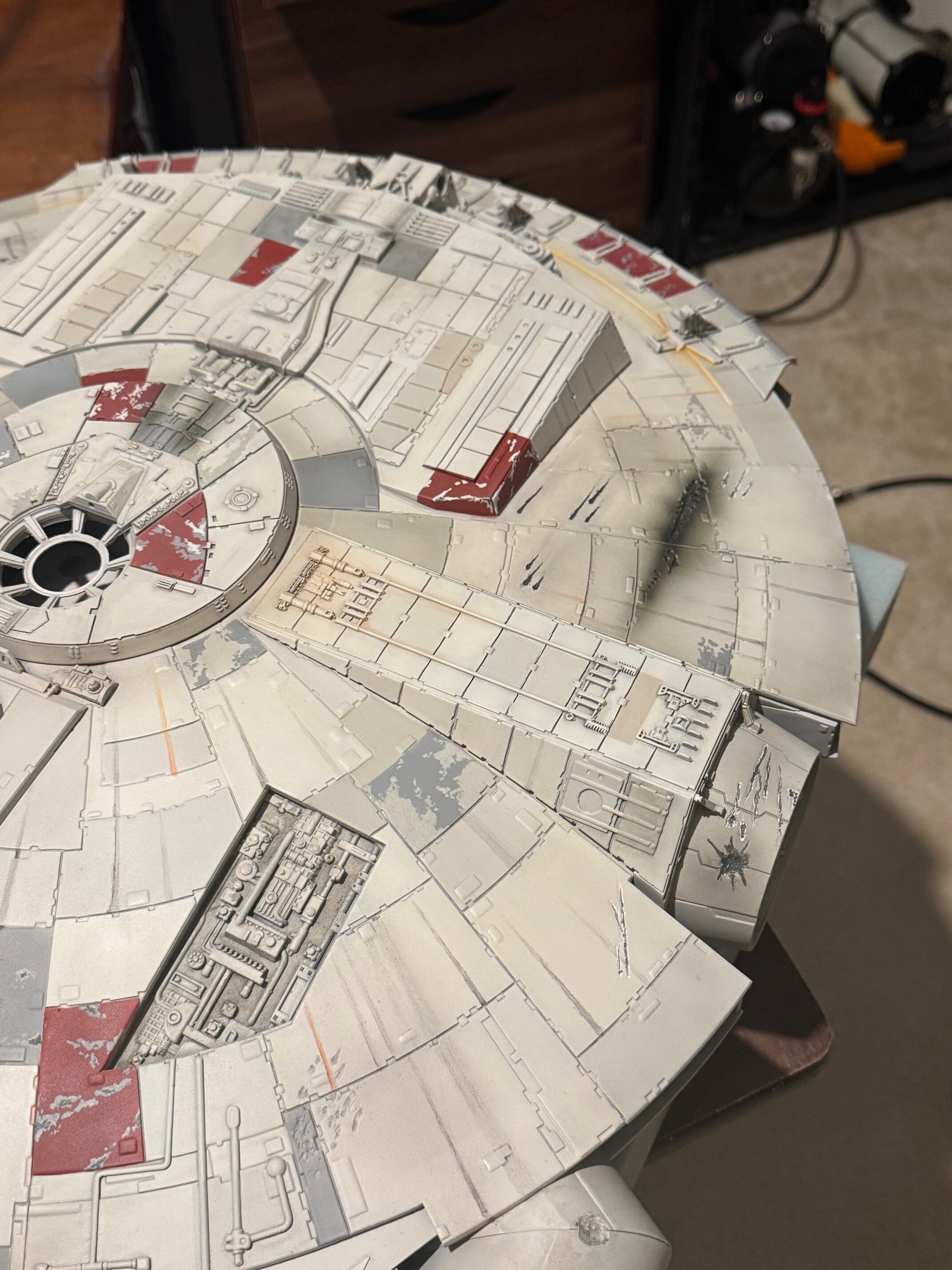

I think I'm calling the bottom done. Although I’m considering repainting the blast marks, but that would be a lot of work at this point.
Looking real good. It''s a lot of work painting the Falcon, literally days of masking and painting.
