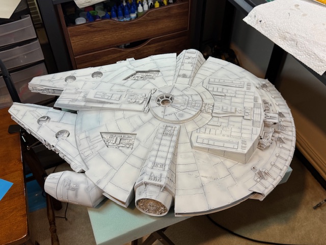

I think I am happy with my paint mixes. Time to get some color on this preshaded bird.

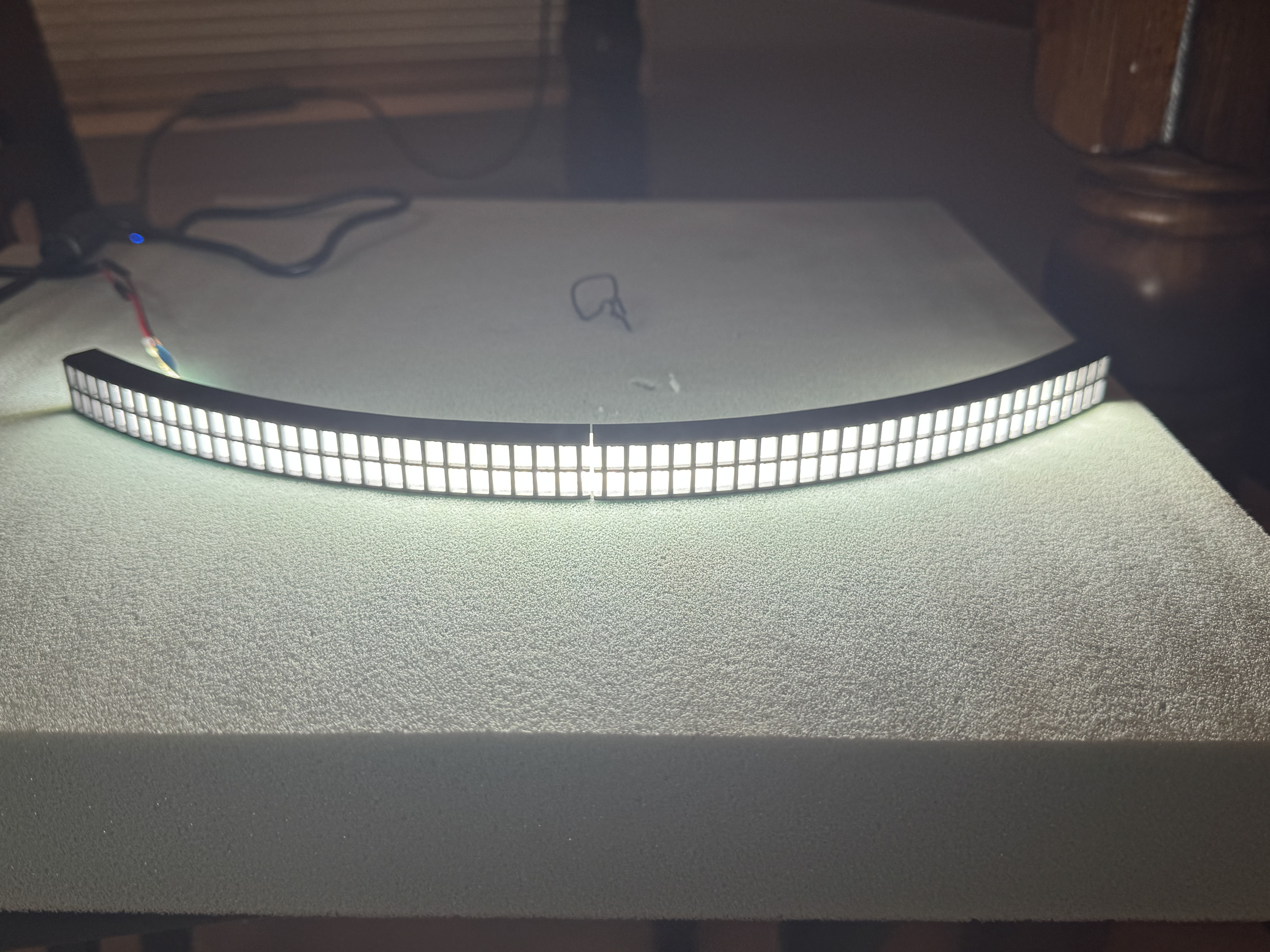

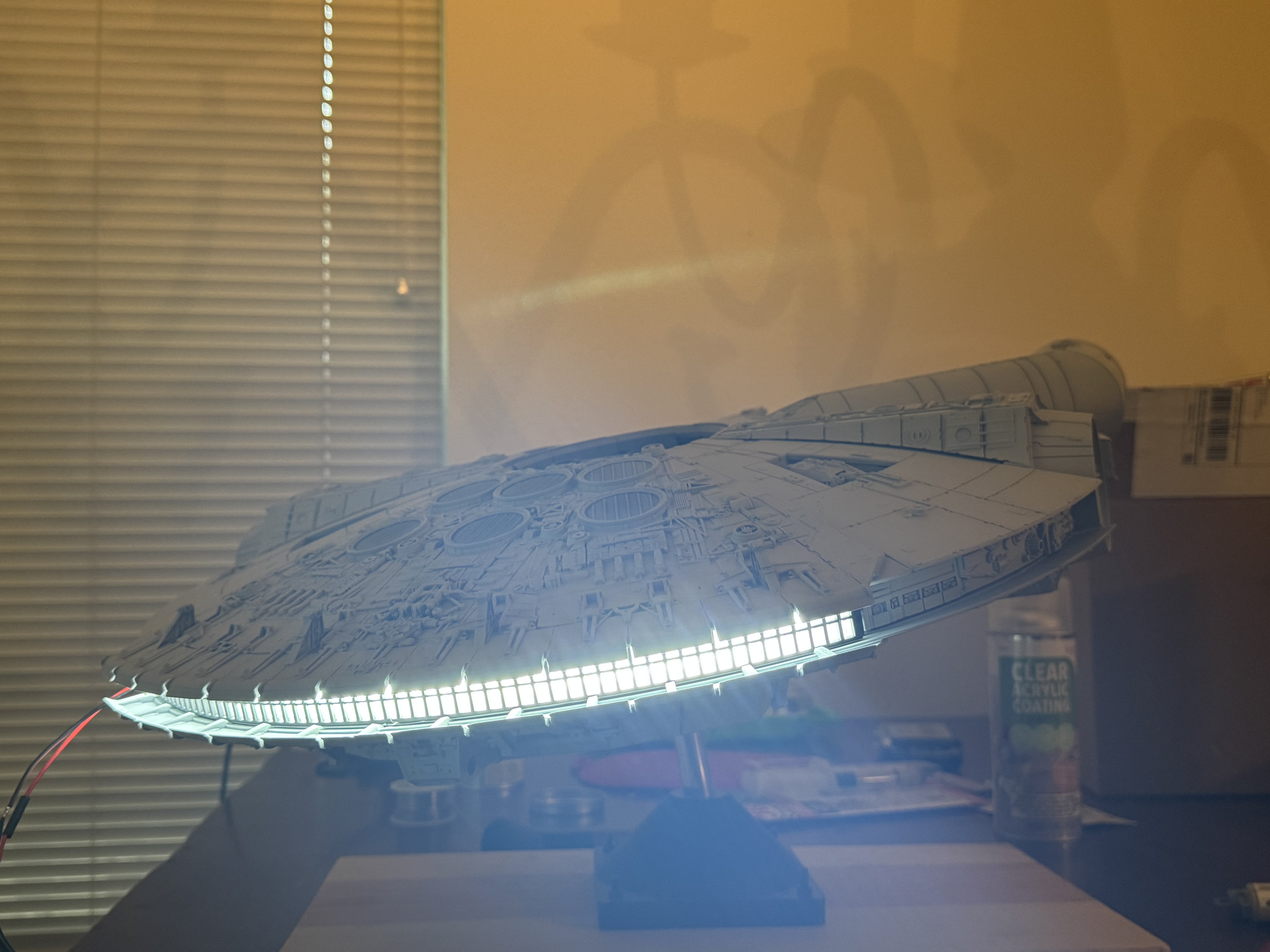

Did a lightning test, but the leds seemed to be getting a little hot. Put a thermometer on it and the backside was reading 60C. I’m worried about deformation of the PLA. I am using a 12v supply 10a supply as recommended by the LED strip. Maybe amperage is too high since the strip is cut down (but I thought the supply would only pull amperage it needed). Electrical is not my strong suit. Any suggestions would be appreciated.
It's looking great! Quick bit of research... the melting point of PLA is about 160 degrees but it starts to soften at 60 degrees celcius.
How long do you plan to have the lights running for?
If you're just flicking them on now and then to admire it or show people I wouldn't be concerned. If you're planning on making it your new table lamp however then perhaps
A) Try a lower amperage as you suggest or I dont know if could even be run at a slightly lower voltage with some dimming.
B) Create a light box back from the engine grille. Then you can foil tape the insides around it and
That should save any issues.
Cheers,
Josh
Cheers,
Josh
Got a new strip that is less densely packed with LEDs. Still puts out plenty of light and is only getting up to about 30C.
