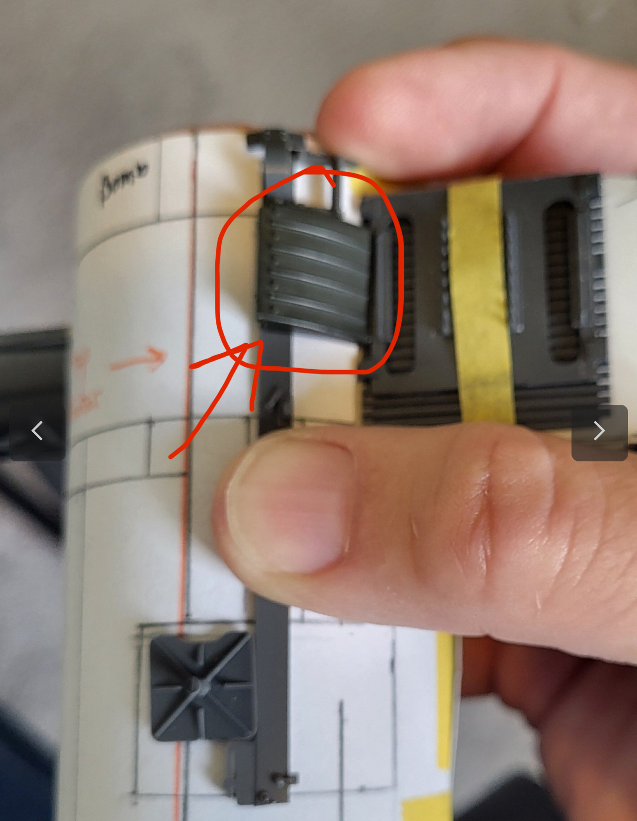

I really like the template, great way to make sure things are fitting correctly.
Is this Lee part positioned correctly? It should only overhang the top of that Leopold part partway, flush to the fuselage body. Just want to be sure your positioning is correct.

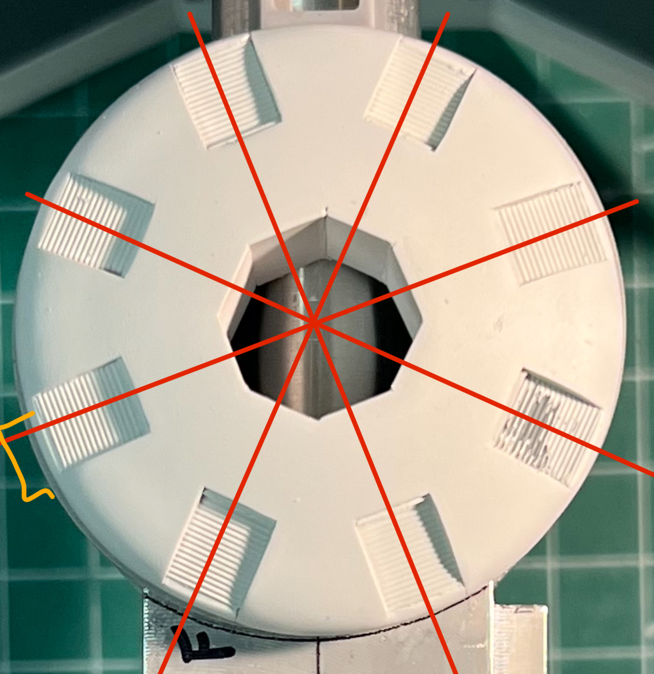

Another template that might help is to cut out a 2” dia circle and divide it into 8 sections to represent the 8 cutouts, one of which aligns with the top Leopold part? That way you can be sure when you mount your actual front dish that it’ll be in the right spot.
Something like this, and the orange is where the Leopold part and Sd.Ah. 52 seat go. Just thinking of things I wish I’d done that would have saved me some headaches later.
I taped the resin front to the body to make sureI got the clocking correct. The M3 lee fender is not in the correct position I need additional fingers to hold all the parts....lol
