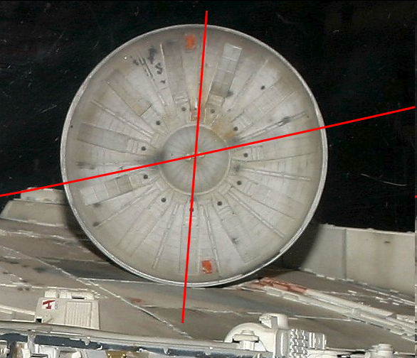

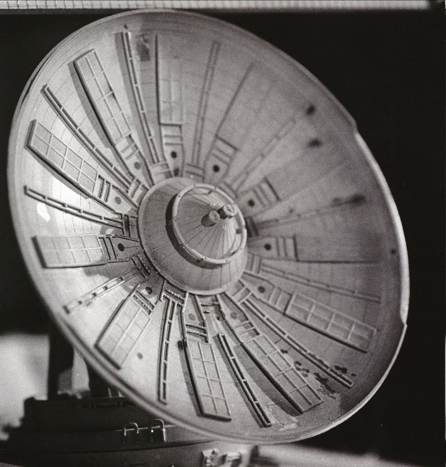

Nice work. Looks like you have a remnent hanging out on your Sat V part though. There should only be three tubes sticking out and the middle one should be solid.
Thanks swgeek for the feedback,
By Remnant do you mean the little nub sticking out underneath thee 3 tubes?
I modelled this based on what I saw in the photos of the Studio Model.
And don’t forget- this is often missed - the dish is 180 degrees out in all these reference pics - it has been ‘flipped’ when on tour - so be sure to display the dish with what looks like the bottom above is actually the top.
This affect the rear too - it’s why you should see the bent tube at the back side at top of the wheel, not bottom. This also affect the orientation of all the part IDs.
Oh many thanks for that - explains a few issues i was having when comparing the photos against other 5 footer builds, where the other builds seemed up the wrong way (But now I know were Correct) - had me confused, as I didn't imagine any of the builders here would get it wrong ;)
