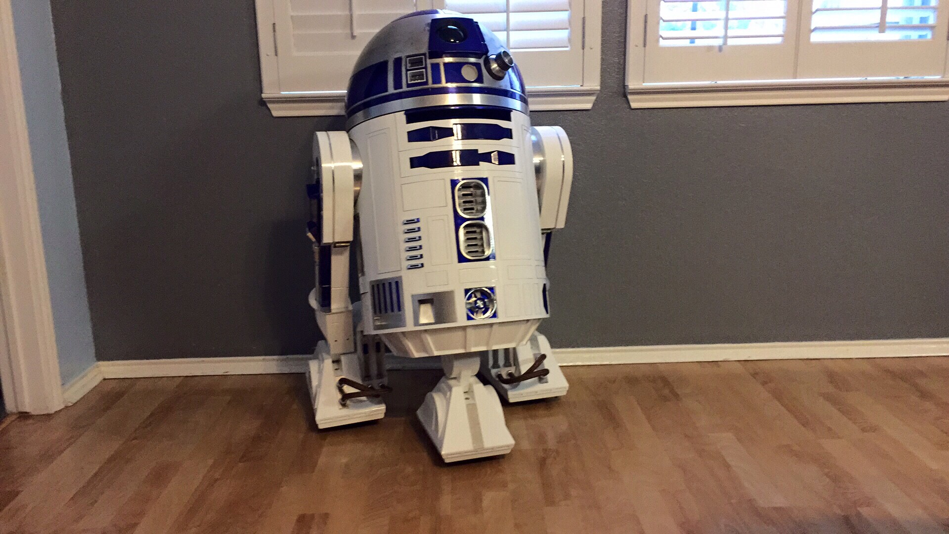

Today marks the day! I was able to get him all put together and driving around for the very first time.
Here's a video of his first steps.
And here he is for the first time with his head and sounds!
It's so cool to see him just 'come alive' with the flick of a switch.
That is so cool!! Superb work and congrats on the build; must feel nice to look over and see the hard work paid off:thumbsup

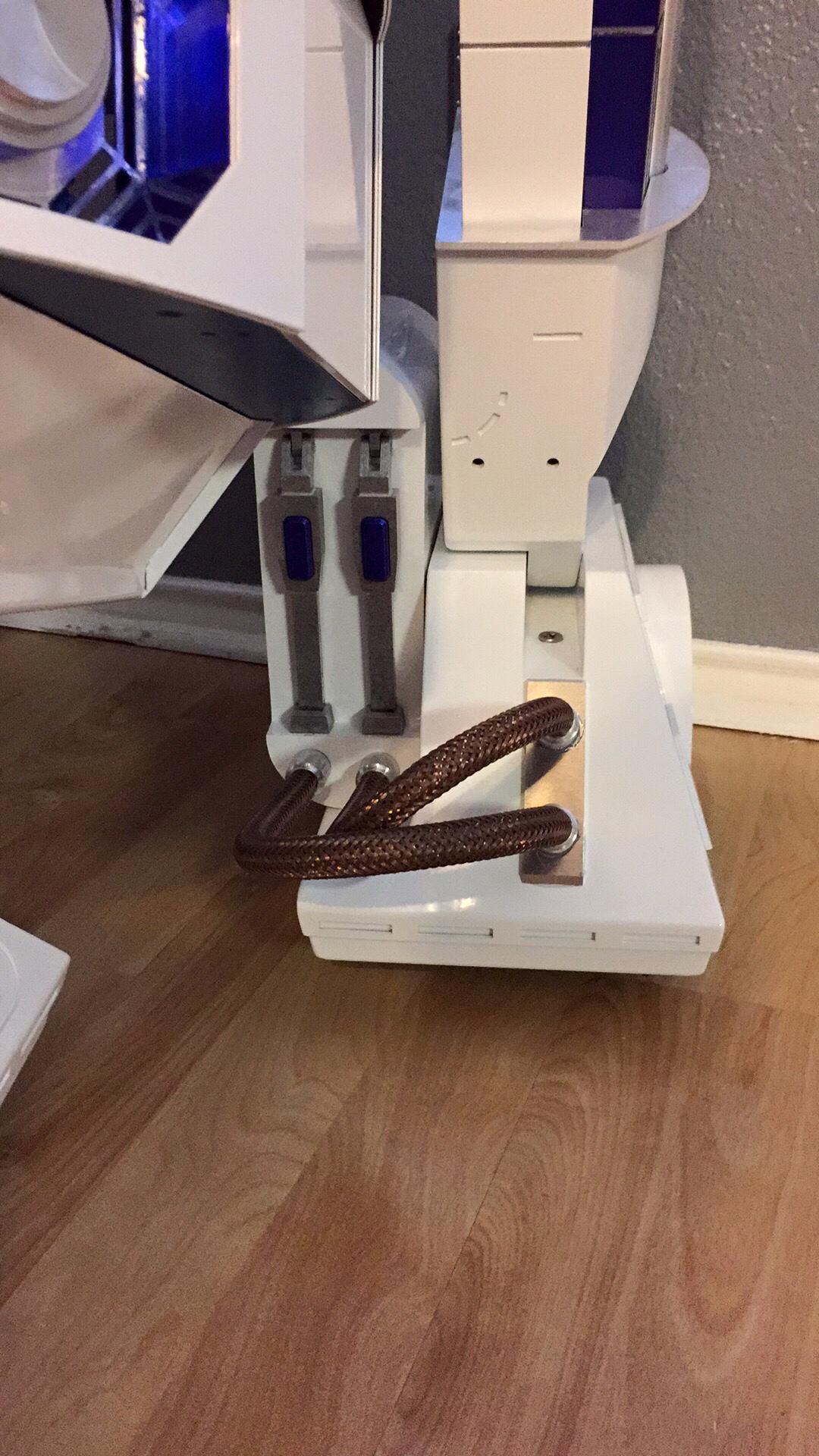

Got the battery boxes and hose put on.
It looks awesome!

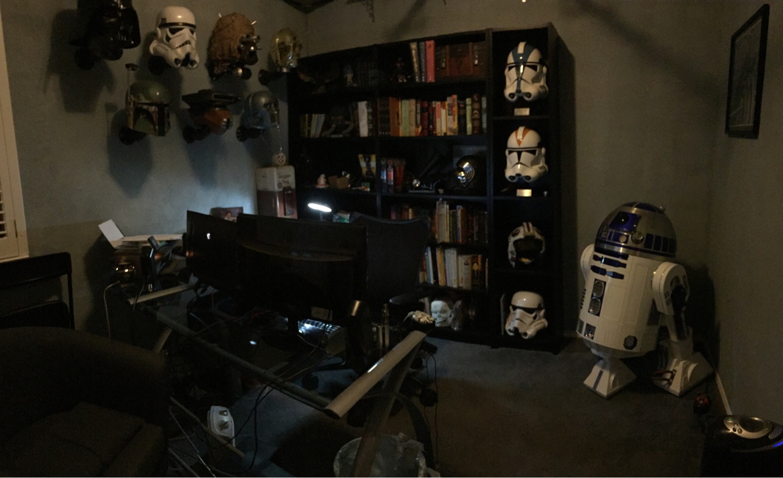

I got the back door put on and tweaked a few fitting issues, etc. and got him setup in his permanent spot.
I'll start the weathering process soon.

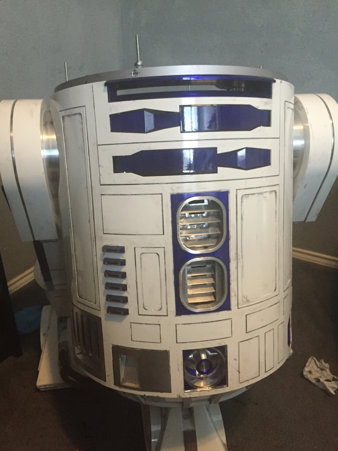

I already posted this on the R2 forum but I'll copy here also since he's technically a prop replica. :)

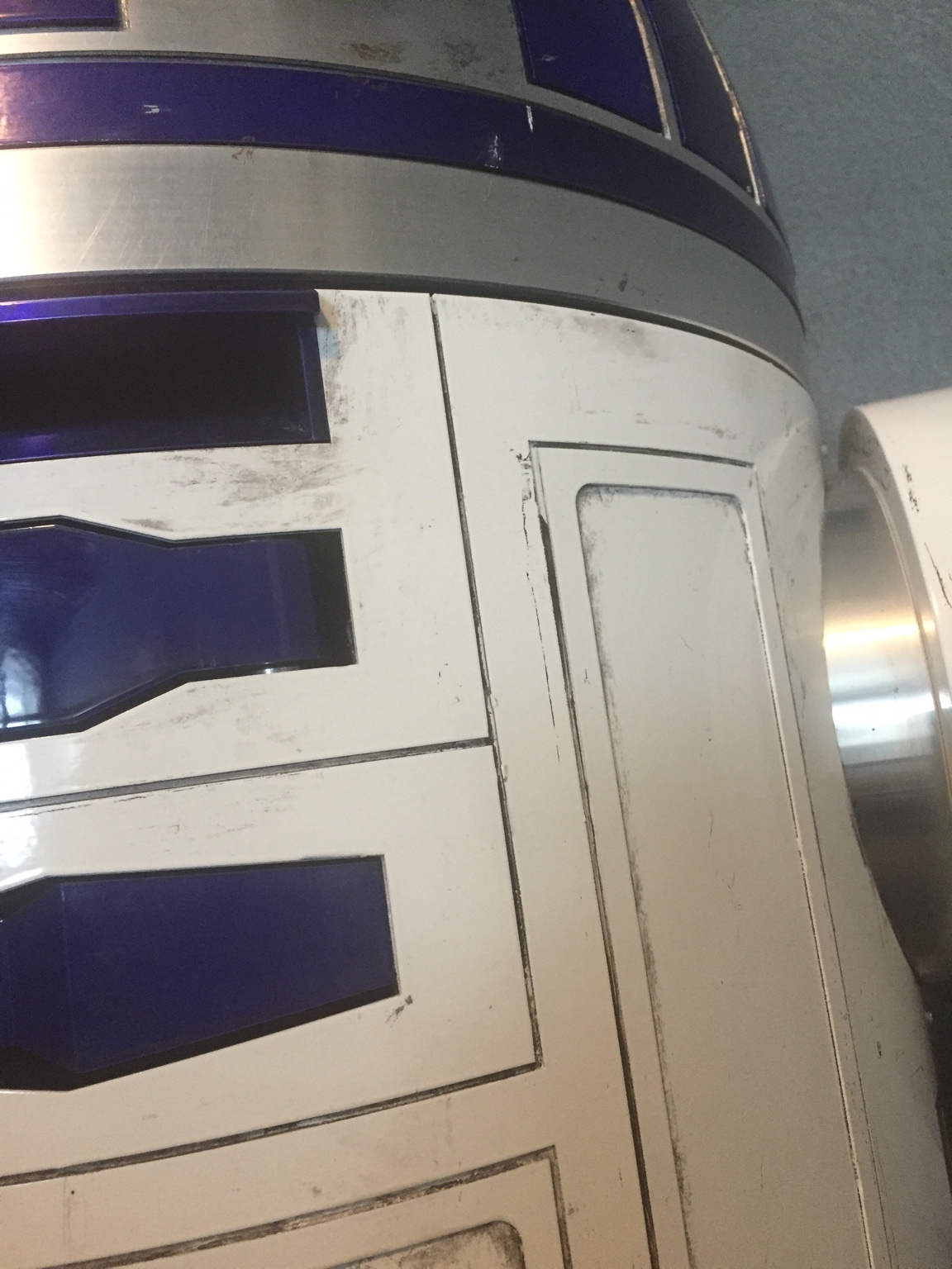

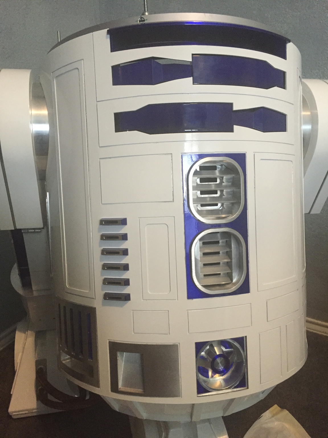

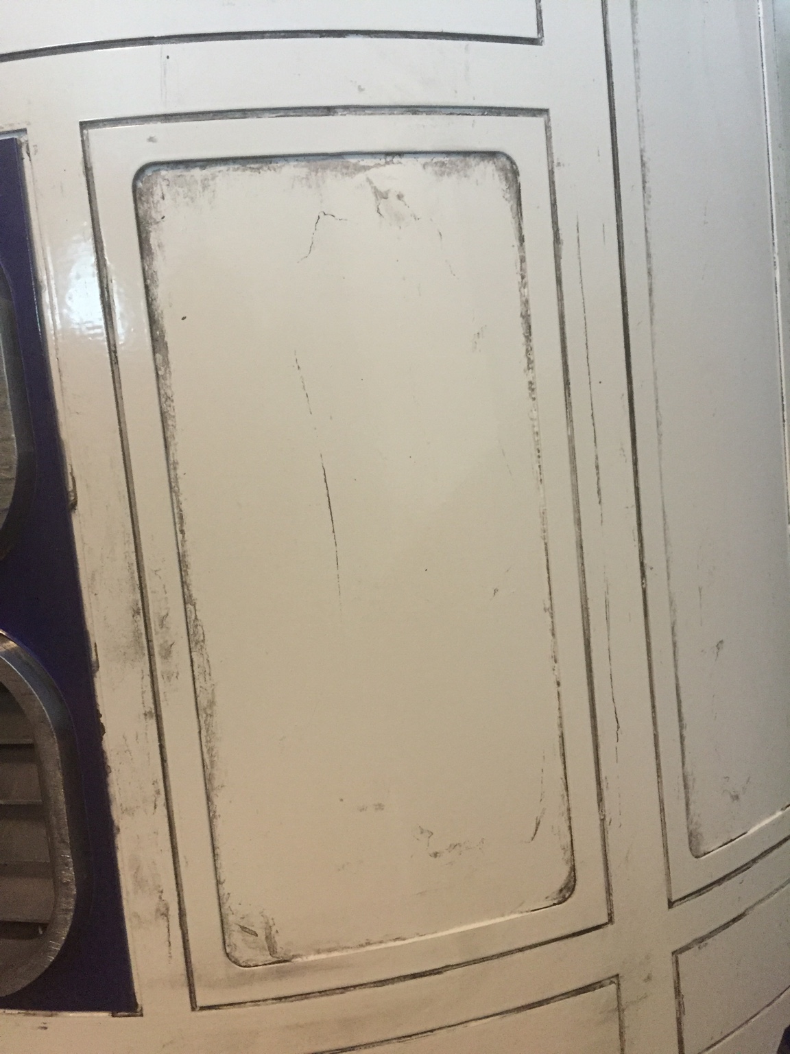

I did the first pass of weathering this afternoon. I wanted just enough to pull out the details and cracks. I'm going for an episode four Tantive IV look so not too dirty. I'm going to live with this for a while and see if anything sticks out as needing more or less. It's all acrylic so I can take it back off and try something else later. I wanted a mostly motor oil look rather than dirt so I went with black, dark gray, and dark brown mixed into a wash.
Before
After
and here he is modeling his new dirty paint job.
Before
http://uploads.tapatalk-cdn.com/20160614/8c339c98de7cf3b049c072a6ee48fec6.jpg
After
http://uploads.tapatalk-cdn.com/20160614/22528950e36619d8b7e7e7046c902991.jpg
http://uploads.tapatalk-cdn.com/20160614/7aafdb0727bf62a5fea3e33e30aad1cc.jpg
http://uploads.tapatalk-cdn.com/20160614/1f6b9b0538eb24b6c9e519f58dfc80da.jpg
https://www.youtube.com/watch?v=J_gIF_P0440

as i have said trent, your weathering amazes me!! i wish you would do a video showing your techniques. hint hint, wink wink
lol my technique is that I don't have a technique. The trick is to get it way too dirty, then wipe it clean, but not clean enough.
