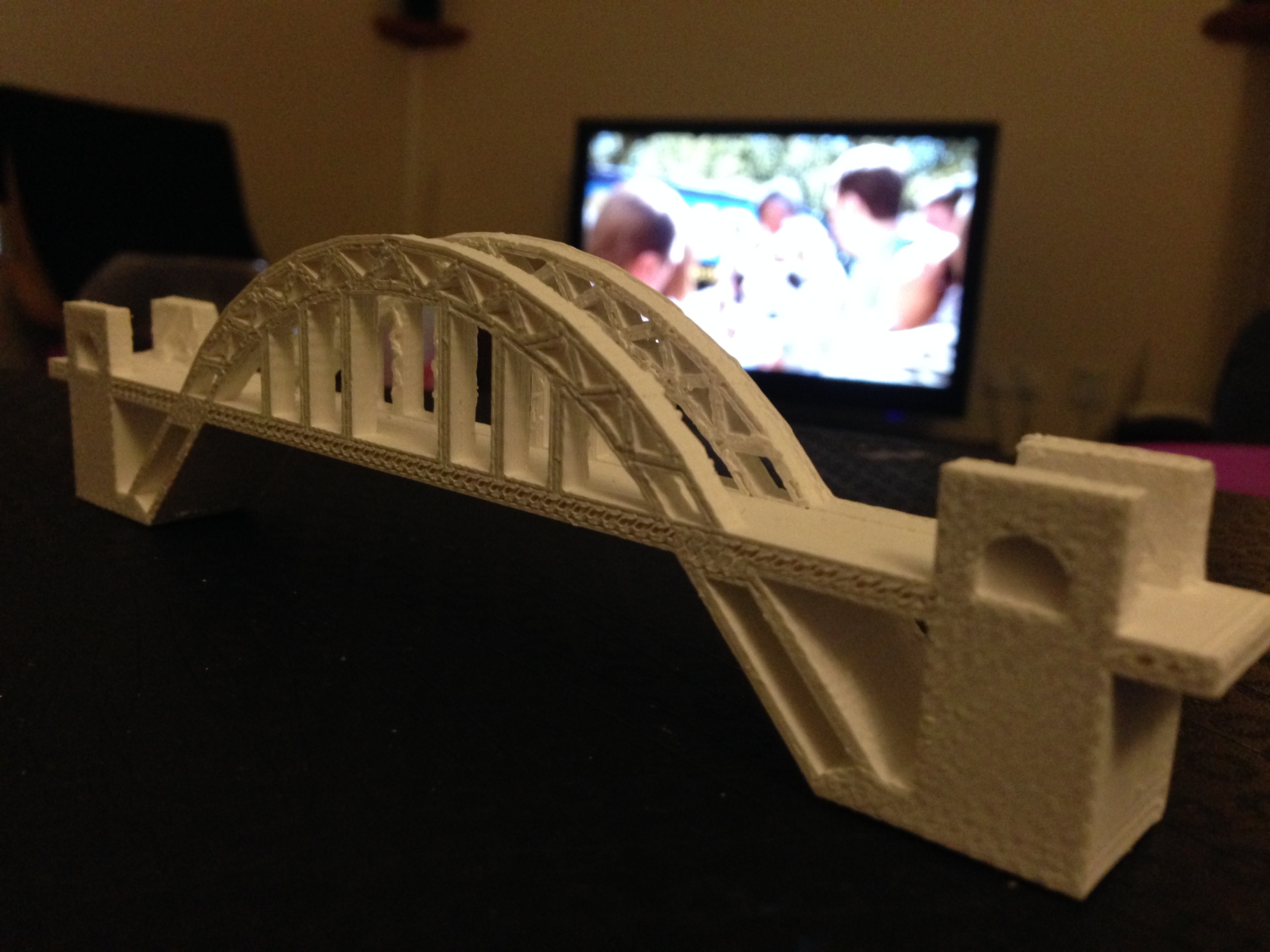

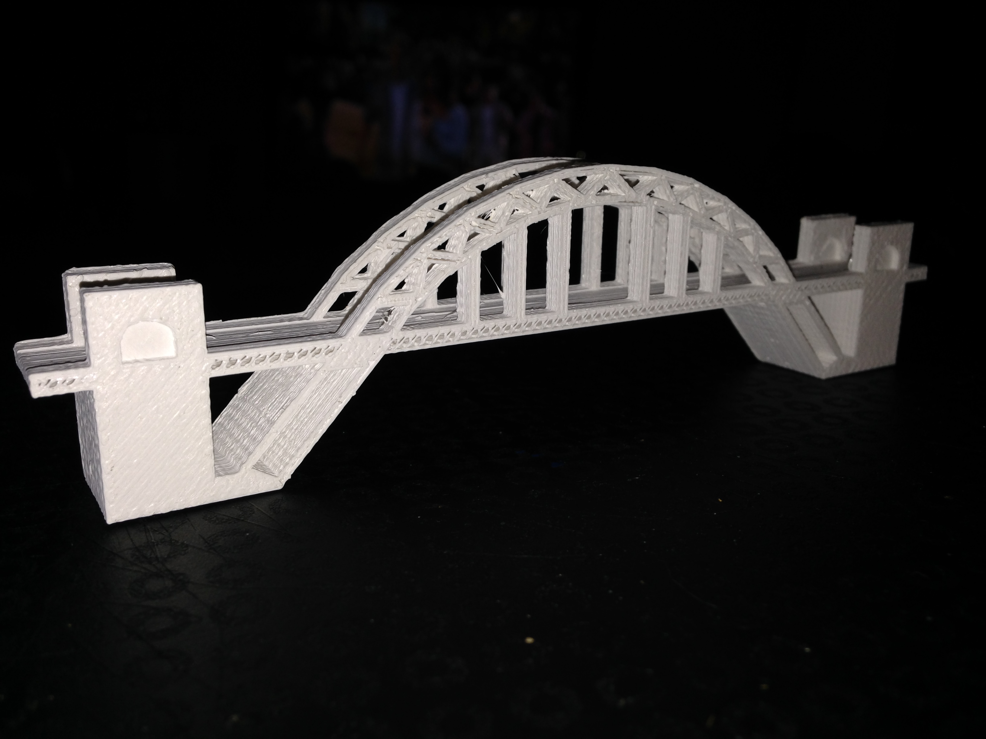

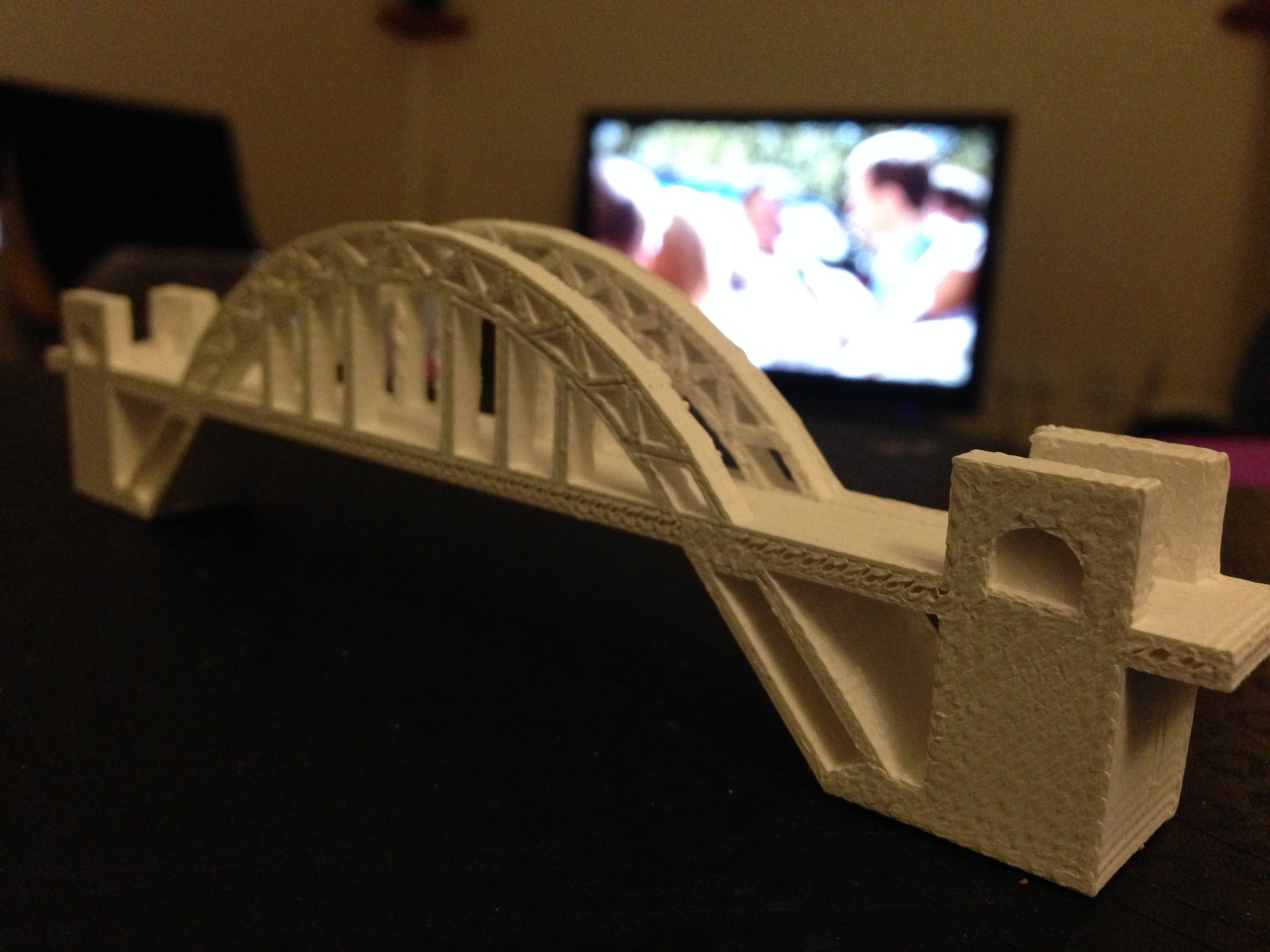

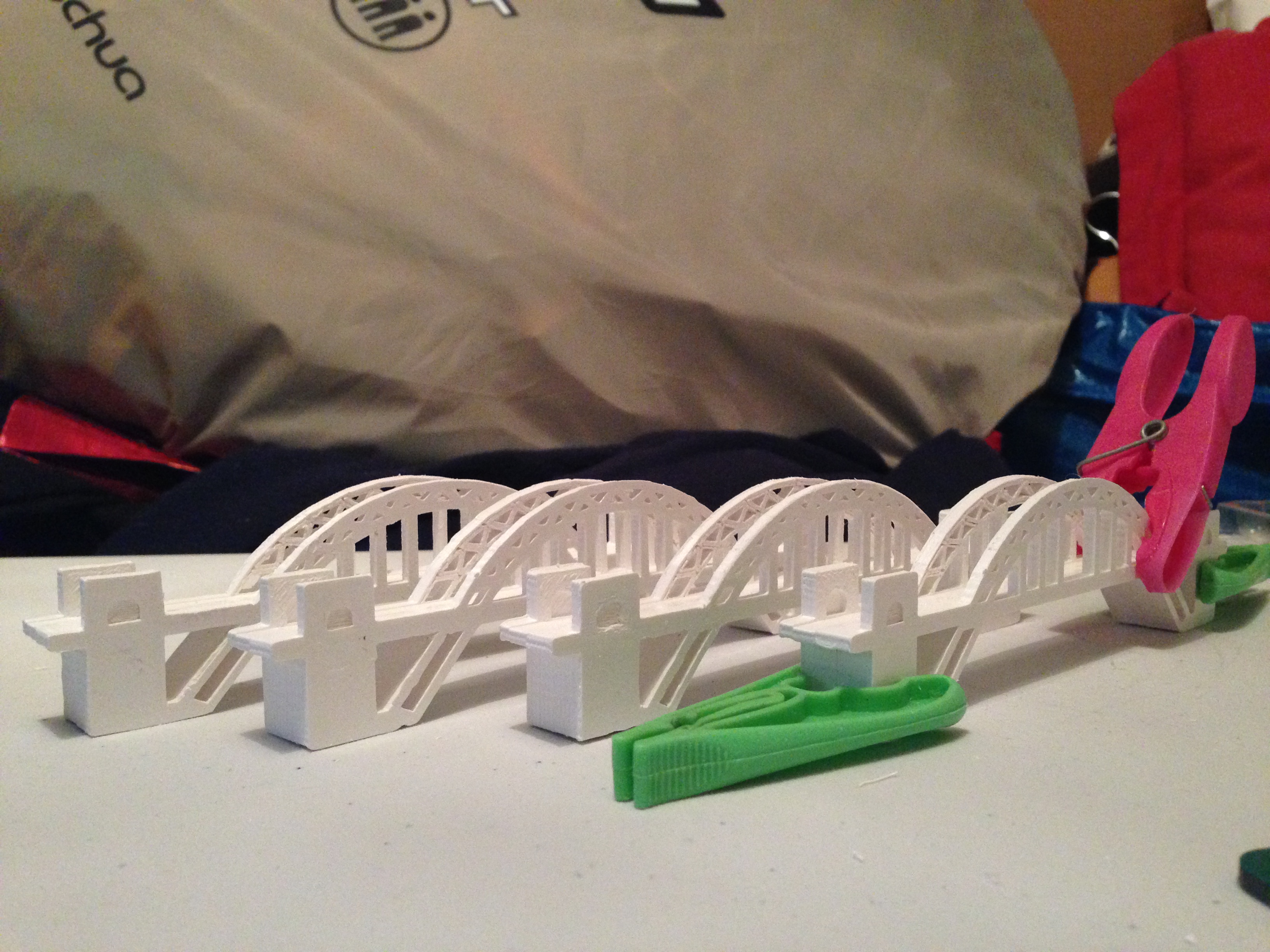

OK. So some friends asked me to see what I could do when presented with the idea of a small non-accurate bridge replica - I assumed it was for a business stand or something. SO yesterday I modelled it, and printed it to see what I needed to change. Turns out the awkward shapes between the arches didnt print well - so Im scrapping them out of it. Had a positive review from the friend that asked when I showed her the pics, and she wants it just like that - turns out it is for her wedding tables, as part of a set theme! So now I want to make them better! Anyhow here it is. and a reference picture of the tyne bridge, which is in Newcastle UK.
20141028_221316048_iOS.jpg20141028_221325791_iOS.jpg20141028_221340660_iOS.jpg20141028_221406976_iOS.jpg20141028_221414325_iOS.jpgTyneBridge.PNG

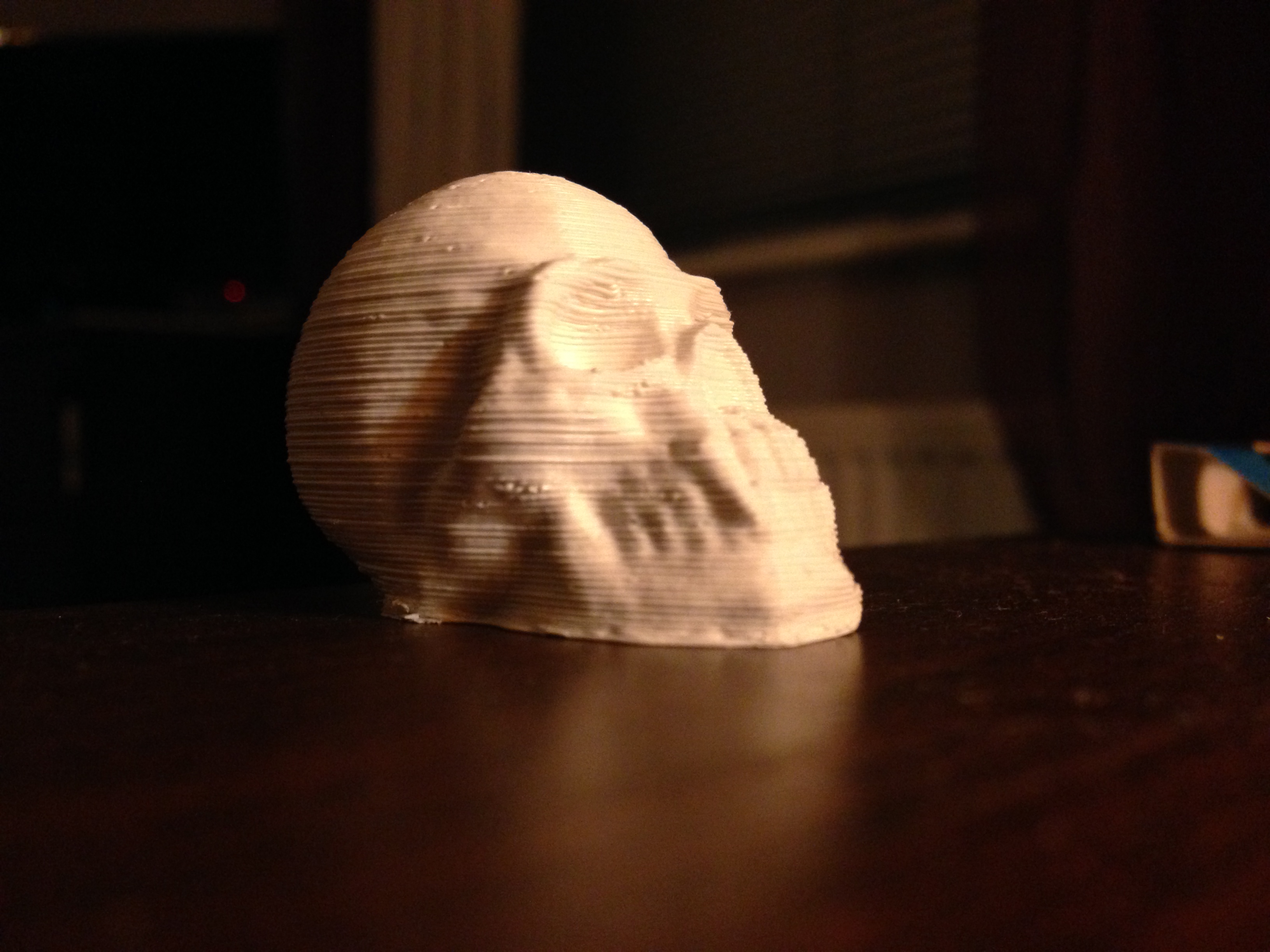

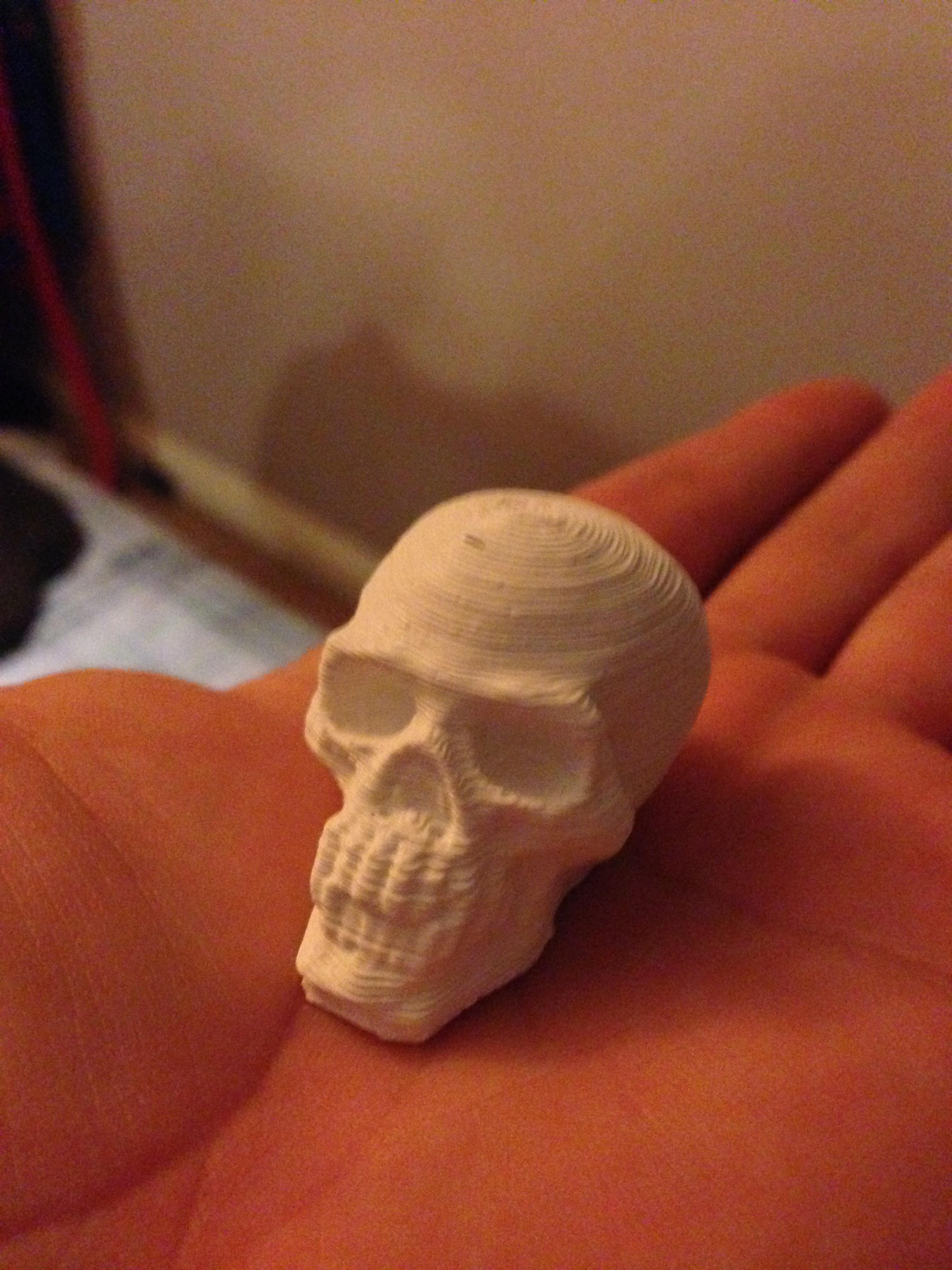

So my printer is still making a strange little jump motion when it is near the top of the z axis threaded bar. It doesnt seem to affect the printing too much. This skull is printed out at 0.2mm and high density. Came out quite well.
Very concerned about the jumping/clicking near the top though. Have had a look and nothing obvious is out of alignment.

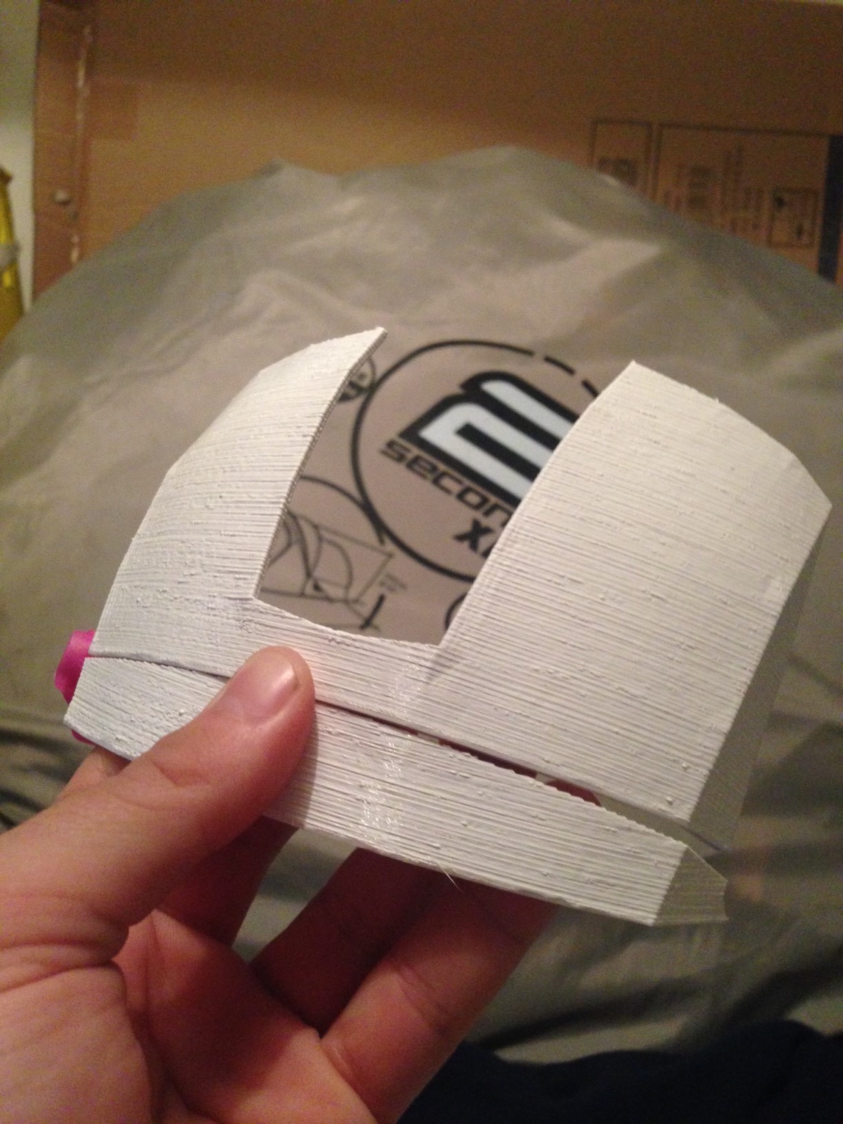

Self explanatory. Finally got around to printing it out. About 10 hours for the three pieces with little to no support except around the eyes - took a while to remove that support. Sliced it in repetier host, printed at 0.3mm to try and save some plastic/time. Still used 32 metres of filament.
Im playing about with acetone/ABS glue for fusing parts together
Thought I'd just a nice boring update - my bridge collection is growing.
I have noticed that leaving a bit more of a gap between the head and the print bed when the print starts really helps clean up the "bottom" of the print rather than the layers squashing out - common sense but I've never just tried it. It helps a lot with the tiny holes that are in the arch of the bridge.

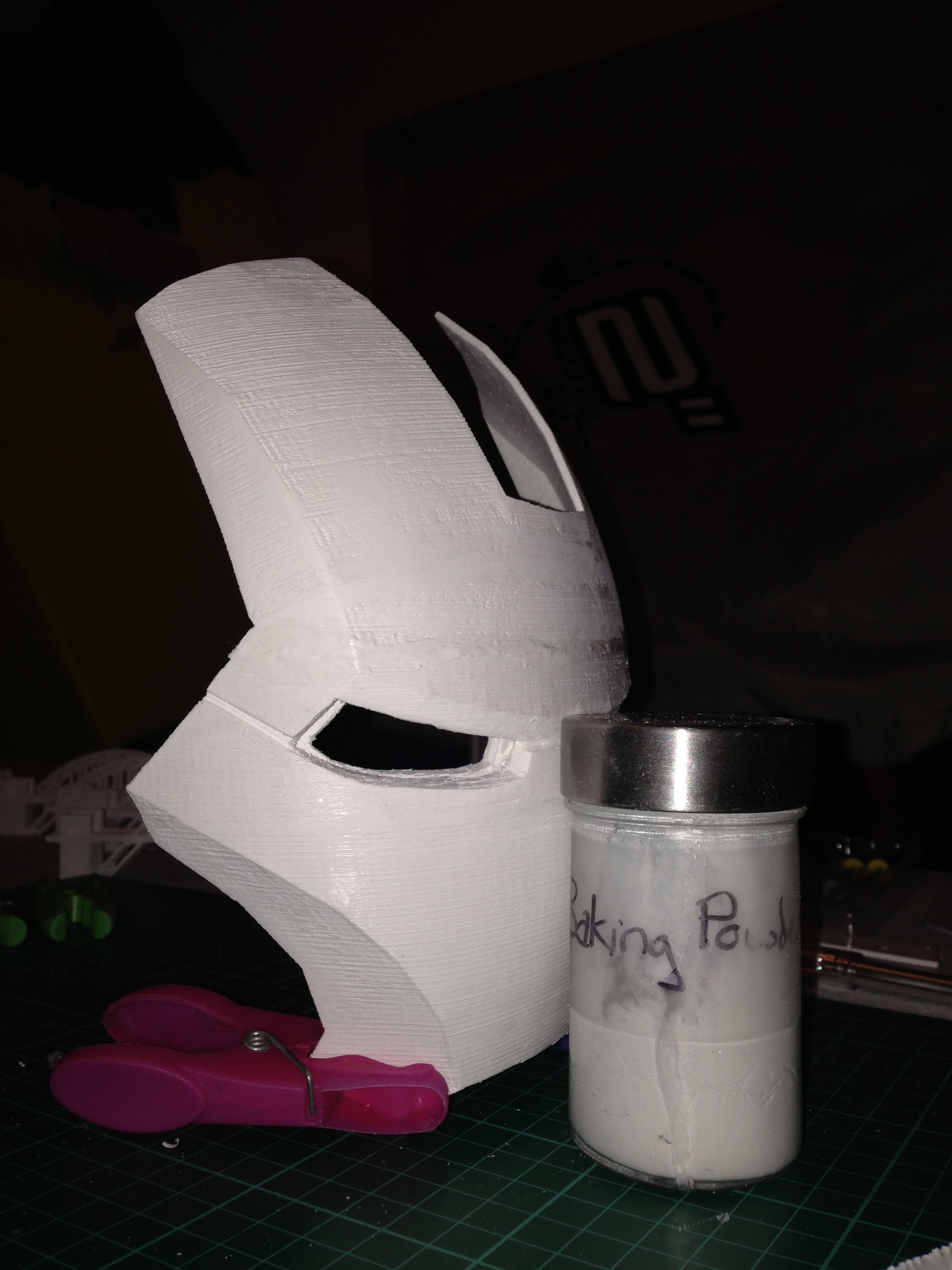

finally got around to fusing the top and bottom half of this print. now to sand it a bit more, apply some of this new fangled XTC-3D and start preparing it for mold and casting
