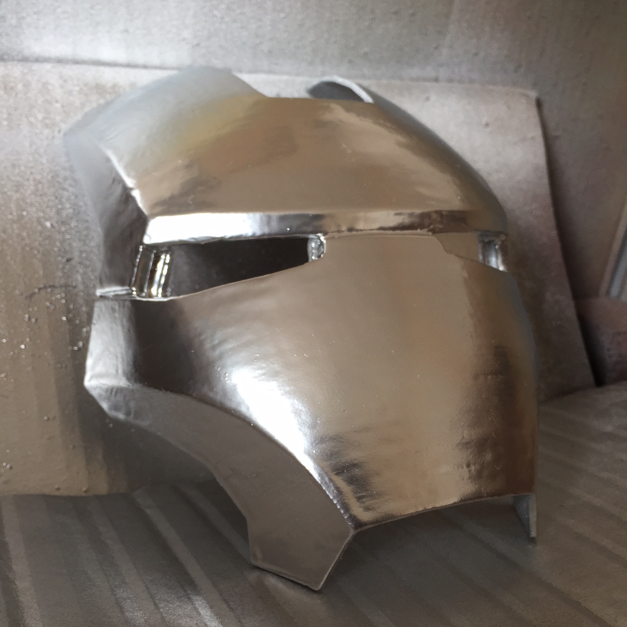

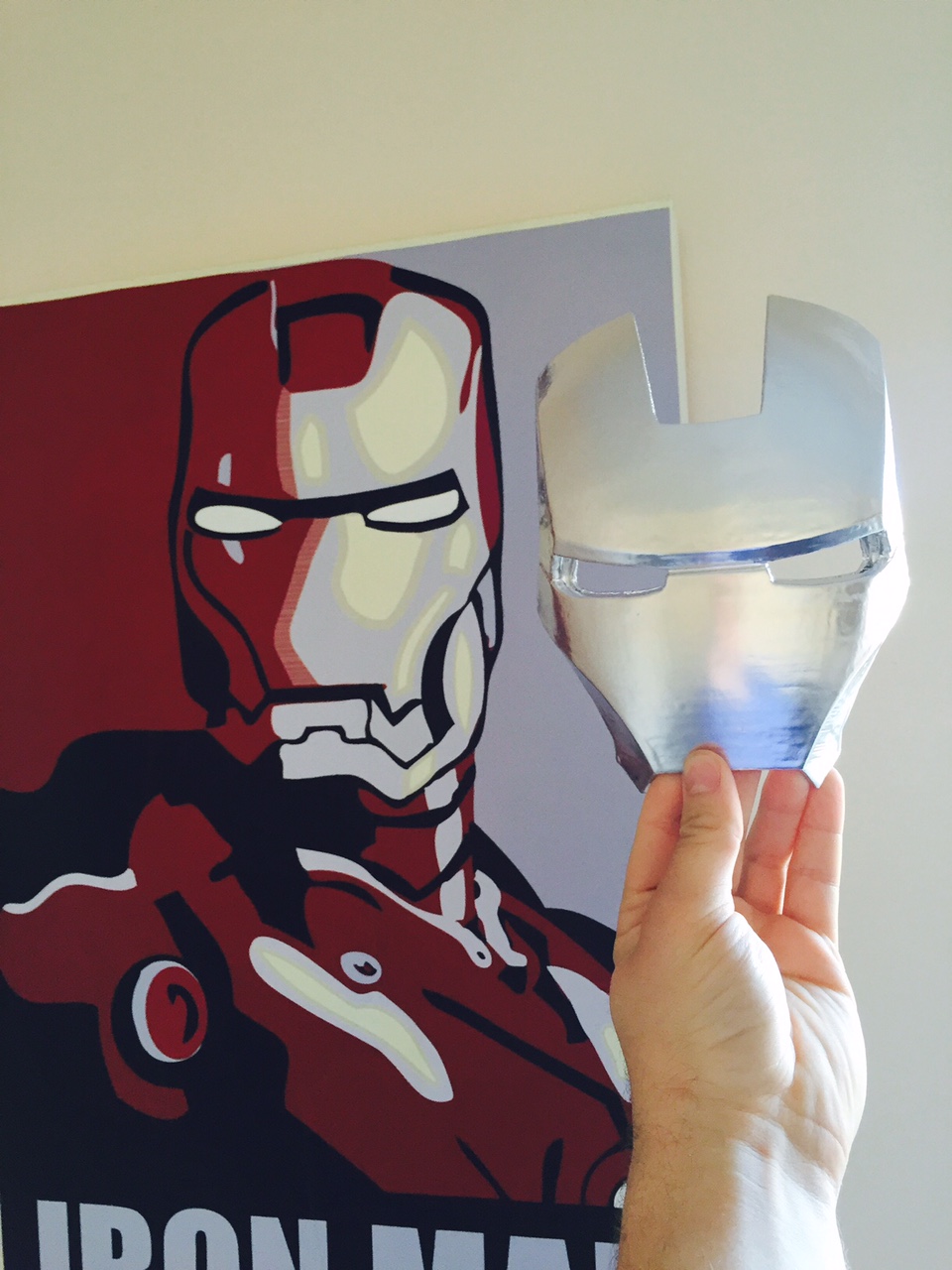

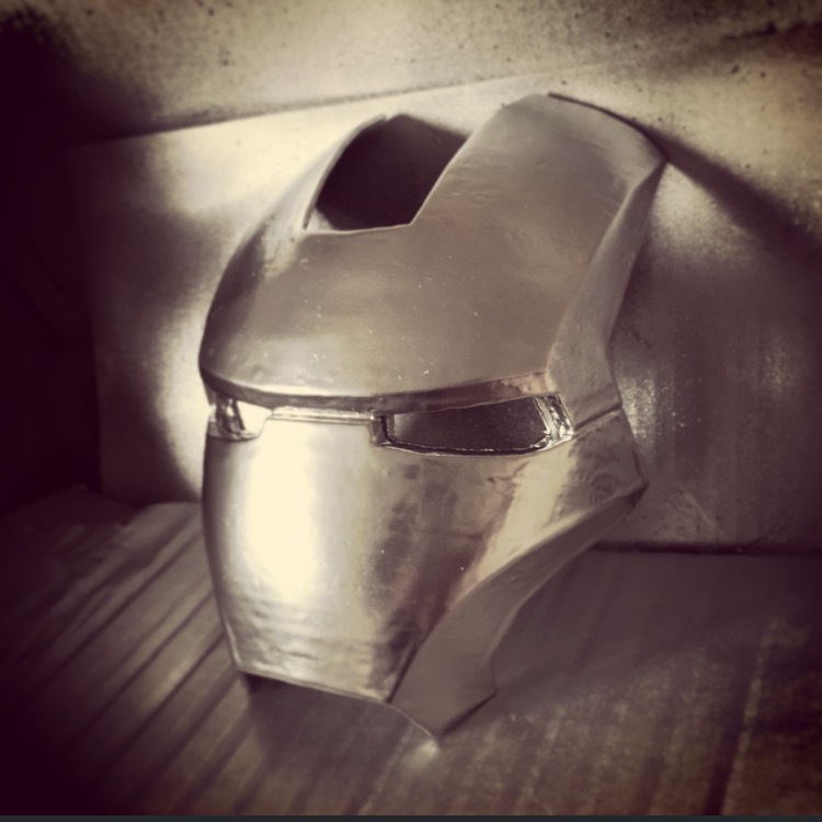

decided to at least put a finish on this - have had little time, so its rough. but it looks lovely compared to just a white base.
Hi Risu. The total stuff used in this instance was a base layer of xtc-3d (settled well in some areas, not so well in others) then a layer of white primer. The chrome was plastikote chrome fast dry enamel.which I picked up from a b and q - which is a british hardware store. Amazon do stock it also I believe.

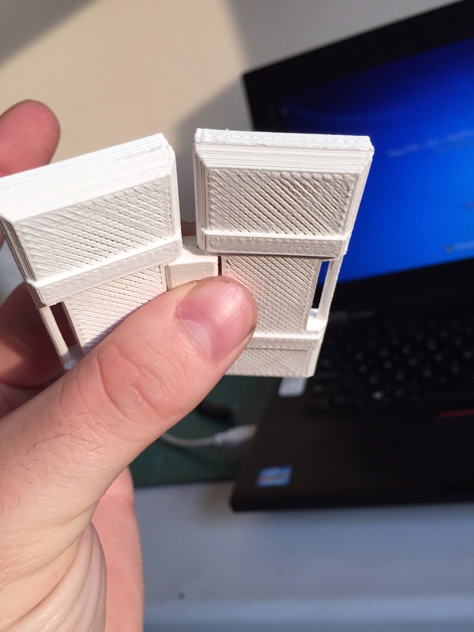

I've had my Davinci for a few months now. The very first thing I did was flash the firmware with Repetier Host so i can use generic Amazon filament. So far I've printed with PLA and ABS, but I get feed issues when I use PLA (clicking problem everyone has). I am finding that I need to calibrate this thing nearly every single print. Once I do, I get a great print, but then it's gone again. It's been a fun learning experience though. Here are a few prints and my setup:

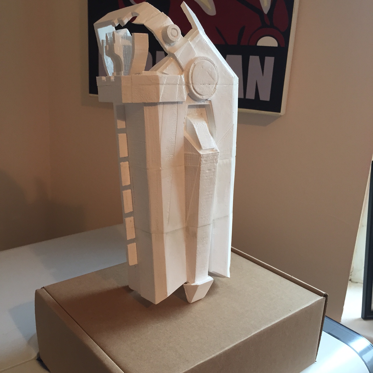

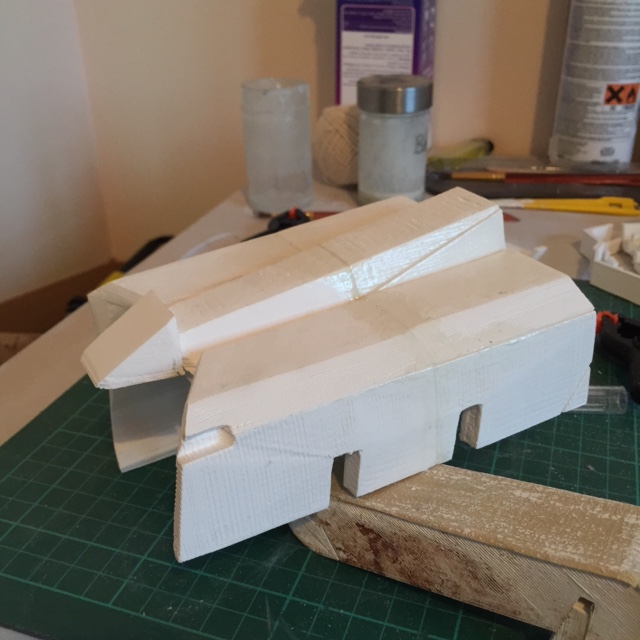

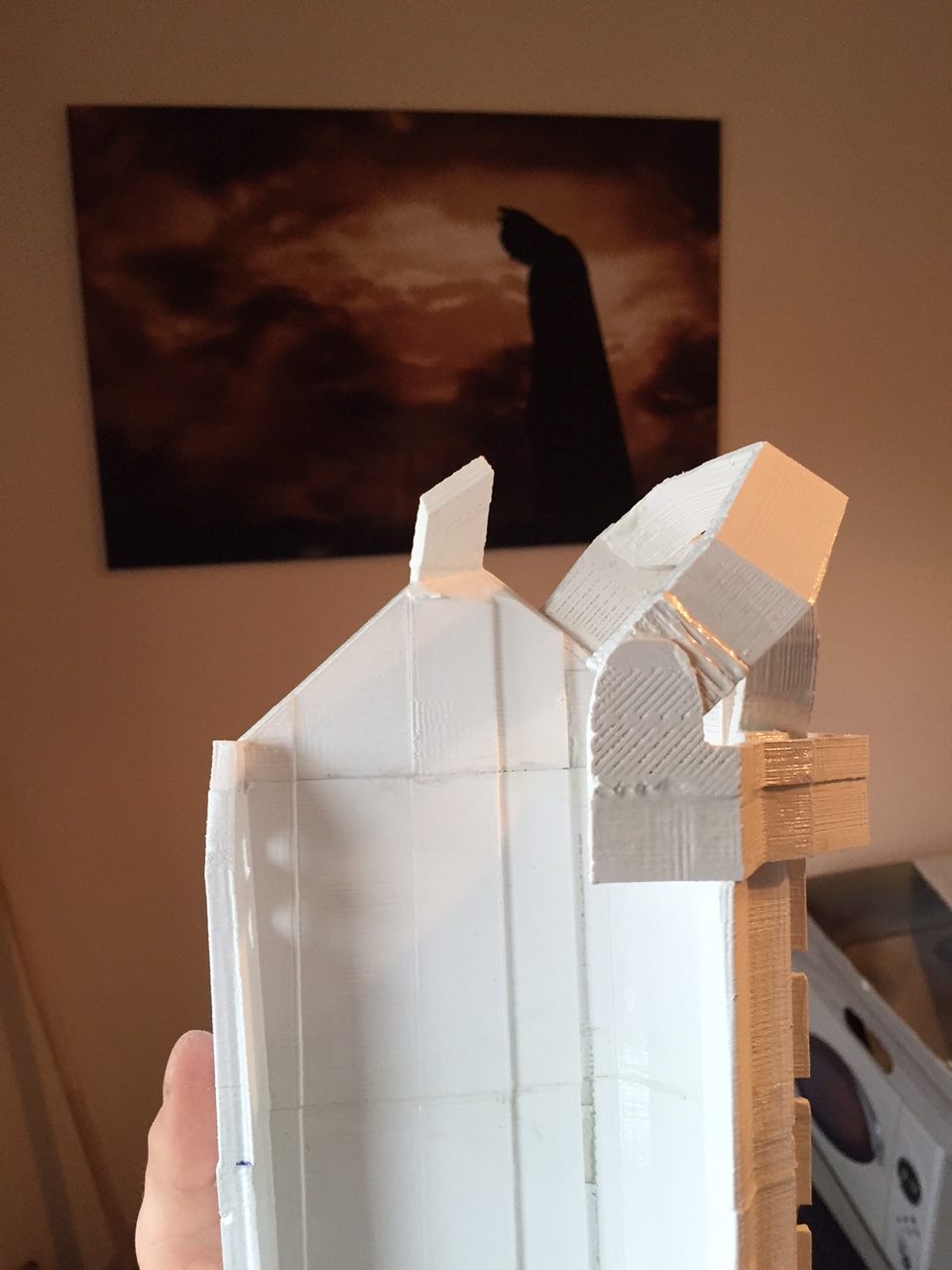

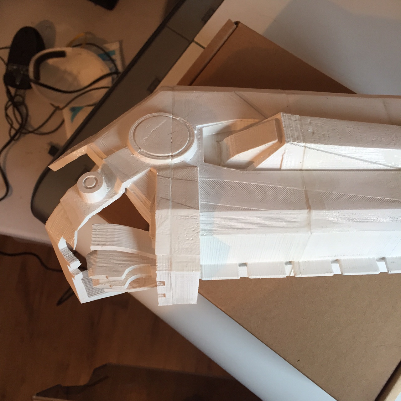

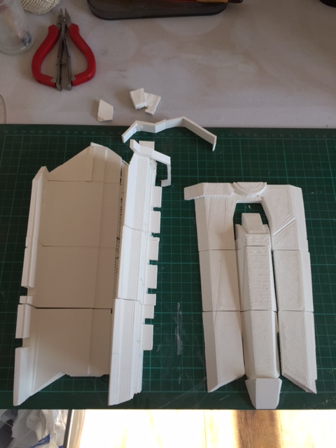

I am currently in the middle of my first commission on behalf of Stigmorgan on here, and the little Da Vinci has been hard at work. Here's a few progress pics of the arkham knight gauntlets. The design is originally by Bandiet.
All printed out at a relatively low (0.3) resolution because there will be a decent amount of finishing needed anyway, and there was no reason to take too long/use too much filament. As the design is quite boxy and armour like, the larger resolution works well with some sanding etc. If there had been a ton of small detail, I would have used a lower resolution.

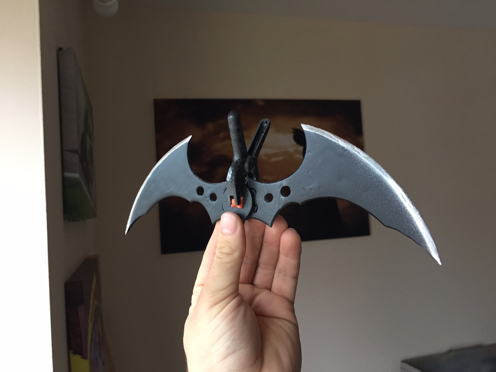

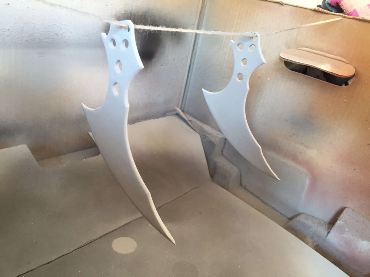

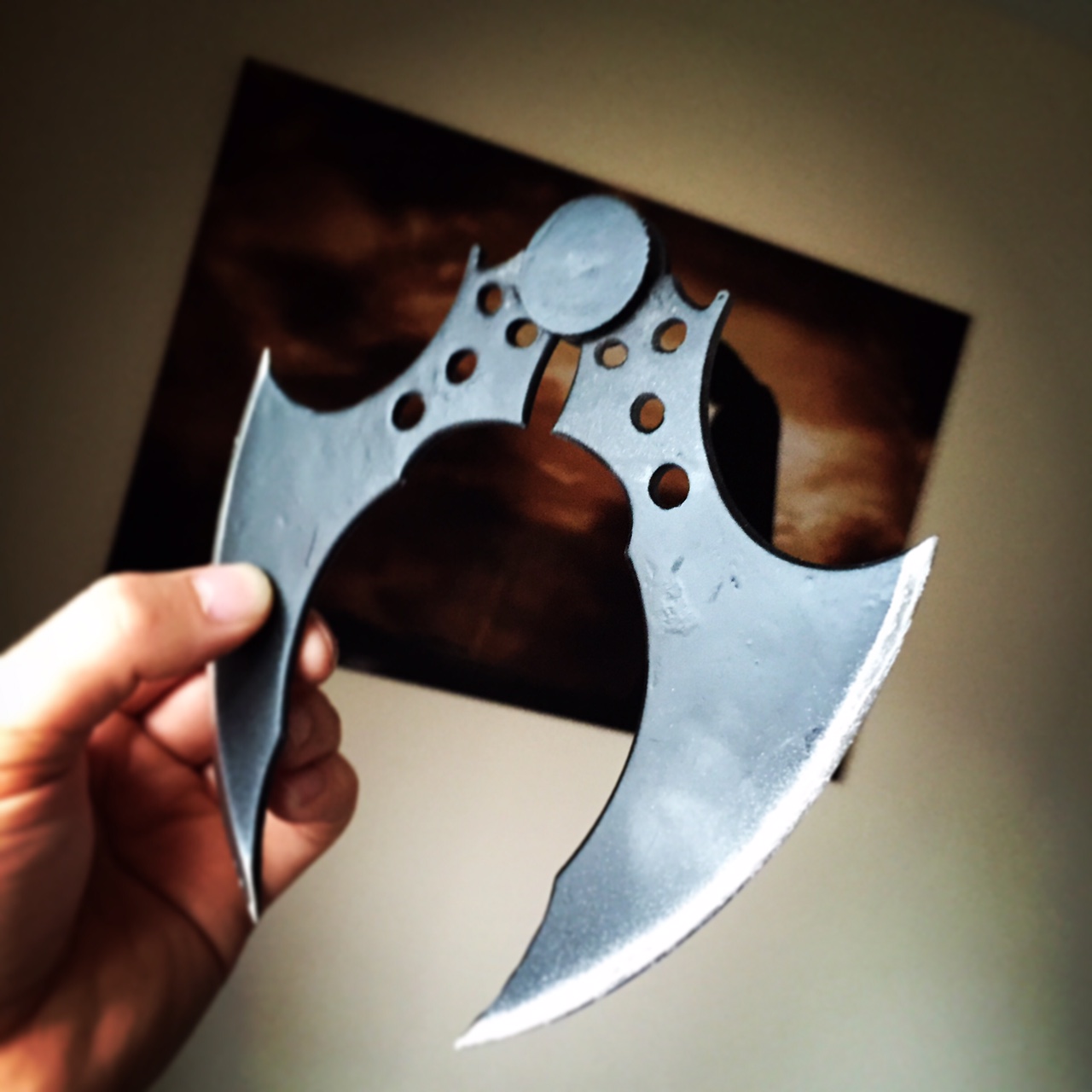

Did myself a little Arkham Batarang and added in some magnets etc. Also used xtc-3d a little more for finishing work.
[video]http://tinypic.com/r/aenz3n/8[/video]
And a little action video.
