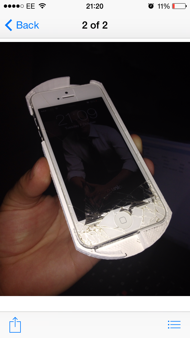

Below is an acoustic booster iphone case. Just to test how the fit was etc. The boost itself didnt do much. But it fit like a charm. A few areas on the case were not a great finish however due to the standard software.
Ignore the broken screen, I'm currently 18 months into living with it like that. Remarkably resilient!
