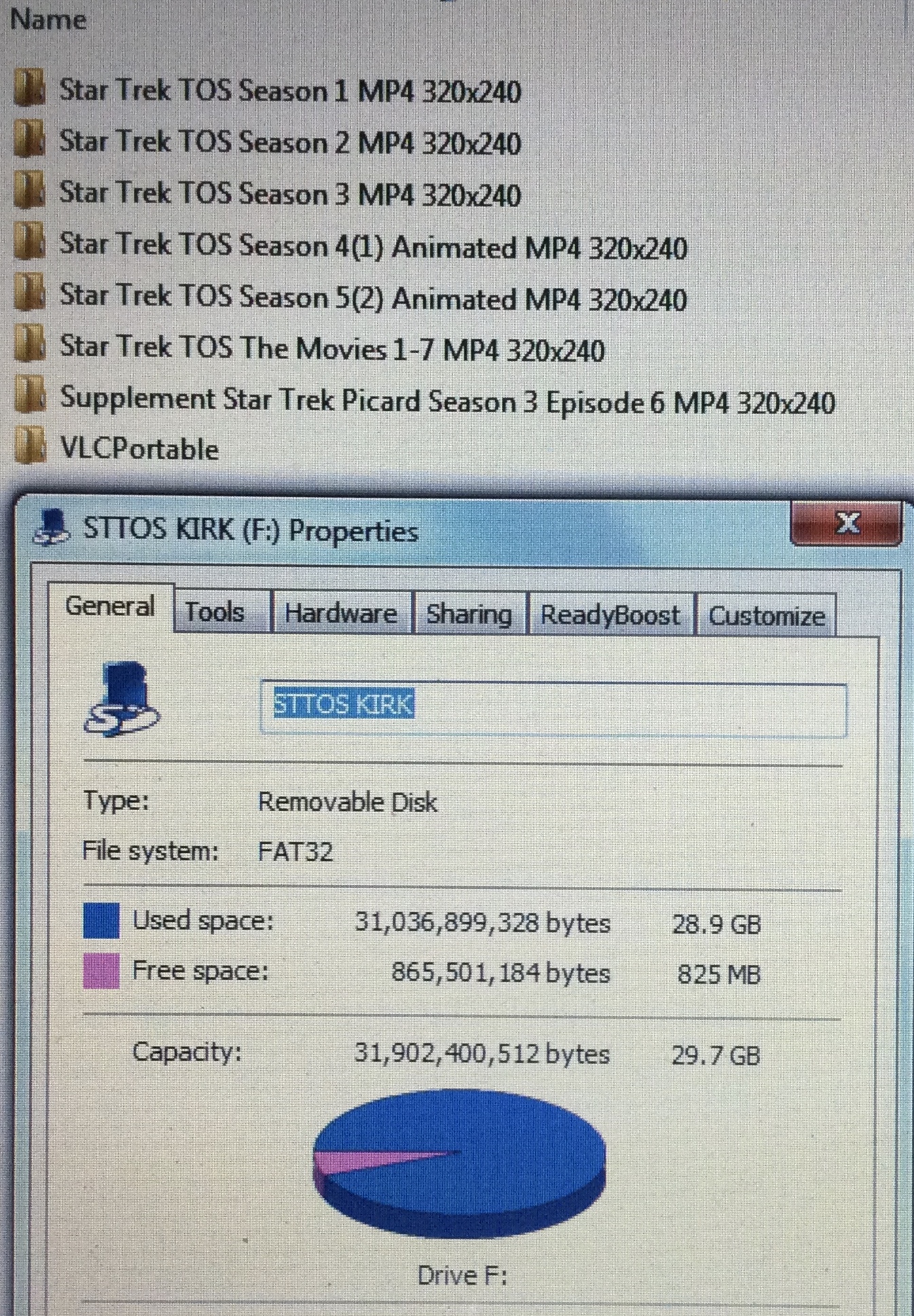

Well as of yet….no one (including myself) that I know of, here and elsewhere, has braved to see if an micro sd card with different file types could even be recognized by the tricorder when inserted into the slot. I’m not there yet….but I have now finalized my Star Trek Kirk centric 32Gb micro sd card (with a bit of room to spare) for when it is known that the card slot is usable. I’m just waiting in the wings…
Right now, according to Chris the SD card reader isn’t functional. He said they’d have to write the software to make it functional but right now that isn’t a priority. They’re working on other things that were put on hold.
I guess the only way to do it would be for someone to hack the software. According to the Wand blog update 5 the Tricorder is using an Arm Cortex M7 Micro controller. The M7 MCU is a more advanced version of the current ArduinoR4 MCU which is a M4.
They would have download the Tricorder binaries and disassemble them. The M7 uses the Thumb2 instruction set. To my untrained eye it looks similar to the instruction set used in other Arm Cortex CPUs. So if someone who knows Arm assembly language, I would guess, they should be able to figure out the code and write the proper drivers for the micro SD card reader.

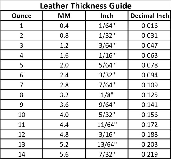

For those looking to make a leather strap, the leather thickness is normally "sized" and sold based on the "ounce", with one ounce roughly equivalent to 1/64th of an inch or 0.4 mm. So a single leather strip strap should use 5 oz leather. If you are going to fold , cement and stitch, I would recommend 2 oz, as the cement (like Barge) will add a little thickness. Also the location on the hide where the leather comes from can be important if you have the choice. Leather from from the belly can stretch (I can testify this phenomenon is not limited to bovines). Leather from the back is firmer and thicker and probably heavier than 5 oz. Also the weight is just an average - as a natural product the thickness WILL NOT be constant across a piece of leather. A professional can take a heavier leather and skive it to the correct and consistant thickness. The most critical thickness will be the ends (approximately the last 70 mm on each end) which must pass through the panel side slots. This will reduce the effort of skiving the entire length, and allow the center of the strap to be thicker if desired. Also note only the ends could be narrowed to the critical 19 mm width and the center of the strap set to fit your own requirements.
EDIT: Also consider the recess of the side panel if you make your ends wider than 19 mm. They can taper wider in this recess and beyond ~ 105 mm from each end can be as wide as you wish.
Interesting info….real leather is uneven. So when buying..you may see overlap choices like 4/5 oz or 6/7 oz in the sales listing description.
